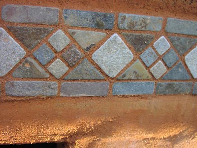

                  Ah - I used the hardieboard smooth siding - not the shower stuff. It comes in 4 x 8 sheets, the other stuff is only 5 x 3 IIRC. Since it's siding, I assumed it was outdoor rated, but i actually never checked
                  As for tile - I couldn't find any good pictures of all tile ovens - but I did find this, which would be kinda cool. Stucco + tile. Would fit your decor well

                  • Re: Texman Build
                    that is cool! So not a total tile veneer, but work some tile/stone in there as border. I like that. I was trying to think of a way to break up the large stucco walls visually. I started to make some recess areas on the walls, but decided it was too much trouble and might look weird. I will do some looking around. Thanks!
