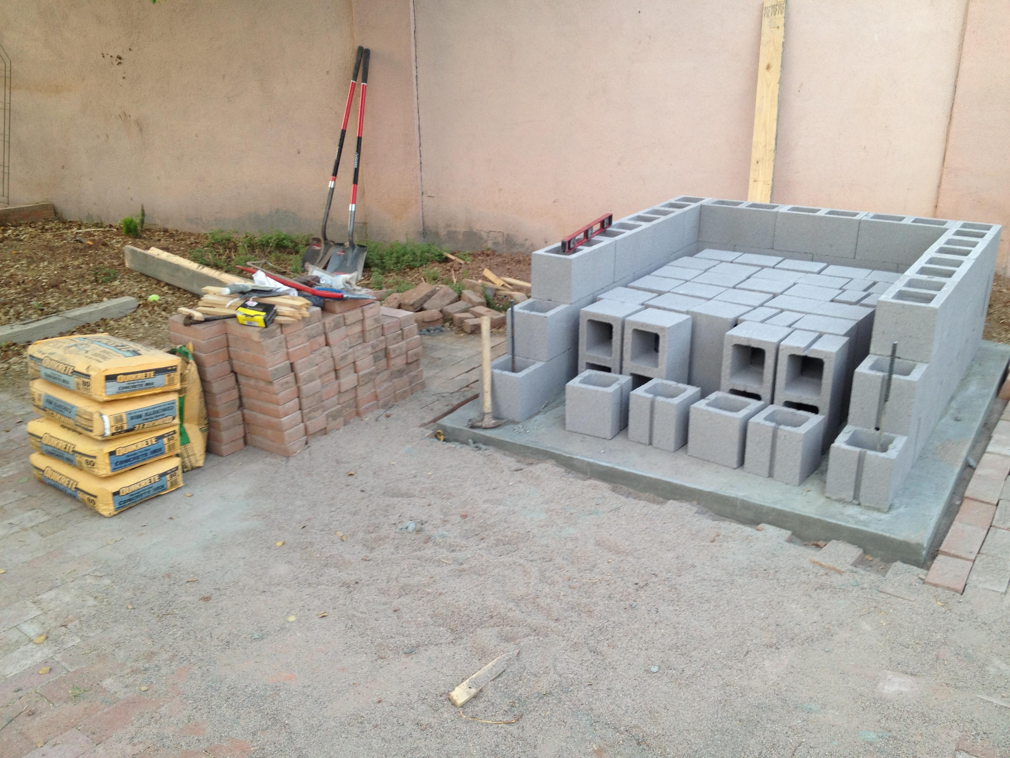

    OK, so Saturdays will likely be days that I get a lot accomplished. I went over to Lowes to purchase the 8x8x16 block. I haven't taken the forms off of my concrete yet, but I have been told 12 hours is plenty in Phoenix.
    I put a chalk line down 4" from the edges of my foundation, and started to place down my block to measure. Newbie note: 8x8x16 is actually 7.5x.7.5x15.5 (like everything else). So, I am off by 1.5" on all my chalk lines. Will need to do that over again. Anyways, here is a pic of what the courses look like. As side earlier, will be doing 5 courses high- don't want to have to hunch to look into the oven.
    Asked a few people on this forum about the need for a center column, given that I have a pretty large gap. Both think it's not necessary. Great news.
