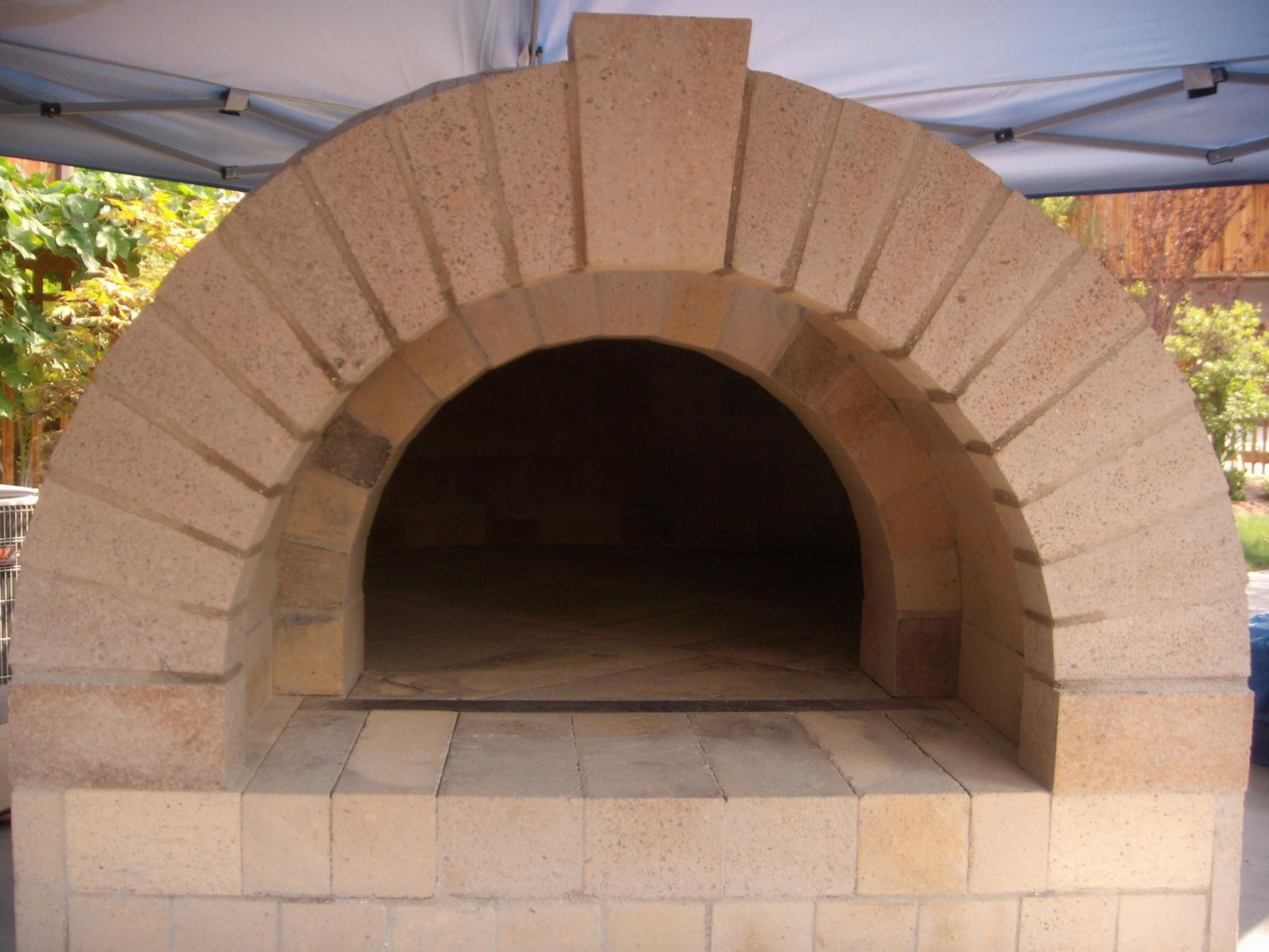

    Wahoo, final arch is done, form removed, mortar tucked and excess cleaned up. Just need to make the chimney transition to the vent anchor plate and install the thermocouples. Maybe I will make the Labor Day deadline. Looking for an old cabinet or fridge to make a dough proofer like KD did and started my research on polished concrete which I am going to do on the hearth. The list keeps expanding..........
    Hi,
    I am planning to build my outer arch so it goes inwards a bit, 20mm or so. What length do you outer arch bricks have? A full length brick,of mine is 208mm, think that is a bit to long, wouldn't look nice I think. Maybe it's possible that the stucco stops even whith the Outer arch bricks?
    Greetings
    • The original length was 9" or 229mm but I cut them to 6" or 152mm for my final decorative arch with exception of the keystone brick at the top. But this is your choice. The inset of the arch was a recommendation from Karangi Dude, to act as smoke block so the smoke would take the path of least resistance through the chimney. Just make sure your diameter of the door reveal flange is smaller the the diameter of the outer arch.

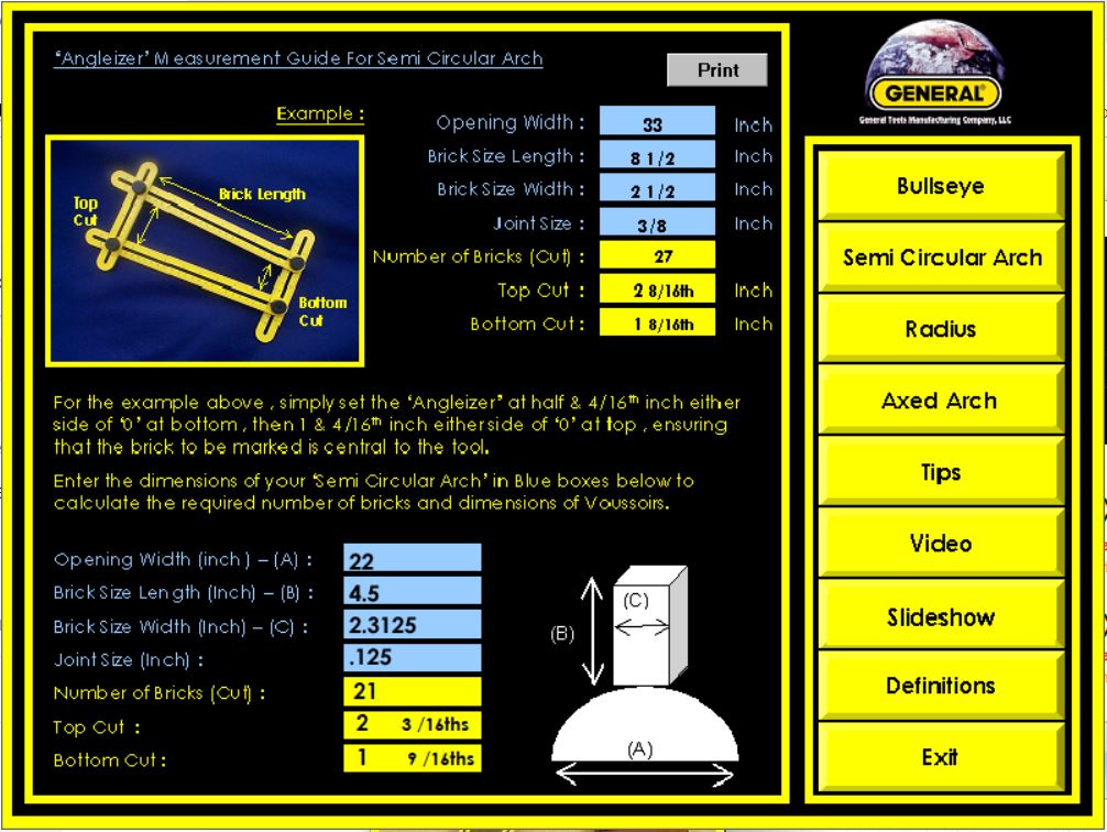

                      • I have been collecting the supplies to build a oven for about a year was going to start build this spring but I have to have shoulder surgery will not get much done this summer. I have made IT and inter arch form cutting jig I was going to cut floor and first two rows and inter arch bricks .I went and bought some bricks and the width of the bricks that I had taper dimensions for were 2.5 inch bricks mine are 2 5/16 for the 2.5 in bricks wide part 2 3/16 narrow end 1 7/16 I was using these dimensions from texas who made a oven in 2013. I was going to follow there plans 36'' oven vent arch 1.5 reveal vent arch 22'' width, radius 11'' It will have a 2 5/16 base brick and the arch part will be a hemisphere ? So my question is what would be the measurements for bricks that are 2 5/16 instead of 2 1/2. I know russell said the angleizer had a program to figure it out I bought one not sure If I could figure that out . Any help would be appreciated you guys are great been studying this forum for about a year so maybe next year it might be done.
                        • You need to tell us how wide the bricks are, not just the thickness and what size mortar joint you want.
                          • I thought I had it figured out with TEXAS plan but to be honest like I said been reading this fourm for a while sometimes I think I got It but I don't just a headache. So to move on the bricks are 9'' long 4 1/2 wide and the ones I have are all consistent . With a 1/8 mortar joint ? what are the taper demensions.
                            • I notice I inputted the dimensions in the wrong field so I redid and reposted. I did it both ways, axed arch and semi arch. I also see you had JR do it for you too.
