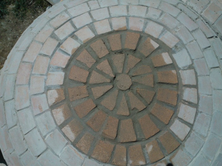

                • deejayoh
                  • Jul 2010
                  • 1893
                  Re: Keystone Size
                  As an aspiration, that looks great. But just be prepared to make adjustments along the way! Your oven is not going to come out precisely as you draw it. My keystone turned out pretty small (relative to many), but I really only started to plan it when I got to the last three courses.

                  My $0.02 is that you might want to plan for the plug to be a little bigger than what you have now, because your mortar joints are more likely to be too big than too small, eating up any wiggle room you have.
