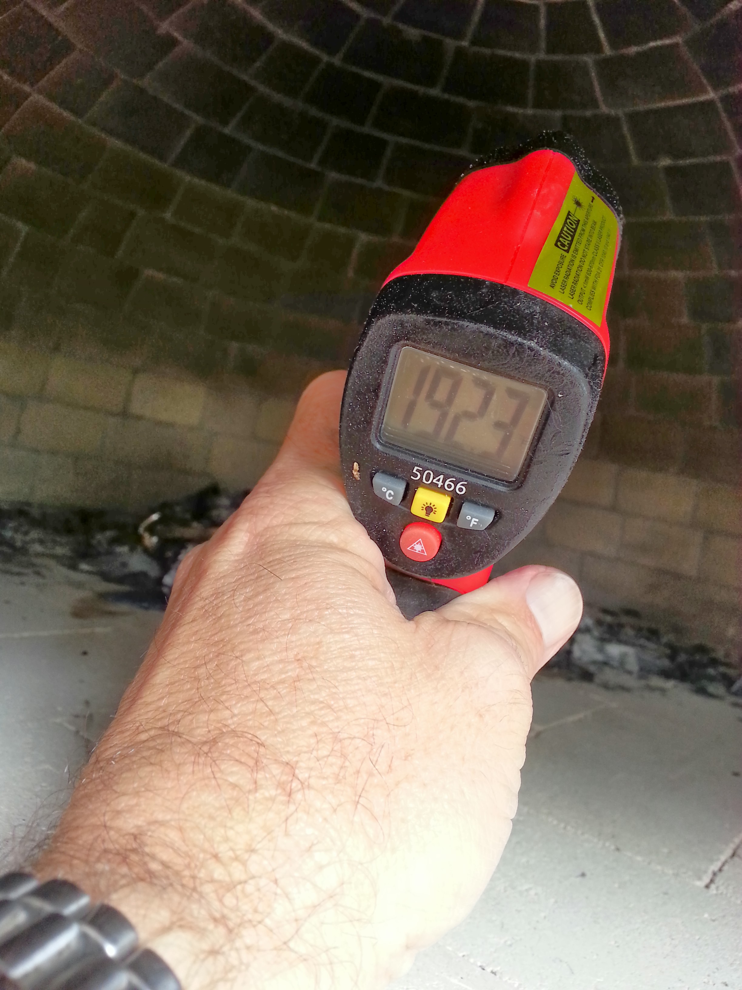

Ok,,,, I was reading the thread on oven curing and thought why am I sitting here??, lets knock the first one out! So I grabbed a couple of shoe boxes and a small piece of oak and an Aim-A-Flame!
Ive had a heat lamp in it for 3-4 days and the outside has been warm to the touch. I saw 300 briefly but 200 consistently for 15 minutes or so.
It's hard to tell how it draws, alot of smoke because Im burning cardboard. Seems like 70% goes up the stack and the rest out the front. If it comes down to it, I can grind out a little more of my opening.
LOTS of smoke! (I dont think my Owl is going to be happy up there)
6 PhotosLast edited by GarnerAC; 09-29-2013, 02:33 PM.
