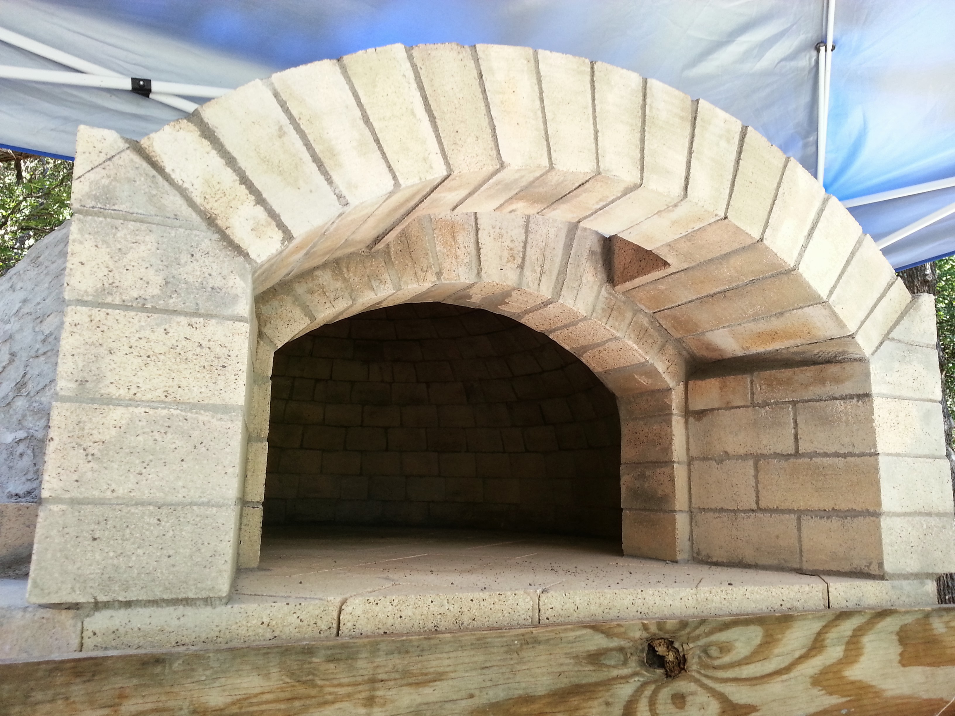

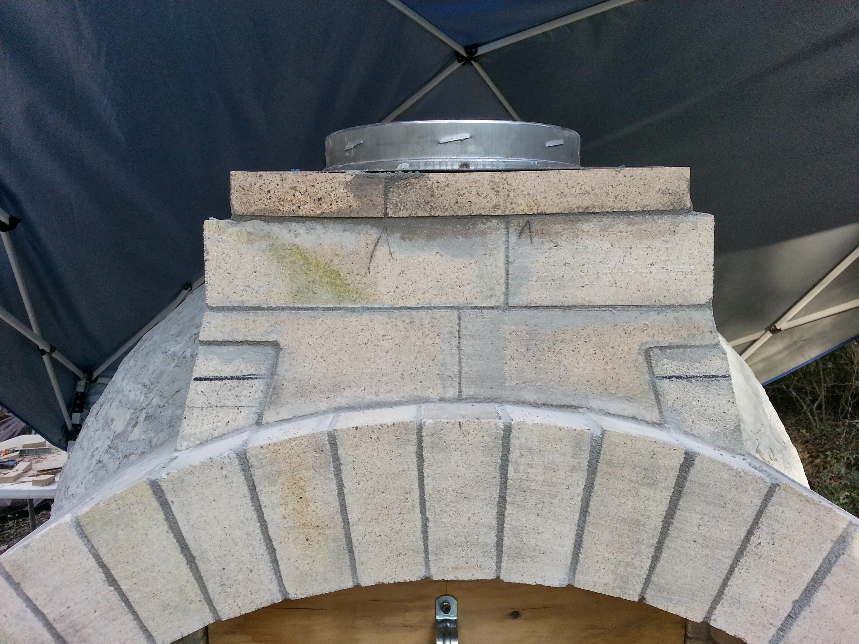

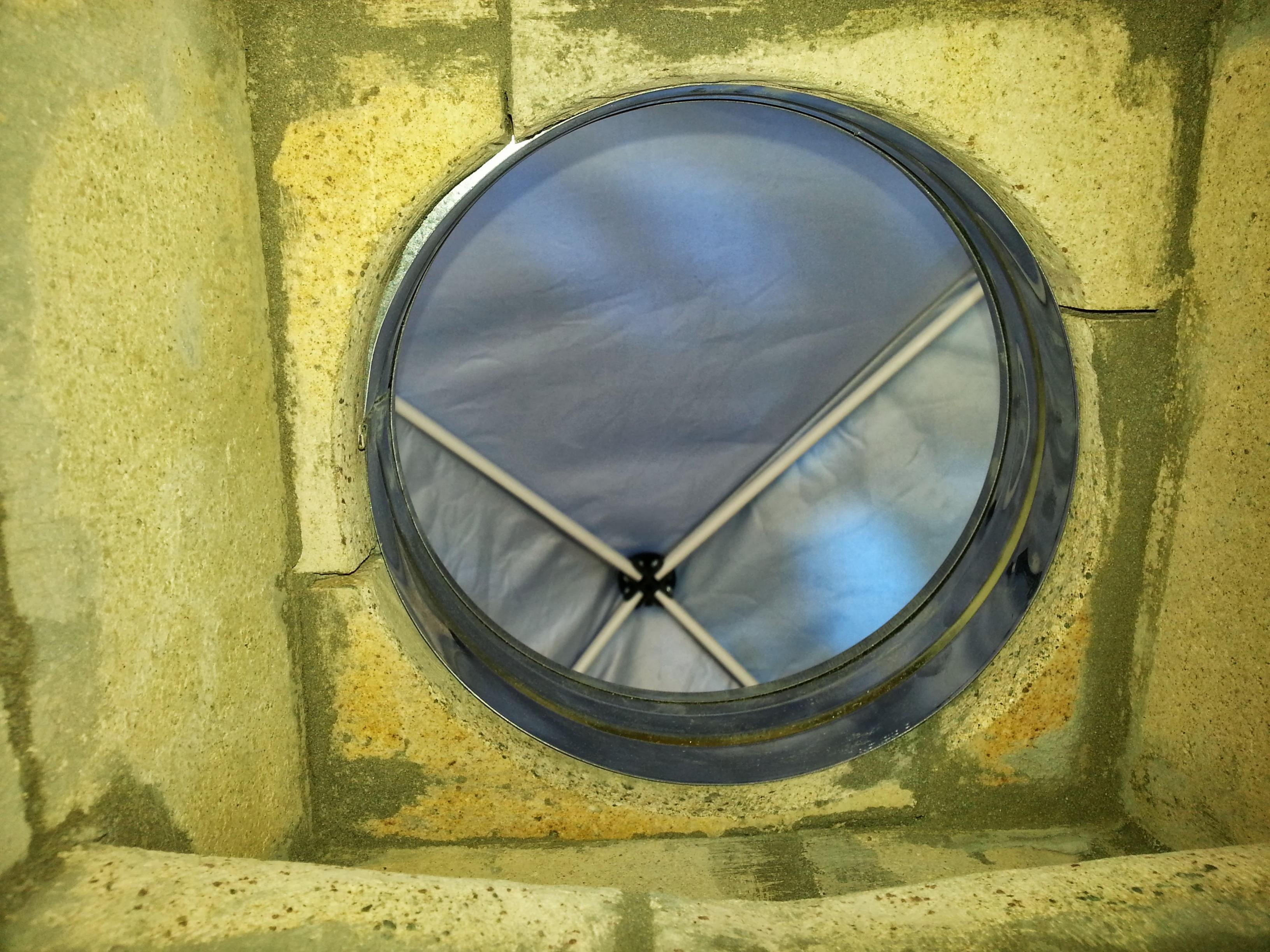

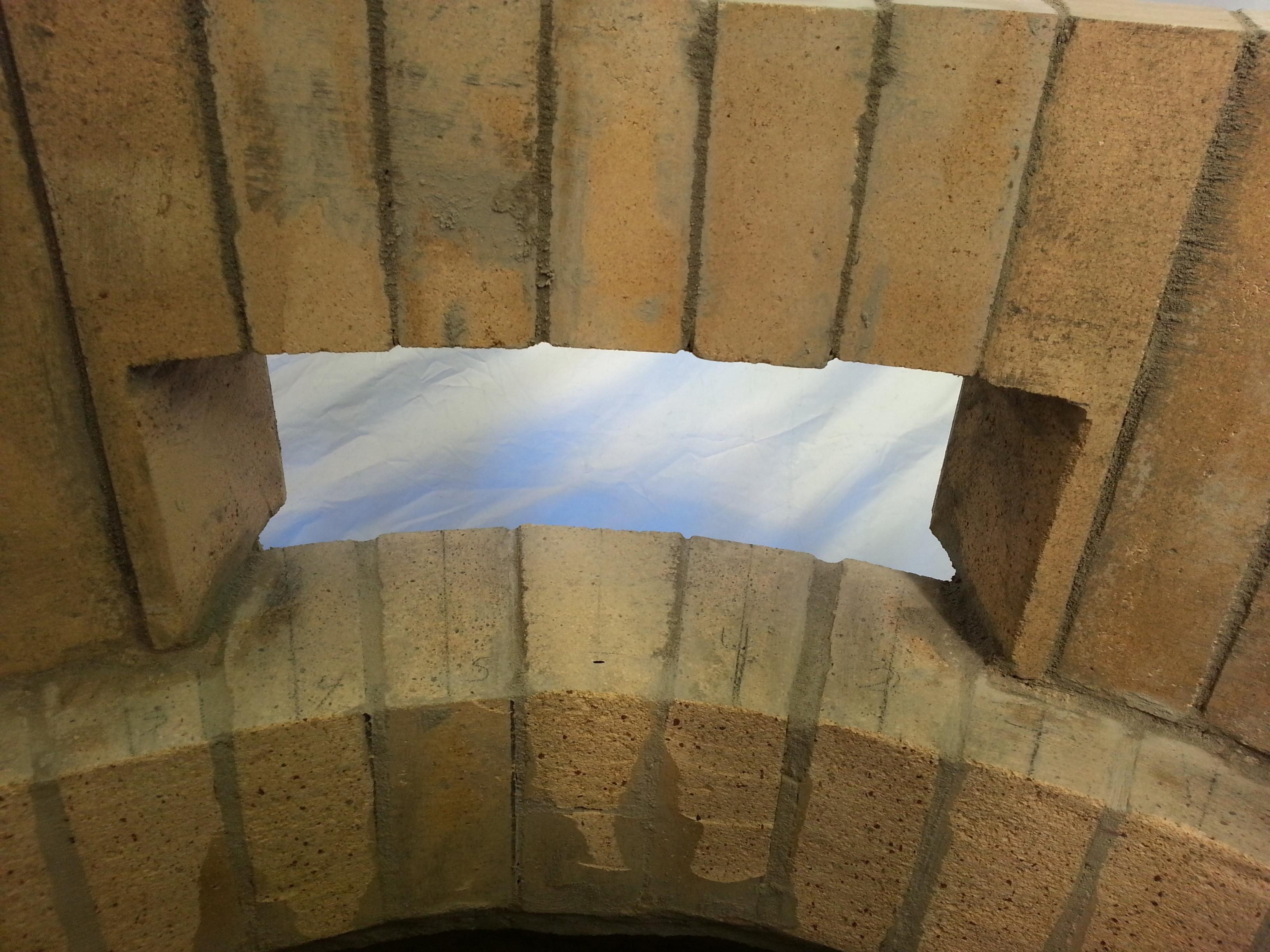

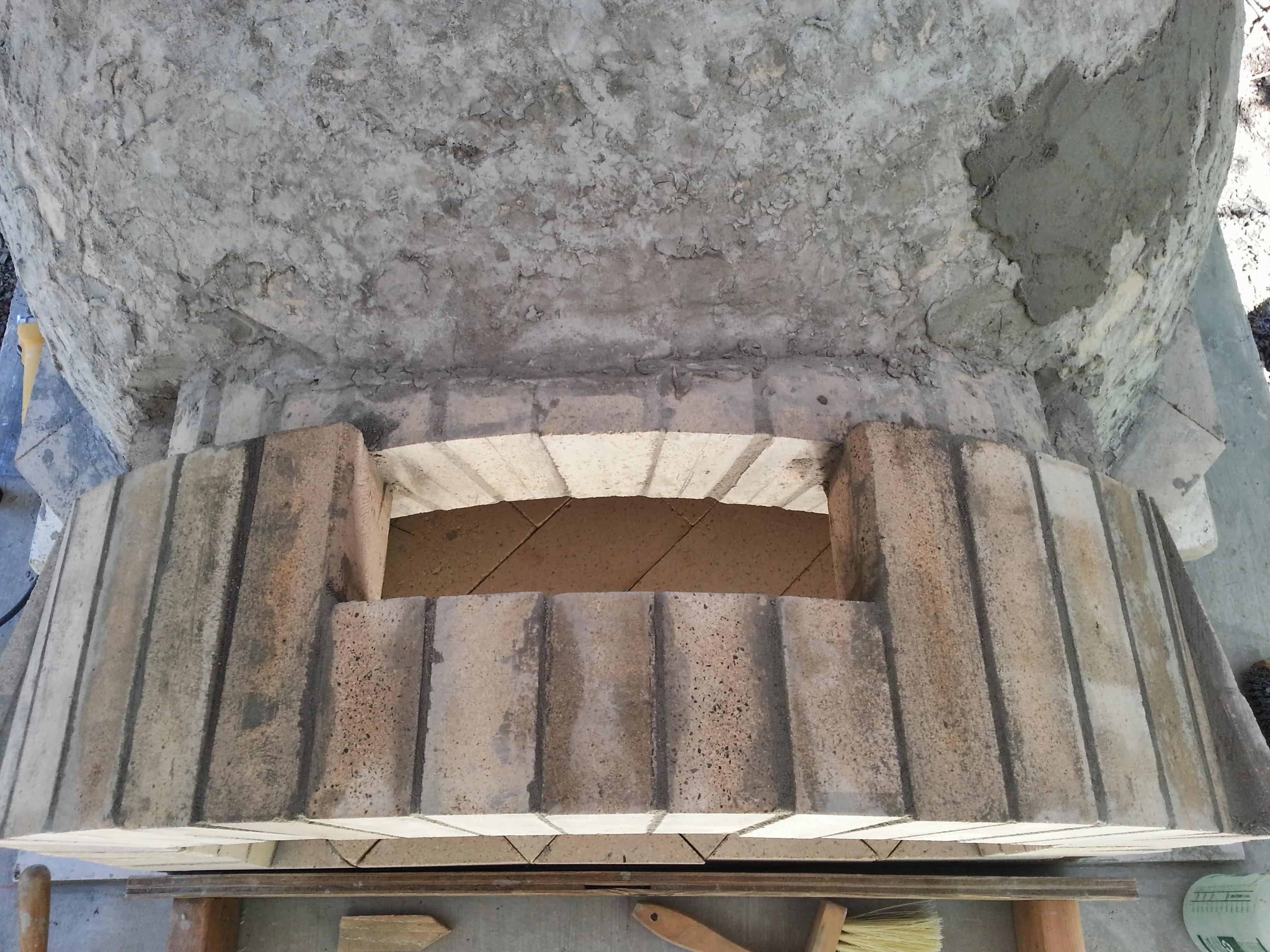

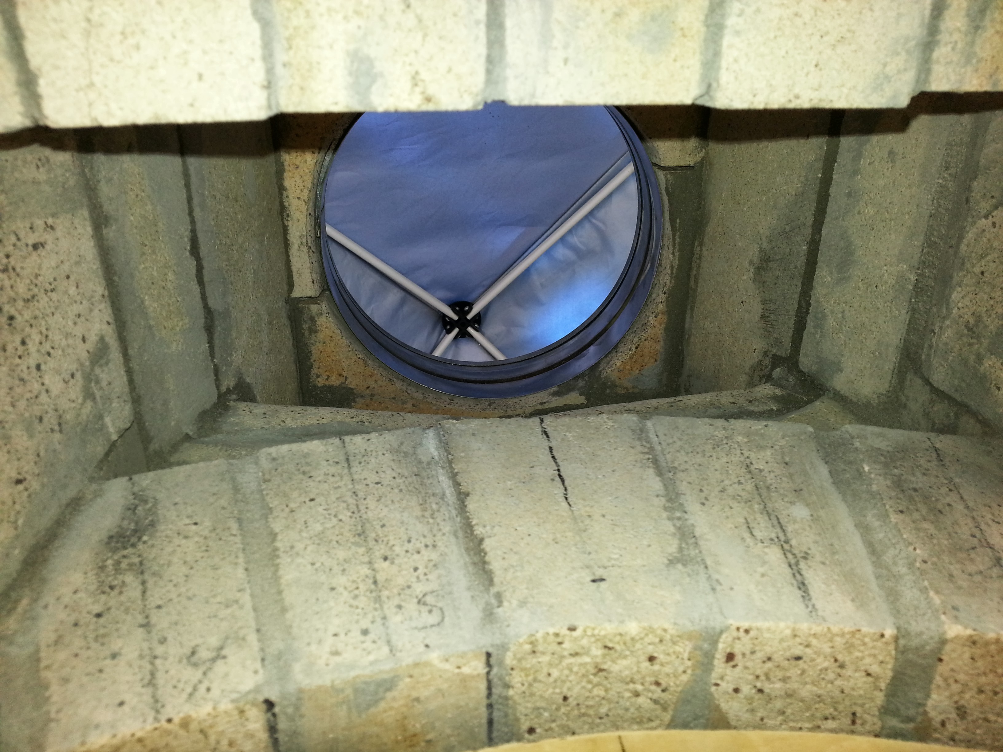

            Got the vent and outer arch up today. Feel pretty good about it.
            First off I want to say how much I like the Heat Stop 50 Mortar. I see photos of some of you guys having to support your dome bricks with all kinds of stilts and contraptions, waiting a long time before moving on. I never had to wait more that a few minutes before I could remove support or move on to the next brick. This stuff sets up quick if I mix it dry OR I can spray it down wetter if I want more slip.
            Anyway, just wanted to run a couple things by. Do you think this is enough vent area to draw up into my 8" SSDW pipe? Its 4.5" x 12" free and clear.
            Also I wish I had taken the outer arch apex a bit lower than I did, just for aesthetics. I wanted a reveal of course but I wanted to be able to get a door in and out without a struggle. See any issue here?

              That looks great. The flue should be plenty big. IIRC, the area of the 8" pipe is about 50" and your opening is 54" so it should flow just fine.

                It's good to hear some positive and detailed comments on how to work with heatstop mortar. I take inboard your comment on working times and the mist of water to give you slip.
                You can't go wrong with an 8 in chimney. These ovens breath quite well without, but adding a chimney saves on eyebrows so it must be big enough like yours to work at keeping the smoke and heat away

                  I have built four ovens using HS 50 and my current one and a bunch of historic beehive ovens with fire clay mortar. The heat stop does grab a bit faster, but it's pricey. I don't use forms for building the dome until the last 3 courses, then it is a quarter form that freely moves. If you don't saturate the brick, you won't have falling brick....even the fire clay mortar grabs very well.
                  As far as your vent opening, it should be fine, although I would have went a bit wider for a 42". And with your flared entry, you should have no problems removing or placing your door...you might want to make it a shade smaller ( 1/4") than your reveal so it doesn't catch.

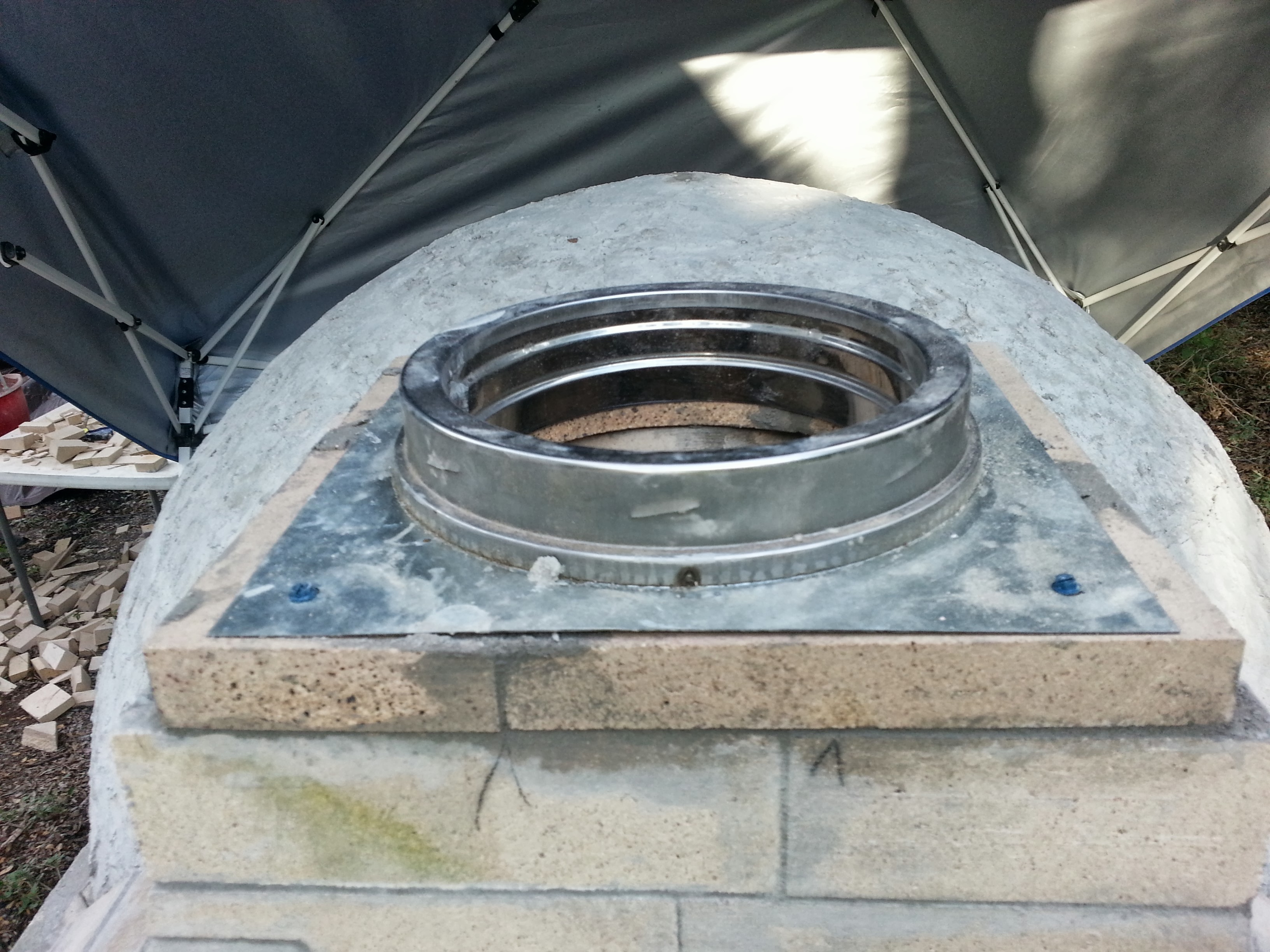

                          Got the vent completed this afternoon. I used Split bricks to finish up, very EZ to work with. Now that Im done with Firebrick I'll be moving on the Hearth to get it up to grade for Granite or whatever I come up with. Suggestions welcome.....
                          Then, I guess Insulation and structure.
