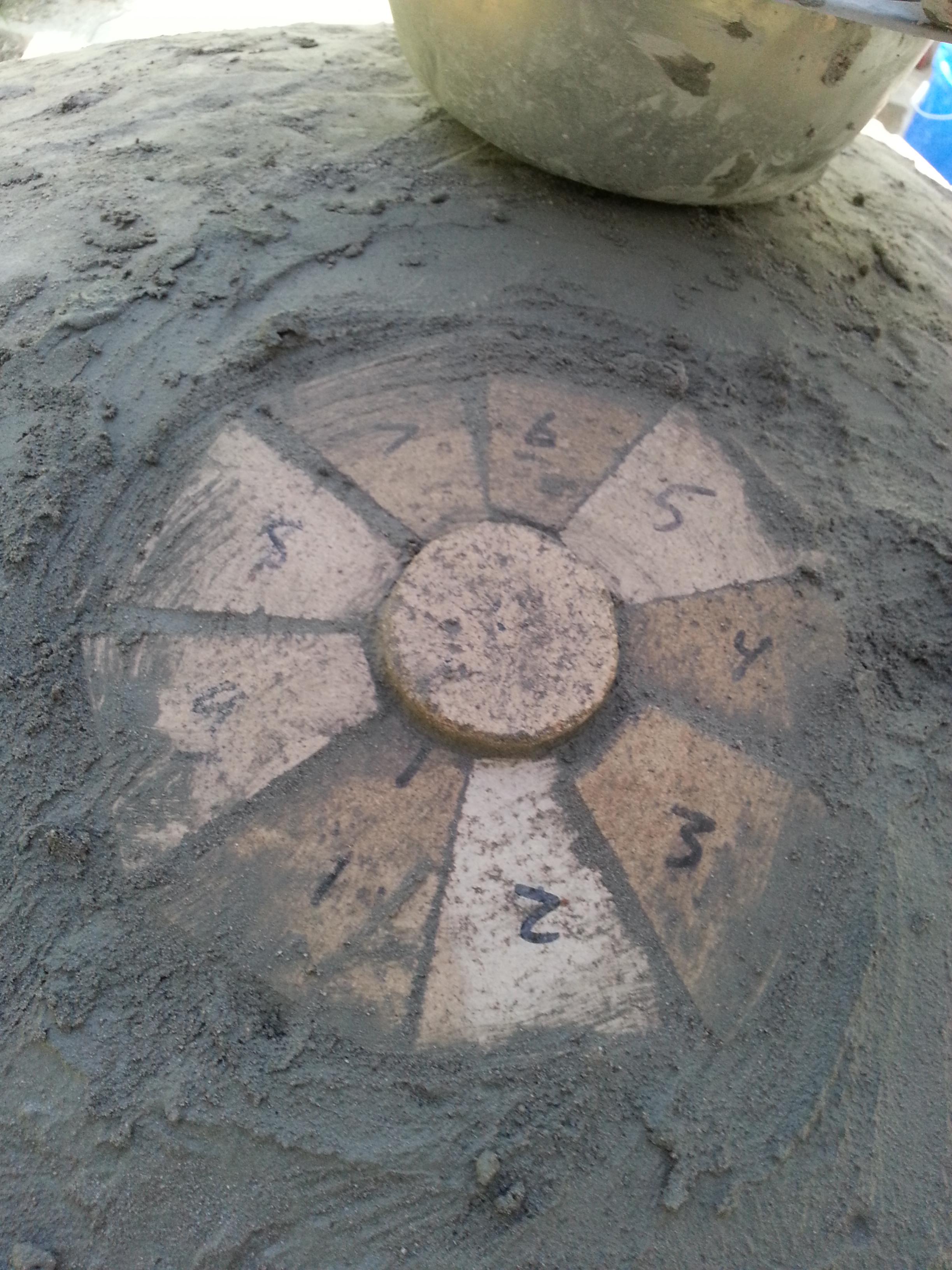

    More progress on the Dome. Im going to try to cork it today or tomorrow as I have Knee surgery on Wednesday. Should be an easy quick recovery and back at it.
    Gotta get 25 more bricks and a another bag of Heat Stop Mortar today.

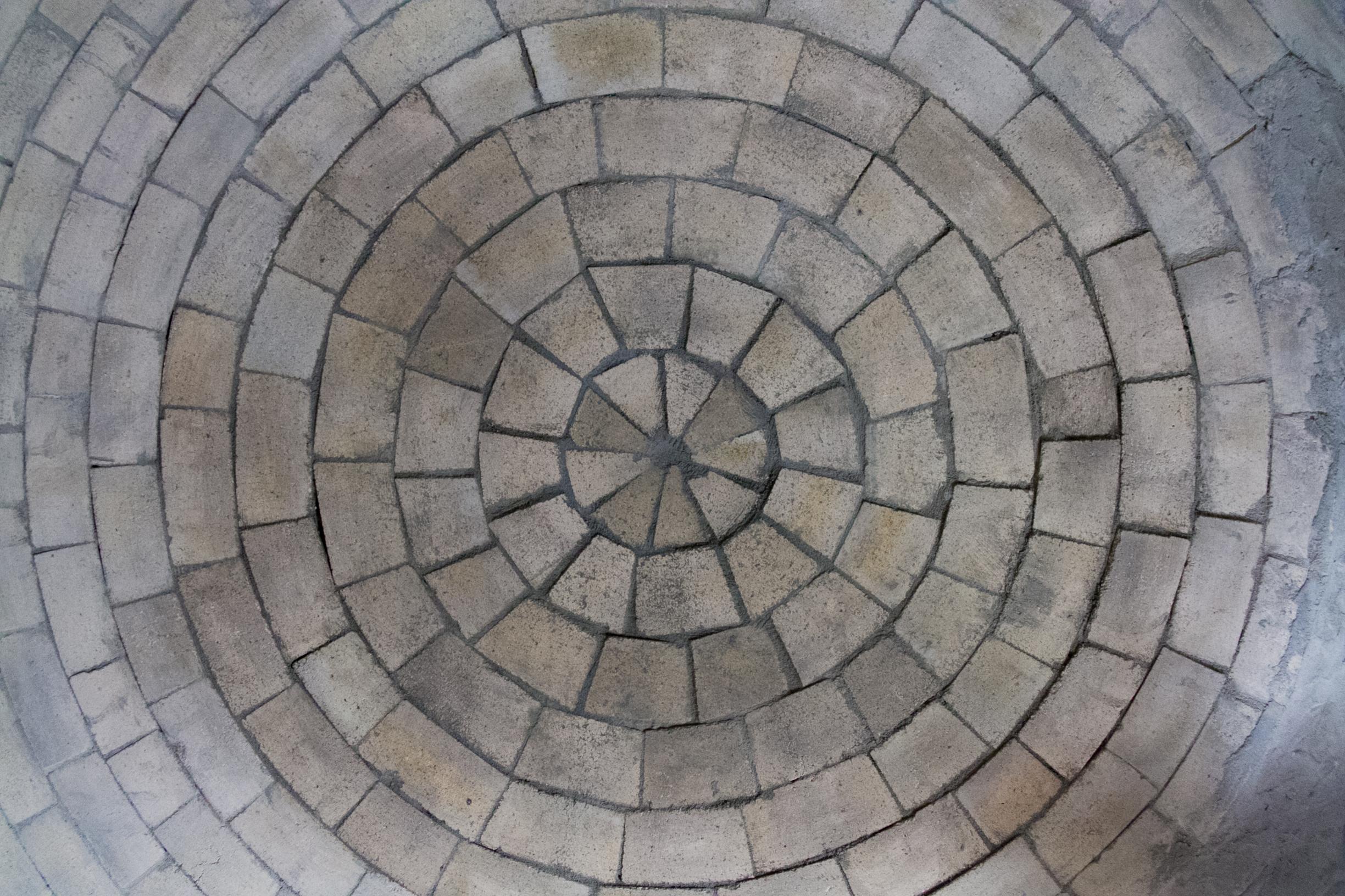

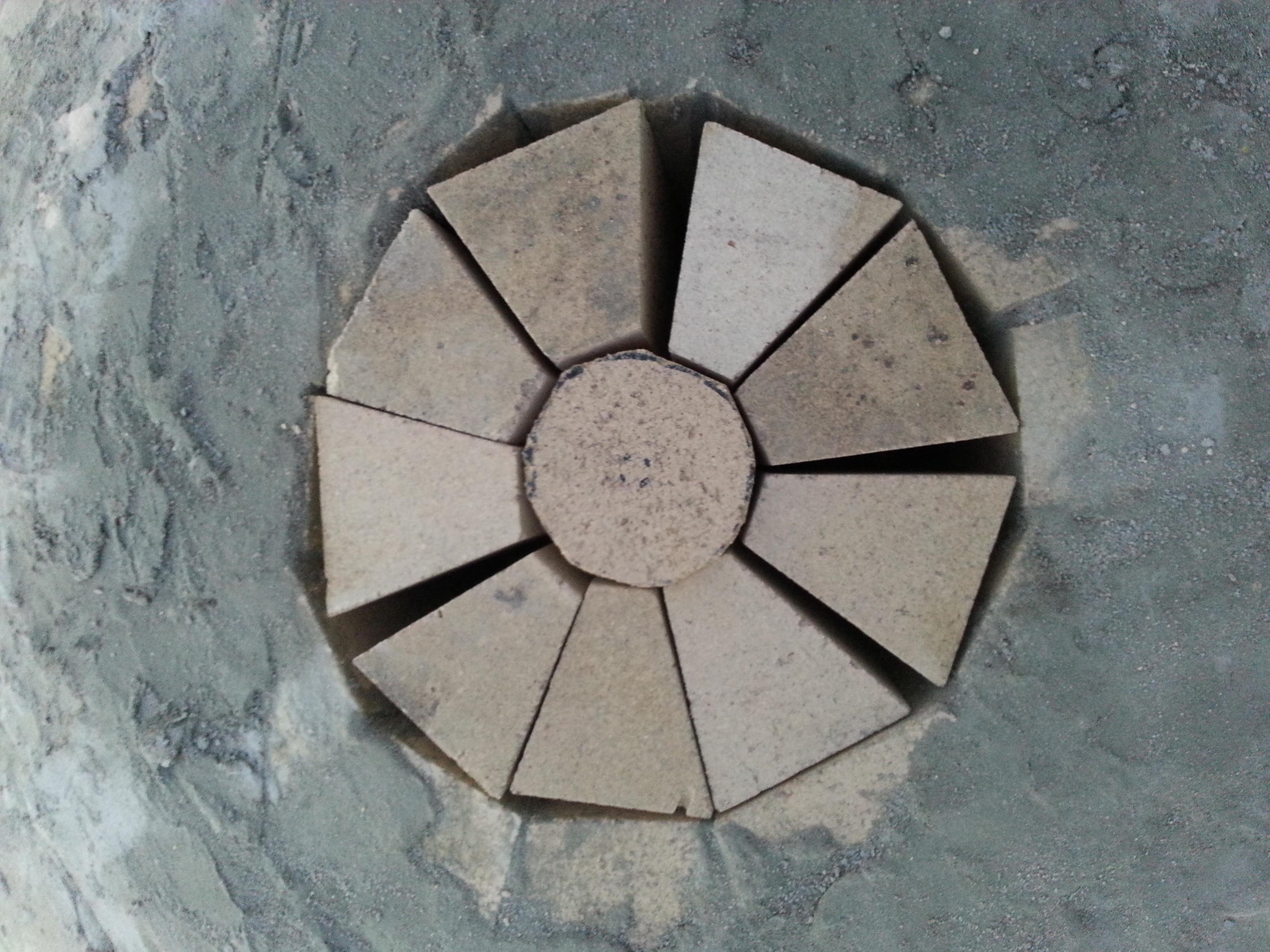

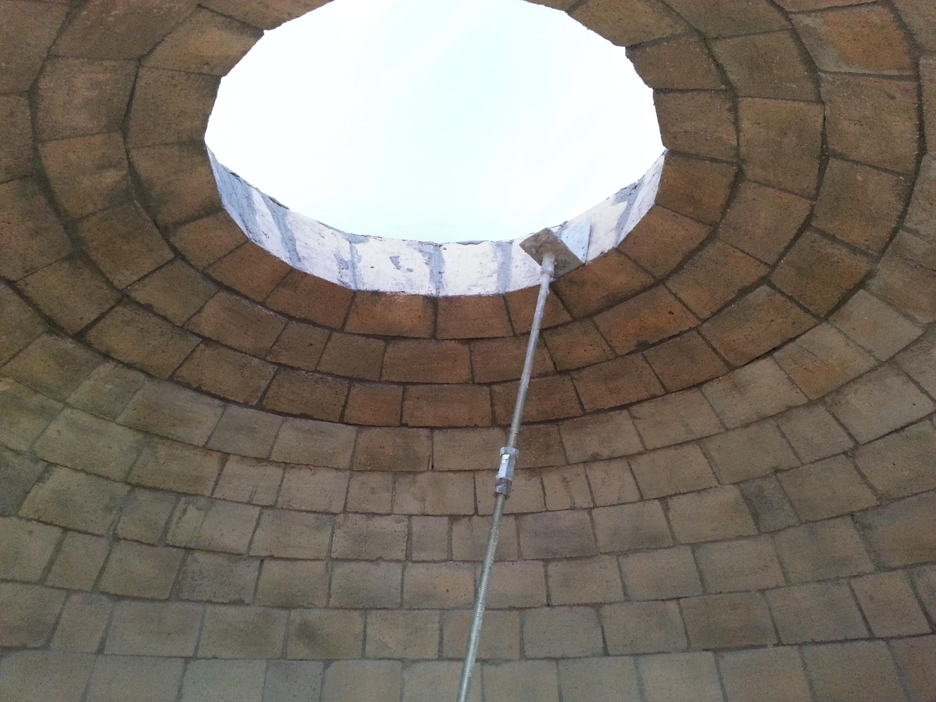

      • #48

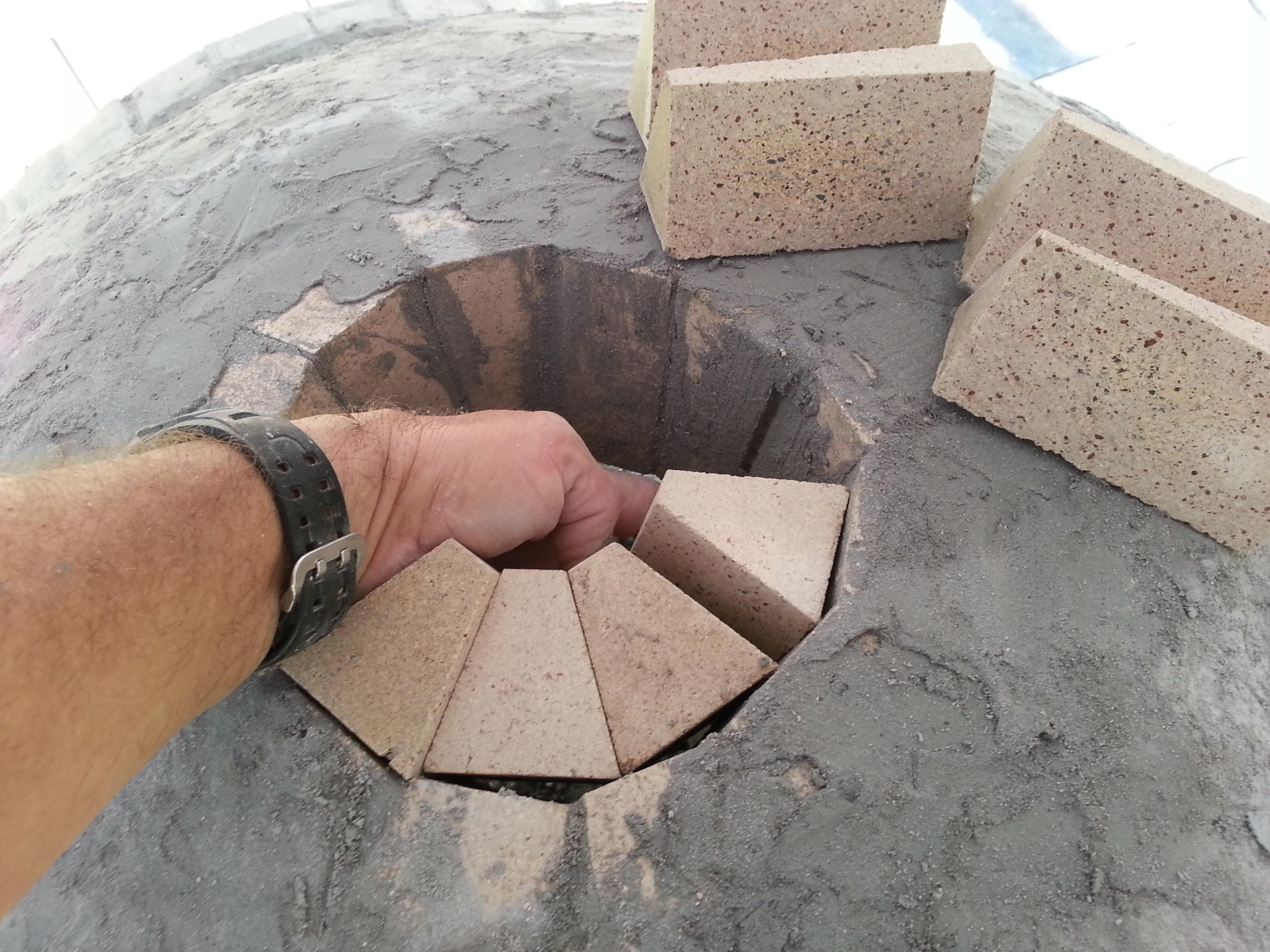

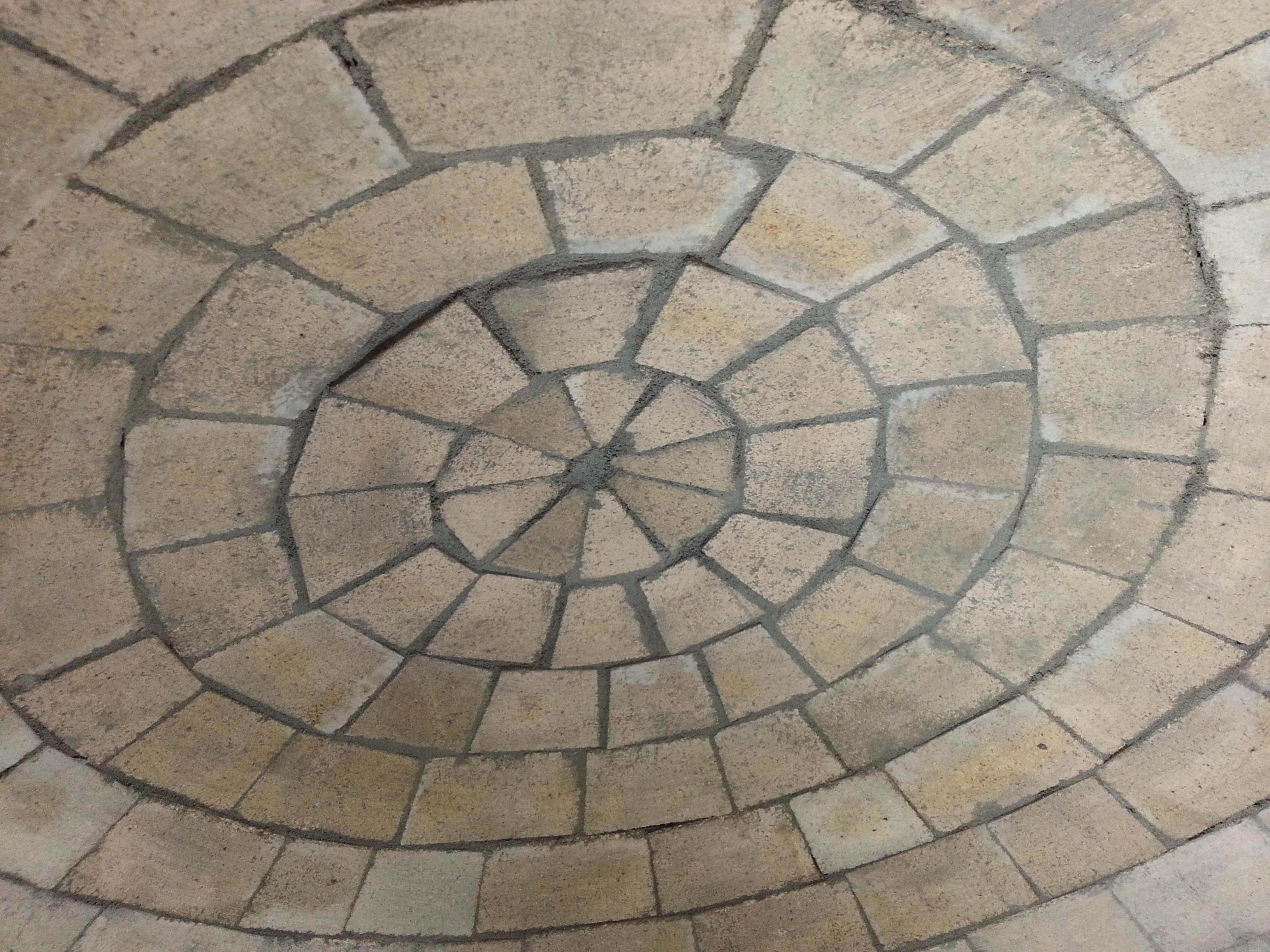

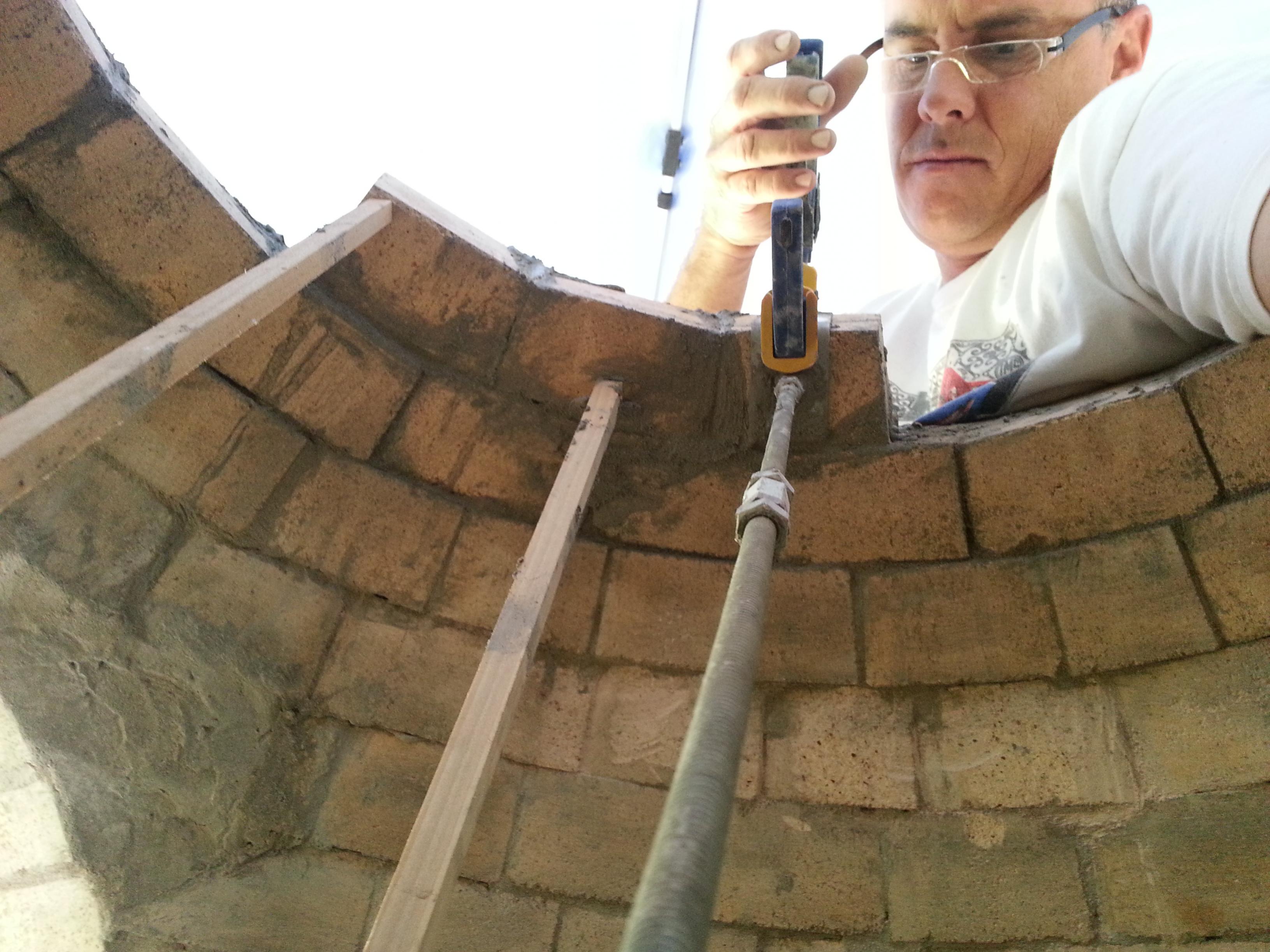

        Finished the Dome today. Had to buy a few more bricks from MPI. Looks like about 250 is what I will end up using. Still have front arch and vent to do. Not happy about a few joints lining up but I just could'nt see after all of the mortar on the small pieces. Keystone took a while to get a good fit. It didnt drop in as far as I hoped but was a good tight fit. It was a good feeling dropping in that last course and key!

        • #49
          Well done. You really put it together fast. Love those shots of the inside of the dome and the arch transition. You'll be glad you took those pictures now because it'll never look like that again (at least while you can put your head or camera inside...too bloody hot). Congratulations.

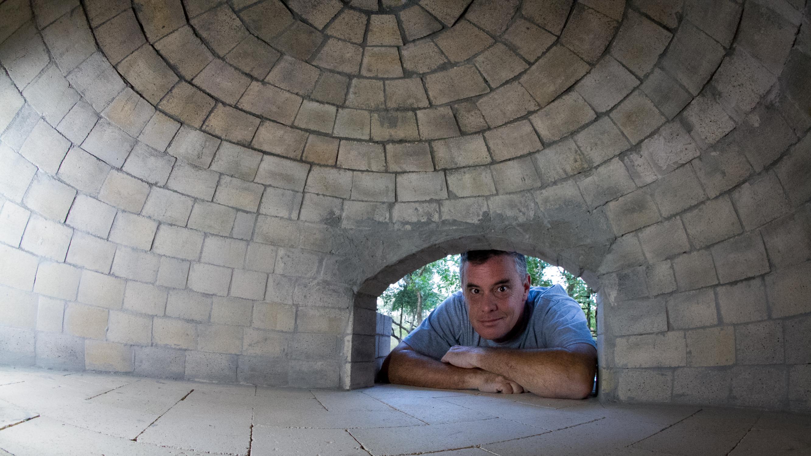

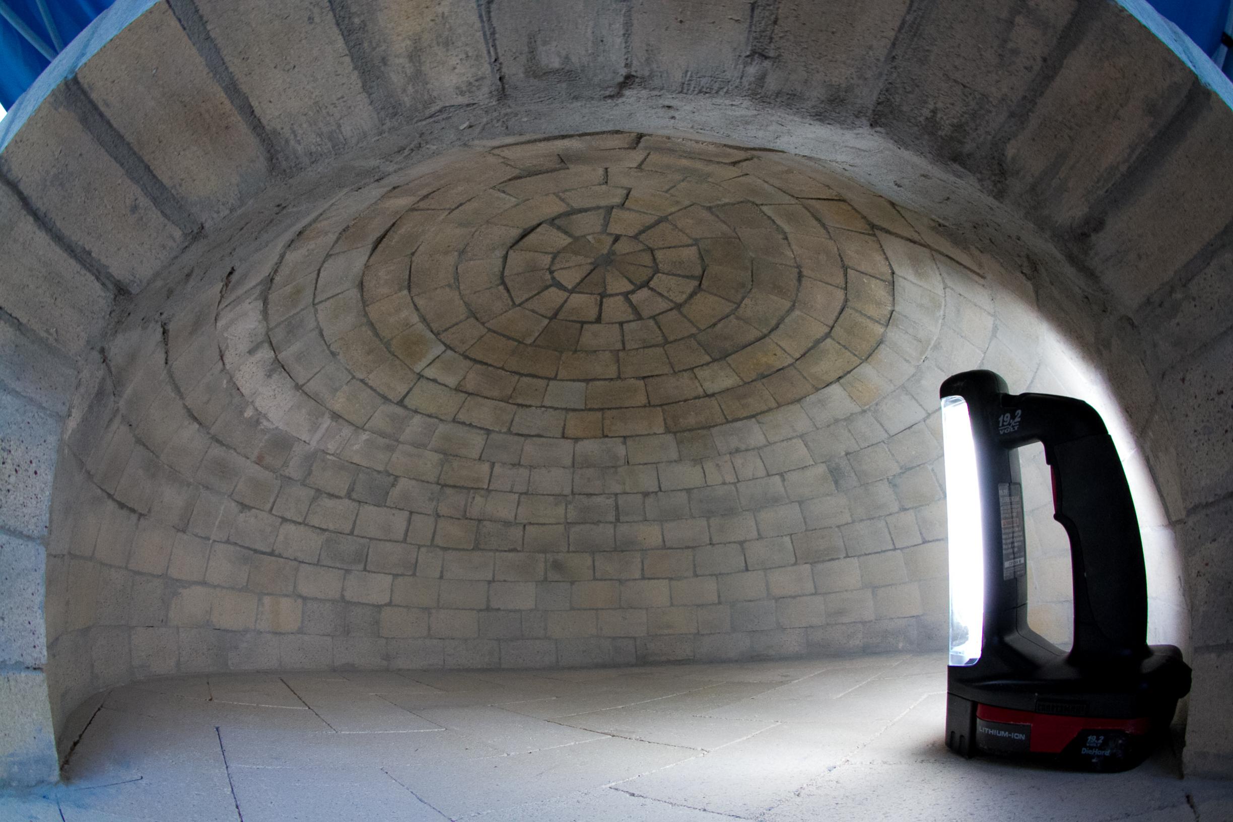

            Broke out the big camera and fisheye lens this AM!

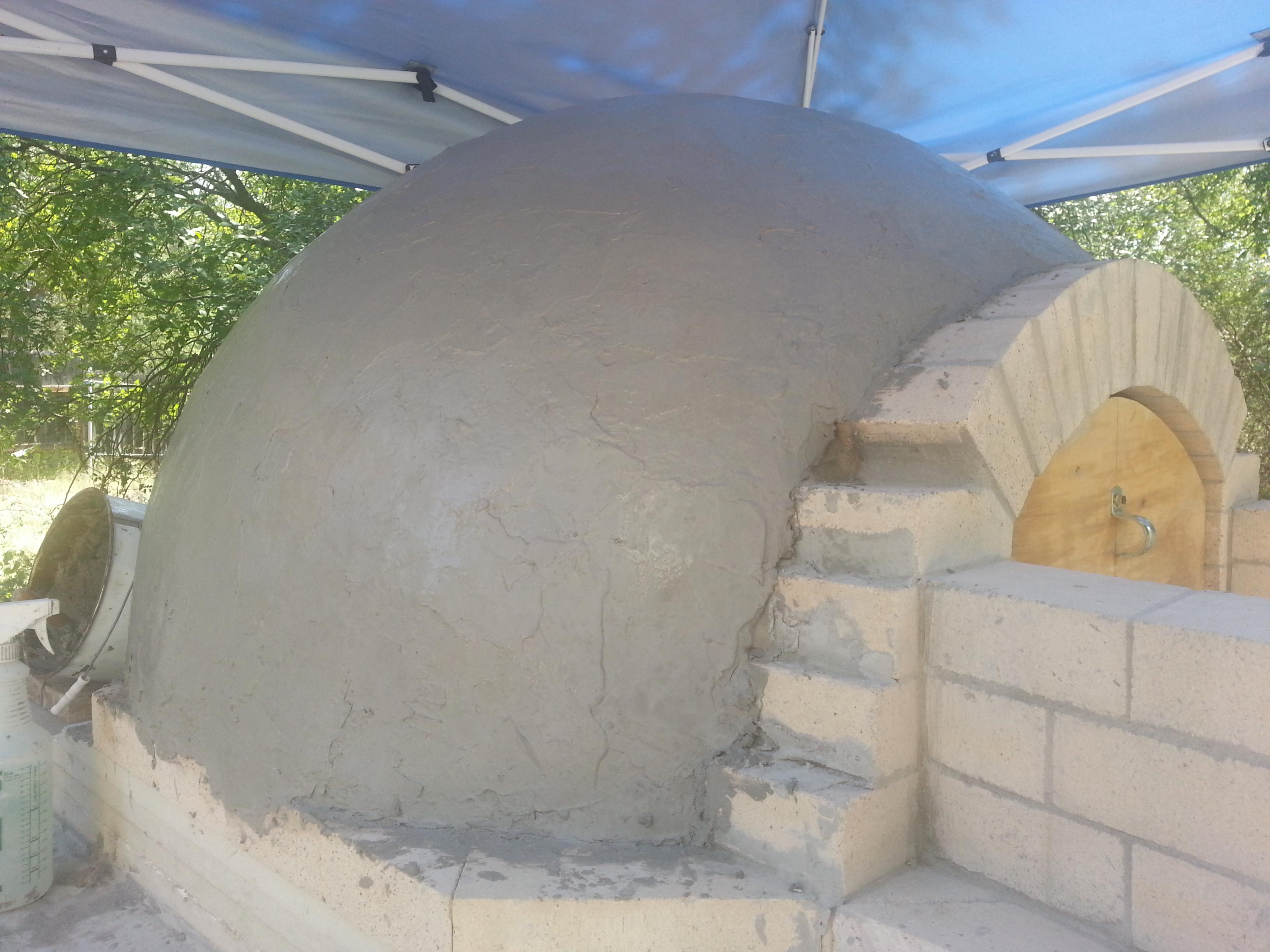

              • #52

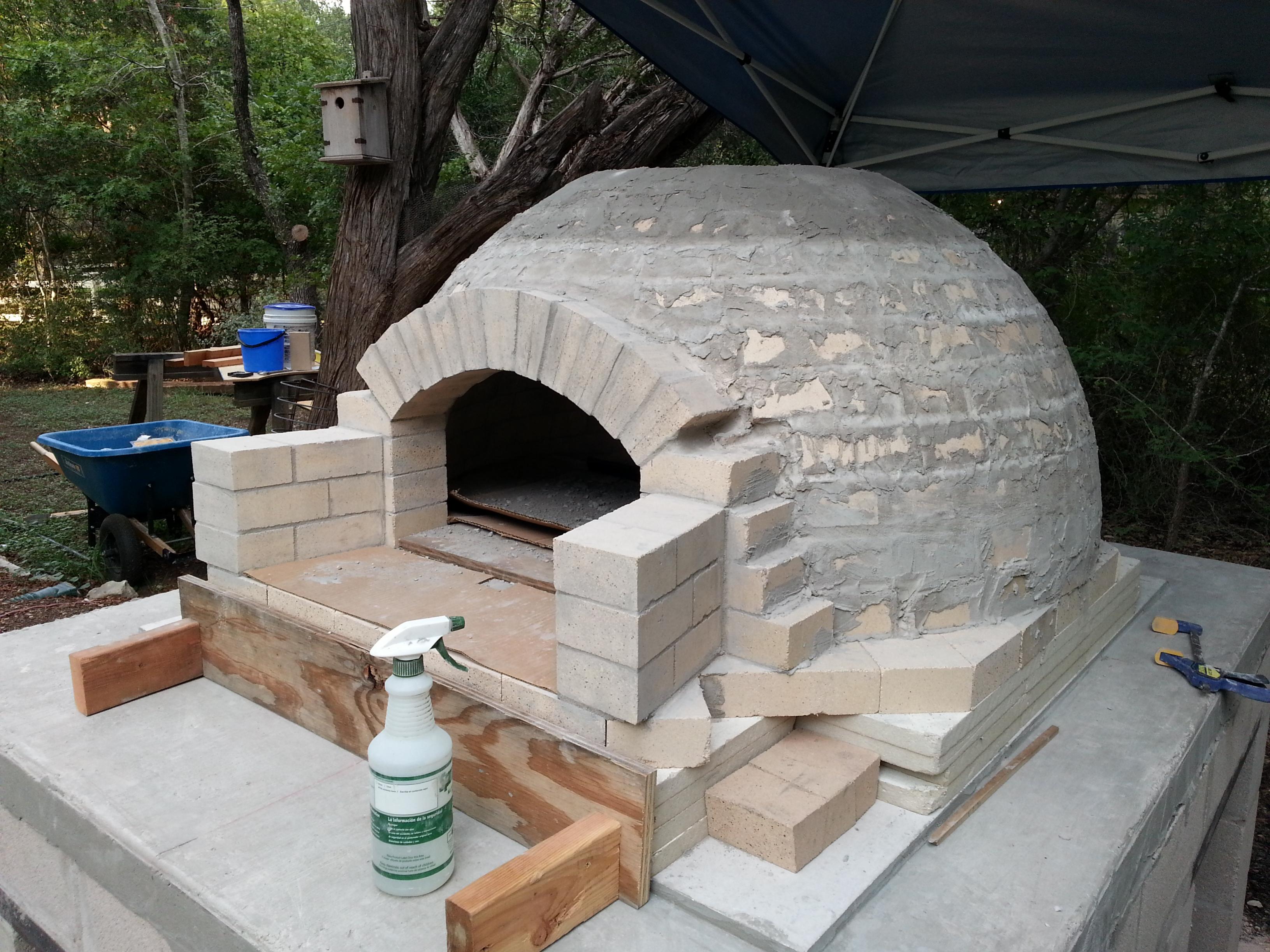

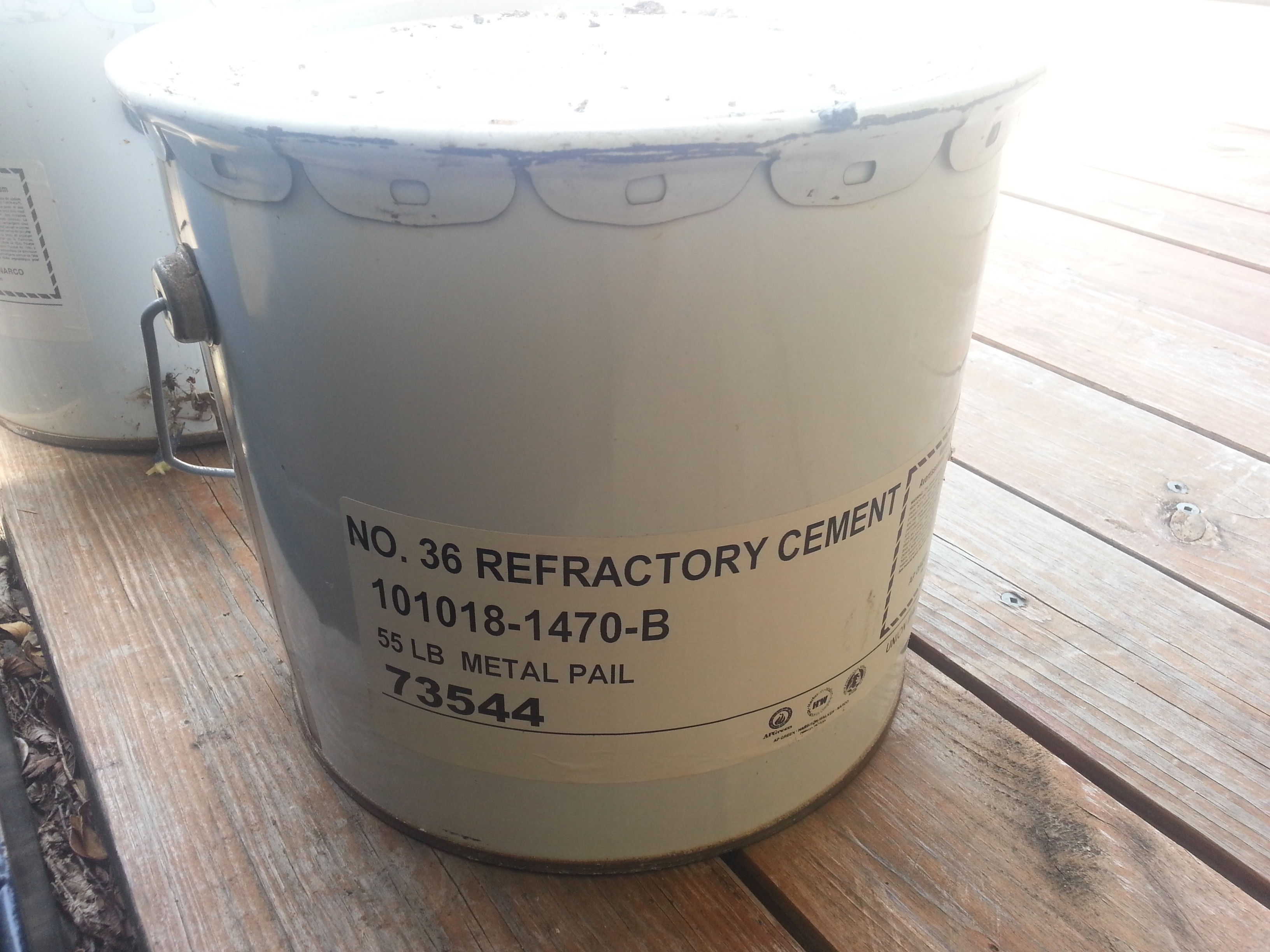

                Thanks KB, I m not even thinking about fire at this point. The second arch with the Flare is looming and I am having Arthroscopic Knee surgery next week, followed by trip to the Netherlands a couple weeks after that. Things may slow a bit here. I do tend to obsess on a project and drop everything else around me. I have done that here .
                This morning I covered the outside with a premixed refractory cement to clean up the outside of the dome. Its called #36 Refractory Cement. (Tscar said I could) This stuff was a pain, very thick and dense. 3 hrs later it was done. trying to keep it damp in 100 temps.....

                    They're always there...sitting....waiting....watching...knowing.. .
                    Like the shot looking back at you, but why go to all the trouble of knocking the bricks out at the back of the oven just for a photo after all that hard work! tsk..tsk...
