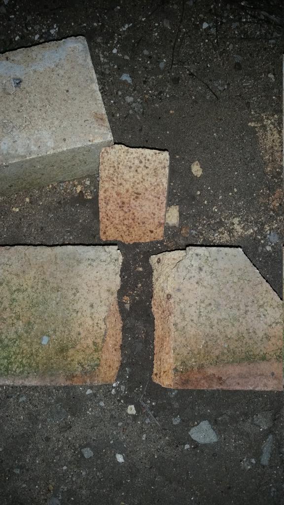

        I borrowed a brick bolster and using a 3lb sledge hammer I was able to easily break both an old firebrick and veneer bricks with one blow after scoring the brick. The one firebrick will need cleaning up but seems fairly straightforward

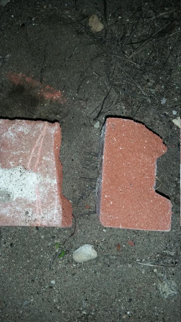

          Attached is the clay veneer brick

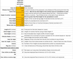

            Re: New 32" build in Saskatchewan, Canada
            Questions regarding dome height and door height. I've been pluging numbers into the dome calculator spreadsheet and I get a different dome height based on how high above the floor my IT sits. I haven't built it yet but my dome height comes out to 18 inches and the door height is 11.3 inches according to the spreadsheet...
            How wide should I make the door? Was thinking 16 inches, as I believe it needs to be 50% of the oven width, but wanted to ask on here first before completing my floor drawing and laying the floor bricks

                I have no idea why the calculation on that spreadsheet came out to 18". I'd prefer it to be 16 maybe I'll have to play around with the nunbers.

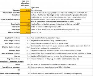

                  #23
                  Here's the results I get from the Pompeii dome calculator(see attachments). I would like my dome to be 16" in height but in order to do that I'd have to make my IT flush with the floor? Or do I make my IT 16" long and then make it shorter as I go up?
                  I think once I get this going I am good to go.
Name:	IT flush with oven floor..jpg
Name:	IT 2inches above floor.jpg

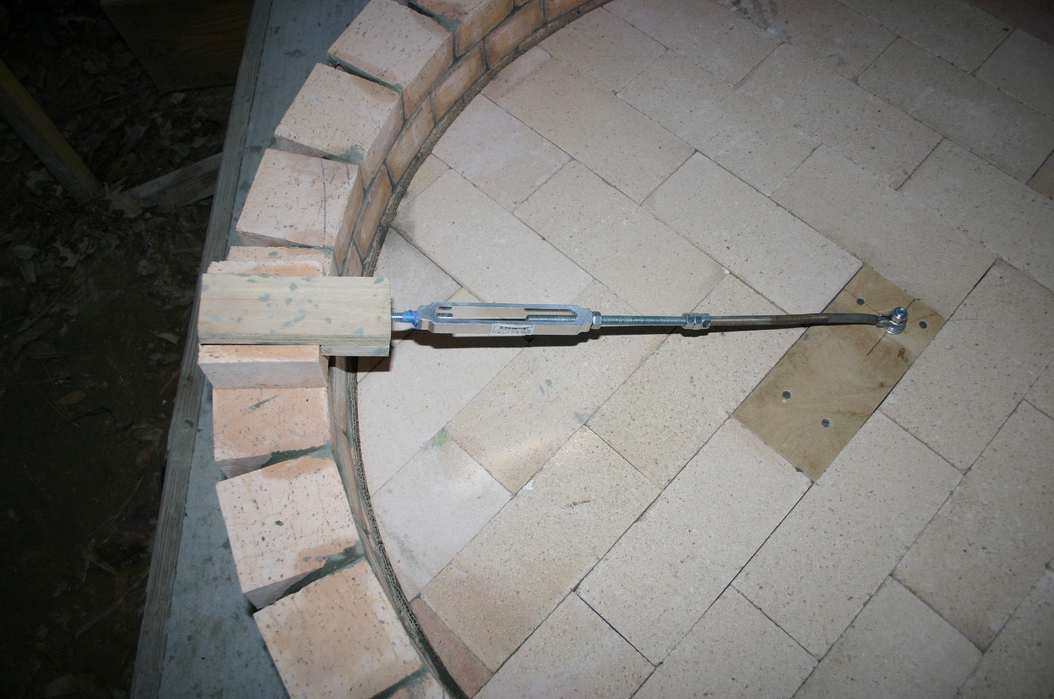

                    I don't think that the 18" height is going to hurt the oven's overall performance. But, I'm not real big into pizza.
                    I placed my IT flush with the floor by removing the dead center floor brick and replacing it with an exact sized wooden block. It also made a much more stable base for the IT than the wobbly the as plywood base I had made origionally. I just used the cardboard box from my HF saw to protect the floor .

                      Thanks. I really like the IT you built there. I was going to use a swivel Castor but I think that I'll use your method instead.
