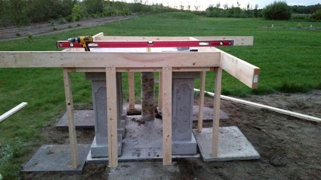

        Tonight I got the form almost completed. I just need to add a couple more support legs and put gussets on the legs and the 2x6 material I am using to frame the concrete.
        Hopefully I'll finish that and the rebar tomorrow night. I also plan on putting vapor barrier over top the existing slab to keep it separate from the new one.

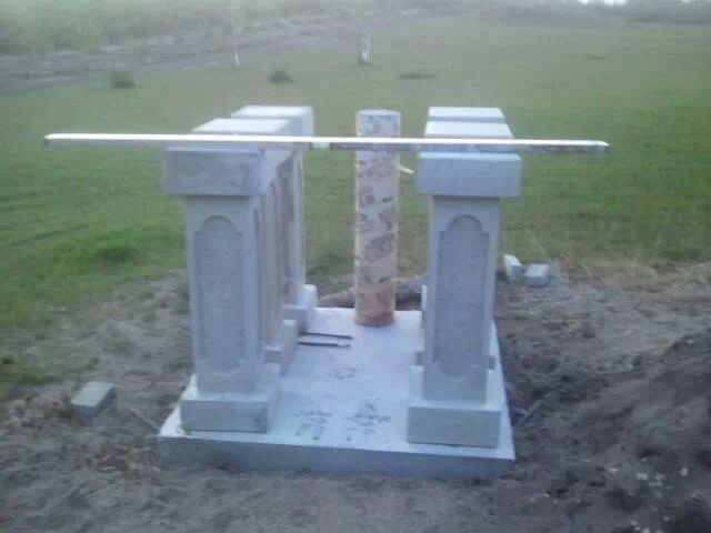

        The one was an older picture of my foundation plus the pillars I and using for my oven. I have since straightened them out and I had to use concrete epoxy to keep them in place as I could move them when I moved the top slab.

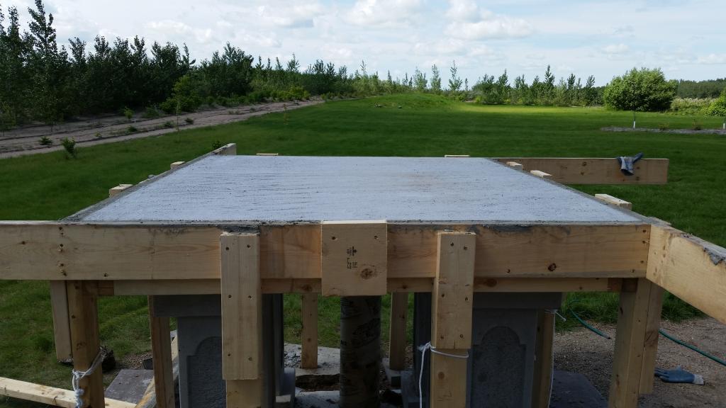

                  I beat the rain today and got my hearth slab poured. It's nicely covered with plywood with a tarp on top. I'm hoping to start my floor soon in the garage while it cures and hopefully will get to start building the dome the last week in July. We've been getting quite a bit of rain lately so hopefully it will stop by time I'm ready to build.

                    The rain finally stopped here and I got to take a look at my slab. We didn't trowel it since will be all covered but everything seems to be level which I'm happy about. I put the tarp back on a put a bit of water on top of the concrete
