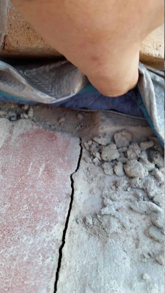

      I fired up the oven yesterday and noticed some smoke not from the chimney and discovered that I had a large crack where my arch meets the arch supports. It's too cold to fix this now as we keep getting freezing temps. Should I stop using it until I can fix it? Anything else I should do until it warms up enough to fix?

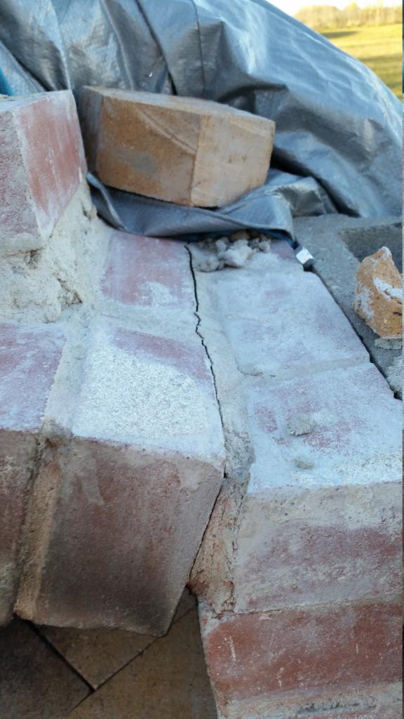

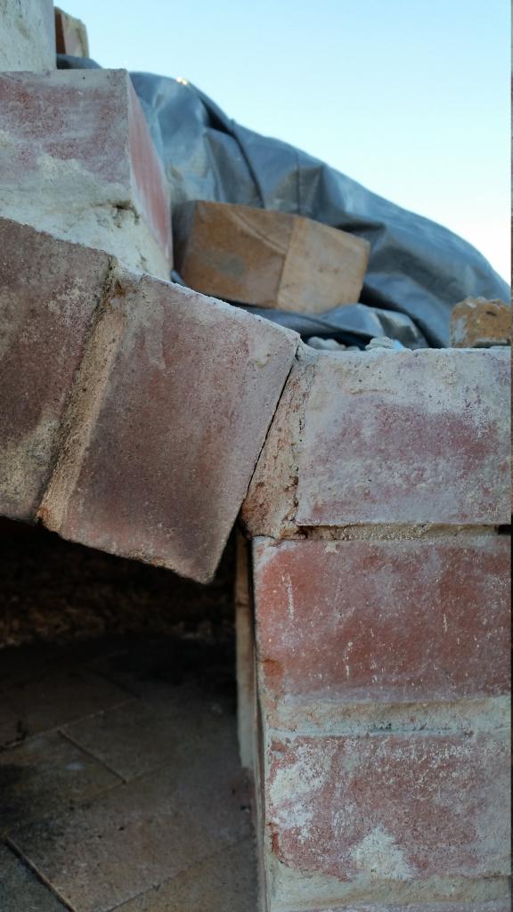

        Here's a few more pictures in day light of the crack on my arch
