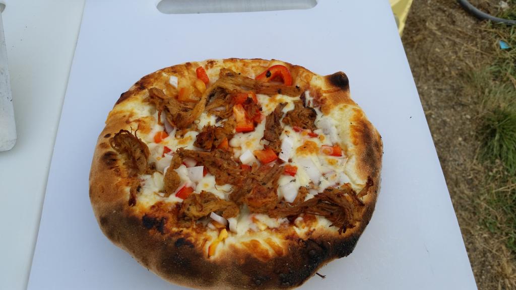

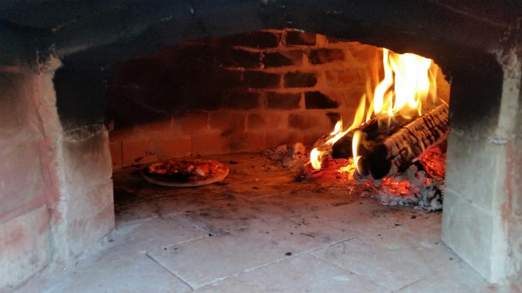

                                I made my first pizza's on Sunday. I didn't have the oven going full blast so the pizza's took a few minutes to cook. I usually make my dough a day ahead of time and put int the fridge overnight and take the dough out a couple of hours beforehand, but I made these in the morning so my crust rose quite a bit more than usual and wasn't as easy to work with, but still turned out pretty good.
