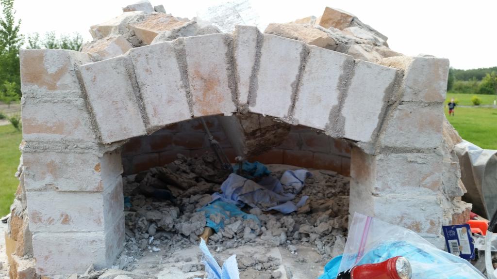

    Last night I took off the arch form and was happy that it didn't collapse

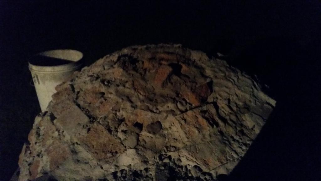

            Tonight I managed to get the dome closed. Not the prettiest build but it should work. Looks rustic lol... Next is finishing the floor of my entrance then onto coating the dome with mortar.
            Picture was taken in the dark. I'll get an inside of the dome picture when it's light out.

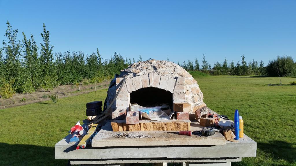

              Here's a better picture of the outside

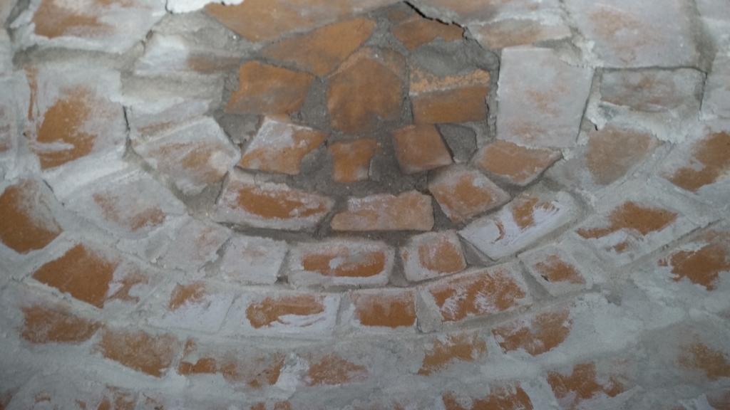

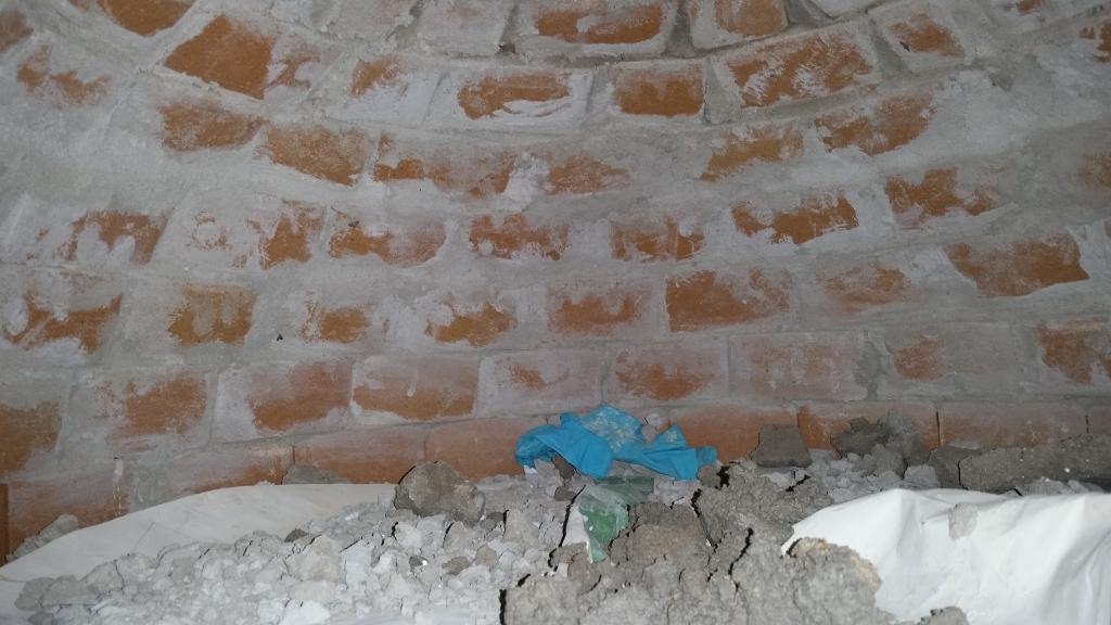

              Here's some quick ones I took of the inside. I had to free hand the top and it shows. In the larger mortar gaps I have some pieces of firebrick burried in the mortar. The plug had to be hammered in with a board and a 3lb sledge.

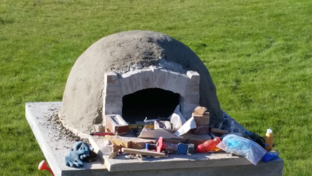

              I also got the outside coat of mortar in place and entrance floor is done. I've started my arch forms and will begin working on the entrance whenever time permits

                    Was checking out my coat of mortar on the outside. Is it normal to have hairline cracks in the mortar while it's drying? We've had some rain so I've kept it covered with a tarp.
                      #85
                      Re: New 32" build in Saskatchewan, Canada
                      G'day
                      Don't worry its just some cracks in the sparging layer once that's insulated you'll stop worrying. It will not harm anything. Great progress by the way!!!
                      Regards Dave
                      • NCMan
                        • Jan 2014
                        • 846
                        #86
                        Those are probably shrinkage cracks. Usually caused by the mortar drying out too quickly. If the surface was dry and/or you put it on too thick or too wet, it can do that. Usually not much to worry about, as long as they will be covered up from the weather later on.
