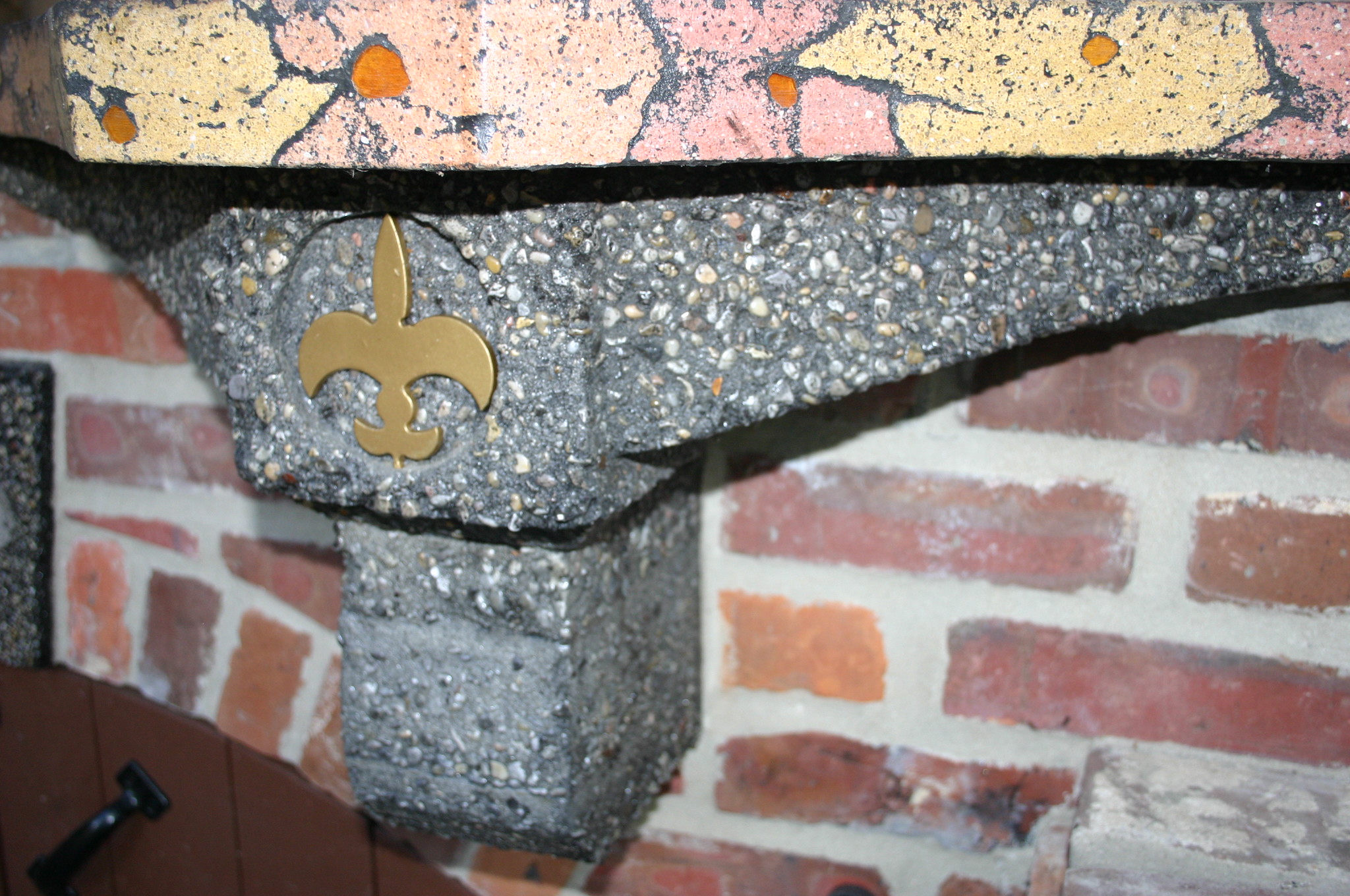

                    I did something a little similar on some corbels and a decorative keystone. I did not fill the voids. I did like the weatherd look, but I did not like the final color. I thinned some liquid charcaol cement color and brushed it in to add a little more color. I wiped it back down with a wet cloth to clean the aggregate. Later, I sealed it all with a flat acrylic masonry sealer.
Name:	Exposed Aggregate 001.JPG
