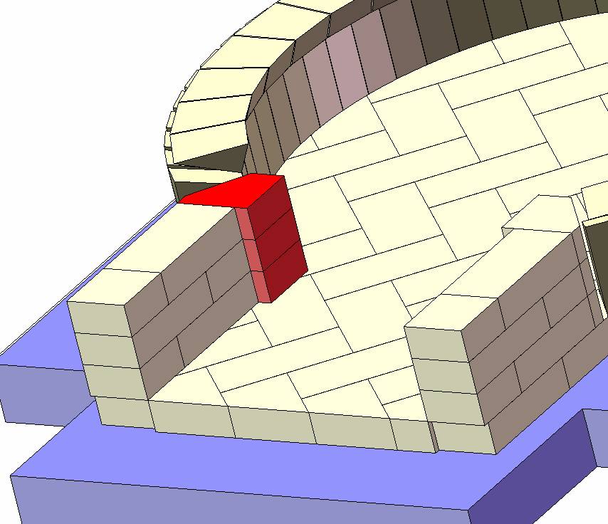

      Today i made some thoughts to start build the first arc and first row of the dome.
      I need your advise on this.
      On the second picture,which is the ideal method to close the dome with the arc?
      • deejayoh
        • Jul 2010
        • 1893
        #198
        Check out the pictures linked in this post, and look up Gianni's Octoforno build. This approach will save you much grief in the build. good luck!

          Thanks deejoyh,finally i did as pizza bob's idea. https://community.fornobravo.com/fil...photoid=275921

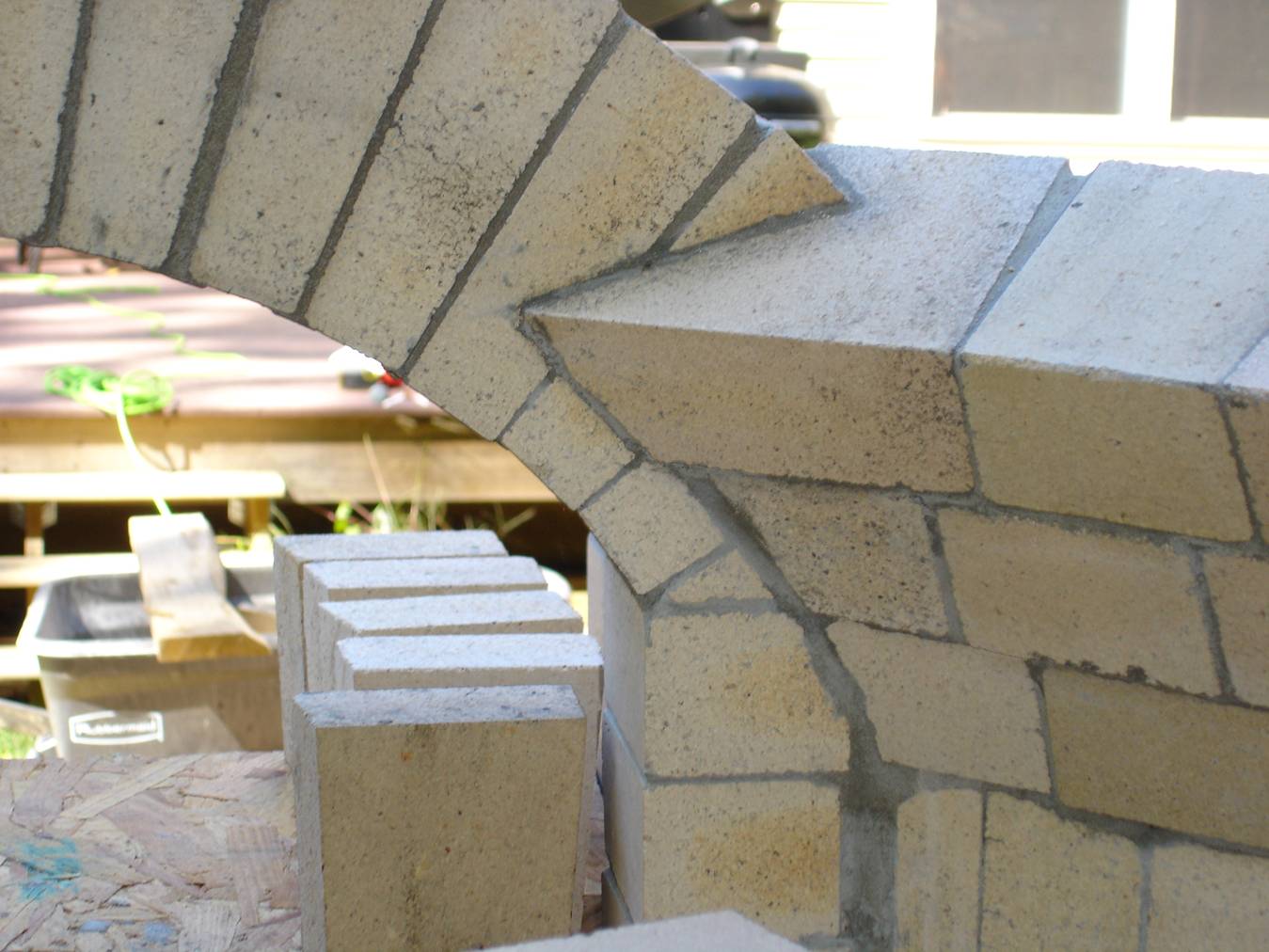

                      George,
                      You are doing a great job keeping the oven course staggered. Impressed you are just using a string for guidance, just goes to show ya simple can work just as well. Have you given thought of doing a tapered inner arch for you oven? Attached is pic from Mr. Chipster's build showing an tapered inner arch similar to your. Highly recommended to do one. It makes the dome to arch tie-ins much smoother.
                      • George_M
                        • Oct 2014
                        • 290
                        #206
                        Thanks my friend!I appreciate your help!
                        I plan to make like this https://community.fornobravo.com/fil...photoid=276946
                        I think it is easy..
                        The bricks at the next row will lock in the arc like the photo in the link.
                          • 5264
                          #207
                          Don't want to burst the bubble but it looks easy but will be much more difficult than it seems. They are very complex angles and difficult to do. But it is your choice.Research tapered arches and look how smooth the transitions can be.
