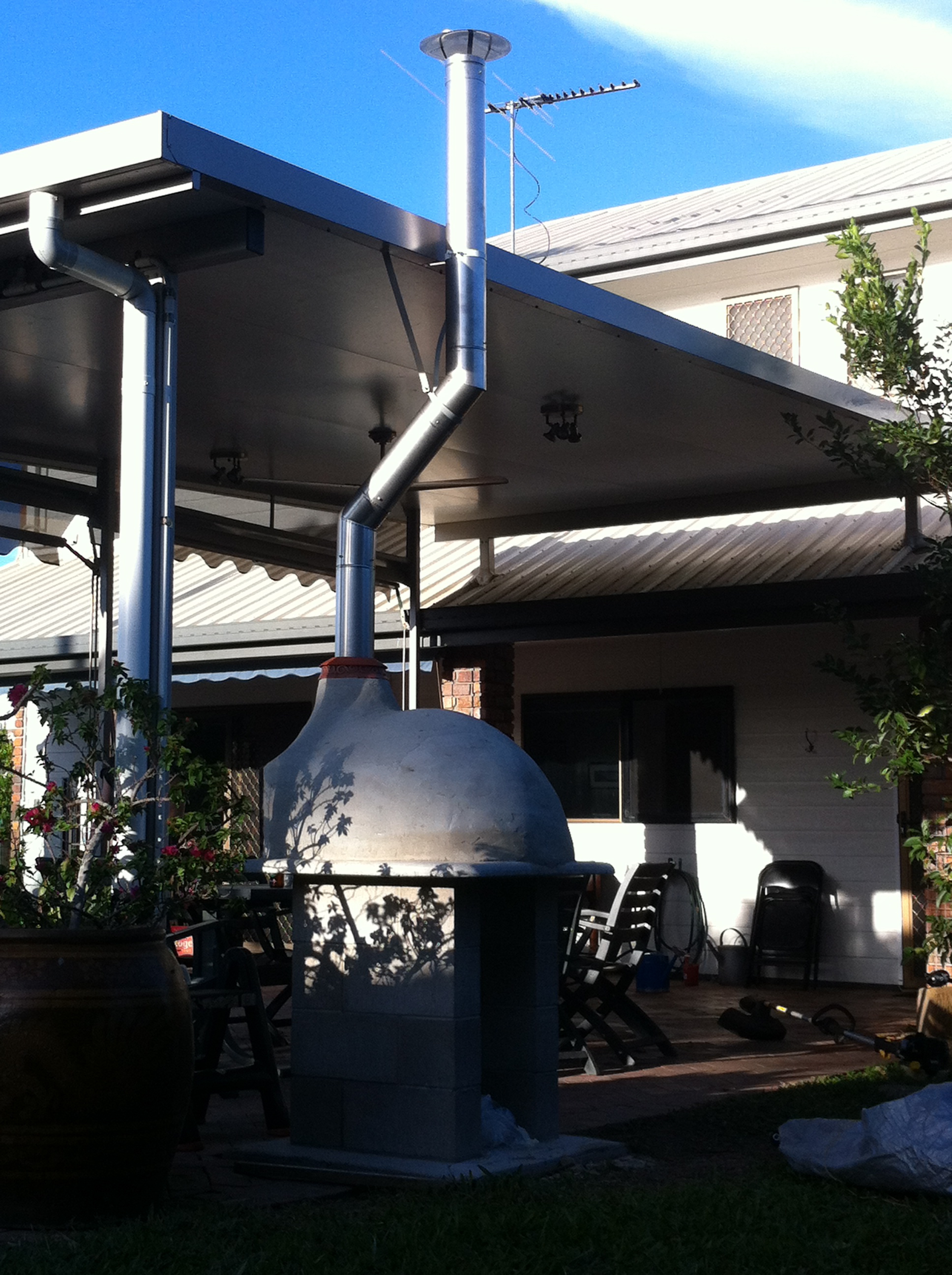

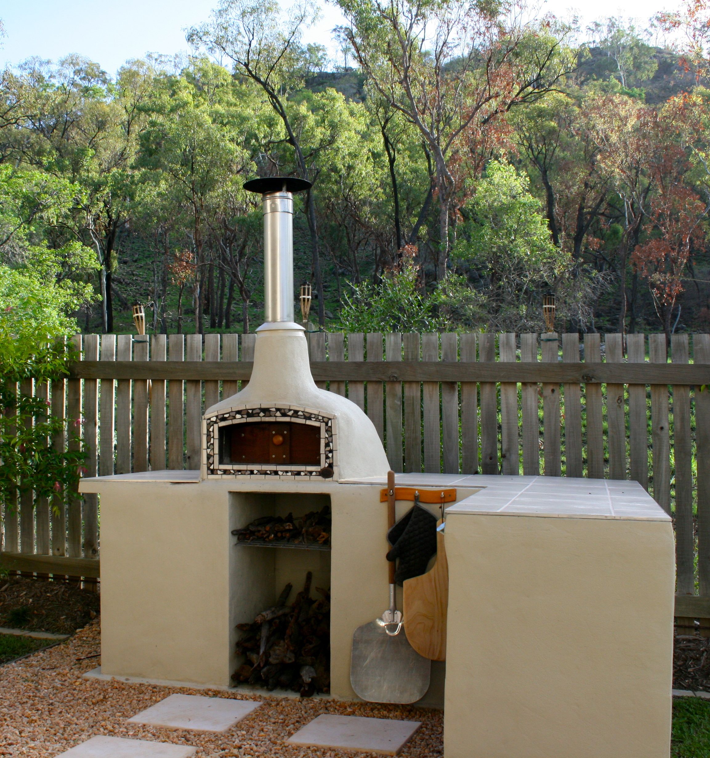

              If your flue is around 5-6 m tall it will more than compensate for the bends IMO. Attached is an oven with such bends and it draws way better than the same oven with a shorter flue of the same diameter.

              • George_M
                • Oct 2014
                • 290
                #217
                Ok i will get 8".
                Also,i need to know the chimney opening in the arc before the flue.
                Is it standard dimension?
                David,i plan to do like the oven in your first photo.
