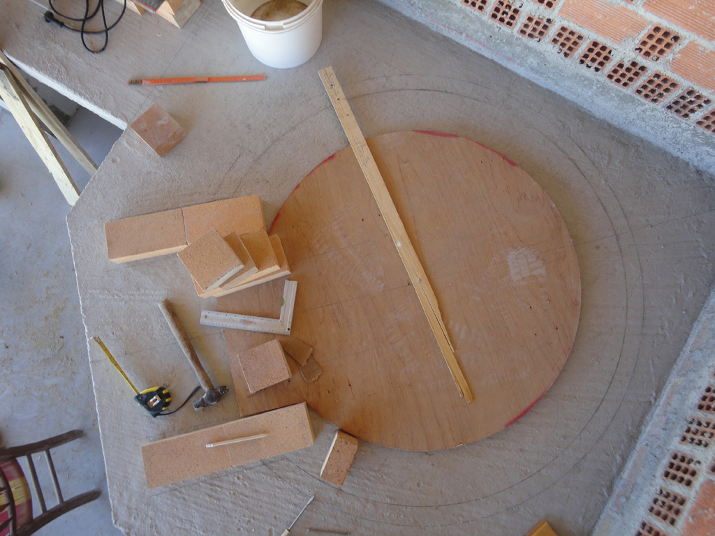

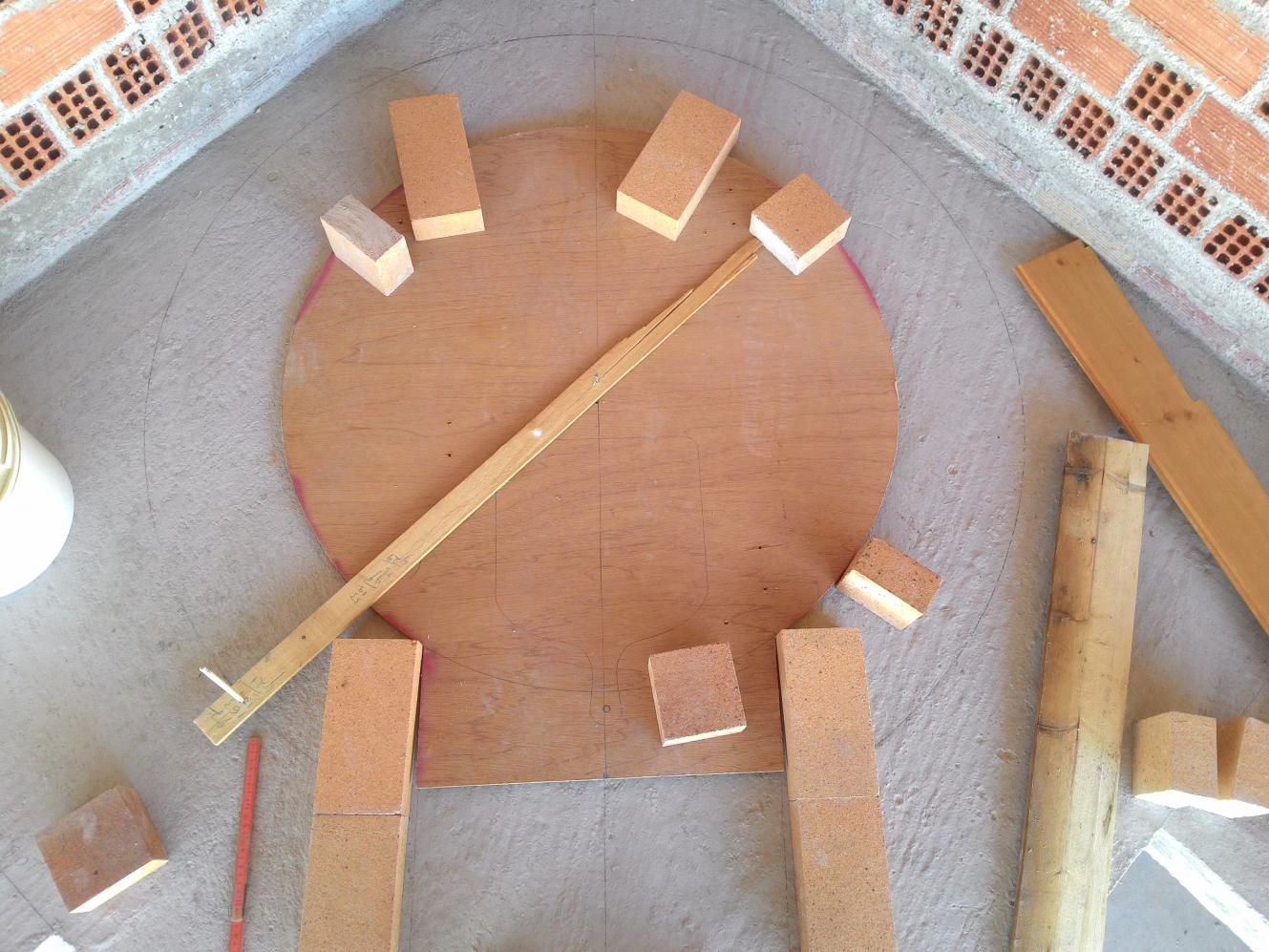

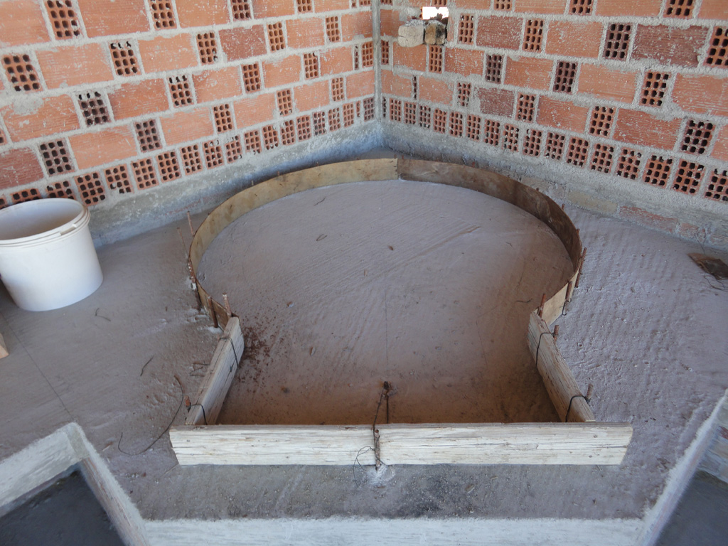

                It is the time to start again the progrees to my wood oven.
                Tomorrow i will make the perlcrete layer.
                I decide to make it 4inch height and 5:1 ratio.
                You can see the pattern in the photos.
                I draw the final dimension with pencil.
                Perlcrete layer will be until the half brick,is almost the half of the final O.D.
                Entry length is almost 20inch,(2 full bricks)
                I have a question here.
                Perlcrete must be also under the full bricks in the entry?This bricks are for the arcs and chimney.
                Or only need perlcrete to put in the inside of those bricks to the entry?

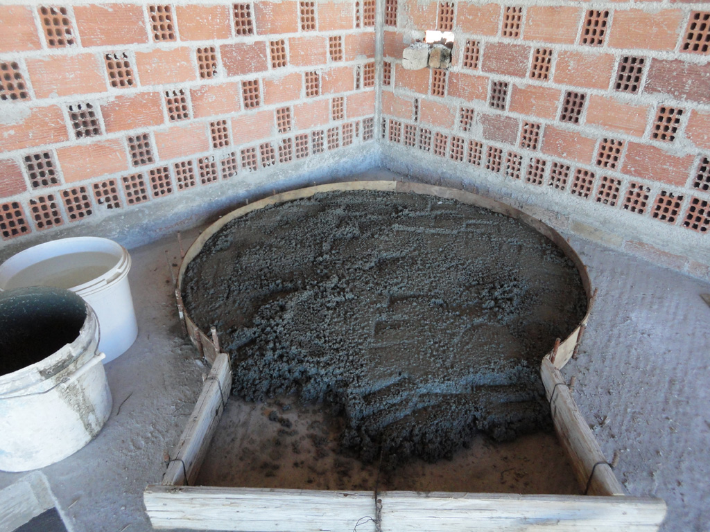

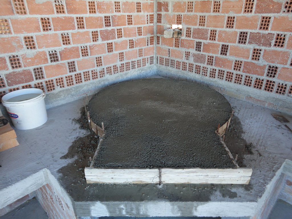

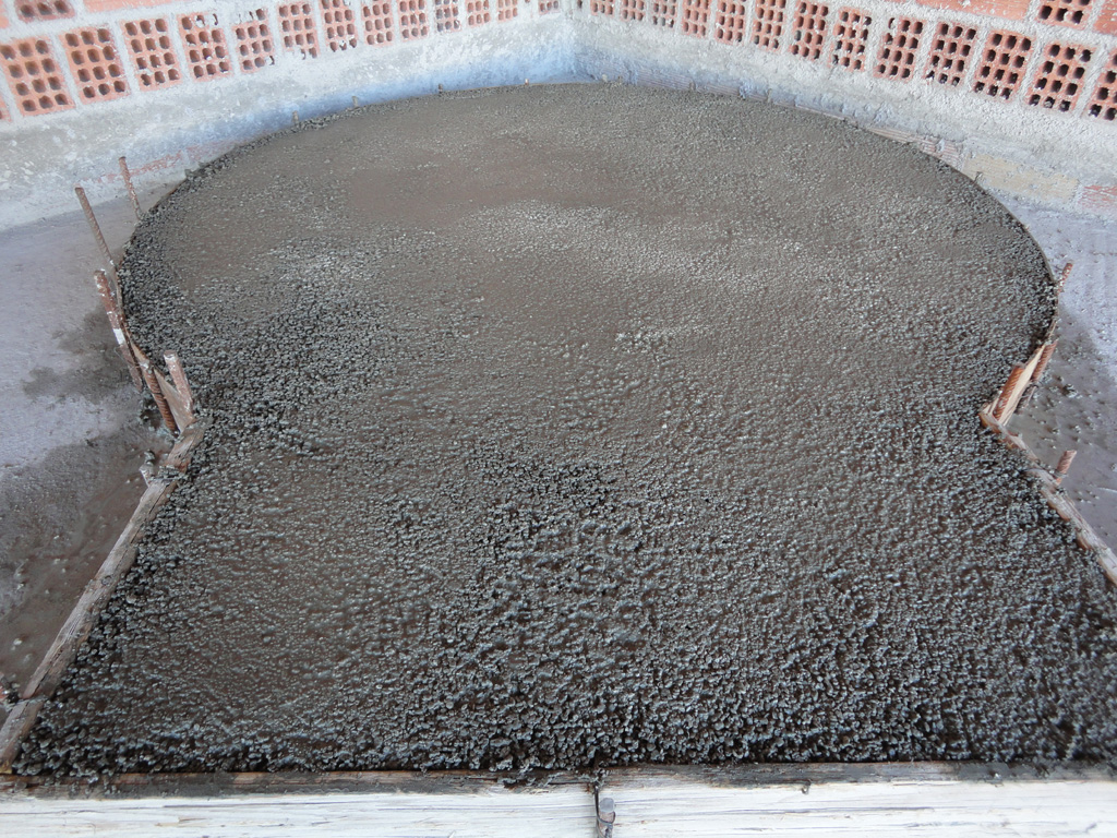

                            Perlcrete layer done!!!
                            Looks perfect!

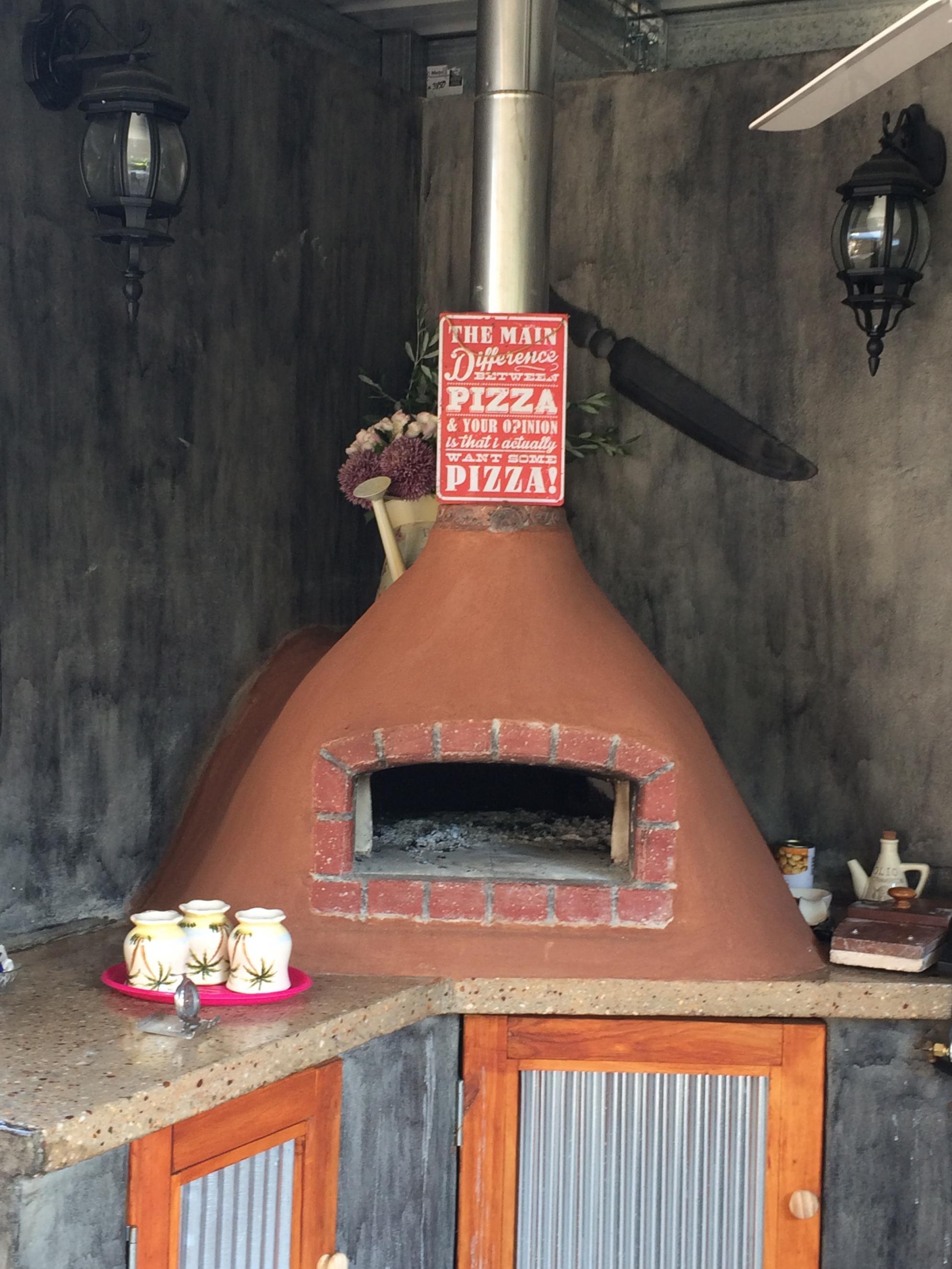

                              • 9216
                              #179
                              Originally posted by Saluki
                              Get to it! I don't envy that tight corner, that's for sure.
                              Here's a solution that eliminates the corner altogether and makes it much easier to finish. Just blend the oven into the corner. You go through a lot of vermiculite, but for the large space in the corner at the back you can throw in a lot of empty plastic bottles with the lids on and just cover them with vermicrete.
Name:	Mark and Jenny Stevens ovenjpg copy.jpg
                              • Saluki
                                • Aug 2011
                                • 89
                                #180
                                Great suggestion by David. David - did you pour those countertops yourself? Is that crushed glass mixed in?
