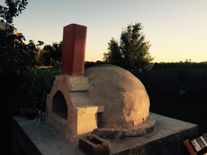

          In any event, I've buttressed the arch opening. Framed up my flue, I need to shave bits and pieces to accept my chimney (8"X12" clay).
          I've also tied in my 7th and 8th courses to the arch. The 9th should be the last of the "custom cuts".
          The 9th course is well on its way as well.

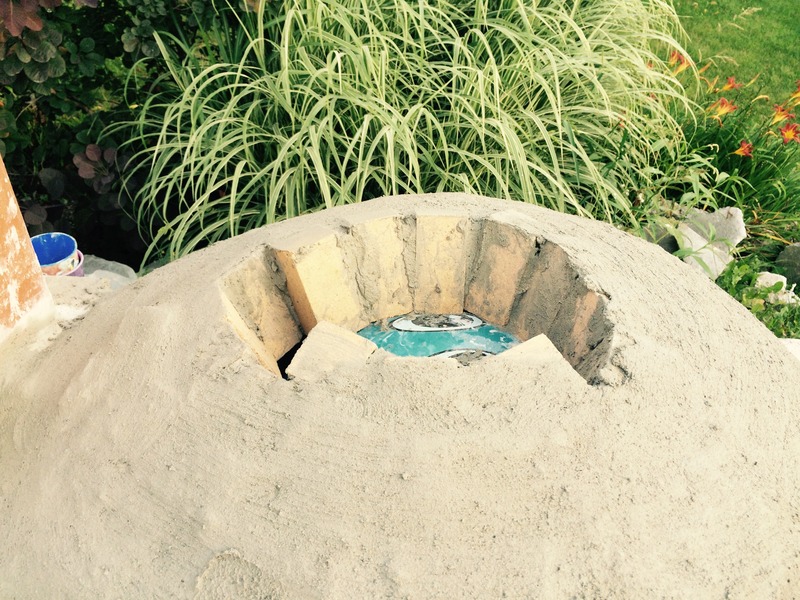

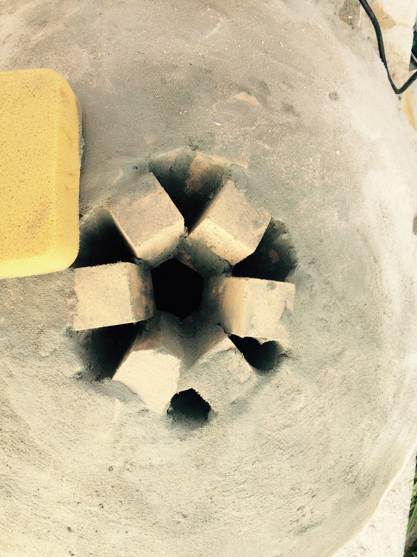

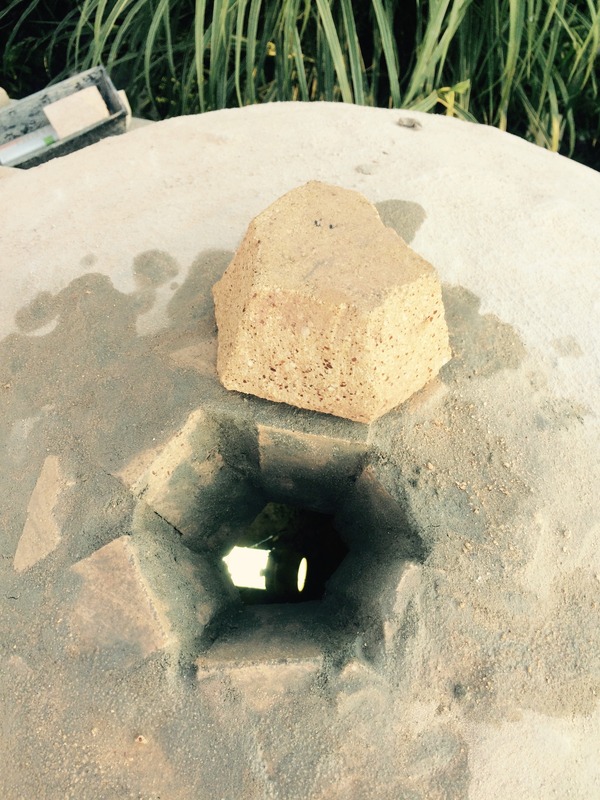

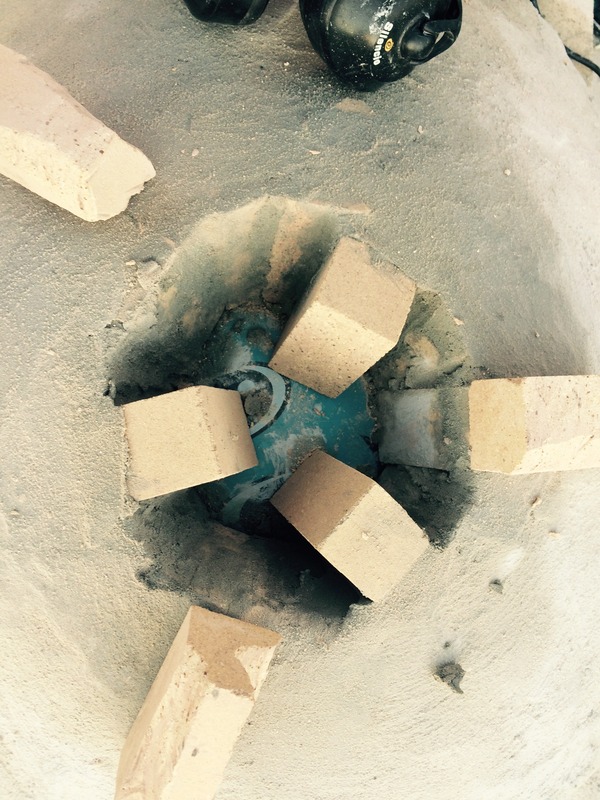

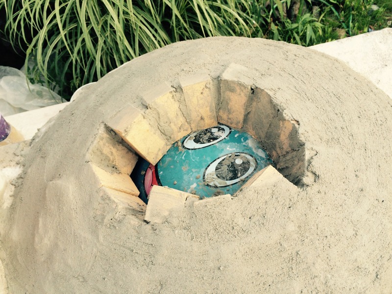

                  Hey everyone, I figured it's time for an update. I've closed in the dome (a week ago today) and lit a small paper fire to check the draw. I may have to extend the chimney or work on the inside of the flue a bit more. It was somewhat breezy when I checked the draw. When it was still or just a slight breeze you could watch the smoke swirl right up the flue, but when wind hit the chimney, it would smoke a bit out of the front. I'm going to call it a win and work on controlling the wind a bit. It must be the angle of the photo, but the chimney looks like it's angled back, it is pretty level, don't know why it looks that way. if I were to have to add another chimney section, how would I go about doing it?
                  I did use my IT, but not nearly as much as I thought I would. I pretty much checked the face of every 3rd brick with it and only had to use it to hold a brick a few times. Once I got to the 10th course or so, I used one of my daughter's toy balls to support the remaining courses, which went really quickly.
                  As far as finish work goes, I'm collecting materials now. We've completely changed our minds on how we want the finished product to work. We will be using reclaimed brick to finish the base with a stucco dome. A friend of mine has a 72x14x2 slab of limestone that was his mantle. I am going to try to set it down as my oven entry/counter-top. I reclaimed about 50-60 oversized "Boston Brick" stones from a friend's house last week. When I stopped by, he had also found a large carbon steel sheet. It's 51x31x 1/2" thick and weighs a couple hundred pounds. I'm currently planning on having a shop cut and square two doors from this sheet and I will mount them as doors to my wood storage. Combined with the reclaimed brick, I think it will look very cool.

                    My opening got a little oblong towards the vent landing, but I was able to shape it back in. Keystone turned out to be a strange shape, but it did the trick. Mortared it and tapped it home.

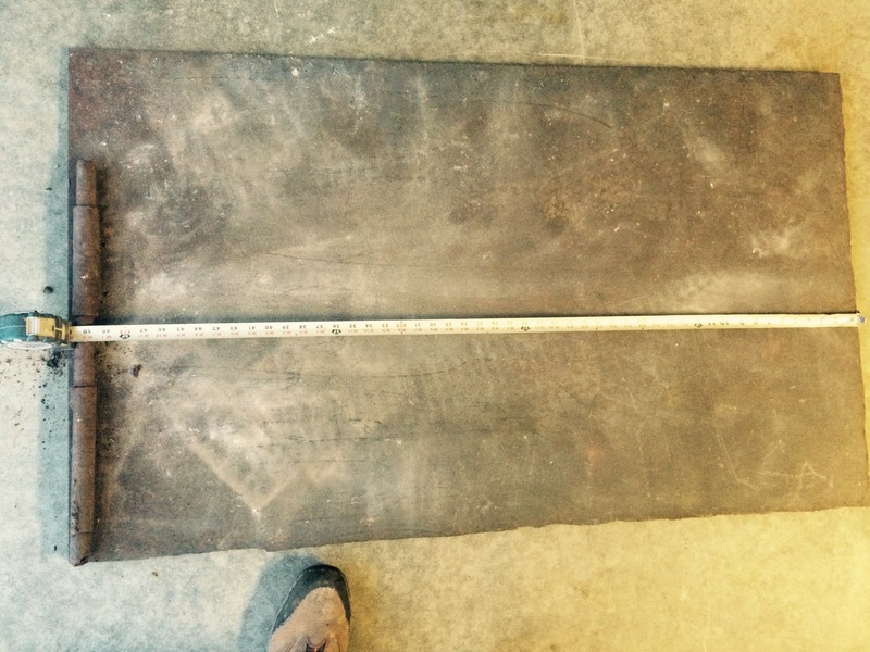

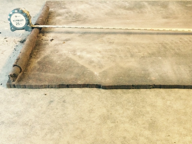

                      Here is a pic of the steel "Door" I picked up.

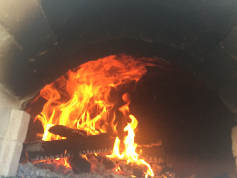

                        We had our first full firing/party Friday night. 3 pies and a 2.5lb salmon fillet.
                        turned out amazing and was so much fun to finally reap the benefits. I planned on getting the insulation set today, but just got called into work.

                            Well, we've done 5 pizza parties, not a single pie has turned out less than amazing.
                            I laid the insulation a couple weeks ago and will be tidying it up and wrapping it in mesh today. Depending on how that goes, stucco may go on this evening.
                            I'm ready to be done covering it each night....

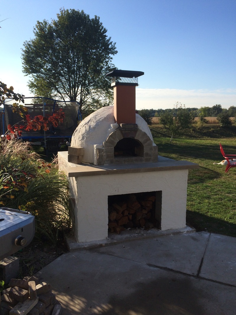

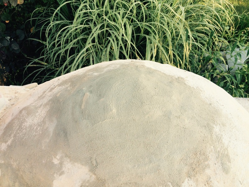

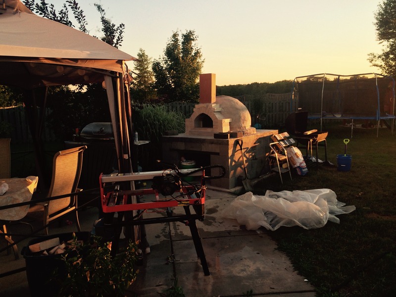

                                Well, the oven is done. The Stucco I applied came out a couple different shades of white, so I may paint it this next spring if the colors don't blend together. I also, might stucco the inside of the wood storage opening....
                                It was a long, laborious build, but it was fun. If one were to ask if I'd build another; absolutely. The finishing has been the most fun. I've re-purposed some different materials for the finishing. Arch bricks are old Belgian bricks, the keystone was a couple POSTON BLOCK bricks I got from a friend, and the countertop was a limestone slab that served another good friend as a hearth to his fireplace.
                                We've used it many, many times now and it looks great on the patio.
