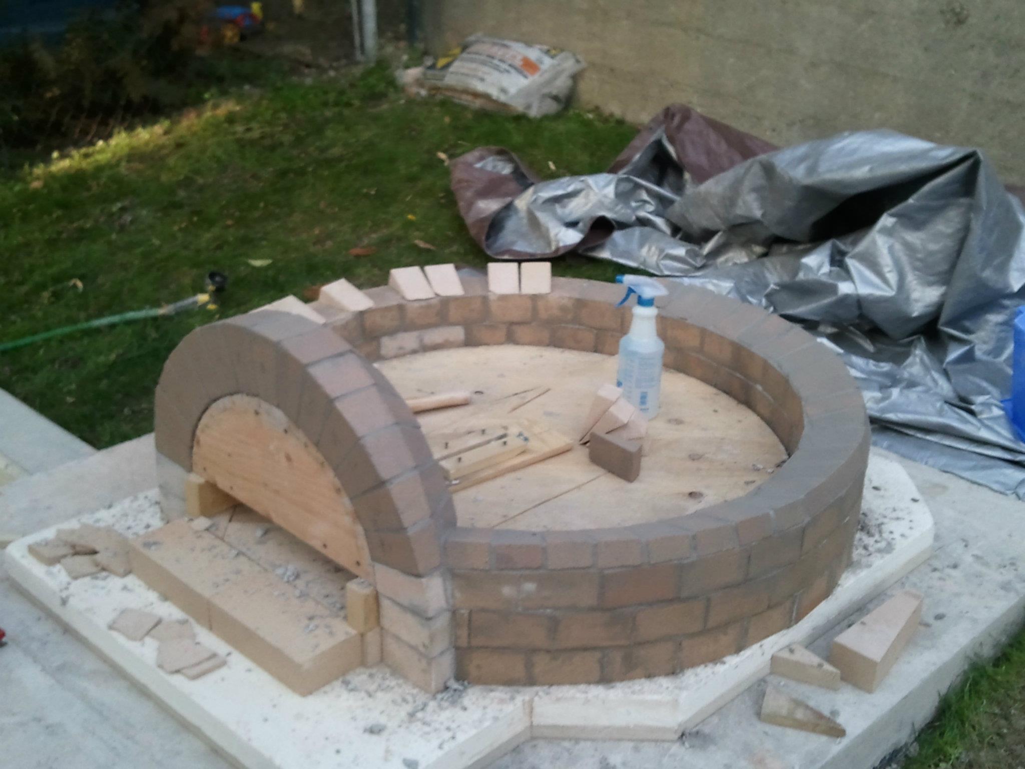

    Hi gulf I may have missed something. What do you mean by tear drop shaped entry transition? And if that is what I have set myself up for then yes I guess that is what I will have. I may have missed something along the way. I did what seamed right. I realize it might not be quite what everyone else has done but it looks to me like it will work and be serviceable . Please correct me if I am wrong and need to change something. Thanks for all the help

    Gastagg thanks for the complements. I can not take credit for the IT I just copyed someone else here on the site. As for oven opening it is 12.5" tall by 19.25" wide.
    I got a few hours of work in last night again. I got my first 2 courses of bricks in and got it tied in to the arch. It seamstress take longer and more mortar than I was thinking that it would. Now I need to start cutting for the next course.
    Randy

    Well I finally got to do a little more work on my oven. I have got about half my 2nd corse done and I got my arch for the oven entry finished. I know people have used a lot of different things as spacers, but I think I may have a first. I used wire nuts as my spacers. The yellow ones were the right height for the arch and some red ones I have are the right thickness for my dome bricks. You know what they say. Use what you know.
    Randy
