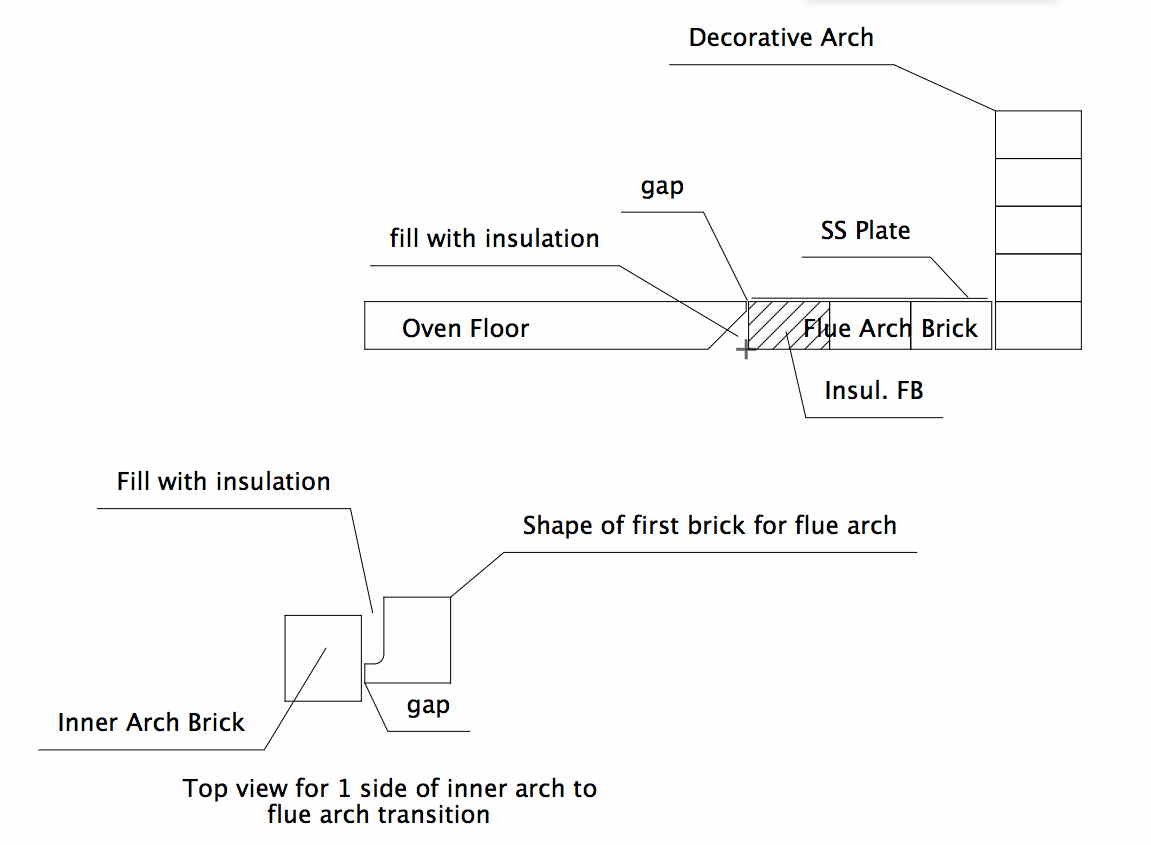

            Now, about the heat break, I really like the design Chip posted on Randy's thread. But I have some questions:
            - by SS you mean stainless steal and not soapstone, right?
            - how thick does it need to be?
            - why go with this and not leave the bricks visible?
            - the fact that the plate sits on top of the bricks so there is a difference in height between that and the oven floor doesn't poses any inconveniences? I am thinking of shaving the bricks under it so that at the end it will sit at the same level as the oven floor.

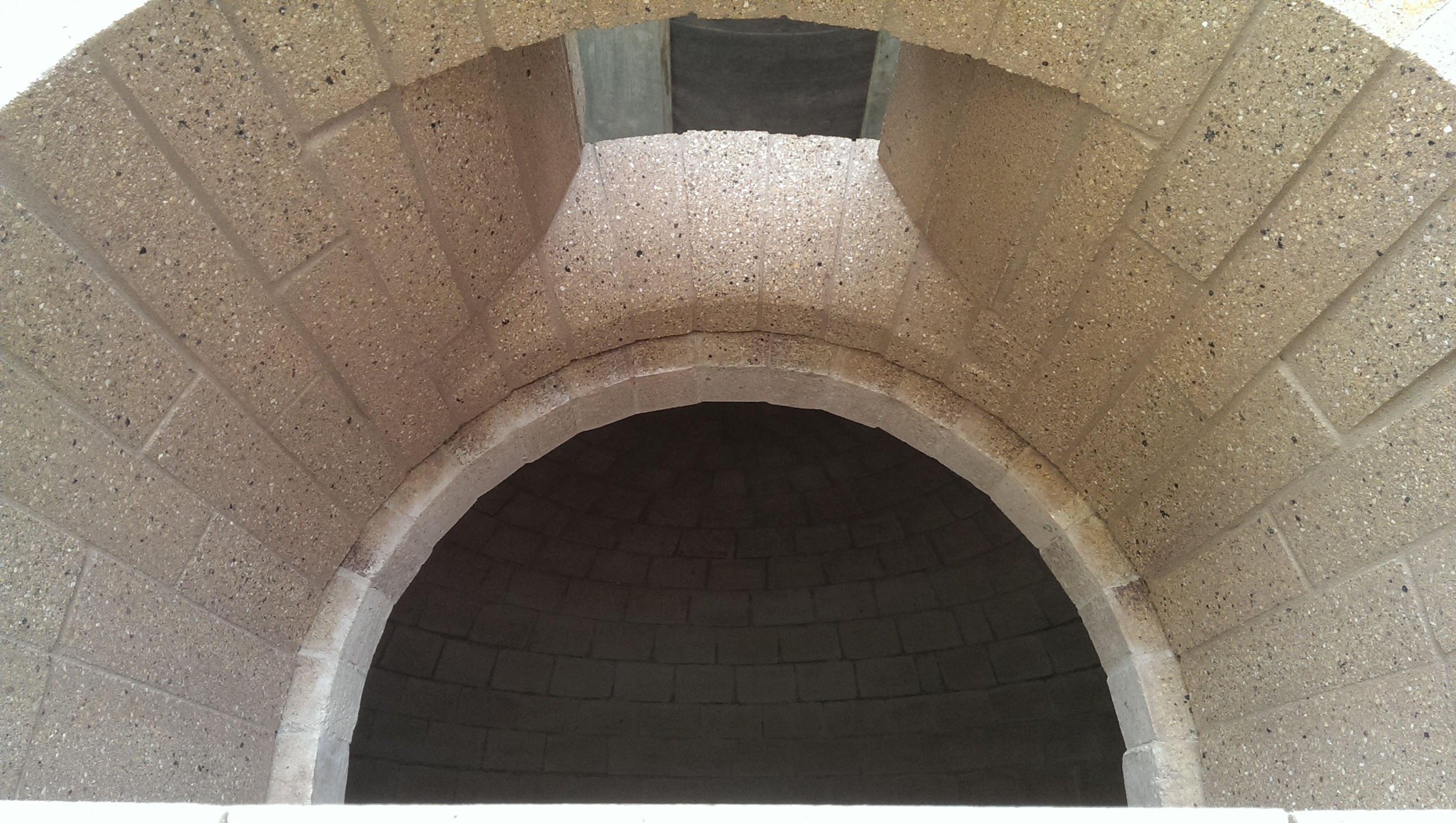

              That is a great looking dome. I love the photo from inside looking up - I think every oven is different and could be identified by a photo like that, like a fingerprint.
              The whole plan and also the location looks great.

                  You do want to shave the bricks down so that the stainless sits at the same level as the rest of the floor. It is there for a heat break and protecting the entry and insulating fire bricks.

                    Regarding your entryway heat break, you may want to simplify the gap and eliminate the 'thumb-like' protrusion, which is prone to crack from thermal cycling. I originally had this same design but changed when TScar and Les convinced me a 1/4" air gap is sufficient. The bricks on the inside of my arch just barely touch the oven arch, and the outside gap is filled with Inswool refractory caulk.

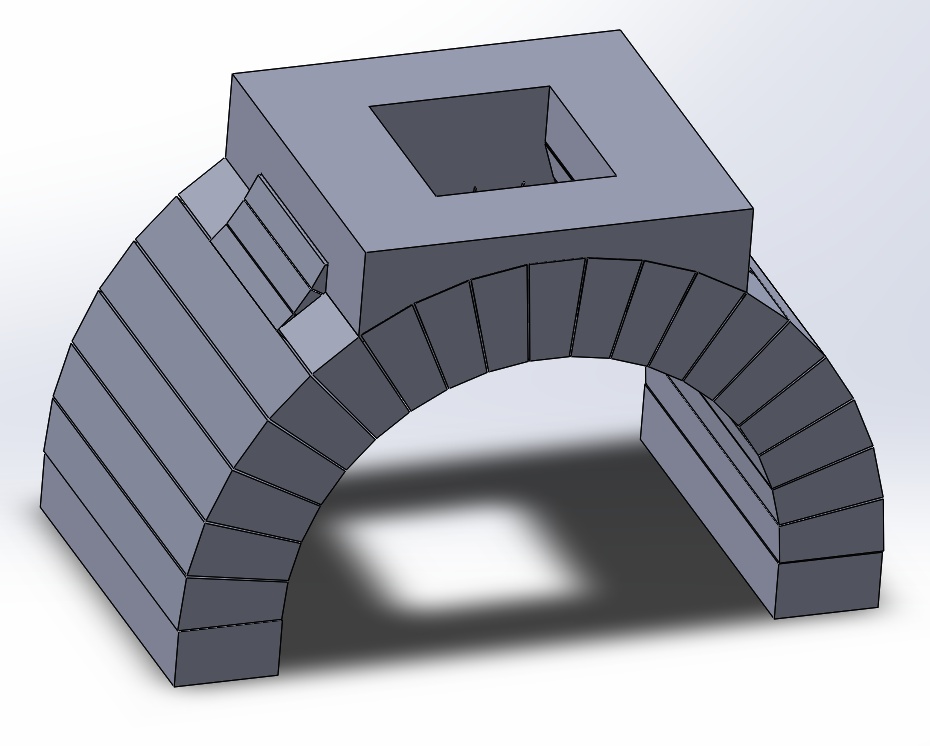

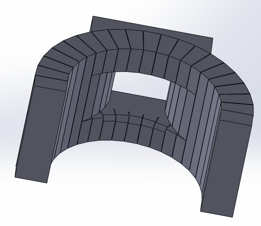

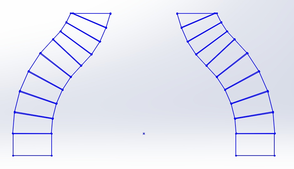

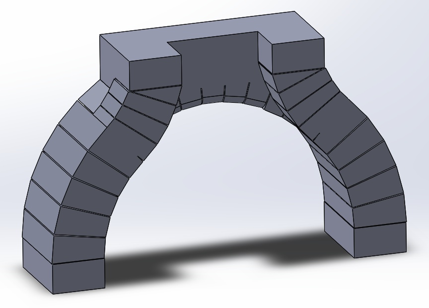

                      John, hearing this from you just made my day! I have been reading your thread inside out and it's your design that I am trying to replicate. If I do a job half as good as yours I will be truly satisfied. You will see next that I am copying also the entry arch
                      About the heat break, I think I will leave a 8mm gap (1/3'') and stick in there a ceramic rope, I think the pressure is enough to keep it in place, maybe just to be sure I will cut a little the inner arch so that the rope will fit in there... will see how it goes this weekend.
                      About the entry arch, I mad my calculations in Solidworks, here are some screenshots:

                        I think the 8mm gap will work a treat as well as the ceramic rope. I recommend you do not leave an inside gap between entryway and oven arches for oven heat/gasses which will deteriorate the rope over time.

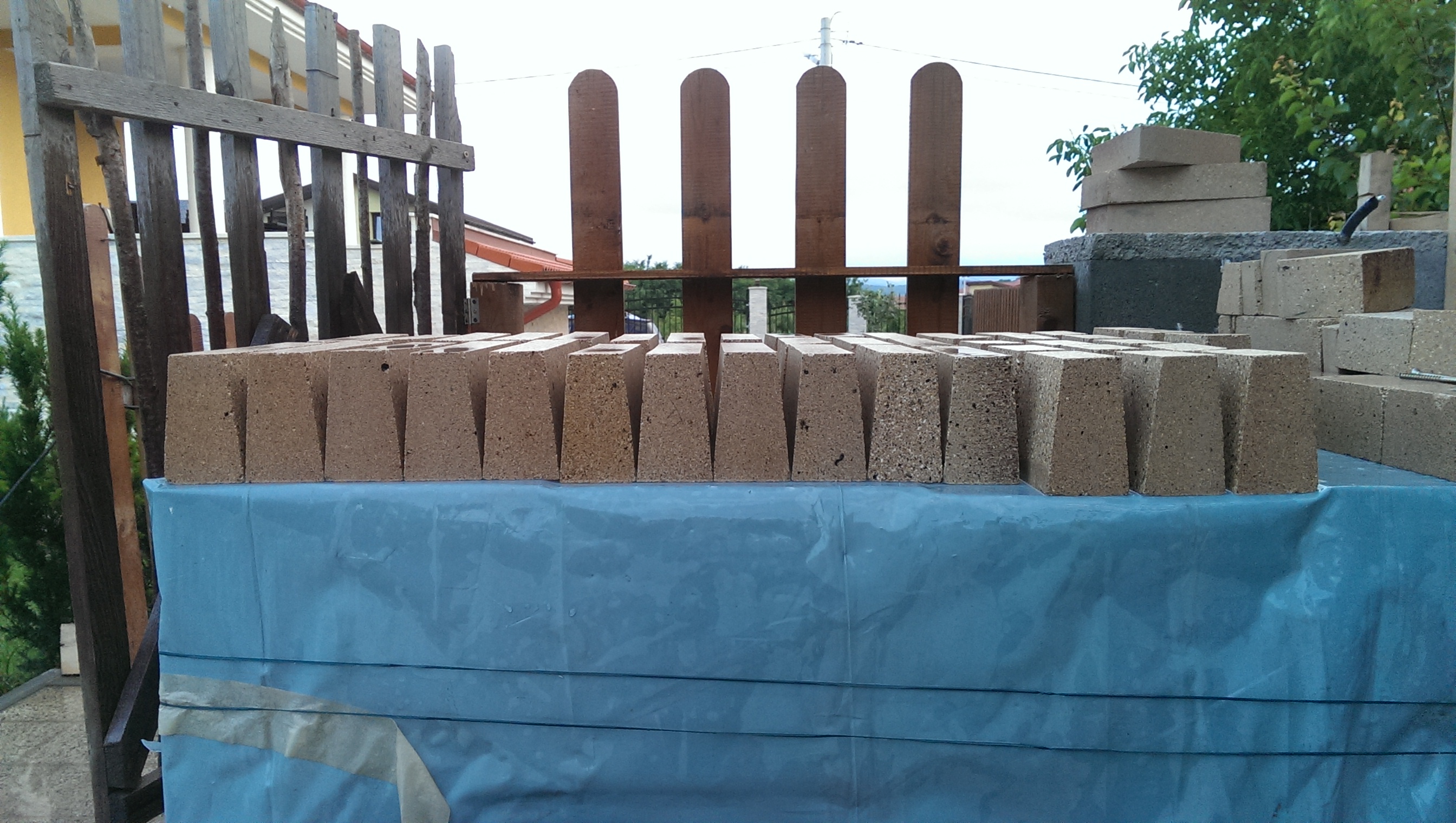

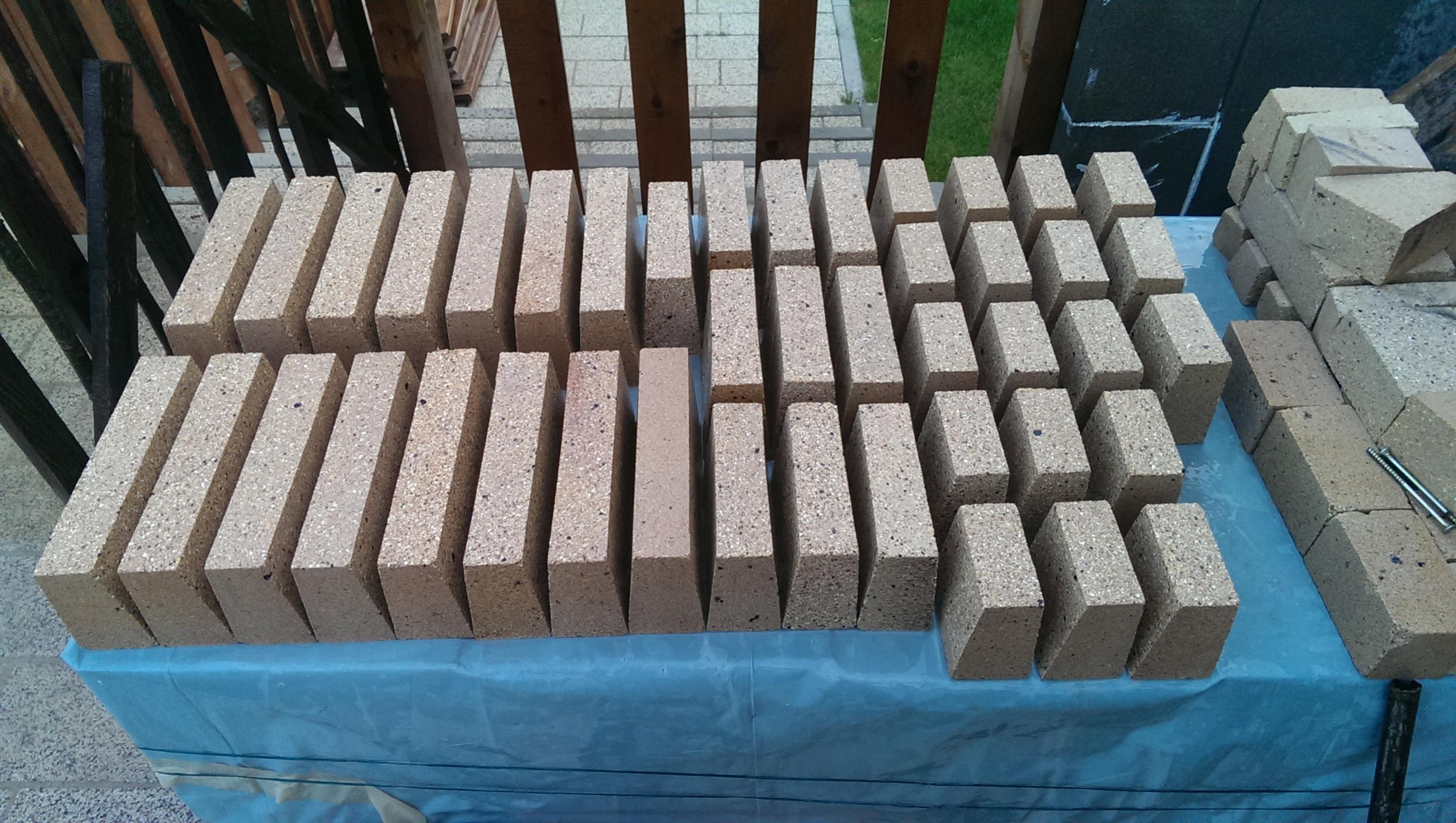

                          Friday's progress, got all my bricks cut:
Name:	2015-06-19 21.00.43.jpg
ID:	308836Click image for larger version
Name:	2015-06-19 21.01.00.jpg
                          Alex

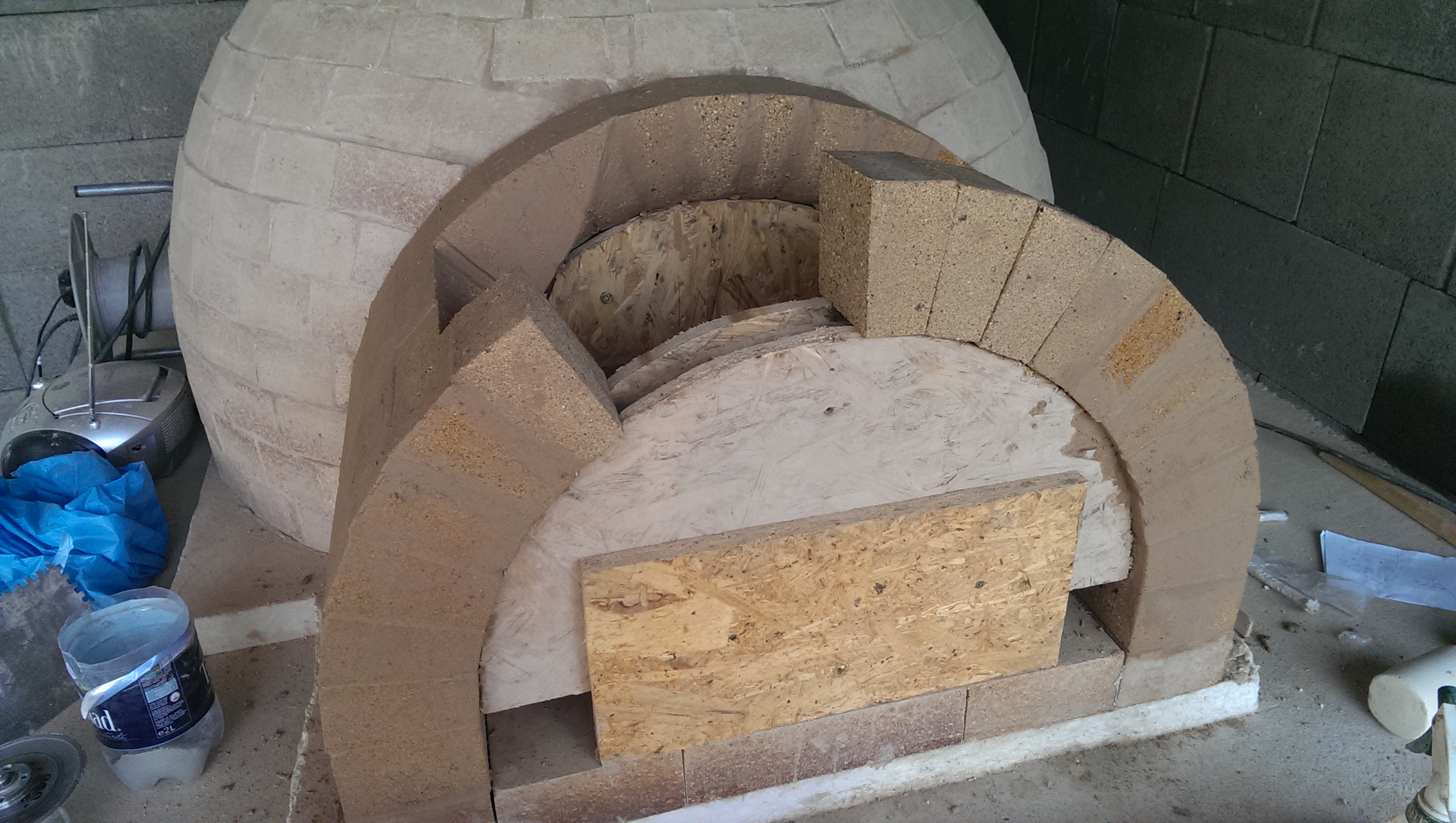

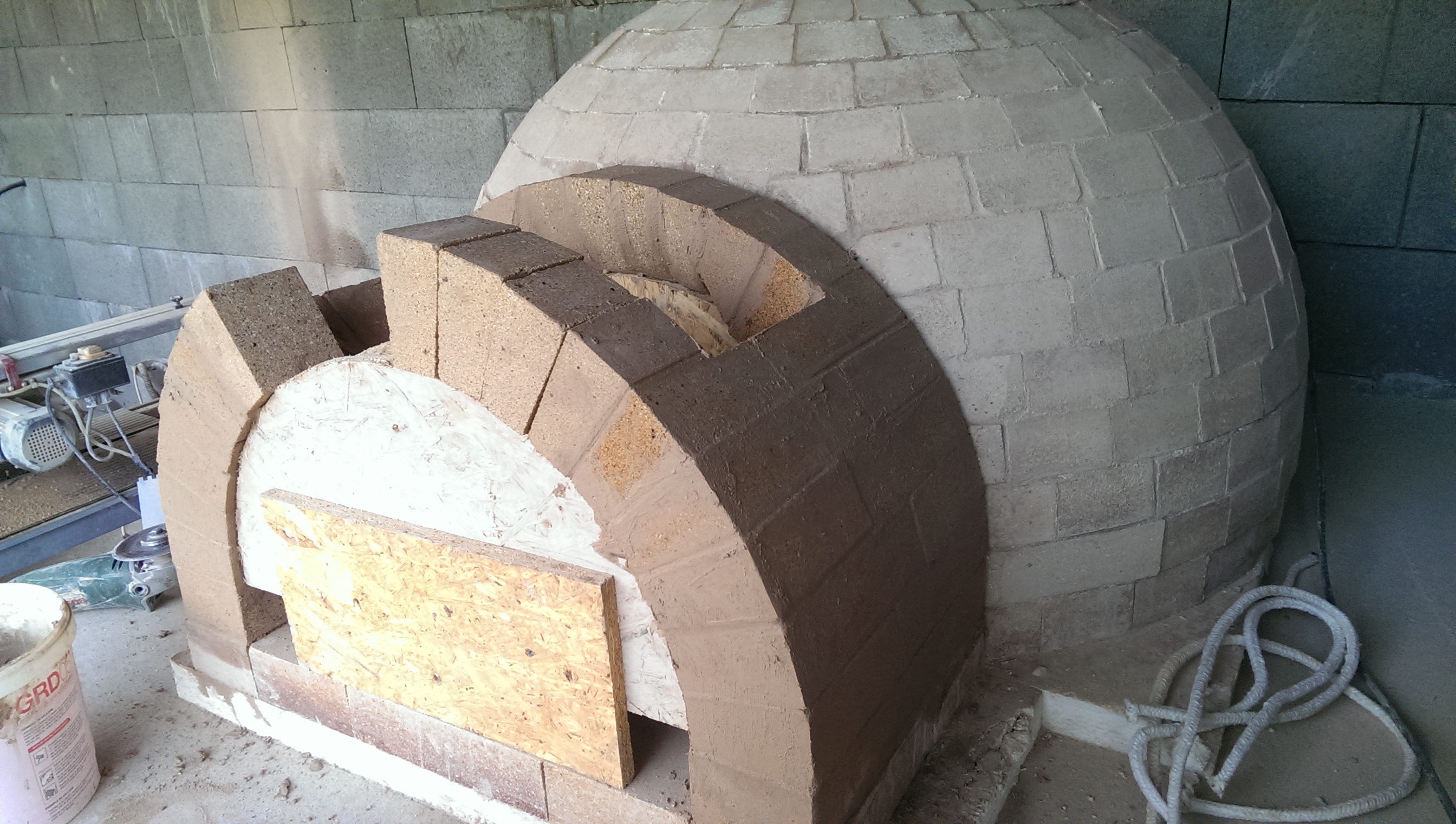

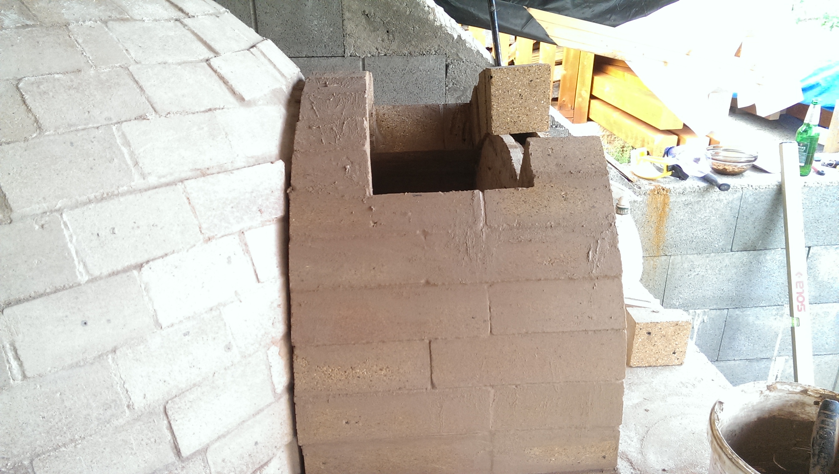

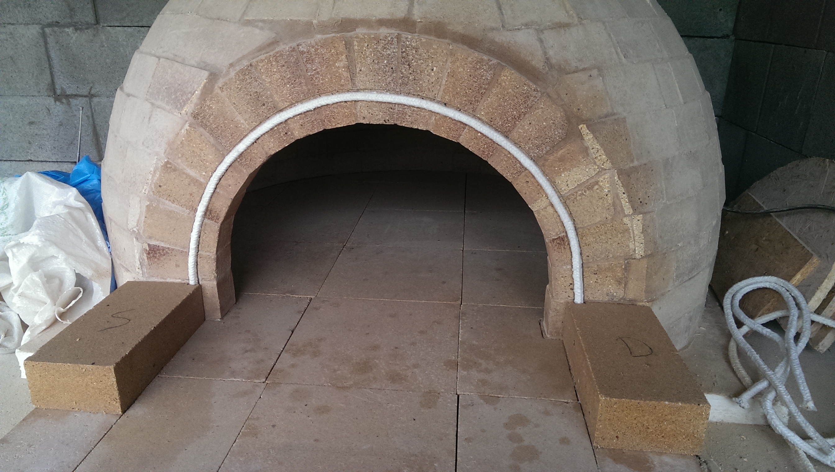

                            Saturday I worked all day, first I cut a little groove into my arch to hold my ceramic rope. Not deep, only 2-3 mm. The entry arch bricks will press on the rope and seal the gap. This will leave an inside and outside gap of about 4-5 mm between the oven arch and entry arch. About rope deteriorating, not sure... I mean I have the same rope at my wood burning boiler to seal the doors. The inside part is in direct contact with the fire, 8 hours/day in winter and this is my 4th year. And is still in great shape.
Name:	2015-06-20 10.25.11.jpg

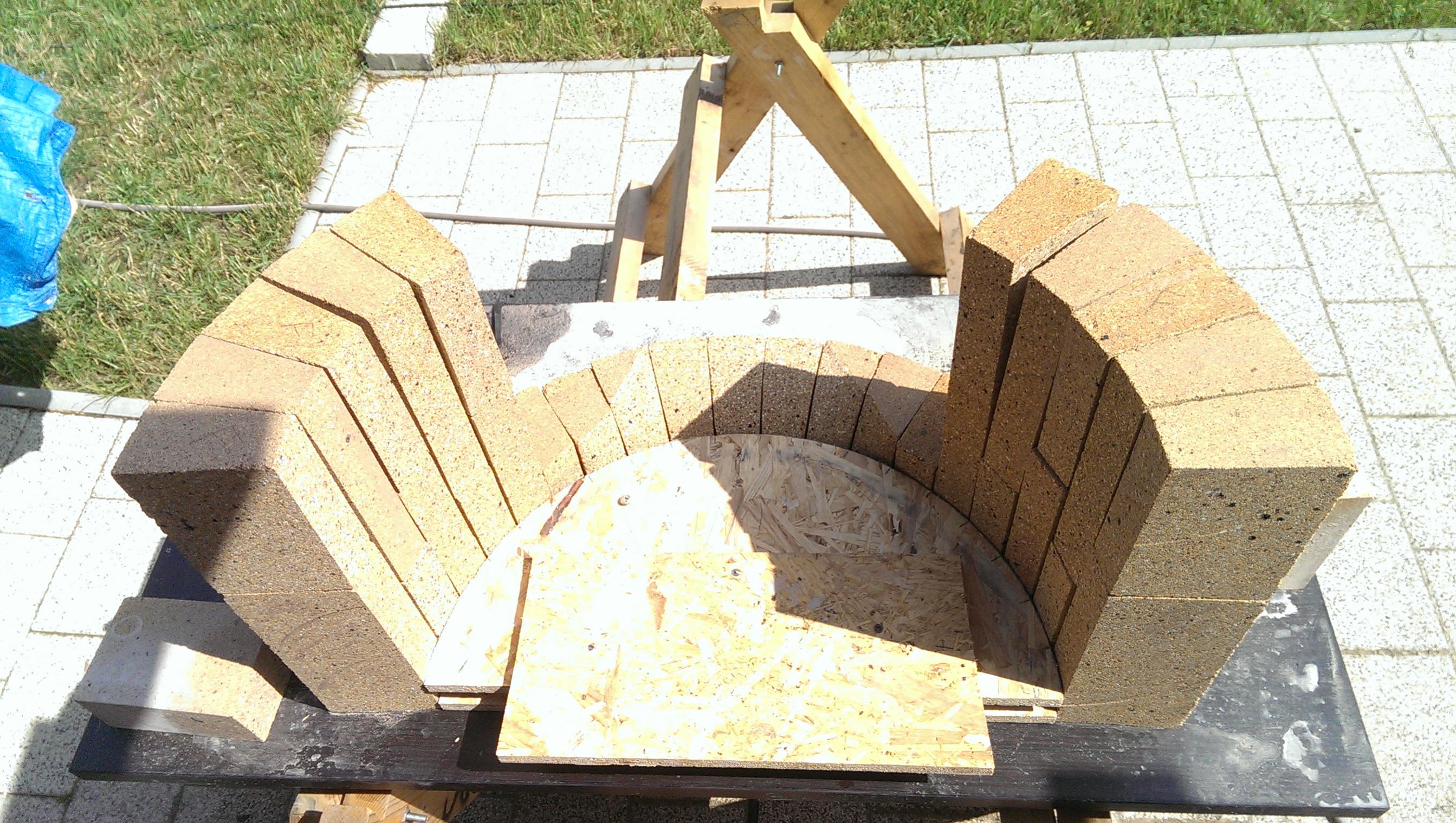

                            Then on a piece of plywood I pre-fitted almost all my entry:
Name:	2015-06-20 11.38.31.jpg
ID:	308839Click image for larger version
Name:	2015-06-20 15.56.52.jpg

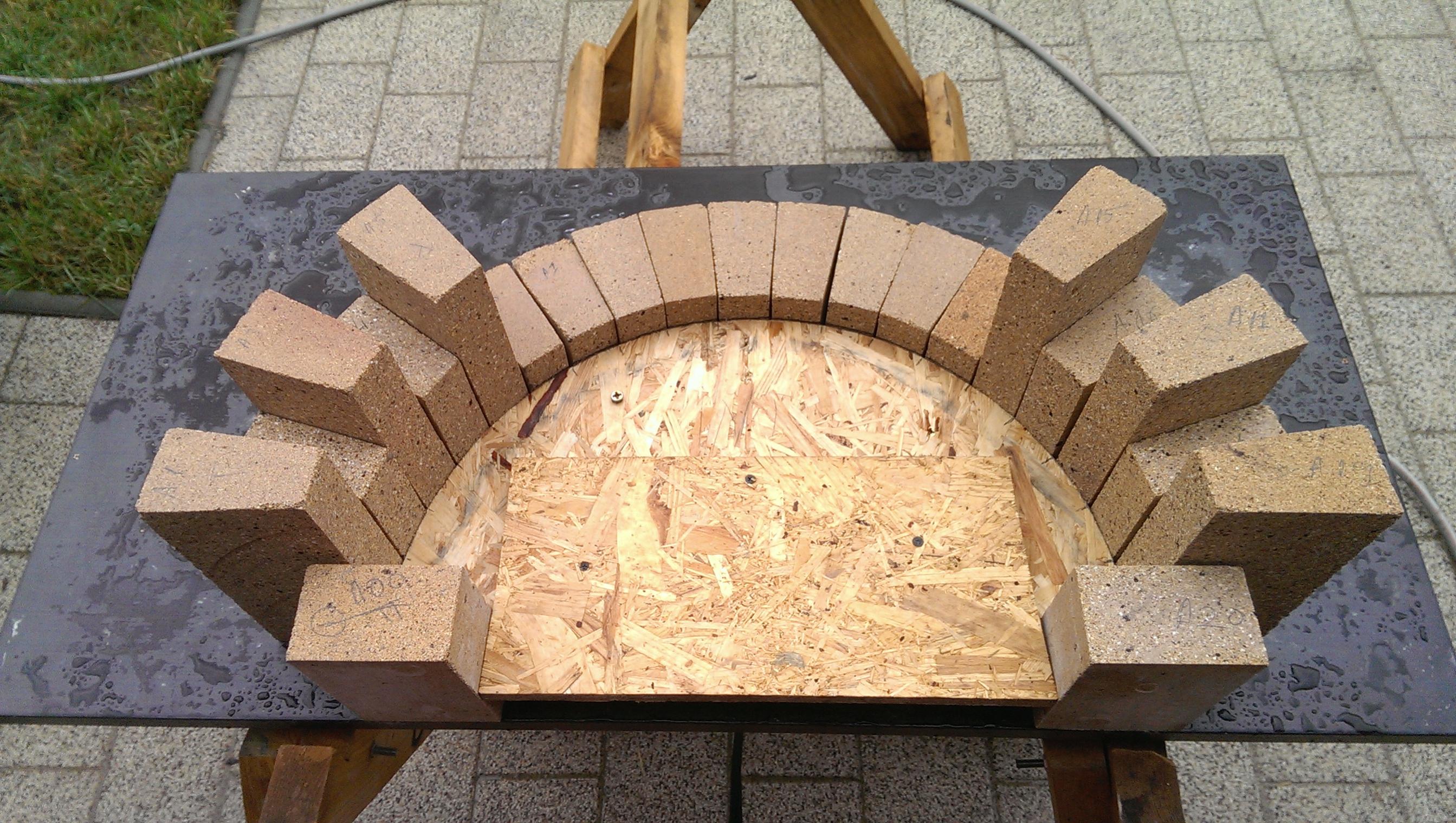

                            And now with mortar:
Name:	2015-06-20 19.15.31.jpg
ID:	308841Click image for larger version
Name:	2015-06-20 19.16.02.jpg
ID:	308842Click image for larger version
Name:	2015-06-20 19.15.41.jpg

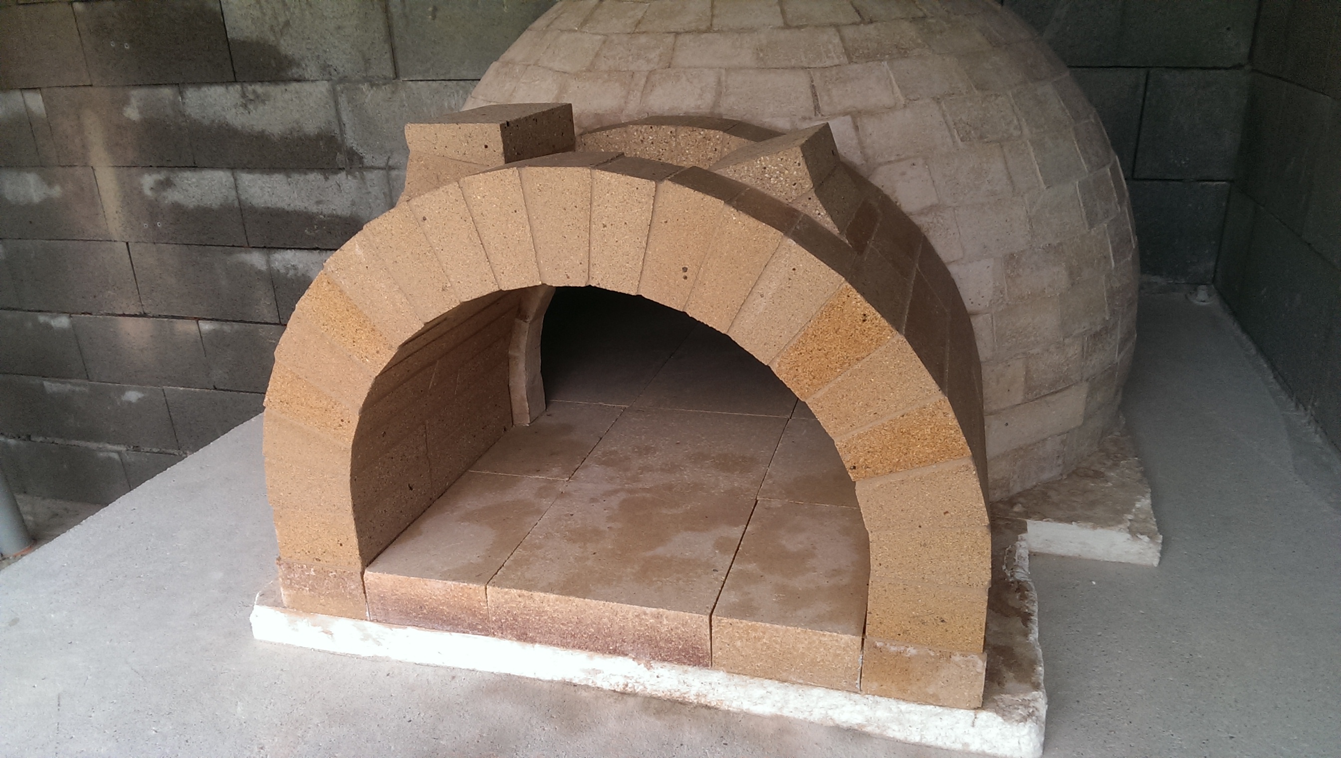

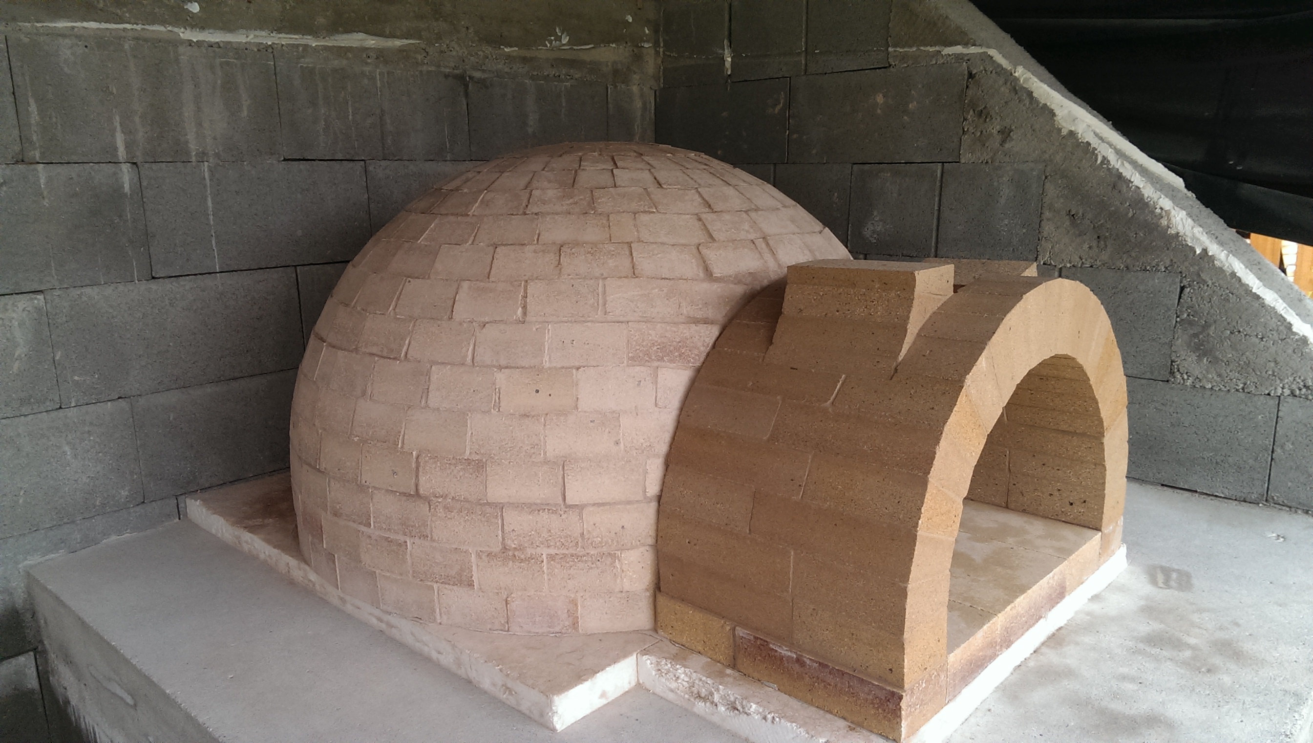

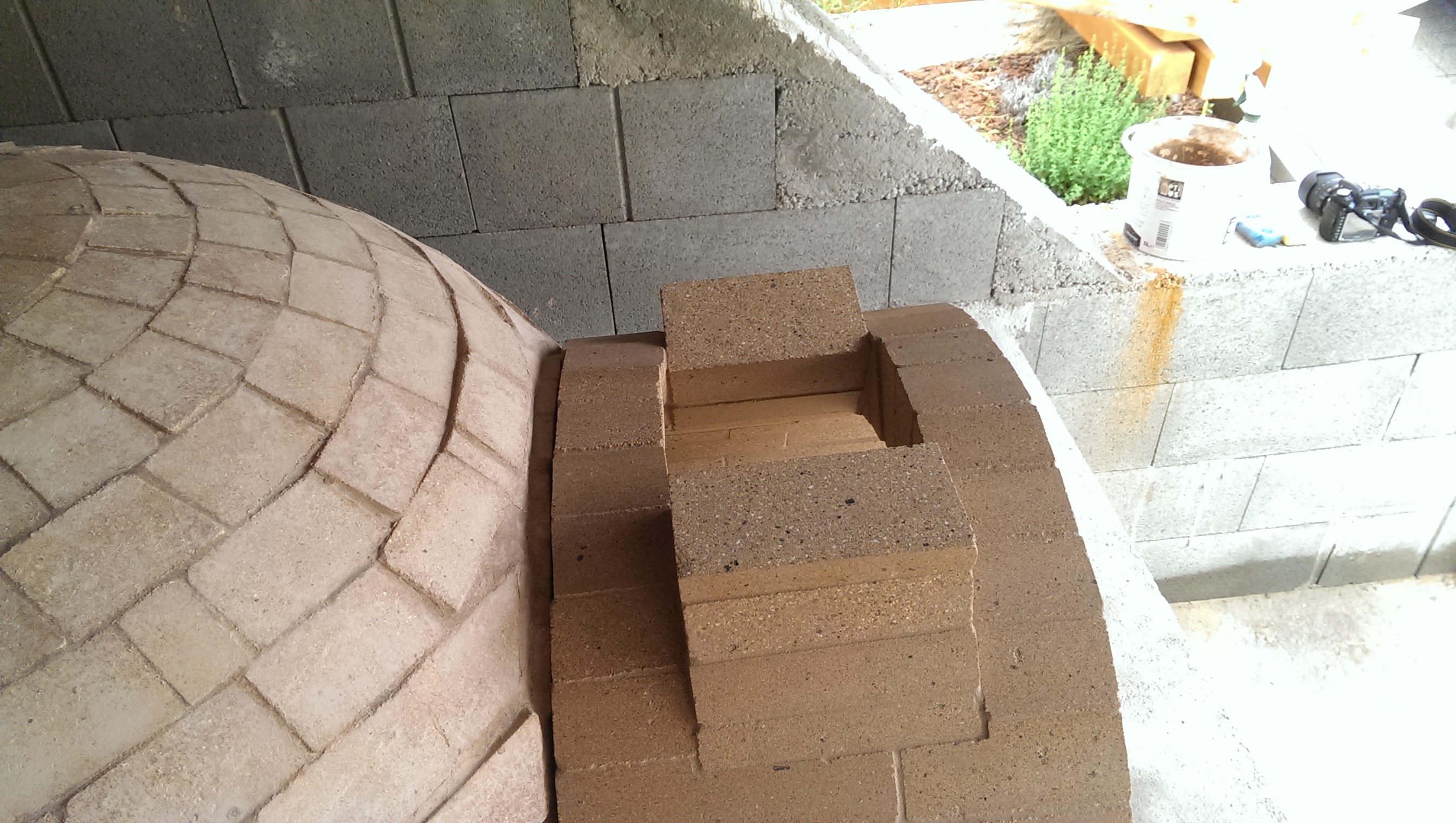

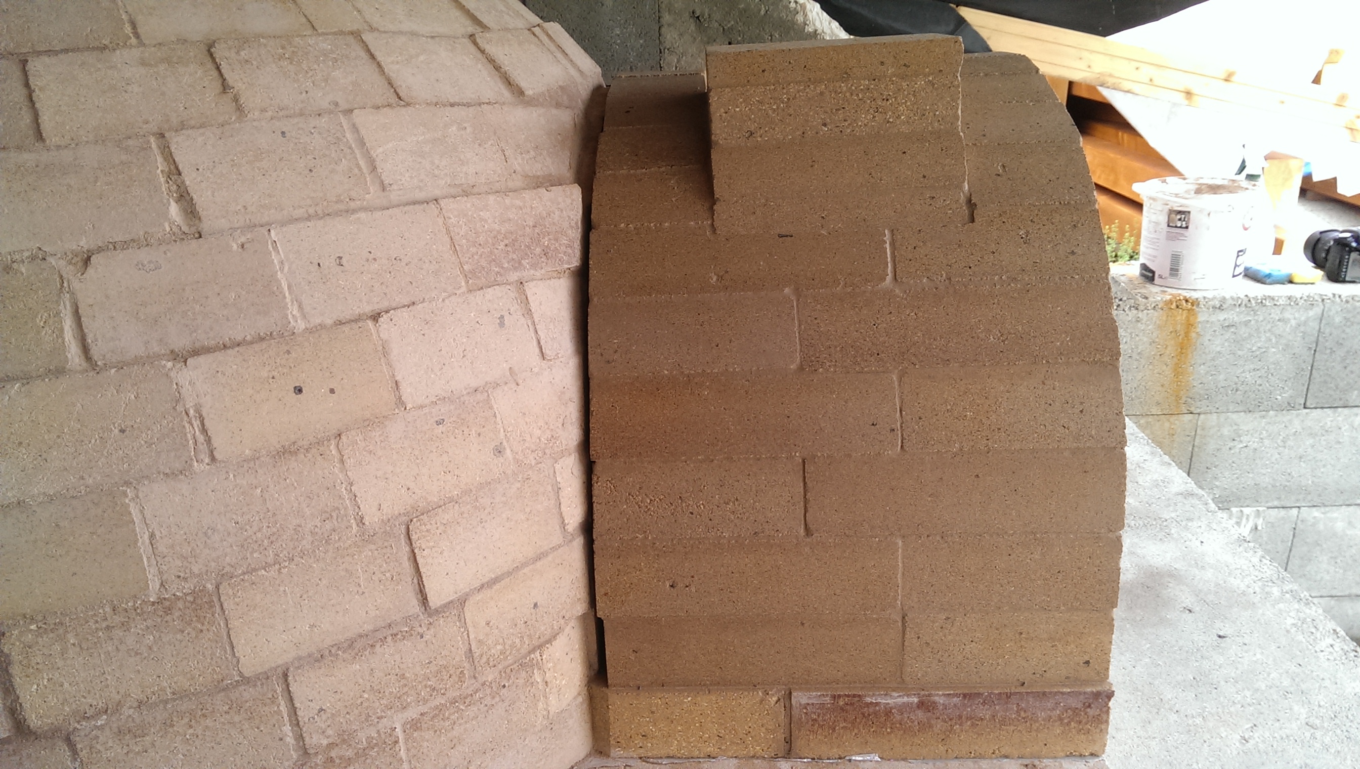

                              And the end result:
Name:	2015-06-21 14.57.45.jpg
ID:	308844Click image for larger version
Name:	2015-06-21 14.57.56.jpg
ID:	308849Click image for larger version
Name:	2015-06-21 14.58.12.jpg
ID:	308846Click image for larger version
Name:	2015-06-21 14.58.04.jpg
ID:	308845Click image for larger version
Name:	2015-06-21 14.58.33.jpg
ID:	308848Click image for larger version
Name:	2015-06-21 14.58.27.jpg
                              I still have a little to do today, I need to cut the bricks that will form the flue base. Tuesday is last day before I need to give the cutting machine back, so I need to do the floor heat break. I left that last because I really wanted to have the entry arch done now and not wait 2-3 more weeks until I can get the machine back.
