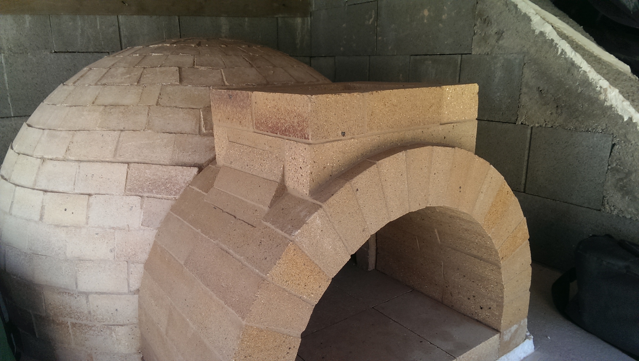

    And the end result:
    [ATTACH]48127[/ATTACH][ATTACH]48132[/ATTACH][ATTACH]48129[/ATTACH][ATTACH]48128[/ATTACH][ATTACH]48131[/ATTACH][ATTACH]48130[/ATTACH]
    I still have a little to do today, I need to cut the bricks that will form the flue base. Tuesday is last day before I need to give the cutting machine back, so I need to do the floor heat break. I left that last because I really wanted to have the entry arch done now and not wait 2-3 more weeks until I can get the machine back.
    Very NICE.
    You make me look like a hack!
    Nice job.
    You will likely not have any smoke out the front.

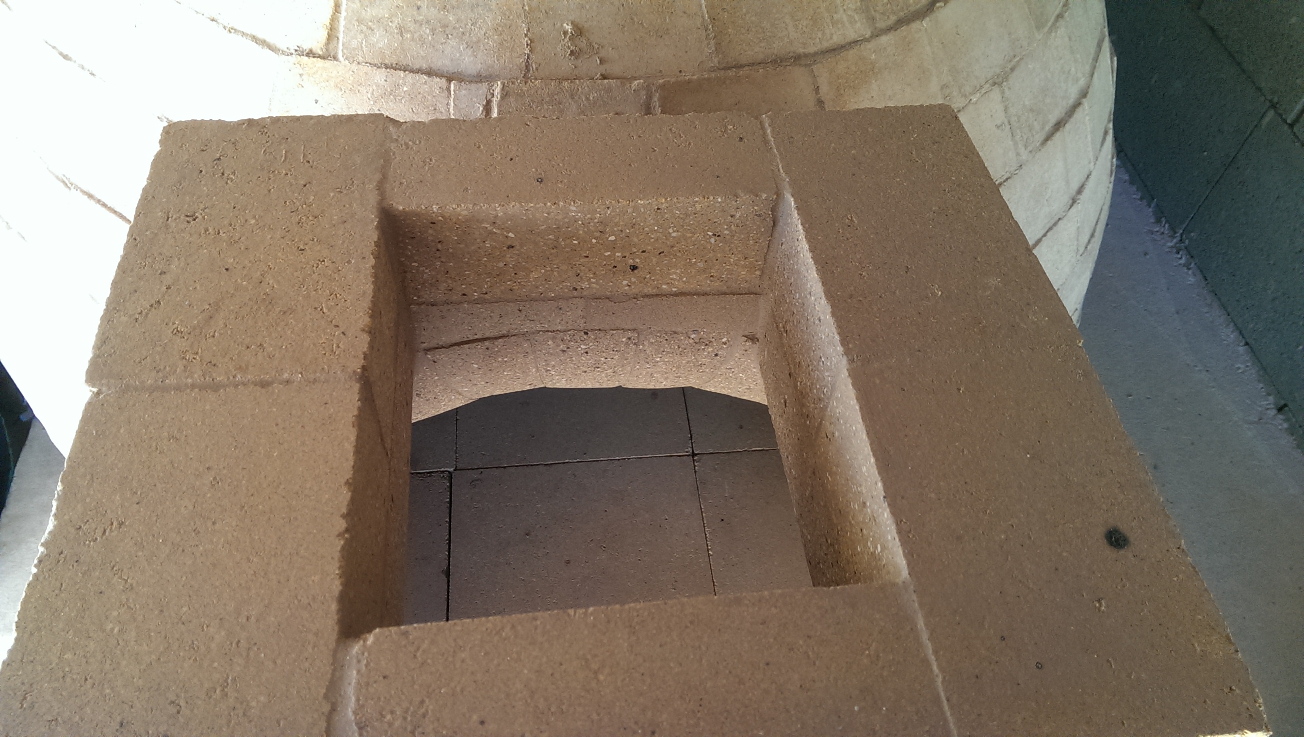

        Had a little more work done on Monday, finished the top of the flue gallery:

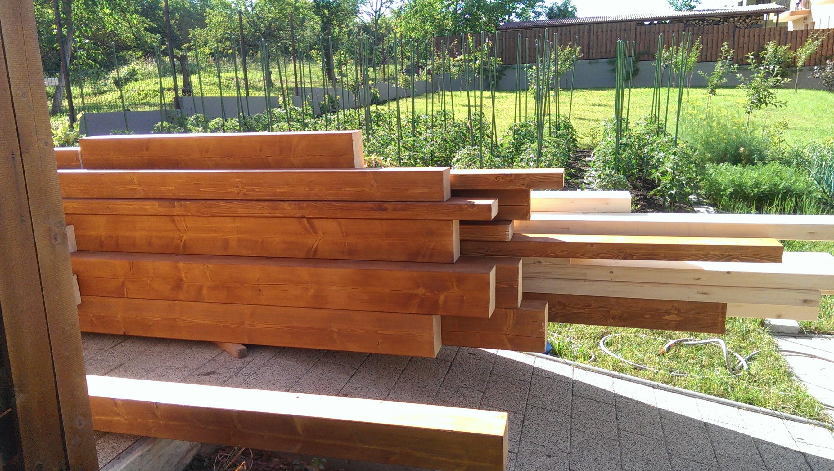

        Also the wood has arrived for the roof. After much thought I decided to hire a specialized firm to do this part. I simply don't have the time and tools to do a good job on that. They will finish it in 3 weeks, me in 4 months. Just in time for winter

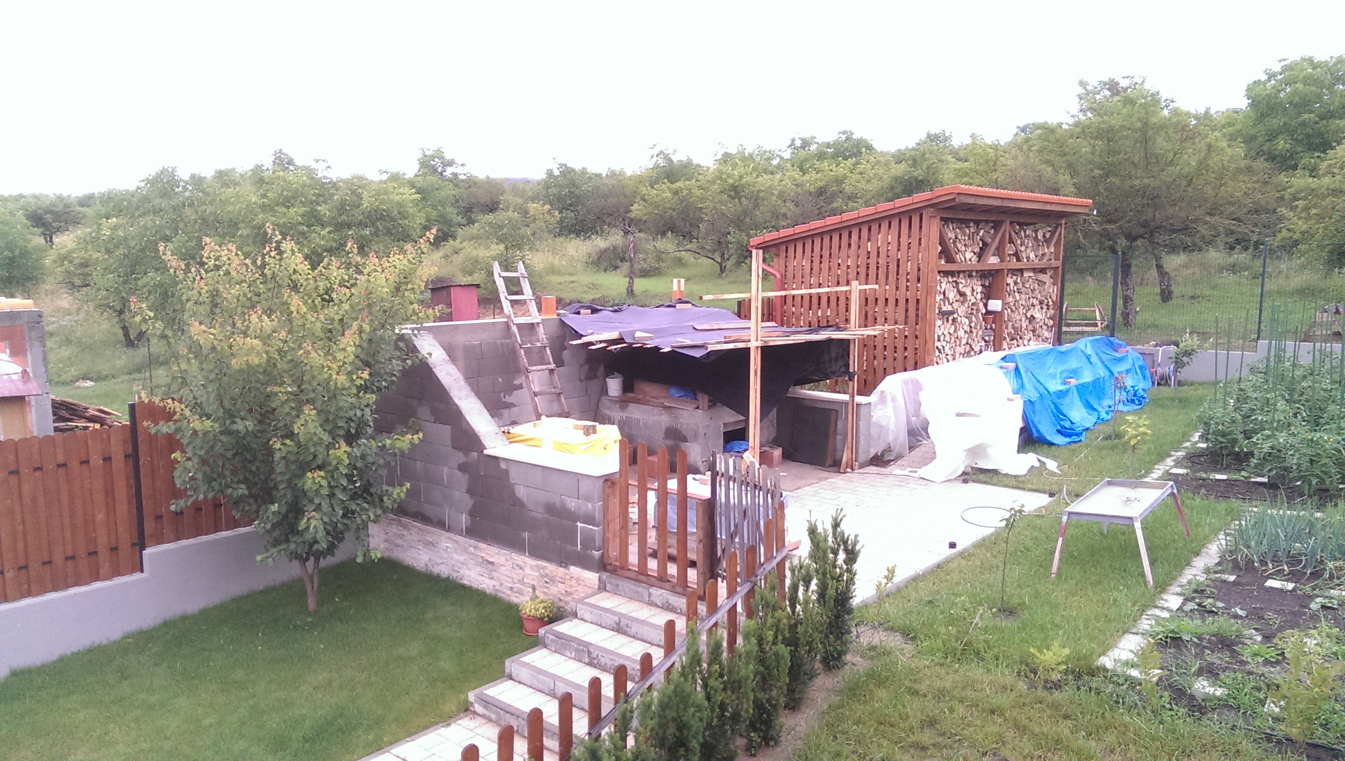

        Today and tomorrow total pause... it's raining non stop, good for the garden, bad for the oven floor insulation. It got a little wet, some water managed to get in through the "roof", I hope it will dry out OK. I have now 3 layers of plastic to cover the oven, hopefully it will stay dry.

                Yours is really neat, mine is something done in a hurry Somewhere, under all that plastic covers is my oven.
