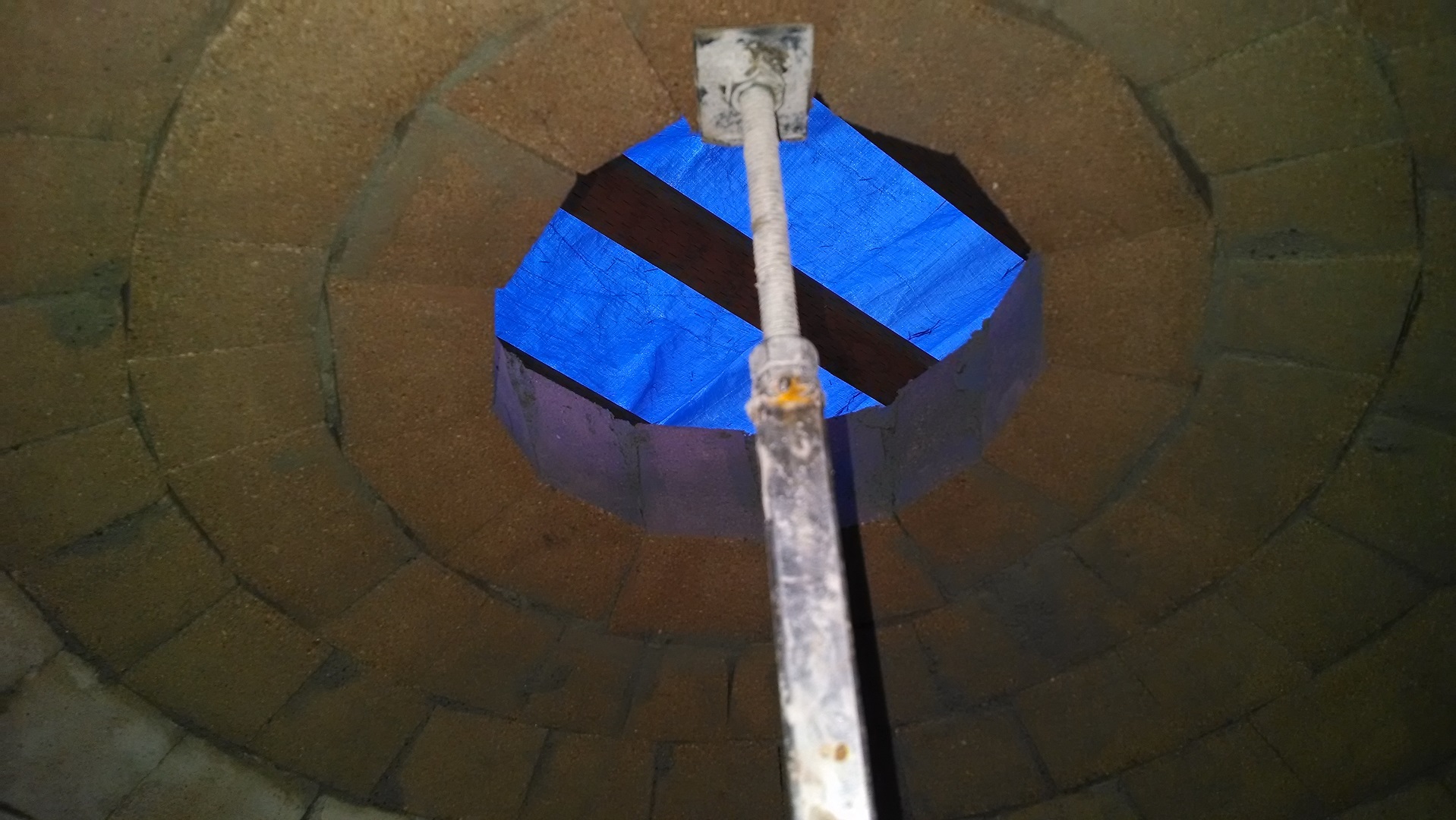

  • Yeager, I had some trouble with bricks when I got near the top and was starting to get frustrated, but then I got on a roll and things went pretty well. Here is what I did. Bricks had to be dry(ish), not waterlogged. I mixed up some fairly wet mortar, and wiped the brick and mating bricks on all contact surfaces with a wet sponge (just enough to see about 1/8 inch of color change). If I didn't see a color change the bricks had too much water already. I buttered up a brick and used the IT to set it into position, quickly wiping off the excess mortar. After maybe a minute to a minute and a half (about the time it took to butter the next brick) I repeated the process. My IT was mounted such that I could remove it without knocking the brick loose, but only if I did it right after I set the brick (hold it with one hand while freeing up the IT bracket). With this method I was able to finish off each row, then allowed them to sit overnight where they were firm enough to start the next row. Some have had good luck with setting a single brick overnight, when I tired that it ended up thunking down on the floor when I tried to place the first brick in the morning. I also could not let the bricks set too long before I laid the next brick or the previous one would fall. I had the best adhesion with the wet mortar just after they started to grab. I found when I got a row in quick they seemed to support each other, and in these upper rows the bricks are pretty much straight up and down. If the bricks are too wet, or mortar too dry, I could not get them to stick when I tried to place adjacent bricks. If I had to jostle a brick after it set for more than a minute or so it would fall. Working quickly with "grabby" mortar did the trick for me.

      I made a small platform that fit over the IT which allowed me to put 1" strips of oak on the platform to support each of the bricks. For the 11th course I put screws in them so I could adjust the pieces up a little bit. Then for the 12 th course I cut it so it was a perfect 8 piece ring that I didn't need to do much to fit in. It did this so quickly that only my wife managed to snap a picture of the sticks, but not the platform that allowed me to hold them up and swivel my IT.

          • Hey all,
            I got my 10th row up today (and the starter for my 11th and final row). I ended up getting some 5 gallon paint sticks from Home Depot, cutting notches in them, and waiting 1.5 days for the starter brick to bond before touching it. With waiting a little longer for it to cure and the sticks it was fairly easy - thank you for all the help!

                      • Had a great weekend with family and building! I ended up putting leftover concrete block from my stand next to arch wall to support outward pressure. It will be hidden behind the structure I am building so figured it would be easier than adding two more layers of brick. I just drilled a hole for rebar in each block hole and put in 24" rebar then filled each cavity with concrete to make sure it doesn't move,There is a 1/4 heat gap on the arch walls and will continue on the actual arch also. I still used insulating brick to keep the outward arch wall to prevent any heat transfer to wick into concrete stand.
                        On my internal dome picture you'll see some gaps on some of the upper brick. Unless you guys think I am crazy, I don't plan on filling them. I don't feel it is a structural issue and will have 3/4 - 1 inch mortar on top of the dome by the time I am finished. Thoughts?

                          • Hey Yeager it is looking great. I don't think I would worry about the gaps as you called them. I did not really go back in and add anything after I closed the dome. I also set my cement board flush with the edge of the stand. I did not do the whole lath and scratch cote. I was advised by someone on the forum I think it was Tscar to use polimer fortified thinset to adhere the stone work and I just went straight to the cement board. I did use cultured stone not real so I don't know what you are doing or if it would make a difference.
