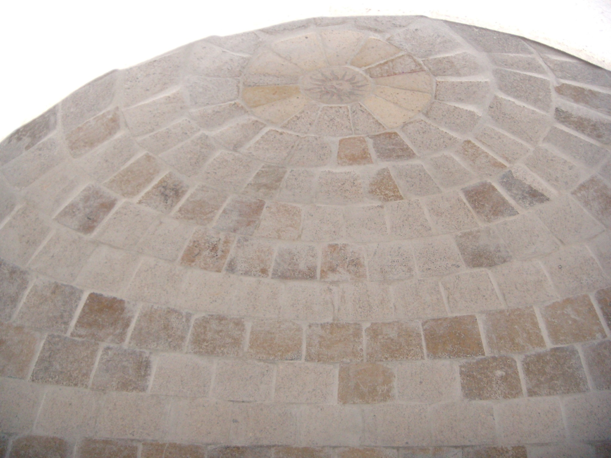

                            You may have to start using 1/3s to eliminate the horizontal joint gap and eventually 1/4s or a combination of both. This is up to you. You could feather each side of the bottom to reduce the gap but that is a lot of work. Attached is a pi c of my dome and you can see how I had to use smaller width bricks as I moved up into the upper courses.

                              Thank you for the rapid response sir and I always love seeing that keystone plug with the sun on it. It’s a thing of beauty. If I’m seeing this right it appears as though you went to 3rds at about the 7th chain, which is where I’m at now not counting the chain at floor level. I believe it’s a great solution to my problem. What I have going is a mess. I’m gonna knock that other one off of there now, and skinny up my IT (it’s too big now anyway even with 1/2 bricks). Those 1/3 bricks should be easier to work with too?
