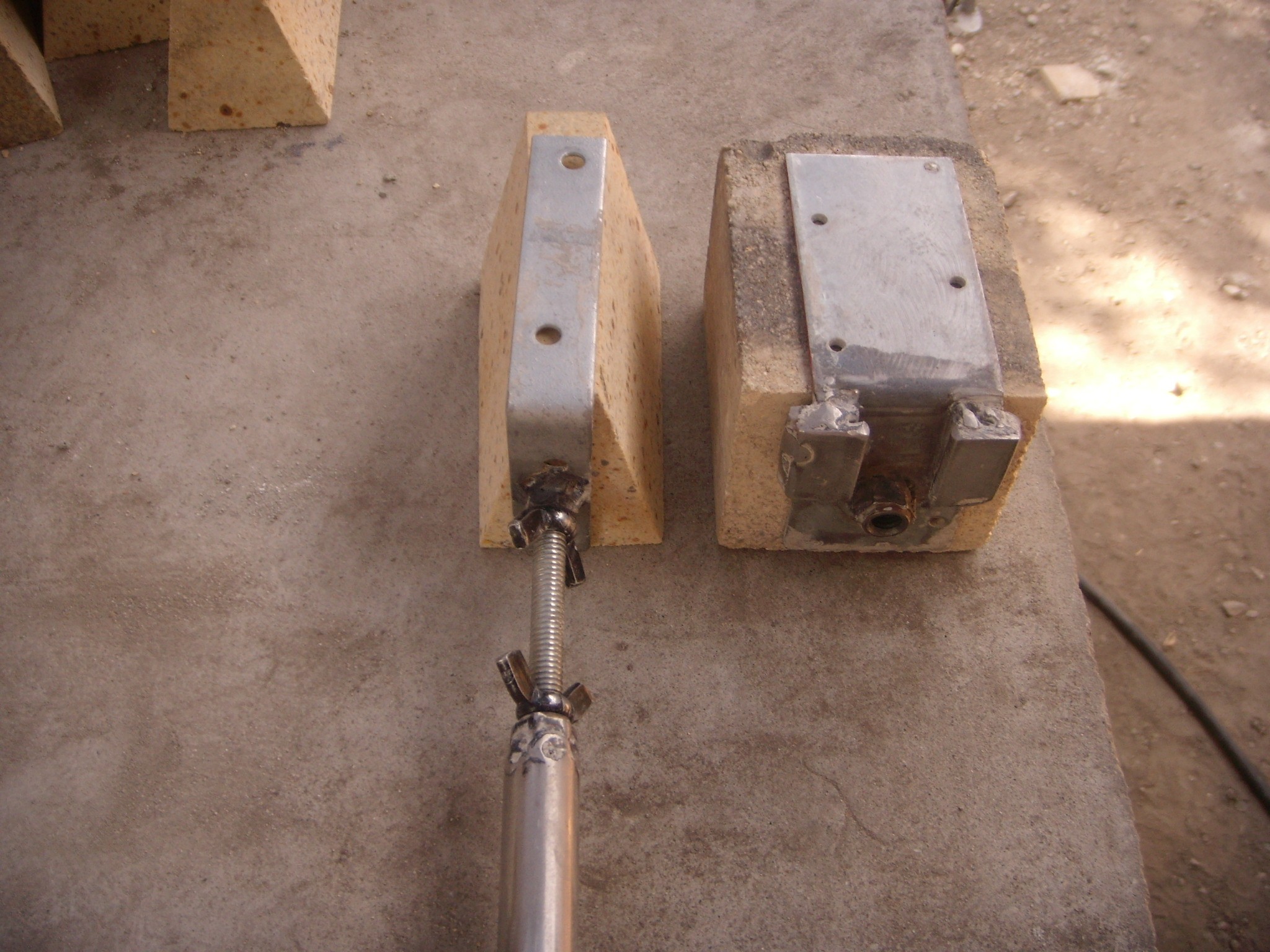

Name:	53H IT Mod 8.10.12.JPG
ID:	418420 My last course before the plug the inner brick width was less than an 1" wide. See attached pic.
