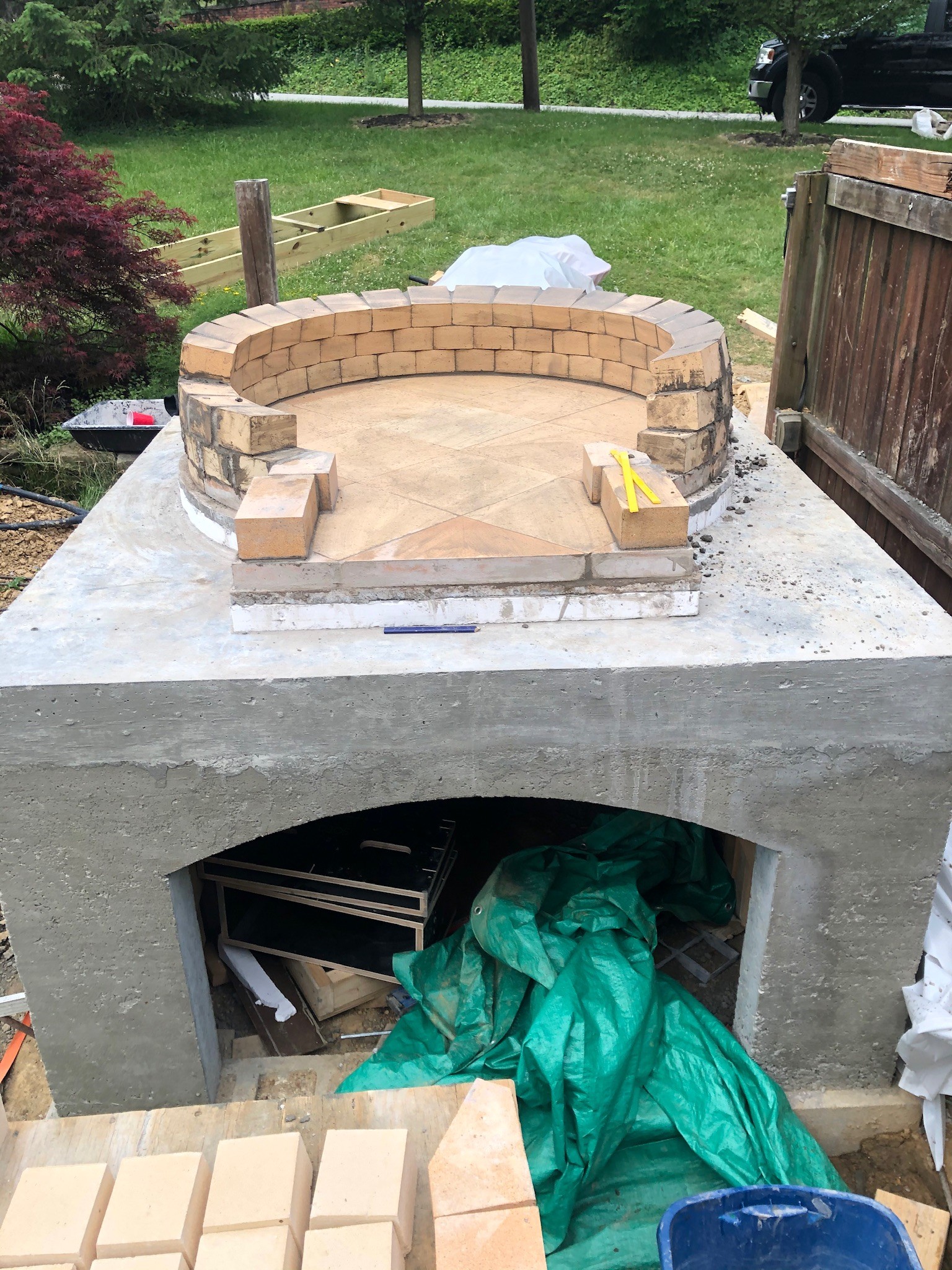

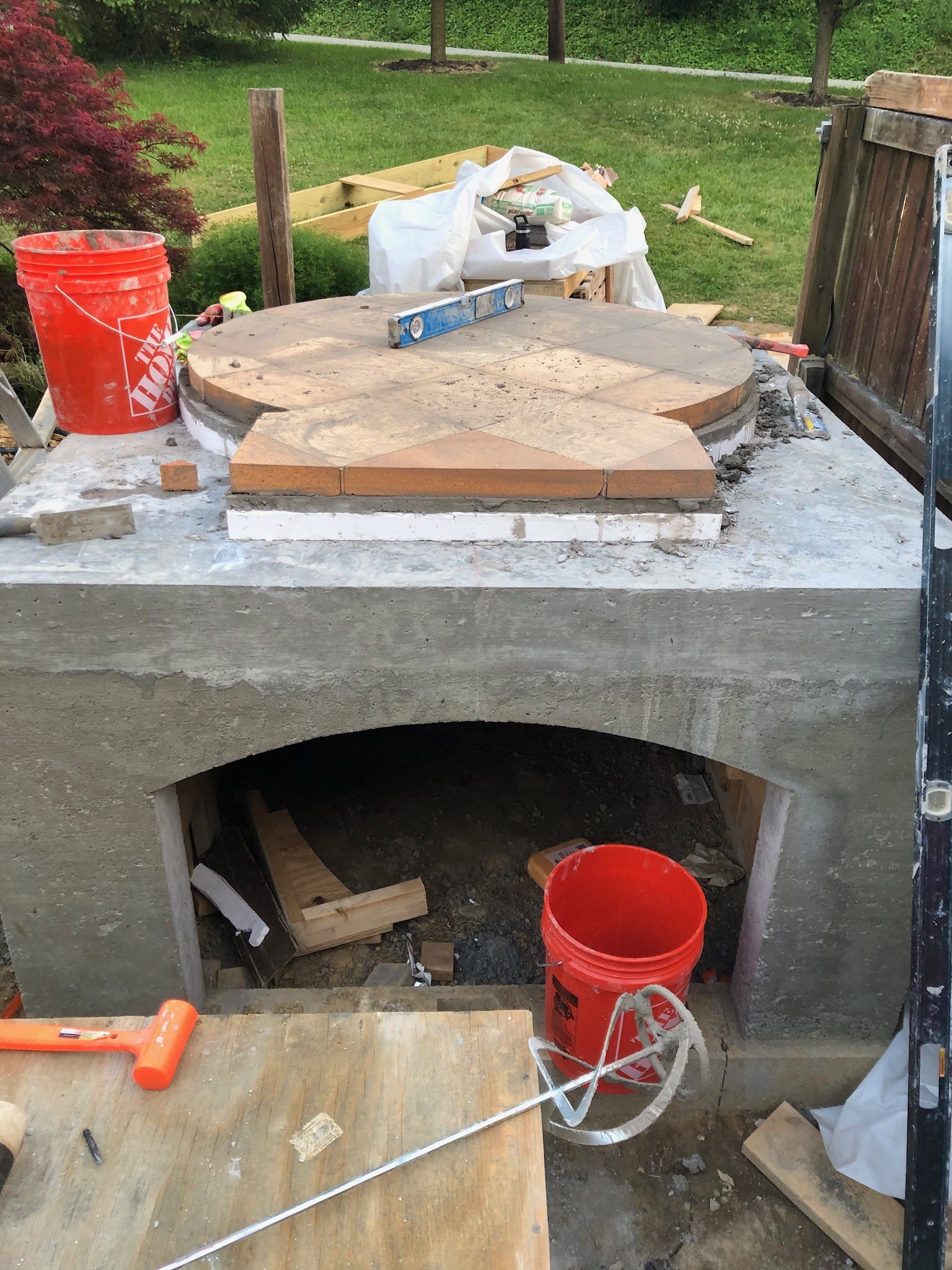

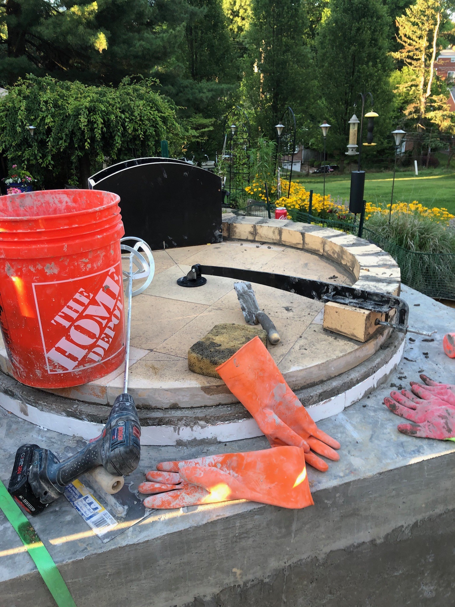

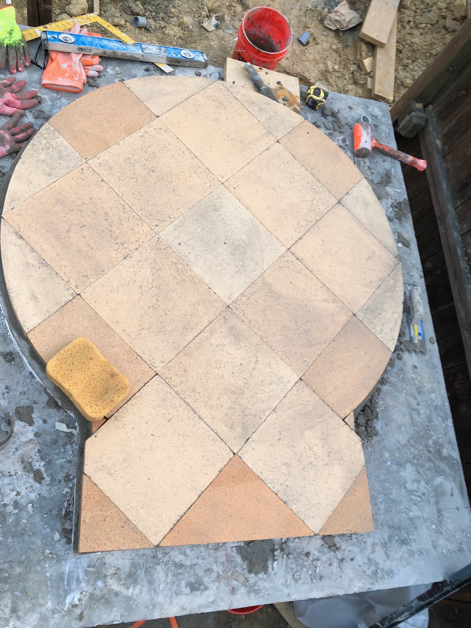

        Today’s updates
        Oven floor completed on Monday, but I did pry up the front 3 tiles and one to the right and reset them. They were the first ones I set on Monday and I was not happy with their flatness. I. Noticed it. Ugh more this morning than in the waning light last evening.

        last evenings progress.

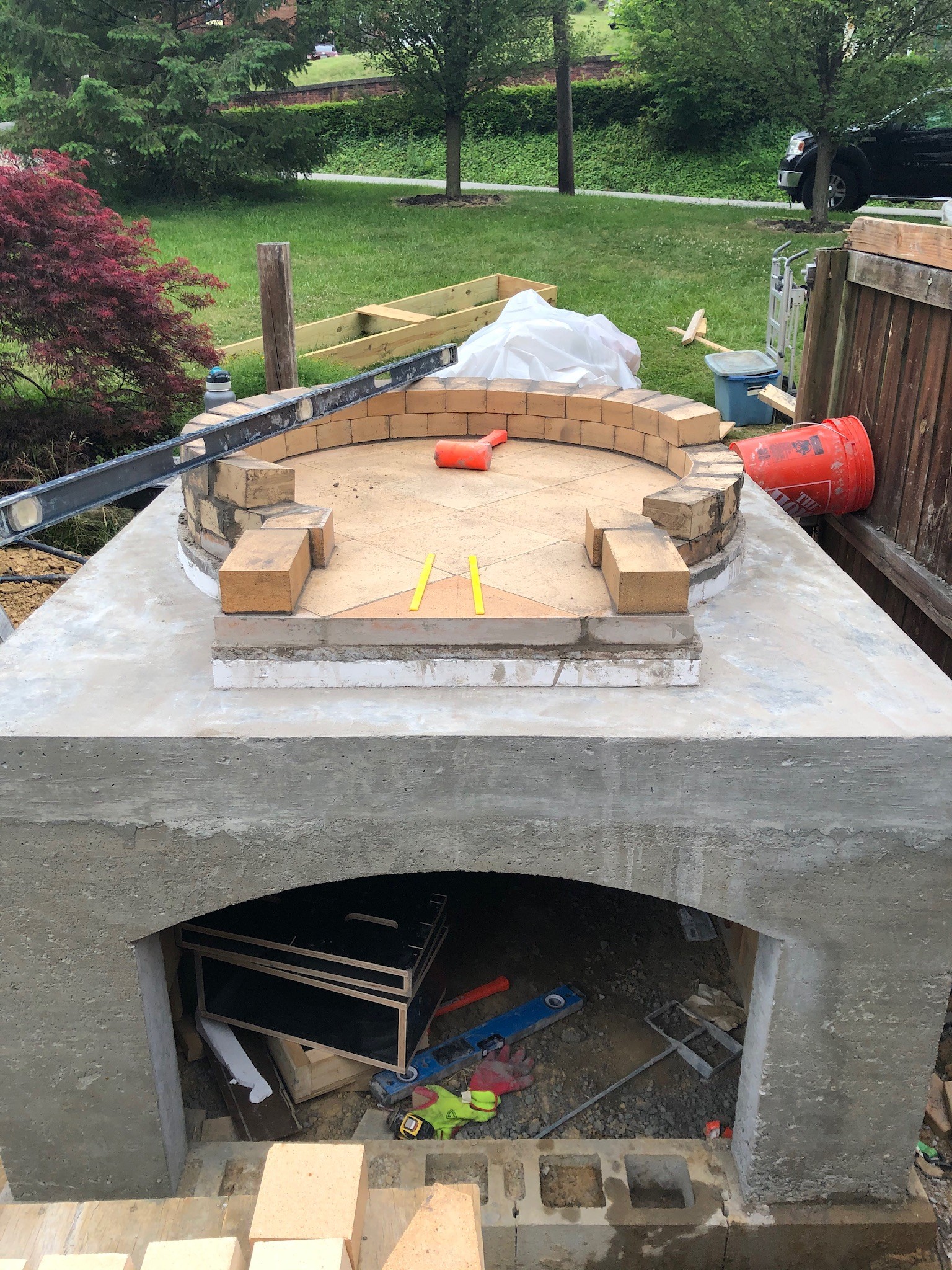

        The bird’s eye view

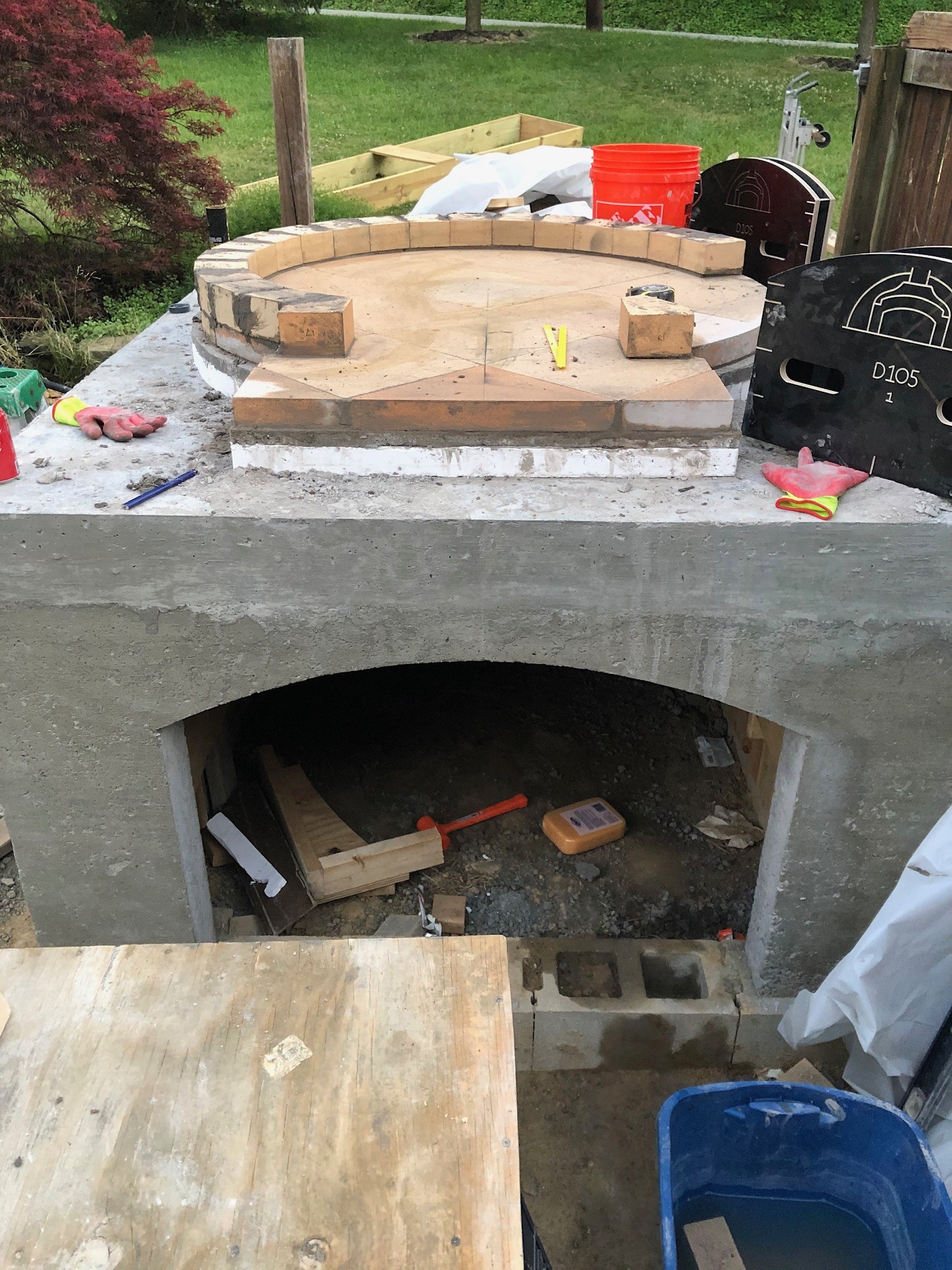

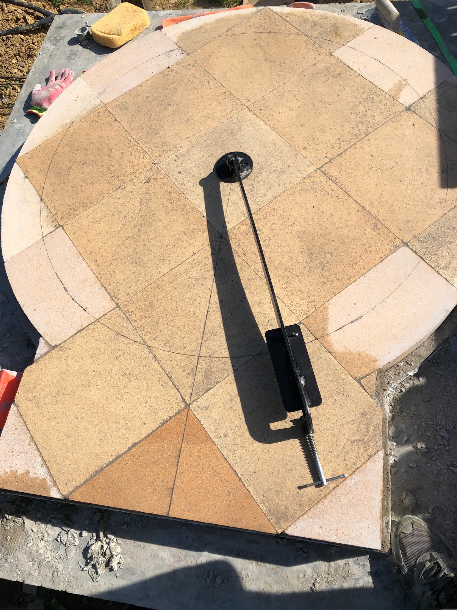

        getting trammel setup and marking arch area.
        FWIW the trammel in this kit is very well made. It is a fixed radius, but the larger kits have a variable length/pitch trammel for non hemispherical domes.
        arch form in place and 1/3 of the first layer done. The mortar (2 part) in this kit is far easier to work with than the heatstop I used years ago. I am actually enjoying working with it.

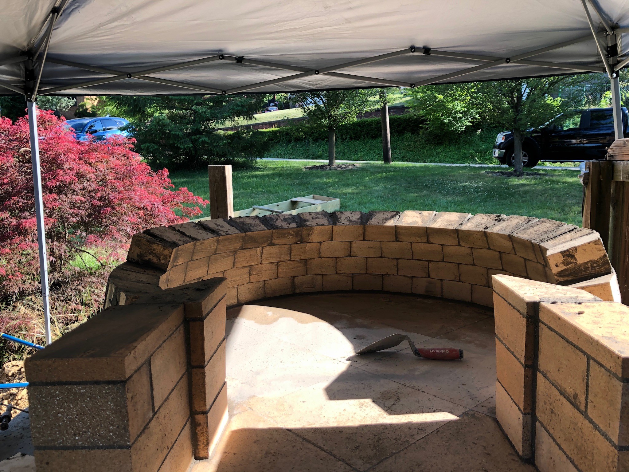

        losing daylight... these went fairly quickly. I should be able to make good progress working for an hour or two each afternoon.
        • #34
          Today’s update:
          Worked about 2.5 hours.
          Got about an hour of brick work in and the rest of the time was prep, site cleanup and mortar cleanup. I am going to cover the floor with ramboard. I spend as much time cleaning as I do setting brick.
          You will notice a slight dip in 2 of the back bricks. I did not notice this until I began cleanup. It took every fiber of my being to not rip them out and reset them. I don’t know if they were both slightly undersized or I didn’t bed them well enough. I image I am going to be the only person to ever notice and I don’t want to start obsessing about perfection. Just trying to enjoy this and not stress about being perfect. I think I can easily sort it out on the next layer.
          Click image for larger version  Name:	09887B76-A297-4777-904E-BE606D38857A.jpeg Views:	0 Size:	1.01 MB ID:	424159
          finished layer 1 and 3/4 of layer 2.
          • #35
            Looking good!
            • #36

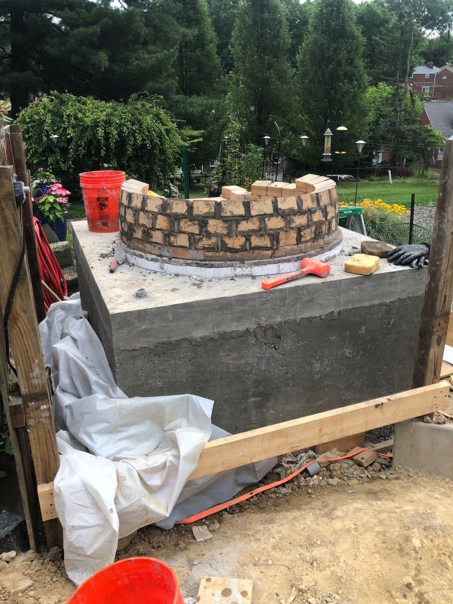

              Got another 2 hours in this afternoon and finished most of the third layer. Still very pleased with this mortar, it is very easy to work with.
              • #37
                Rained out on Friday. Did get a few goodies in the mail to be revealed later...
                I may order the hemlock for the timber frame. Finishing the exterior of the oven under roof would be nice.
                i found a regional lumber mill that specializes in timber frame components. Pasawmill.com
                there are closer mills and suppliers, but 5 minutes on the phone with these folks, and I am sure I want to do business with them.
                • #38

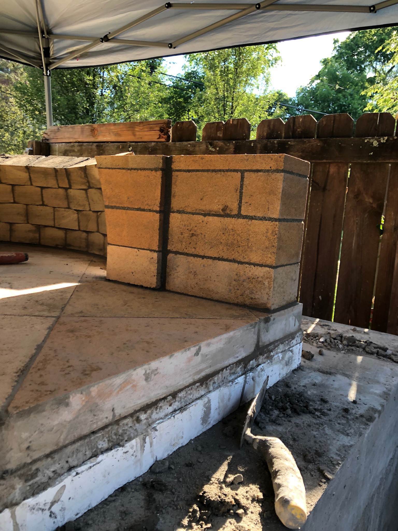

                  Got, a few more hours in today. I setup Anne up in an attempt to combat the heat and direct sun.

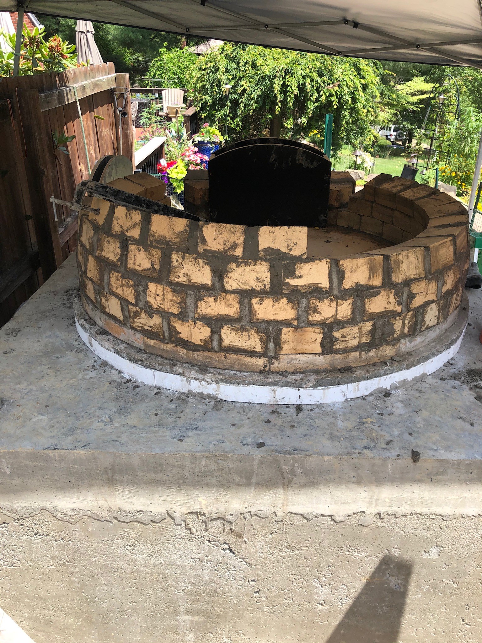

                  ez-up in place and working on row. 4 and arch columns

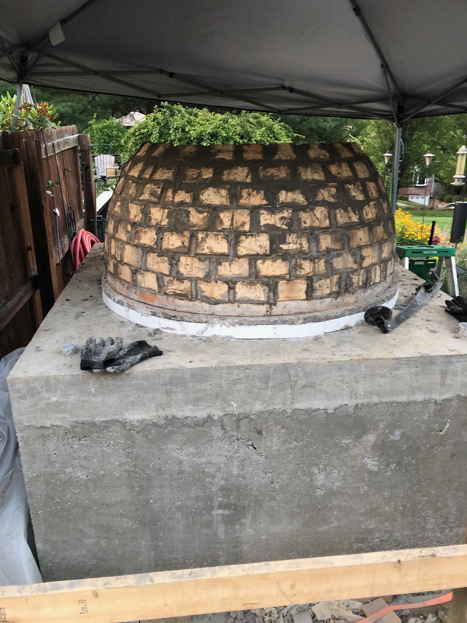

                  row 4 done... note I have not tied the rows into the entry area yet. Did not want to drag the wet saw out until I need to. Trying to bang out as much as I can systematically.

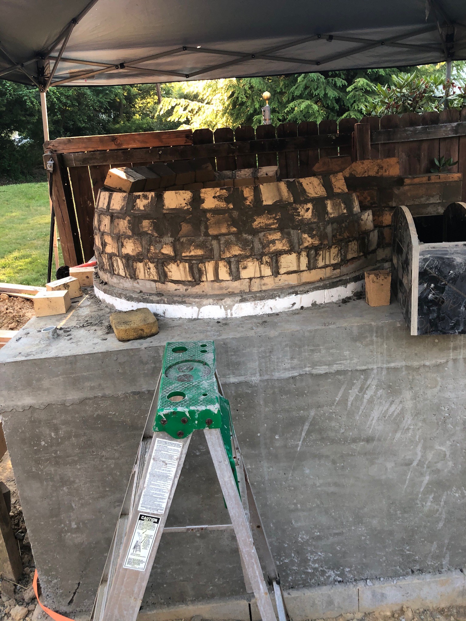

                  • #39

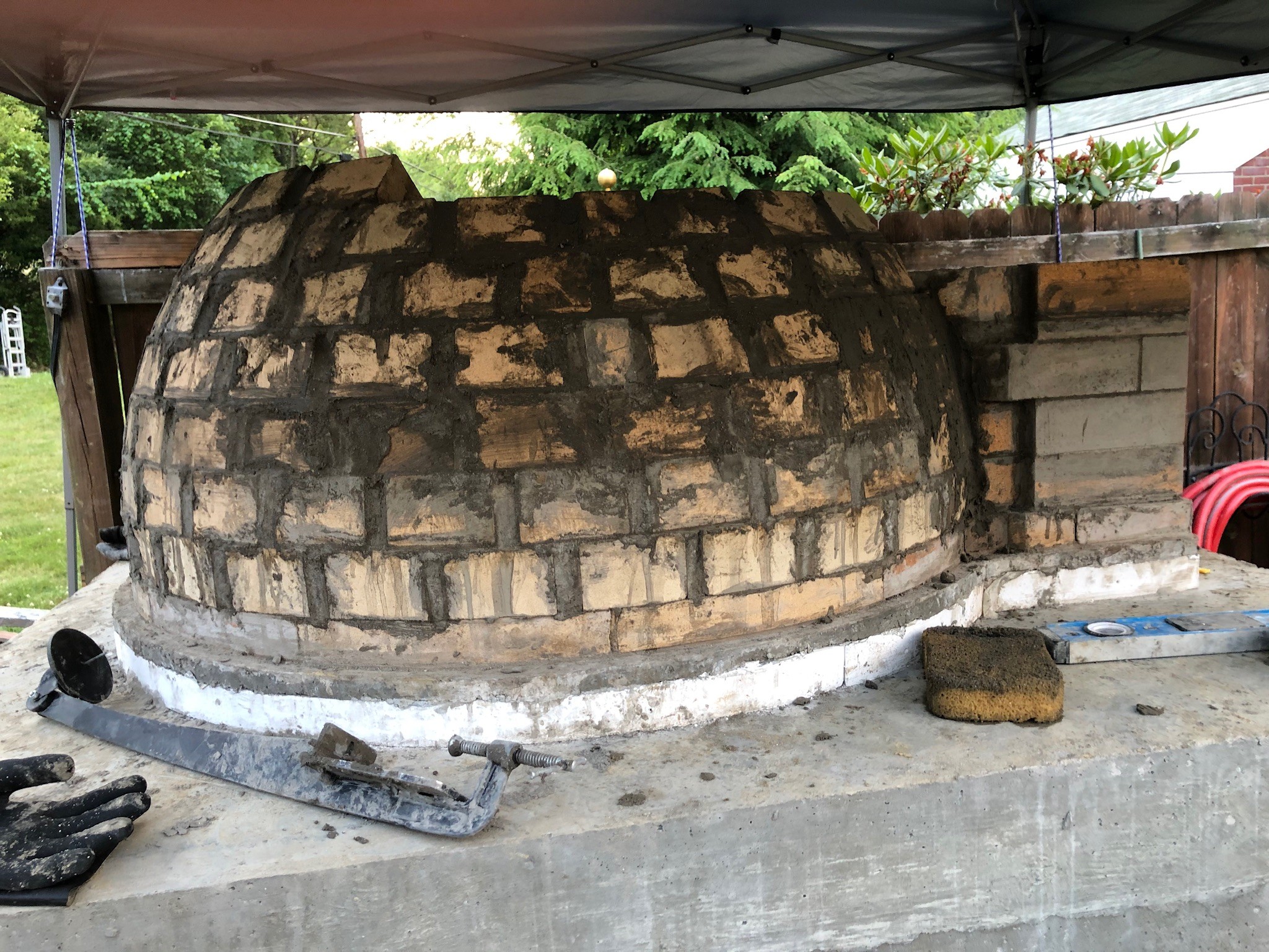

                    Spent some time today connecting the courses to the entry walls and adding a few more courses. Can’t go any further until I set the inner arch.

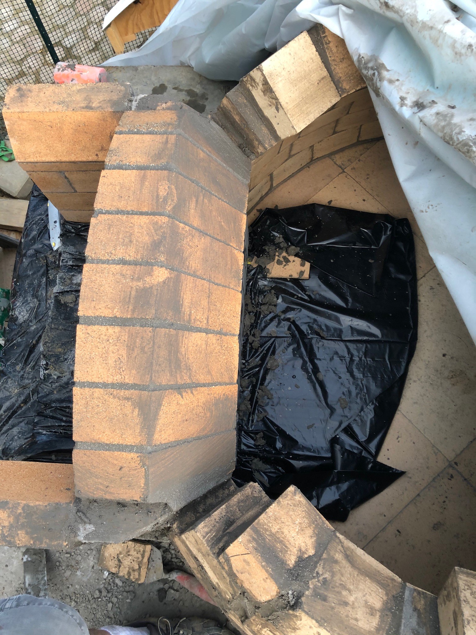

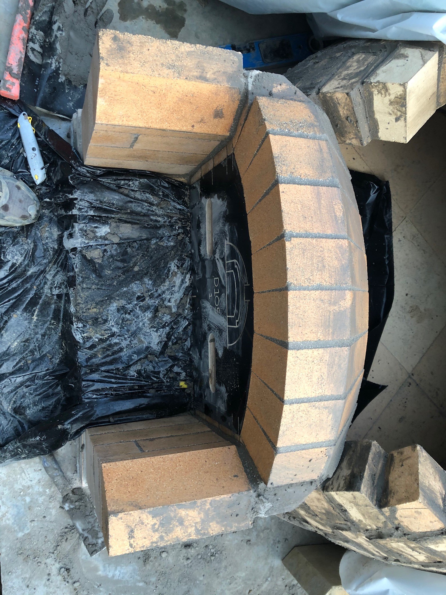

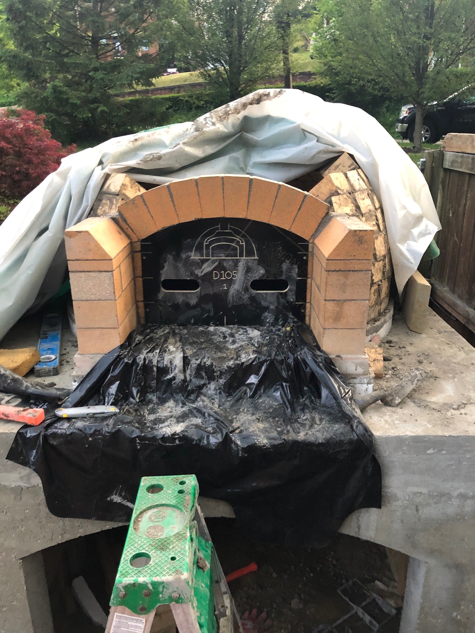

                    • #40

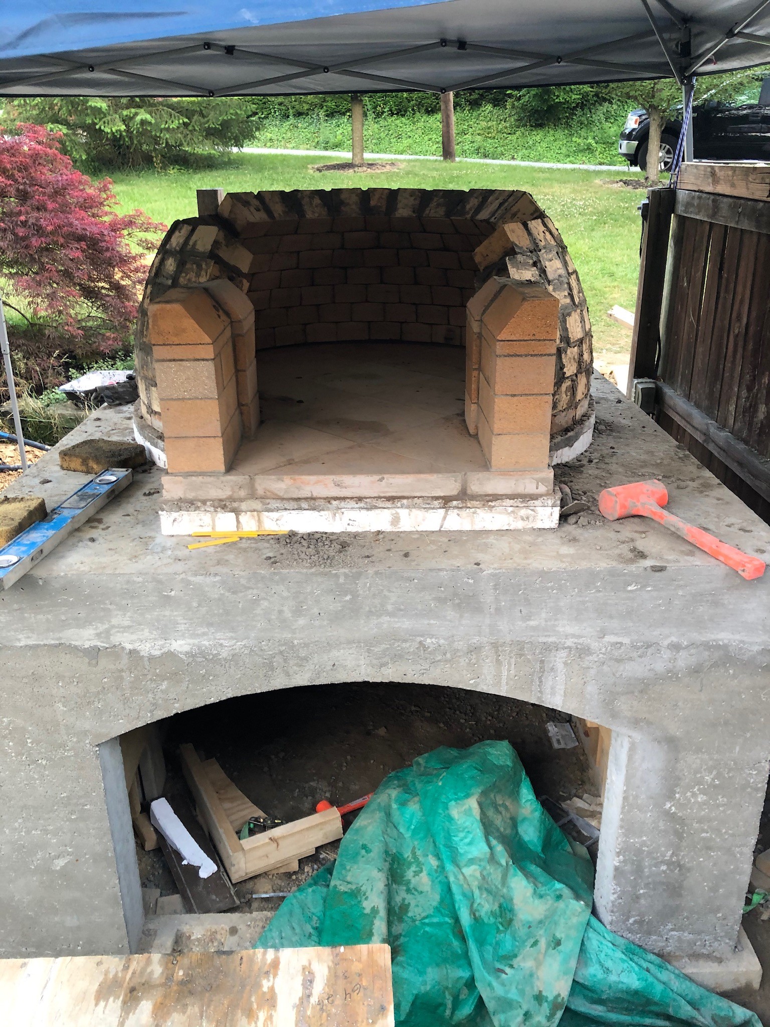

                      Rained out most of the afternoon. I was able to sneak in about 30 mins of work and get the inner arch set.
                      Click image for larger version  Name:	10B858E7-0AA5-4180-9319-903FEE7C3F8E.jpeg Views:	0 Size:	860.3 KB ID:	424542
                      joints are not perfectly spaced, it close enough. It was good practice for the outer arch. I have a better eel,for then go to get things adjusted and aligned. One brick is slightly leaning to then left. Ohh well.
                      Very nice arch form in he kit. The markings were a big help for keeping things symmetrical.
                      Click image for larger version  Name:	7EDBBE86-080A-4A50-B714-E31ACC326AF4.jpeg Views:	0 Size:	850.1 KB ID:	424543
                      still a little cleanup to do before dark
                      . Click image for larger version  Name:	97147B83-2ECC-4433-9E2A-49EEABB7302F.jpeg Views:	0 Size:	924.8 KB ID:	424544
                      I set plastic under the form, as it [the form] will not be removed until tomorrow. I hope to have less cleanup of dried mortar.

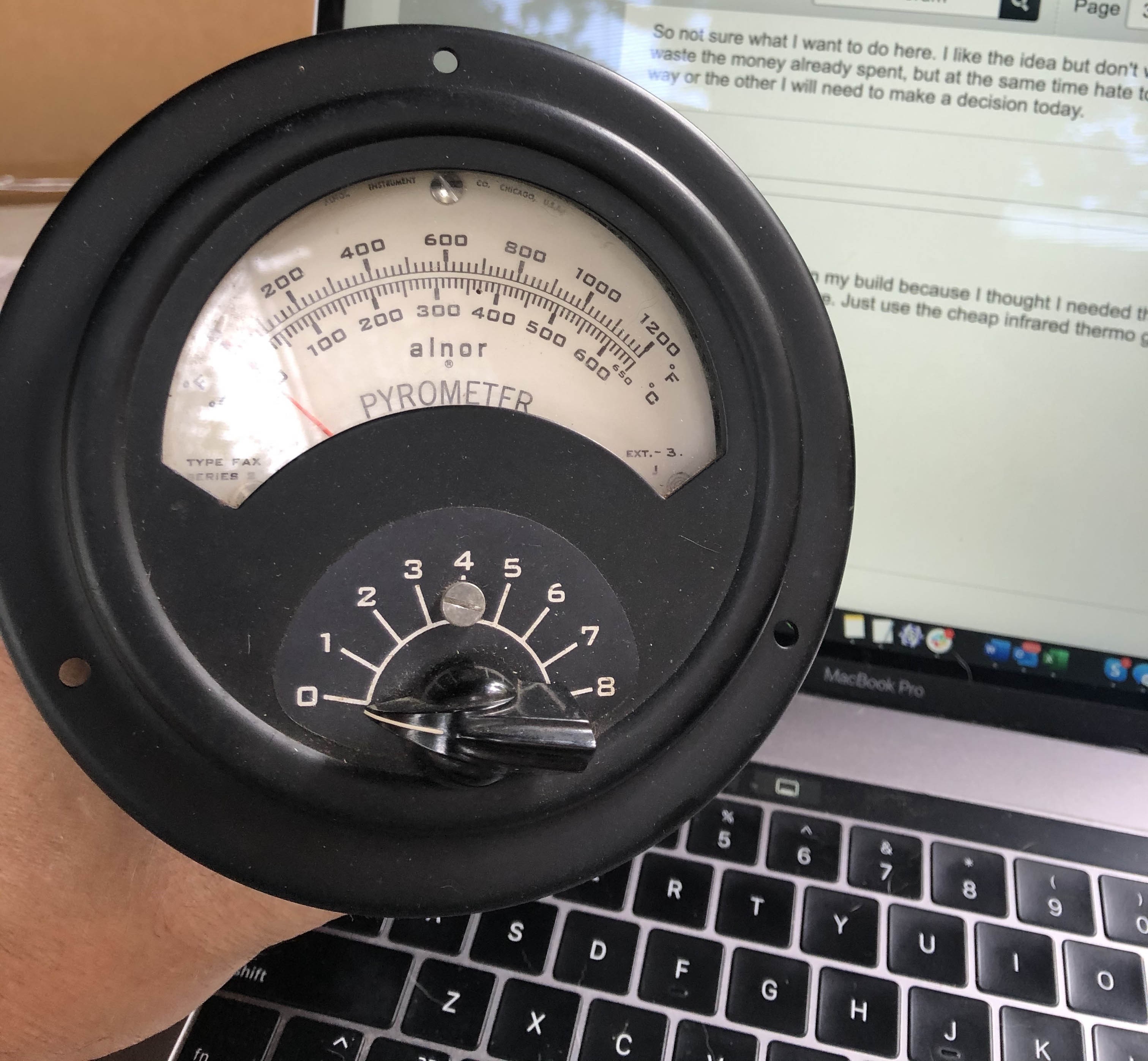

                                So I purchased one of these - mostly because it looked cool -- It has 8 positions, uses type-J thermocouples and is old. Produced from 1930 on to maybe the late 80s? This unit appears to be from the 50's or 60's given the appearance of the backalite back plate material. They were apparently used for manifold and exhaust temperatures on trucks, and large diesel process equipment.. patent 1,798,896, granted 1927. Anyway, my "must have syndrome" got the better of me and that send me down this path.
