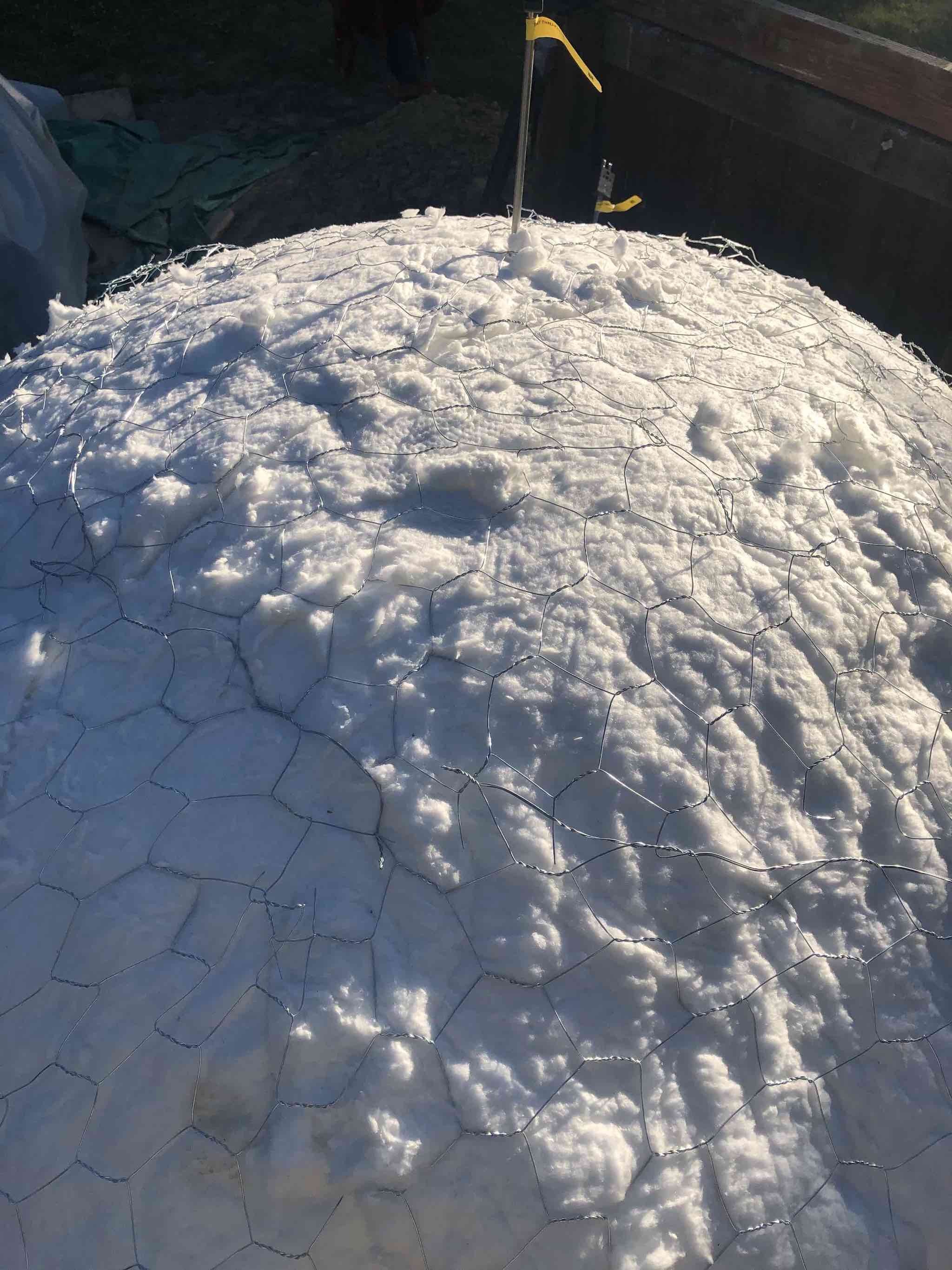

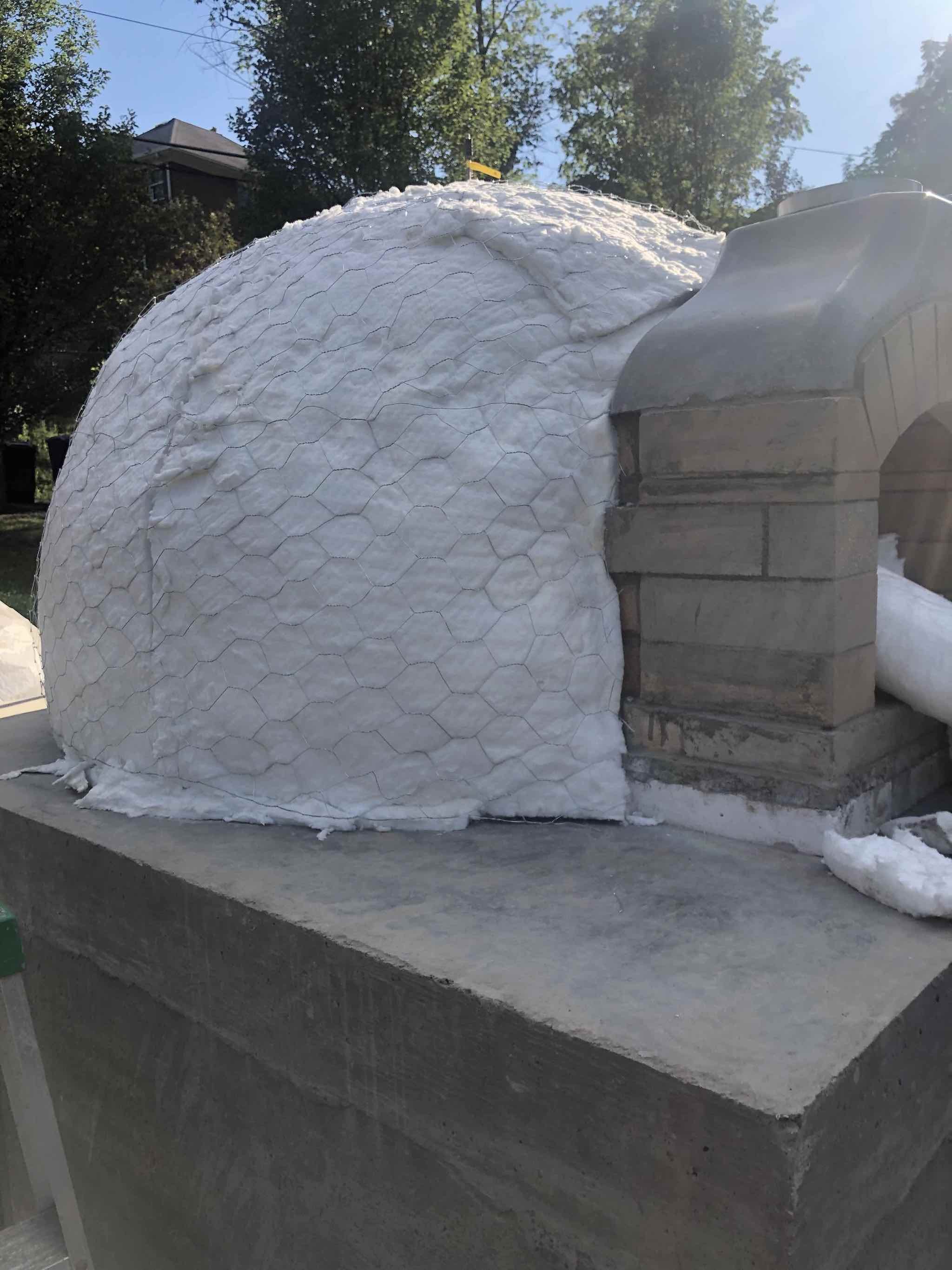

                      I got all 3 layers of blanket installed this afternoon and held down with chicken wire. The stuff that came with the kit is MUCH higher physical quality than the stuff I ordered from skyline components. I have no idea how they compare in regard to insulating quality. The china stuff is rather delicate, much more friable and much easier to compress. Both are the same density.,

                        #71
                        Photos tomorrow....
                        I contemplated adding a 4th layer of ceramic blanket, but simply do not want to wait for shipping or track down overpriced local supplies. I have no idea where the point of diminished return is.
                        i decided to just go ahead and apply an inch or so of perlite render, mostly to secure the ceramic blanket fibers. I was not overly careful about neatness or shape. I got a late start and finished in the dark. Tomorrow will be interesting.
                        Anyway, I am ready to start curing and move on to the enclosure.

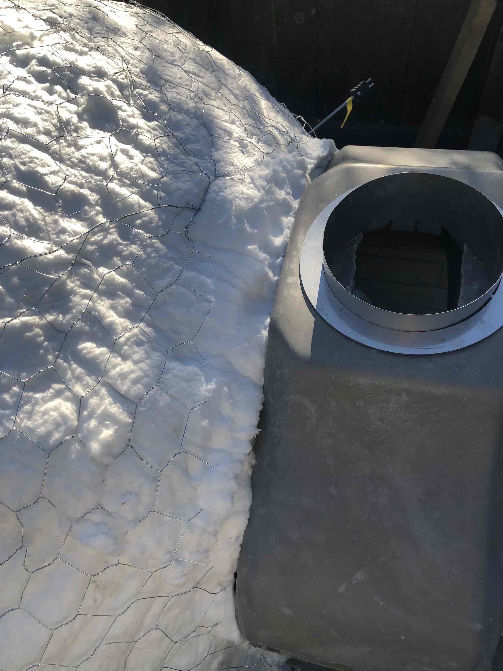

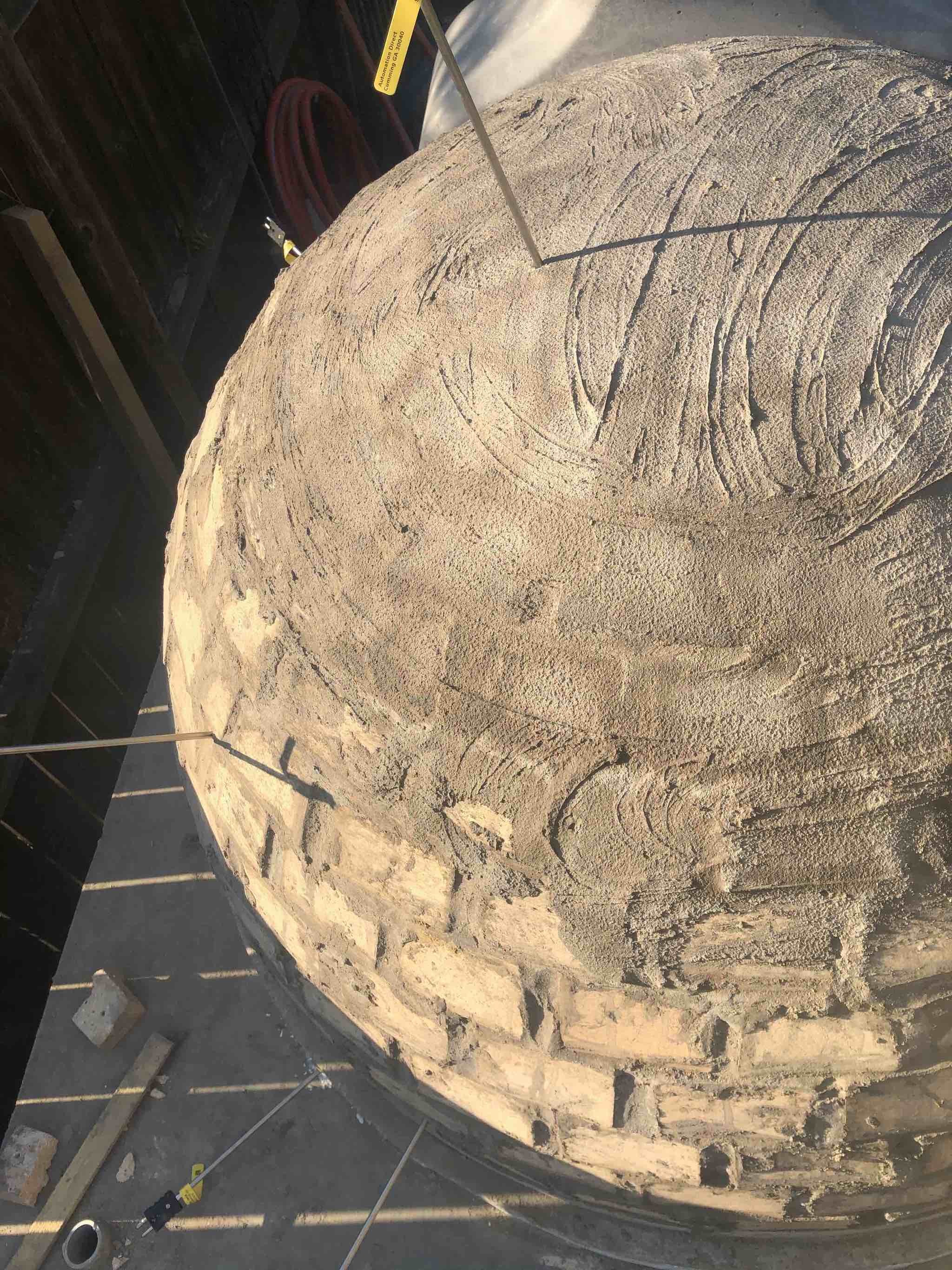

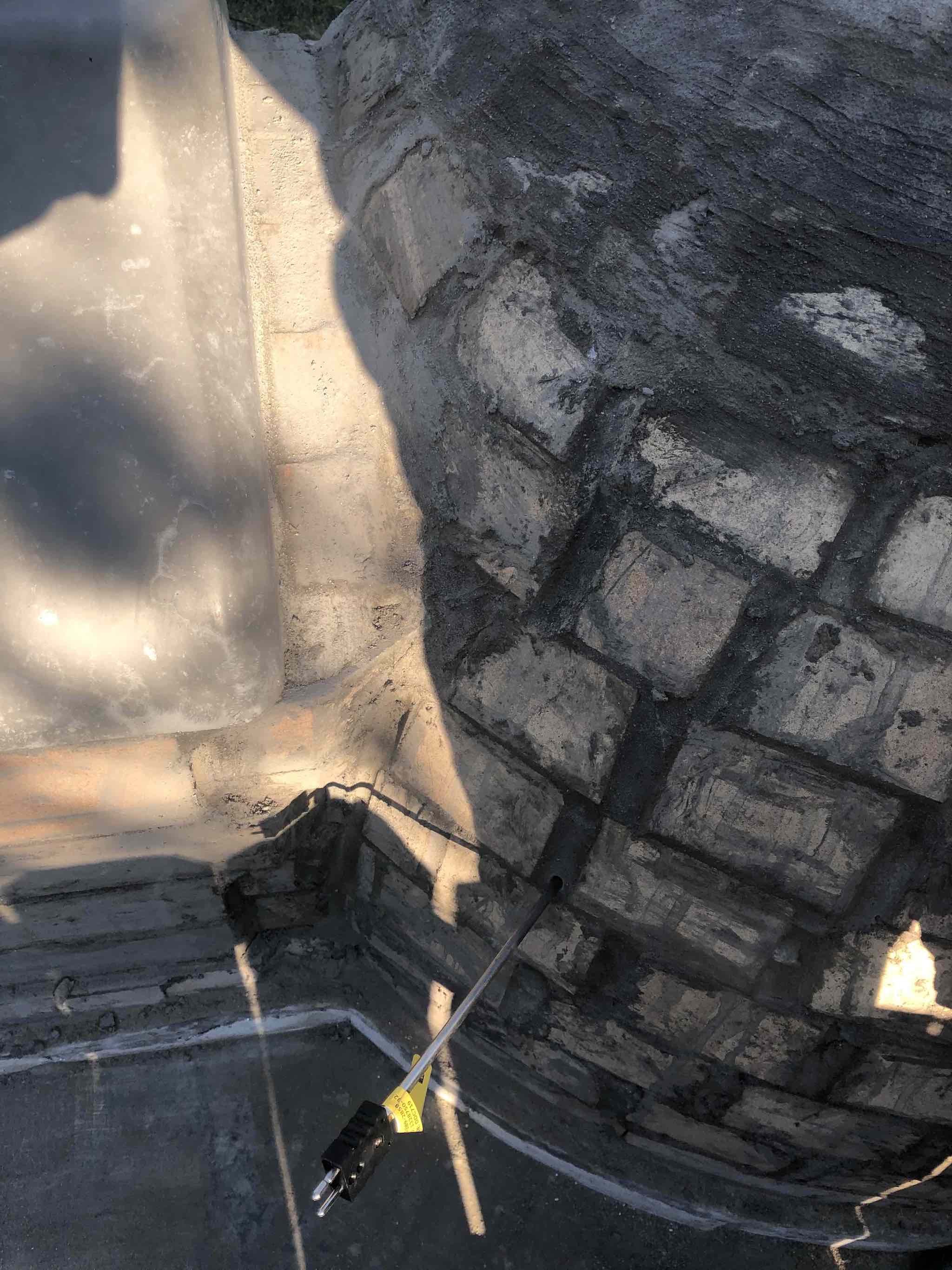

                                Thanks for the update! Glad to hear there is minimal cracking or damage. I have not had a chance to start curing fires yet - I just can't find the time and have instead used the spare time to continue working to complete the oven.
                                Sadly, I have not had time to update this thread.
                                I also realized that I did not take any photos between insulating and house construction, so there are no photos of the overall perlite render process or final result. Ohh Well.
                                I ended up with 3" of blanket - kicking myself for not going with 4" - ohh well.
                                The entry area will also be insulated - but I wanted to get the structure in place first.
