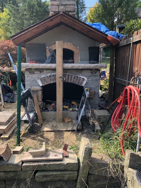

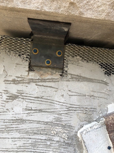

  • Limestone landing (5x12x77) lifted into place with angle iron supports (5/16 tapcons shown) . Landing stone is fully grouted under and not going anywhere! 400 Pound lift was actually not too bad. It only took two of us and a third to standby for safety. Absolutely ZERO lippage between landing and oven floor - I couldn't be happier. A single jack board was used to support the barely balanced stone until the angle brackets were set.

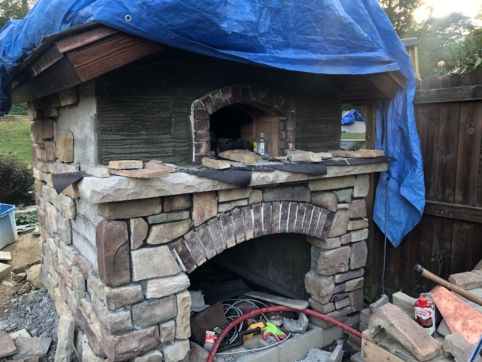

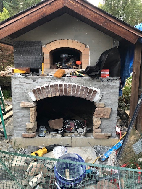

    • Entry arch set this afternoon. Scratch coat on front tomorrow and hopefully stone this weekend!
      getting closer every day.

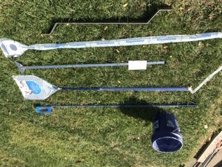

              Gi metal order showed up.
              8” stainless turning peel
              14” aluminum placing peel (they steered me away from the stainless model, said this was better)
              brush
              ash tool
              divider... don’t think I needed it, but why not spend more money
              sorry for the upside down.. iPhone exif data tries to “correct” orientation even if you rotate prior to posting. So stupid.

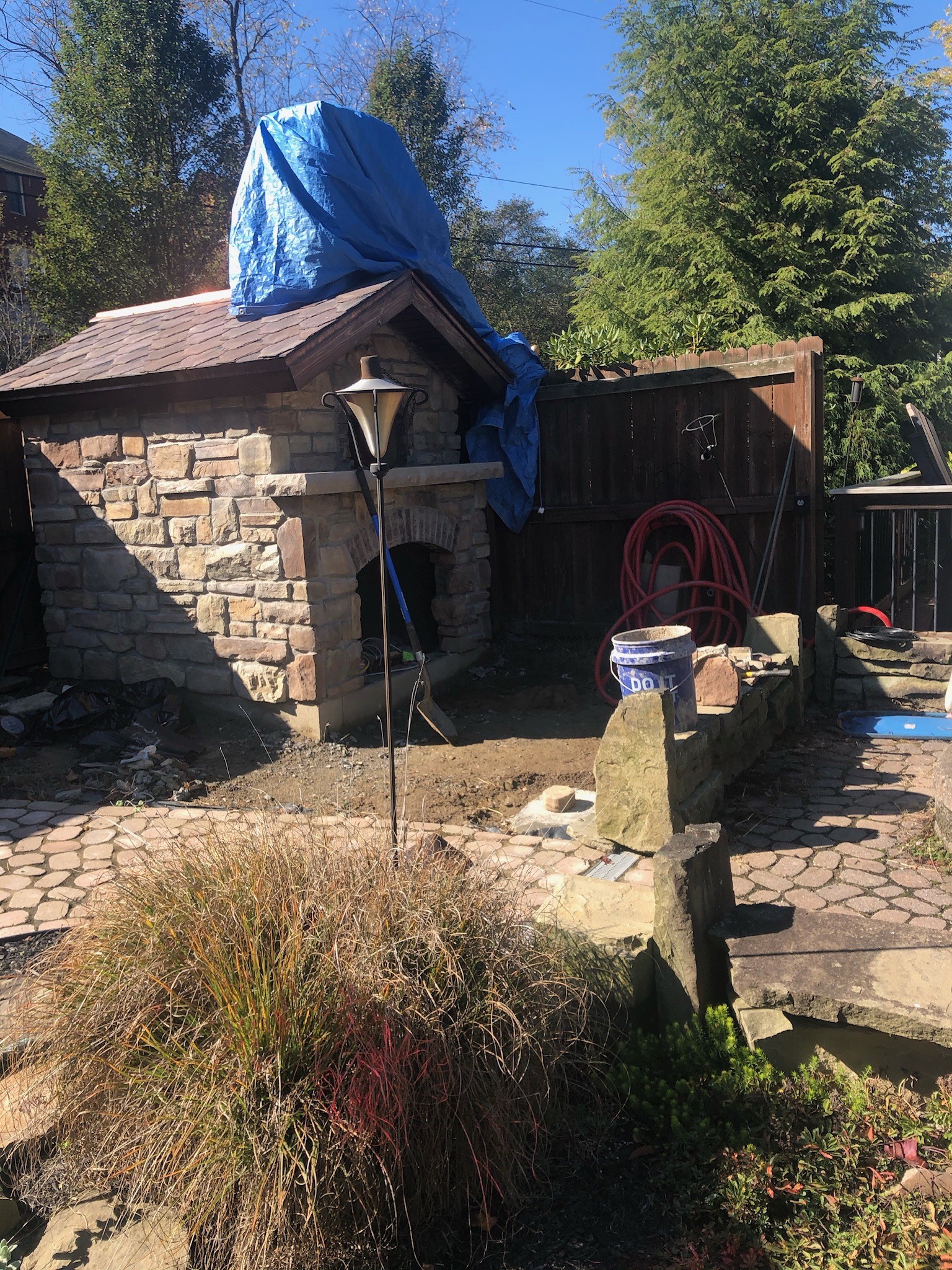

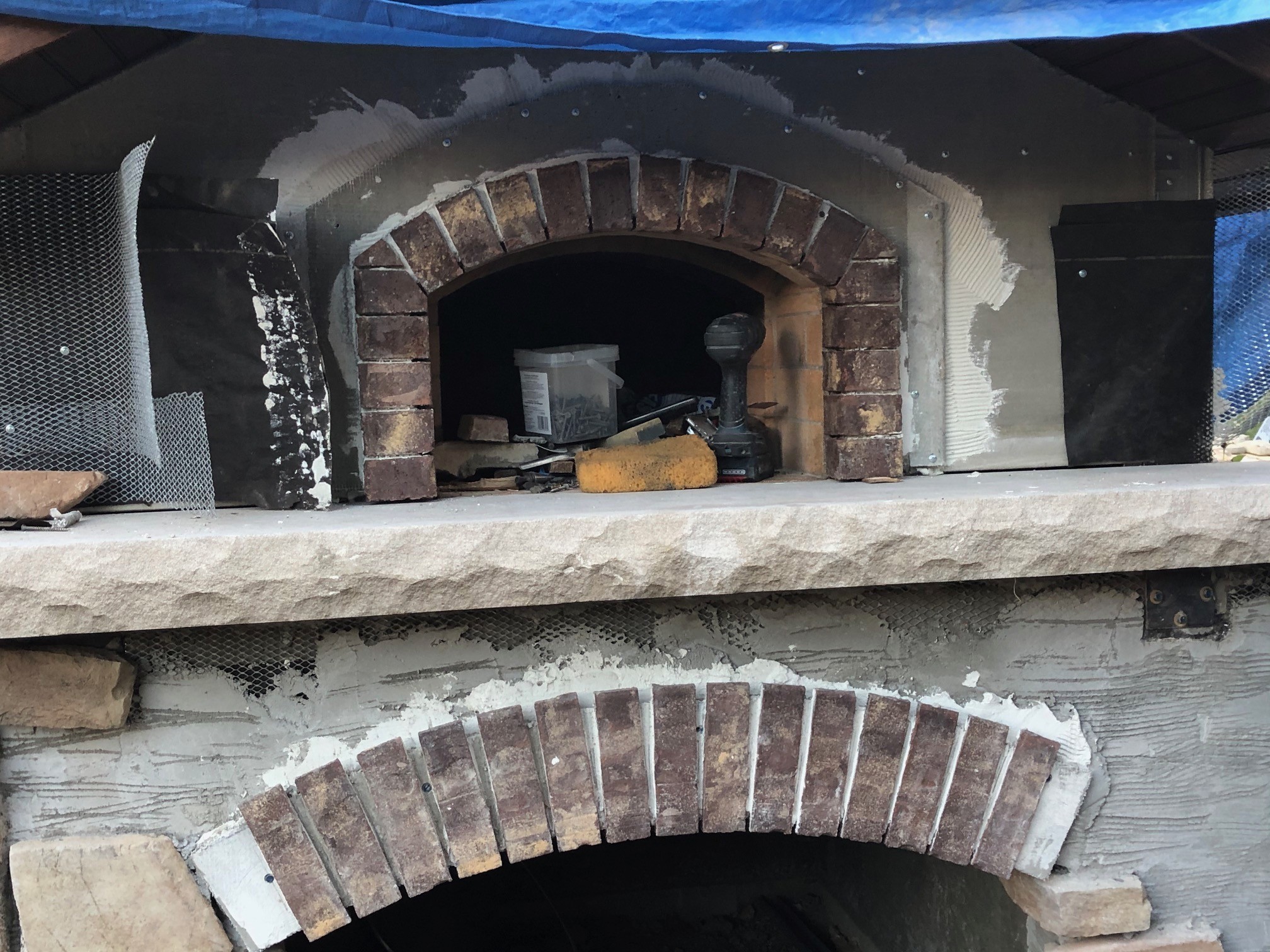

              • Lower arch area covered with stone and upper area scratch coat complete. Click image for larger version
                • I had some grotesque (gargoyle style) corbels picked out, but have decided to skip them. I liked the idea and have several in the garden, but not sure they really matched the overall theme. Polling friends and family revealed “meh... I do t think you need them” and the landing support brackets are barely visible from any low seating angle around the fire pit area.

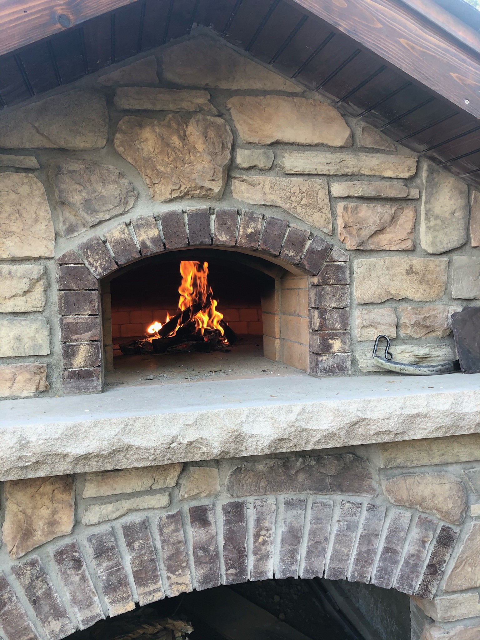

                  • Click image for larger version
                    almost done! Chimney still needs a cap and counter flashing.
                    last bit of. Or tar around arch bricks needs to be finished.
                    couldn’t help but pour a drink or two to celebrate.
                    Landscape work and a standing area need to be done before the snow falls, but hope to be to pizza temps by this weekend.

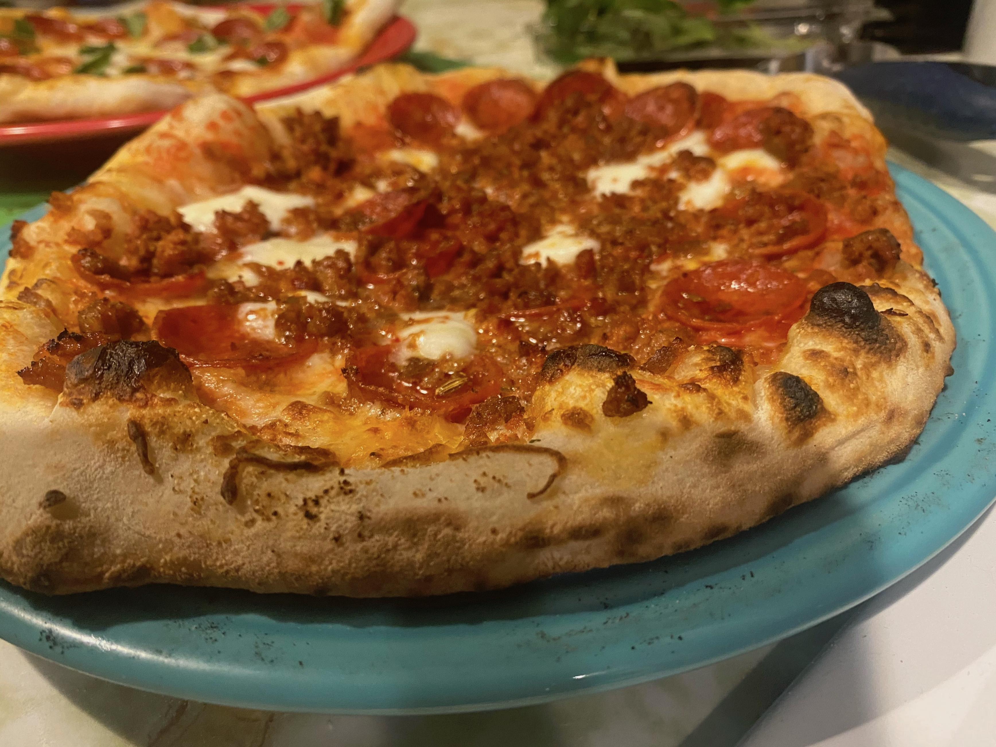

                        • Okay - Pizza temps today
                          900+ upper wall and ~650 ~750 floor depending on location.
                          Satisfied but a lot of learning to do.
                          FB dough per PDF and same FB recipe using the modified tscar method. Both used weight method.
                          The dough was made last evening and refrigerated until about 3pm today. I made two pizzas, 1 from each dough, knowing that I will prefer longer aging, but eager to give the oven a try.
                          I used a food mill and canned san marsano - I don't like chunks. Sauce was a bit thinner than I had hoped. I need to work on this.
                          I used fresh moz on one and dry on the other.
                          The watery sauce and fresh mozarella made for a soggy mess. Edible - but not even close to the desired result. No photos...
                          The second pizza turned out very well. However, in my eagerness to ensure I was not burning the bottom, I stretched a hole in it with the turning peel. Lesson learned, once placed, let it cook long enough to be turnable.
                          My only complaint (aside from the tear) was that I pulled it out too soon. I like my pizza a bit more done but was unsure on how much it would continue to brown as I pulled it out. She was really sizzlin!
                          That brings me to my next question. How do you manage the gooey burnt mess that mistakes make on the oven floor, placing peel and turning peels?

                          • That looks like a great first attempt! Wel done! I find, if I have some spilled cheese or some such that it burns off easily enough by respreading some coals, then sweeping the floor again. Unless if it's really hot, then it burns off pretty quick anyway.
