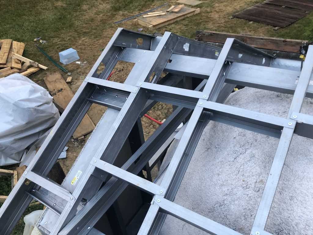

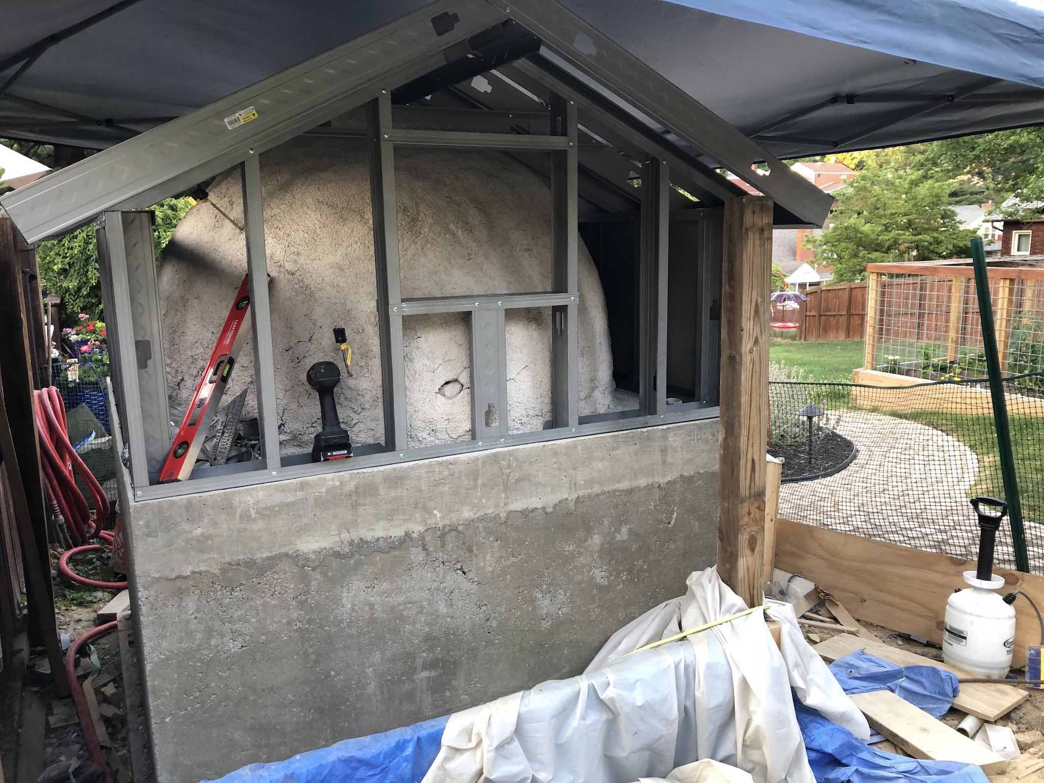

    For the structure (like many other builds) I chose to use steel studs.
    Without a HUGE hassle - only 25 gauge was available. Not pleased, but not willing to chase down #18s for such a small quantity.
    Following the theme here (bomb shelter) and the light gauge - I used 12" OC spacing for walls and rafters. This also fits the 3'x5' cement board dimensions better with far less waste.
    Also - I plan on a slate roof and a large snow load capacity, as the timber frame may get pushed off for a year due to timing and my workload.
    I framed for a cast iron "vent" in the rear that will be mostly hidden by the fence. This is simply for an aesthetically pleasing access hatch for thermocouple replacement. I may or may not actually go through with this.
    I got the order process started today for my veneer stone
    I also found a local slate expert (Joeseph Jenkins, http://josephjenkins.com/) willing to find suitable material in his yard and offer a bit of help/advice and his book as part of the deal. I am kind of excited about this actually.

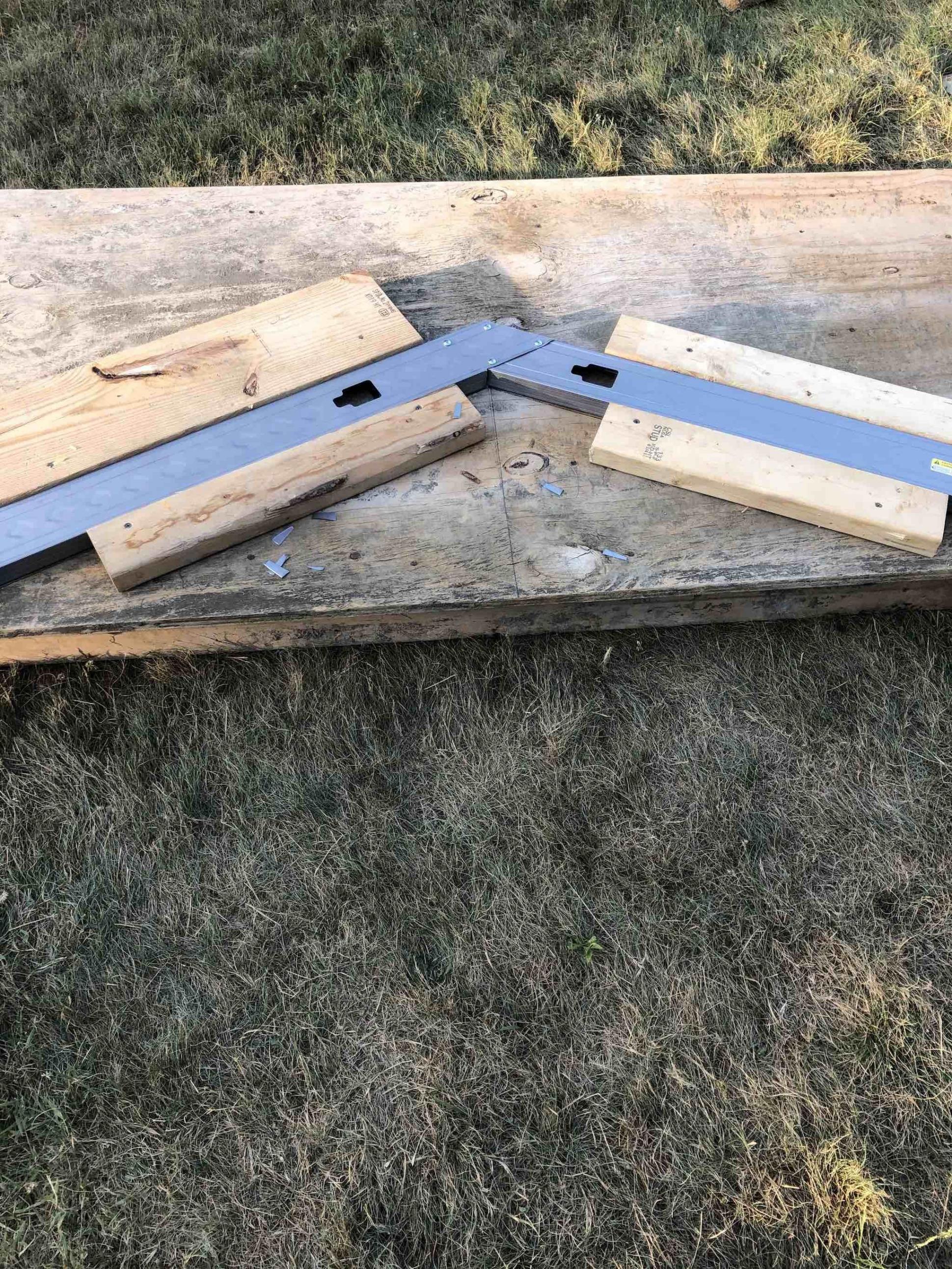

    I built a jig for the steel trusses, so that they were all the same shape. I then (not shown) assembled most of the roof on the ground by attaching the offset ridge tie and end channels. I then simply lifted it into place and started securing it and adding bridging (again overkill, but I have the spare steel).
    Excuse the few crooked braces - it got dark again and I couldn't see. I couldn't stand seeing these in the morning, so removed them and replaced them using the square.
    FWIW - there are no CAD plans for this portion. I started to lay them out and decided it was not worth the trouble. So just framing as I go.
