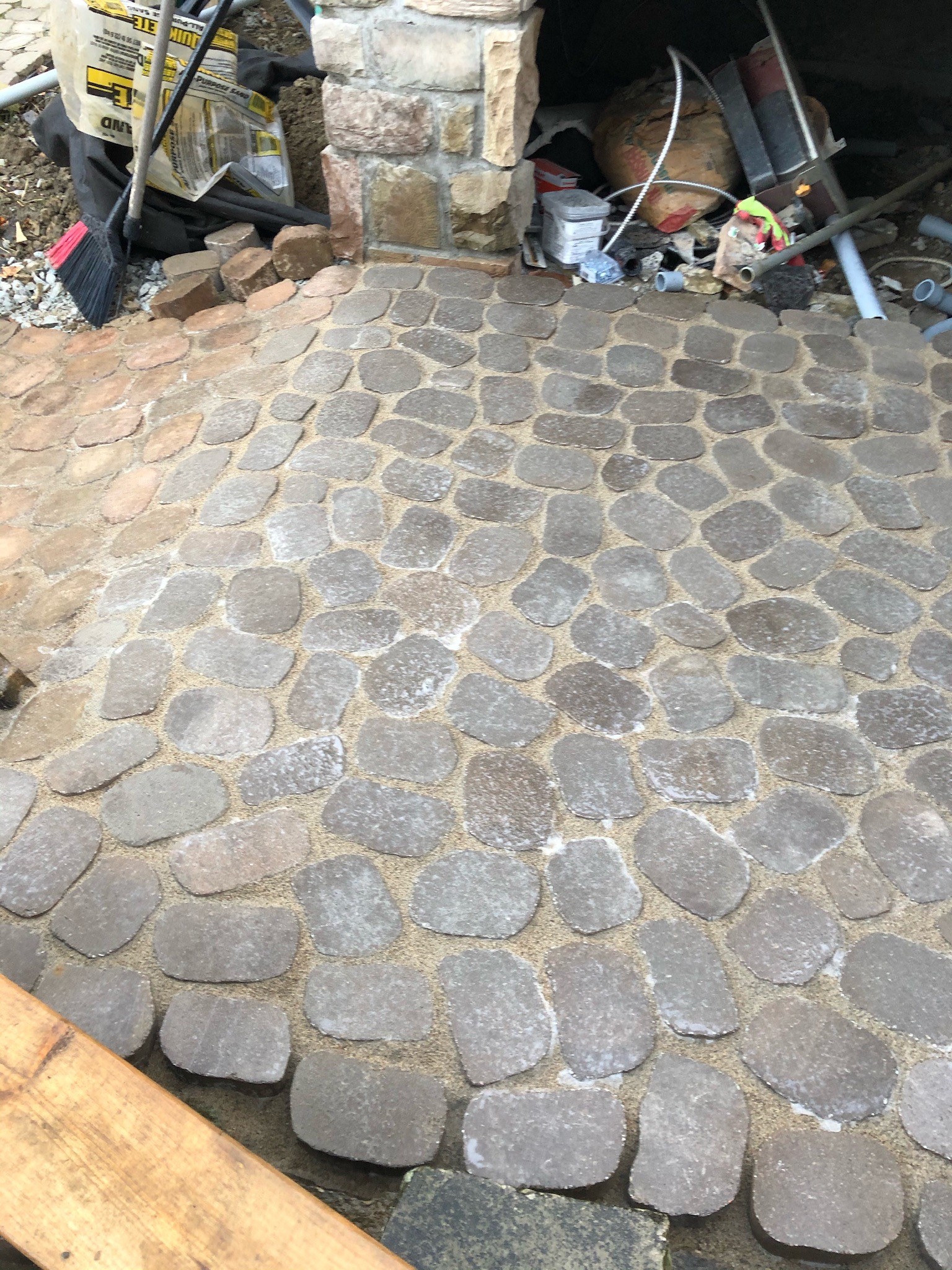

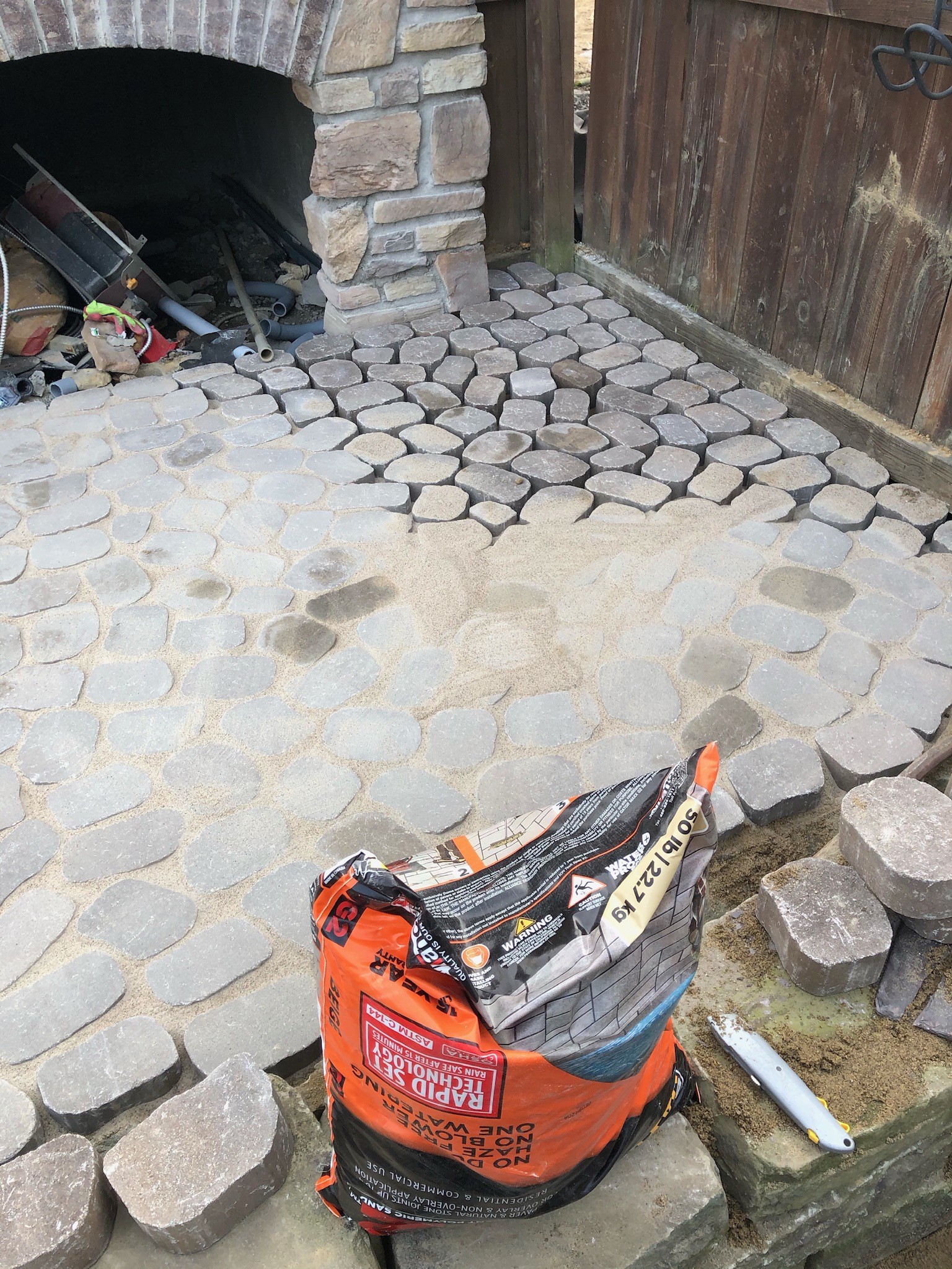

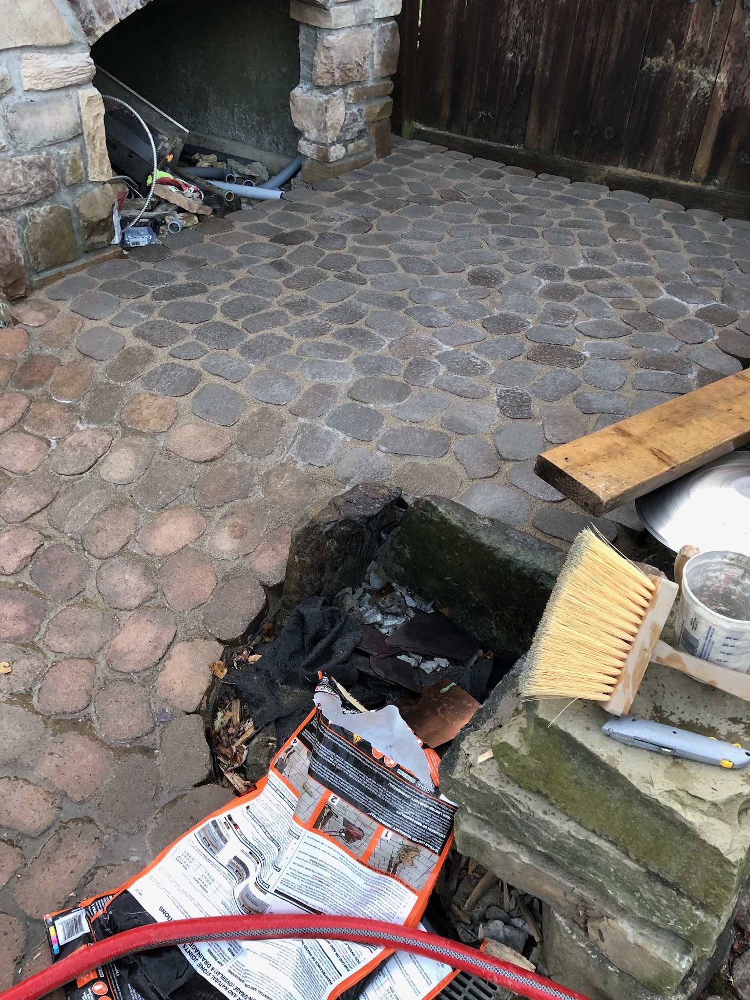

      Pavers (color) from previous work are discontinued. The new ones are close enough after install that they will look great once weathered in a bit.

        The bigger issue was that due to cost cutting these expensive ass tech-bloc pavers are no longer tumbled.
        Solution... I removed the mixing paddles in the Harbor Freight Mixer and tumbled them in batches.
        I will post a video of a get a chance. Noisy, but effective.
