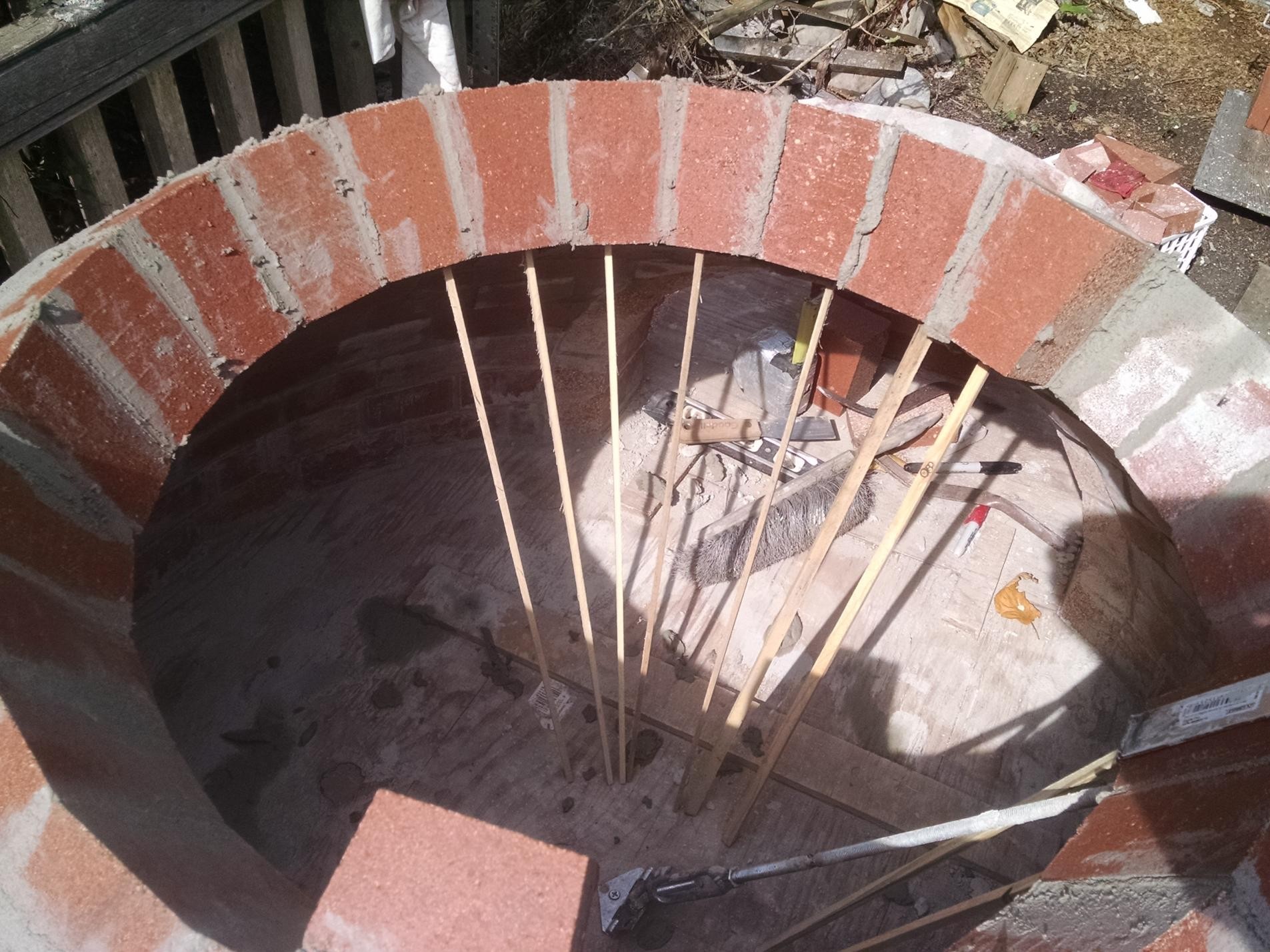

    A little slower going today as at the 6th row the increasing slant is causing the bricks to slide a bit. Putting some sticks in there to hold the bricks in place till they start to set up. Need to find a better configuration of "stick" so it holds on both the floor and holds the brick. I remember reading a pearl of wisdom from one of Russel's (UtahBH) posts about at the end completion of one row and before you knock off for the day, mortar in the 1st brick of the next row. This kind of adds a bit more "anchor" when starting the next row and the slant is increasing. So did that. Otherwise, moving along, some progress pics attached.

        Looking real nice.
        If you have a table saw, I ripped a bunch of thin sticks. Maybe 3/16ths square, maybe 1/4" or so. Thin enough to flex for a little bit of bend. But they friction stick nicely to the floor and brick just enough to keep the just mortared brick in place.
        And I agree, setting an anchor brick helps for getting the next course started as well. You can see mine for the next course in the foreground of the attached photo.
        Keep on doing what you're doing, you're killing it. Your oven looks terrific.

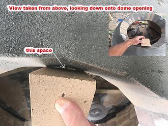

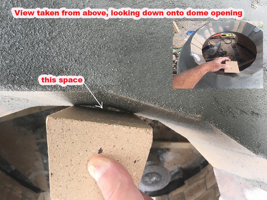

              Question about brick configuration higher up in the dome rows. I'm getting to row eight. The circumference of the brick rows is getting smaller. So now when the next row is placed, there is a noticeable space created where the 2 bottom corners of brick is sitting on the row under it (see attached photo). I suppose this could just get filled in with mortar. But shy of shaping every brick to get a tighter fit , basically removing the corners that are causing the brick to sit up that create that space, or maybe using less wide bricks..... any words of wisdom about this. Just accept that some mortar will show? Thanks in advance for your insights/suggestions.
                Click image for larger version  Name:	space.jpg Views:	0 Size:	205.9 KB ID:	431194
                You have maybe 1/8" gap there? I'd accept that for this course and let some mortar show.
                We all go through it...when do we go smaller?. From half-bricks to third-bricks, to slightly smaller than third-bricks, to...?? lol I think my final course prior to the plug might have been custom cut quarter-bricks? Close to it. I did shape the bottoms of those bricks in my final course to 'fill in' those triangles.
                Eventually FOR YOU, that gap will be too big. Or too many of your vertical mortar joints will naturally line up or stack on top of one another, and you'll want to go to a smaller brick to better maintain an offset joint pattern. Even though I was cognizant of offsetting my mortar joints, I still have some that line up. Sometimes I saw it happening, stopped, and cut a smaller brick for an infill. Other times I saw it, and just kept mortaring, understanding that I'd re-achieve offset after two more bricks. So even though I TRIED to do well, my dome by a purist's standards is not perfect looking. But it's been cooking perfectly fine for several years now, lol.
                There's also the issue of brick waste. You can leave a lot of brick dust and offcuts on the ground going for a 'perfect' dome. And again, nothing wrong with that if that is indeed what you want.
                You'll know when you need to shave those bricks, or when to altogether go to a small brick. Because honestly, only YOU know how you want your dome to look. In your mind, you might be there now! In so many ways it's simply about what you want, what your eye will accept, and simply how pretty your want your dome to be. Cooking-wise, your dome will still cook if you have an occasional fat mortar joint instead of all 1/8" mortar joints.
                For me, I didn't want to get in to the finicky-ness of shaving this corner and that. I wanted a pretty dome, and I wanted to do decent work. But sometimes shaving each brick individually can lead to inconsistencies around the course as you build out the course.
                As I wrote above, the only course of 'custom' shaped bricks I did was for my final course prior to the plug. I used a template to transition from the multi-faceted last course to an octagonal-shaped plug. See the photos below.
                In MY OPINION, with the gap you show in your photo, by tightening it up you're going for 'style' points versus 'structural' or 'significant improvement in performance' points. Nothing wrong with embracing style. I did where I could.
                You goal is to build a dome that will cook, as well as one you are proud of. Nothing wrong with pride!
                Best, Mongo
