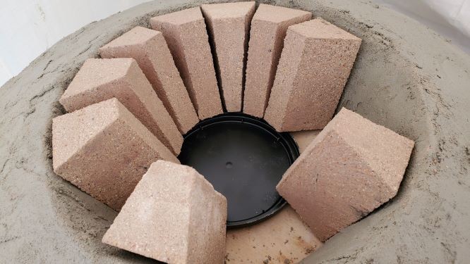

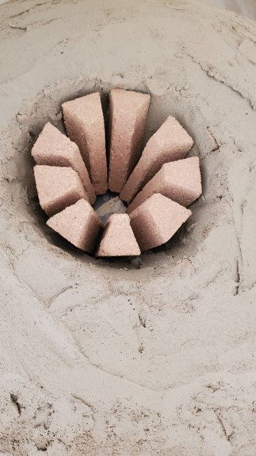

    Hello Forno Friends! After a long (and busy hiatus) I was finally able to get my attention back on the WFO. It has been great to work on it over the last few weeks and yesterday I was able to get the dome complete! A great feeling for sure!
    The build was pretty straight forward thanks to the many threads and feedback on this site. I was able to use the IT until the last 2 courses, and after that there was still a bit of trickery to contend with. As my arch design got changed at the last minute (due to poor pedestal planning!) I opted to not worry about a tapered arch and just tried to build into is as best I could. While the dome/arch transition looks pretty .. well.. horrid, the good news is that the arch isn't so large, so apart from me there's very few people that will actually turn their heads and stick it in to see said transition. So I'm not going to lose any sleep over it!
    Once the IT was retired, I used a jack stand and a wooden disc on top. I didn't want my dome to flatten out too soon, however, so I opted to go with a "folgers shim" to keep the bricks angled on the trajectory, or close to it. What I found quite difficult at this part was a) getting the bevel angle where it needs to be and b) not having the visibility from the underside. What ended up happening is the 1st course using the folgers shim came out fine. The last course (before the plug) I used a plastic cover that from a tape container. However I had no idea that the ass-end of these bricks was sitting lower than the "folgers" course. So when the jack stand was pulled out and the dome was exposed in all it's glory, I had the baby course surrounding the plug about a half inch lower than the plug and rest of the dome. It almost looked like the entire course slipped (which it didn't.. it was just laid wrong.) So I hit it with the grinder best I could. While it doesn't look great.. it looks a bit more level and kind of has an "aged and weathered look" to it. (Yeah, I'll go with that..)
