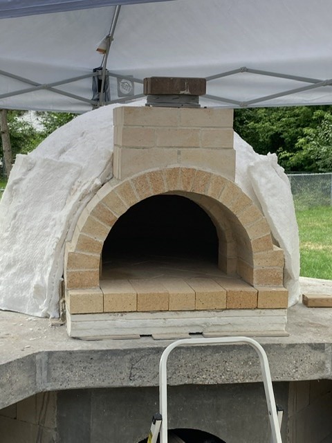

                            #193
                            Quick question…when applying the ceramic blanket to the dome, did anyone use an a hi temp adhesive or just lay it on and hope there’s not a strong wind? When I’m done, I’ll use a thin galvanized wire to hold it in place. It’s really just for the time putting all three layers down.
                            Chris
                            My Build - https://community.fornobravo.com/for...d-in-minnesota
                            My Album - https://photos.app.goo.gl/KsnadqNYJqHMYxme7
                            • SableSprings
                              Moderator
                              • May 2009
                              • 1310
                              #194
                              Just put the layers of batting over the dome...no need to use adhesives of any kind. Since you should go through the curing process before applying stucco over the blanket, you can lean some bricks around the perimeter & couple on top to hold it in place if you choose not to lay chicken wire or metal lath over it. Just remember to wear a good mask, gloves, & goggles to protect your eyes...the ceramic fibers can be very irritating!
                              • MnDude45
                                • Feb 2020
                                • 123
                                #195
                                I just laid the blanket over the dome and propped them on with scrap 2x4’s. It worked well until I determined I was going to run short on blanket. I had enough for 2.6672 of the 3in to cover the entire dome. Ugh! I’ll have to run tomorrow and get another roll.
