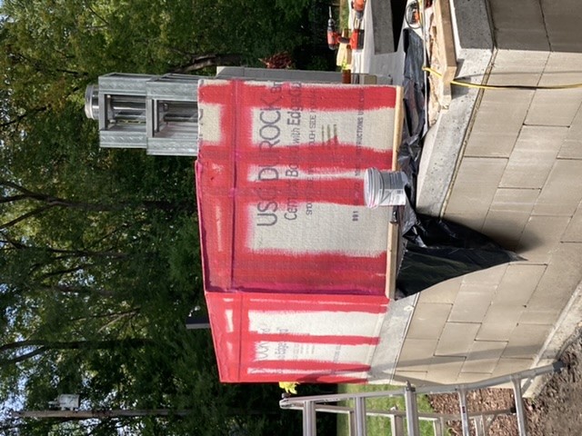

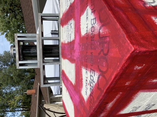

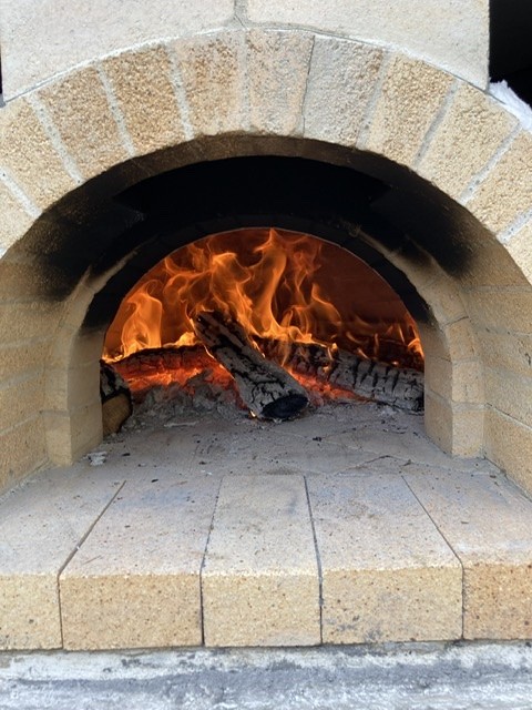

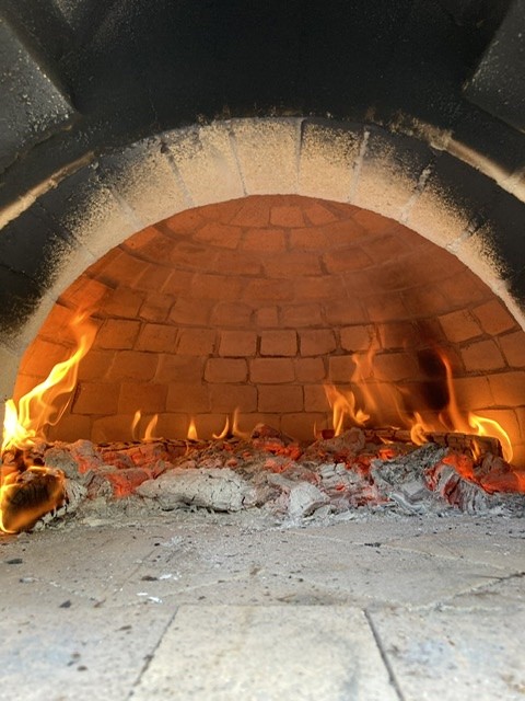

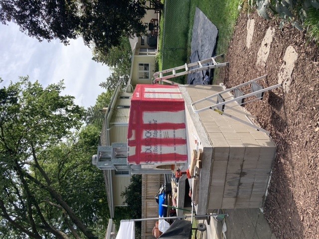

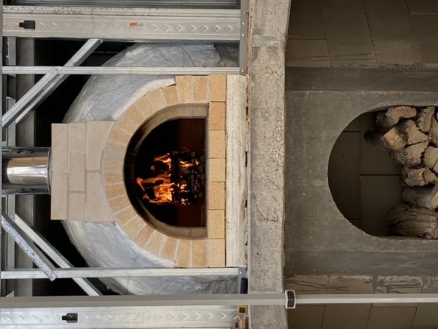

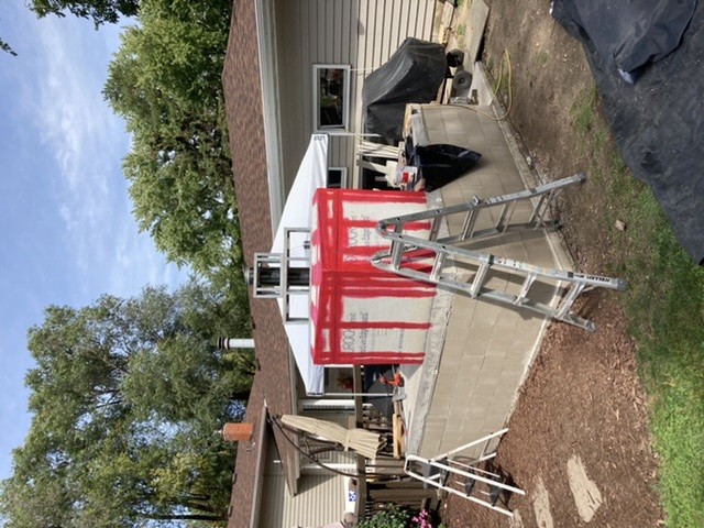

              I’ve finished up the back, sides and top over the dome and applied waterproofing to seam and screws. Also continued with the curing fires after a couple days off due to schedule and weather.
              The fires are mesmerizing. Click image for larger version

                I have completed 5 of 7 curing fires and have noticed a hairline crack along the back wall. I know all ovens crack but should I be concerned??

                  No, fairly common and domes are self supporting. One of the reasons staggered joints are recommended, even though the crack did go thru one of your bricks.

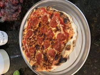

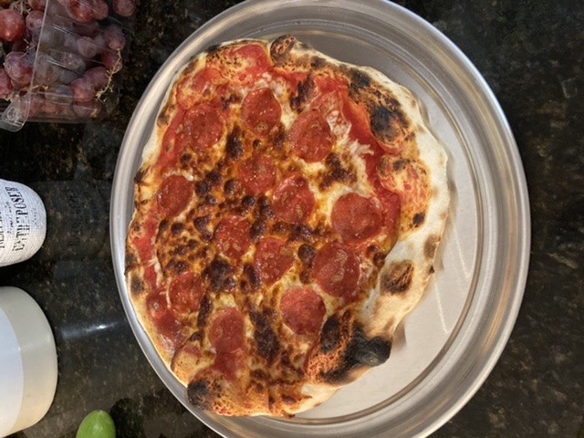

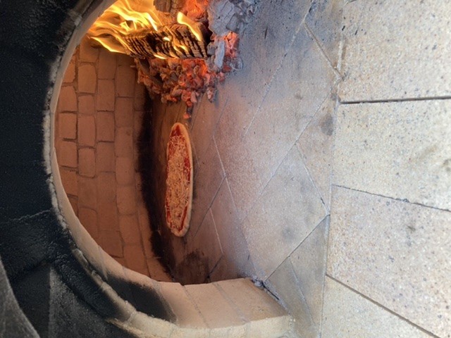

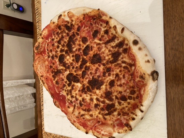

                          Pizza Time!!
                          i preheated the oven for about 2hrs. Reached a relatively consistent of 900+ on the ceiling and 680-720 on the floor.i started with a plain cheese pizza and then made a couple pepperoni. Our granddaughters were over so that’s as exotic as it can get
                          I had good activity with the crust and some nice leopard spots on top and bottom. It was a great first run.
