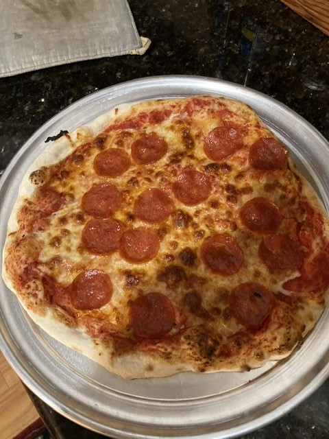

          I finished up the enclosure and waterproof yesterday. I fired it up again tonight and made three more pizzas. Still working on the fire up and transition to production process. The oven was ready in about 90 minutes from when lit with a clear ceiling. 920-950 on the ceiling. It feels like the optimum floor temp is ~700-725 with the pizza done in ~2-2.5 minutes.
          BTW… I love the feedback on “launching”. I have had the best luck with lightly floured wooden peel. I have worked and stretched the dough on counter, placing on the peel, give a little shake to make sure no sticking and made the ‘za on the peel.

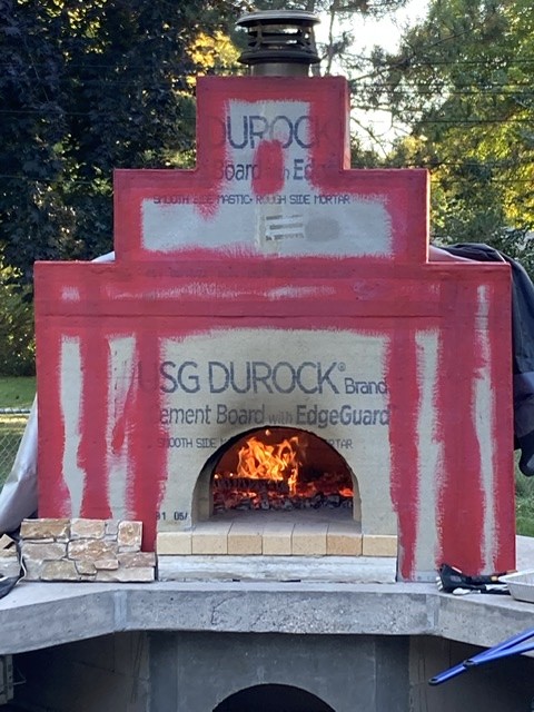

                    Great to hear that you're getting back in the game. I finished my enclosure with cement board in the fall and will install the counter ledge and the brick veneer in the spring.
                    I was able to use the oven regularly during the fall but have shut it down for the winter. I needed to switch over to my winter ice rink project.
                    I learned a lot during the firings this fall about the amount of wood and timing of the fires as well as the pizza making process adjusting the flour types and hydration. I had some issues with the launching process with the peels and found the long handled wood peel to be most effective.
                    I can't wait to actually finish the exterior in early spring and get a full summer of use. I look forward to see your new oven take shape. I'm very interested to see the pre-cut plug-n-play build.

                      I’m back online with progress or lack there of. Planning the finishing work once the oven is functional is a challenge as many of you know.
                      The latest task is pouring the steps for the chimney exterior and mortaring them in place. I experimented using the countertop cement for the steps and the chimney cap. Seems to have turned out OK. I need to test the cap and ensure my measurements are accurate. If so, I’ll put them in place.

                            Started the veneer. The cuts around the opening and those intersecting the arch are more tedious than expected. Need to keep pushing forward.
