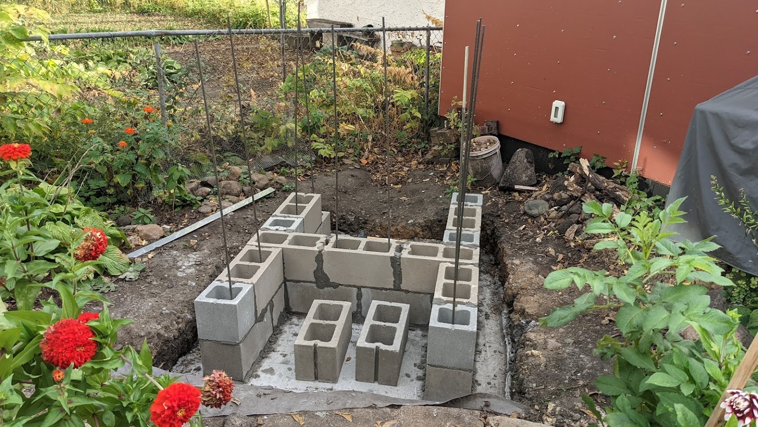

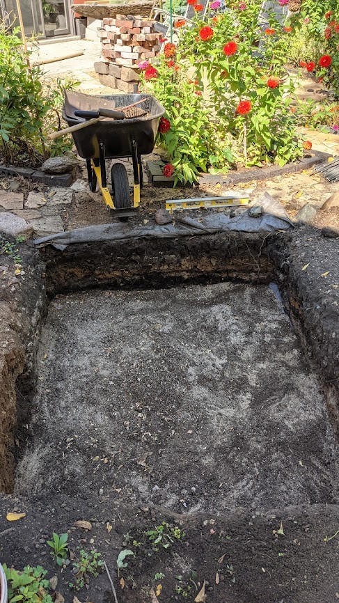

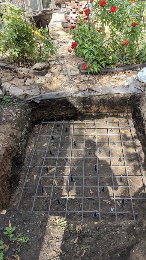

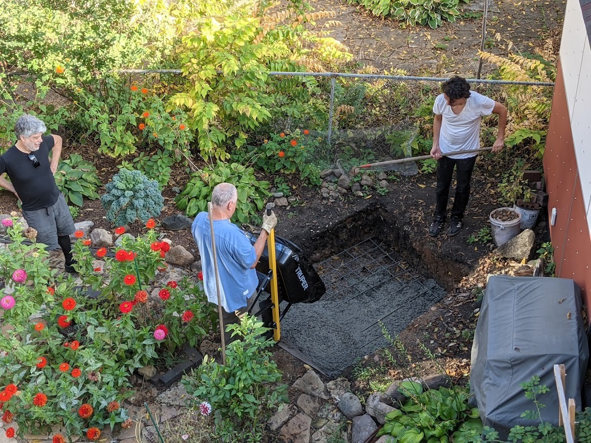

        Hi Randy, thanks for sharing your experiences! I ended up going down 2' below grade and pouring a 1-foot thick reinforced concrete footing. I laid down landscaping fabric on the undisturbed soil and added a couple of inches of sand/gravel above that to help with drainage immediately below the concrete.. The concrete pad is 5' side to side x 6' front-to back. I figured if there is any movement, the whole thing will more likely move up or down with soil moisture and frost conditions. It ended up being about a cubic yard of concrete, and rather than mixing it myself, I opted to have ready-mix delivered... it took about 15 trips of the wheelbarrow.
        So-far there is about 2100 pounds of block, mortar and grout above the foundation... by the time the brick dome/igloo style oven is finished, I'm sure it will be close to your figure which ends up being just under 4 pounds per square inch of net weight over the entire area of the foundation (assuming even distribution)... if my math is right, it's just a little over-designed... :-)
        I'm attaching a few photos of my progress... 3 photos per post... I will pause construction over winter and resume in the spring.

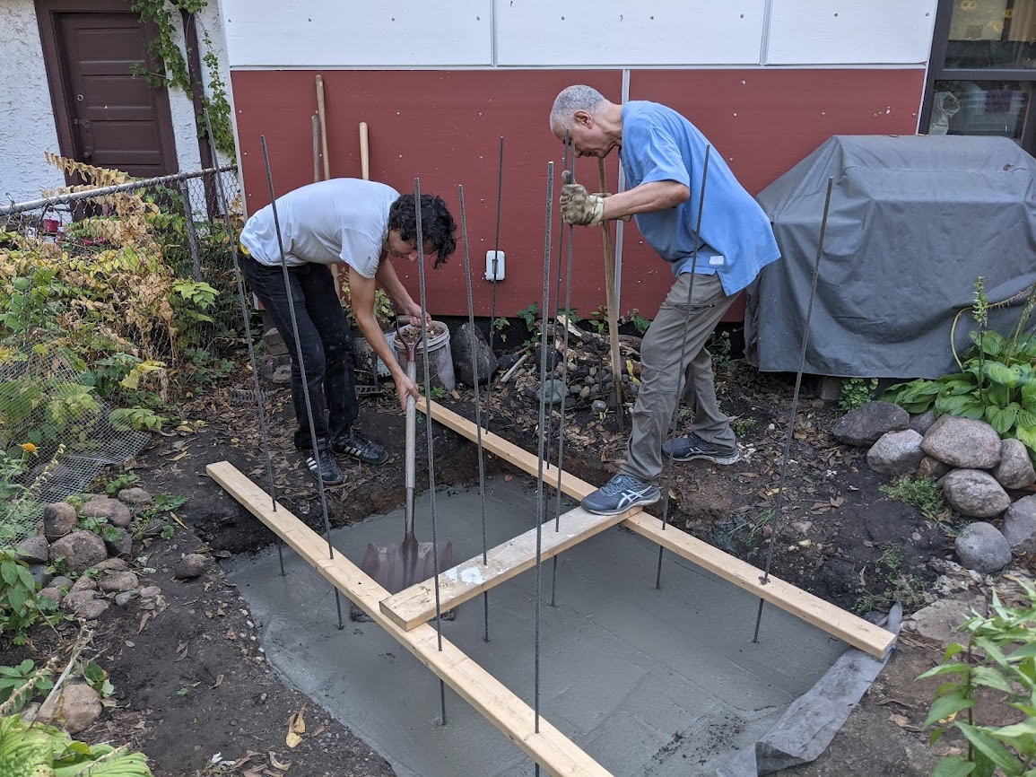

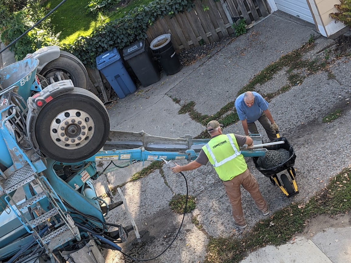

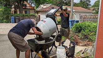

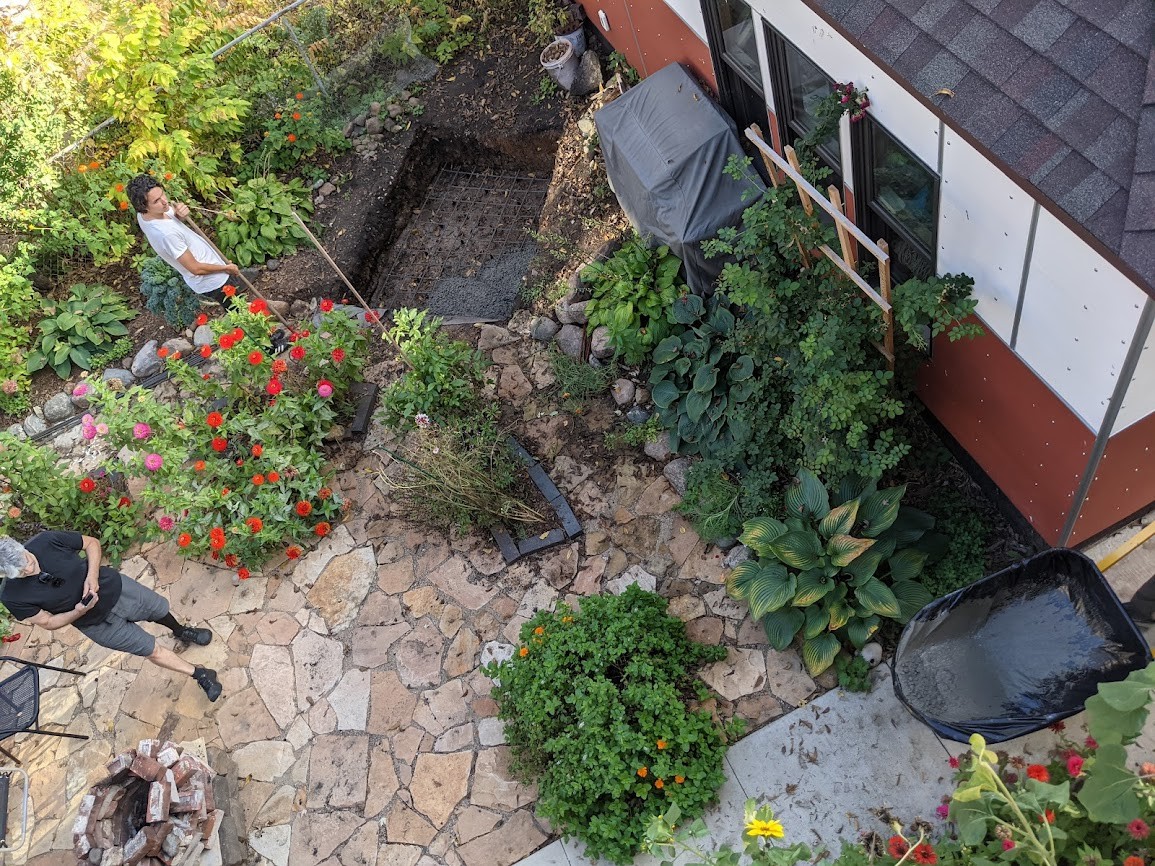

          My son helped me rake the concrete into place, since there wasn't an easy way to maneuver the wheelbarrow around all sides... I did the shuttling back and forth from the truck to the hole. Our friend Nick offered free advice, and my wife was the photographer from the roof deck...

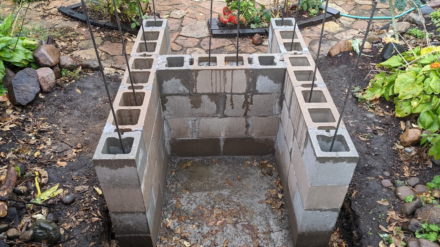

            I made a form with 2x4's to locate the vertical re-bars and placed (fiberglass reinforcement rods in the holes, had to use a mallet to pound them into the still-wet concrete, to get around a few horizontal bars that were in the way... And started laying block (be easy on my masonry skills, I'm learning as I go....) at least it's fairly level. I'll fill the cores that have rods in them, and seal the open cores with plastic to prevent any issues with ice over the winter...5
            I do have one question for those that have used homebrew refractory... I ended up with 3 bags of ready-mix mortar that I'm keeping dry till next year...Assuming it's a 3:1:1 mix, can I add 1 bucket of fire clay for every 5 buckets of ready-mix and end up with a workable refractory? (theoretically that would give me 3:1:1:1 for sand, cement, lime and clay). I have not come across any references to people adding clay to ready-mix grout so far...

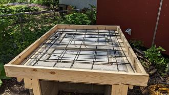

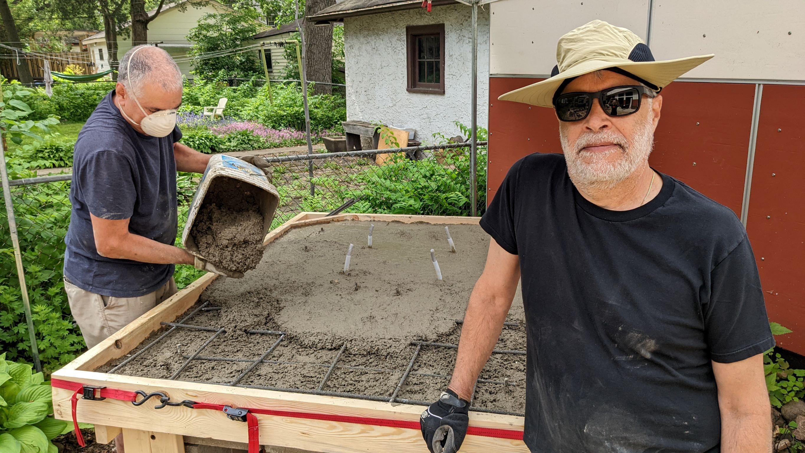

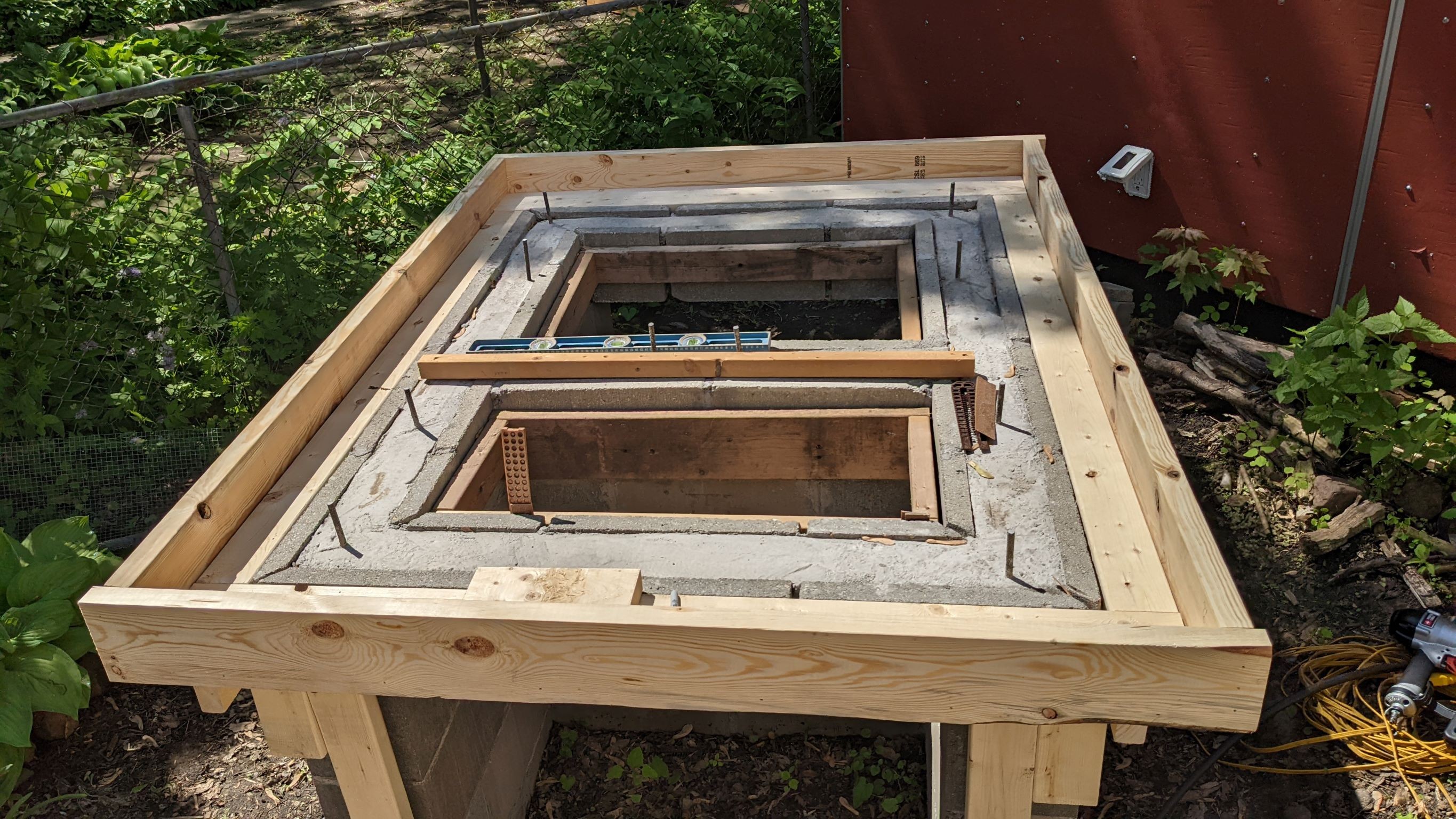

                          Back at it after a long winter hibernation... I'm the one with the mask, trying not to breathe cement dust.:-) Sixto. It was great to have my pal come over to help, not just for the muscle, but also for the cool italian vibe he brings to the party.

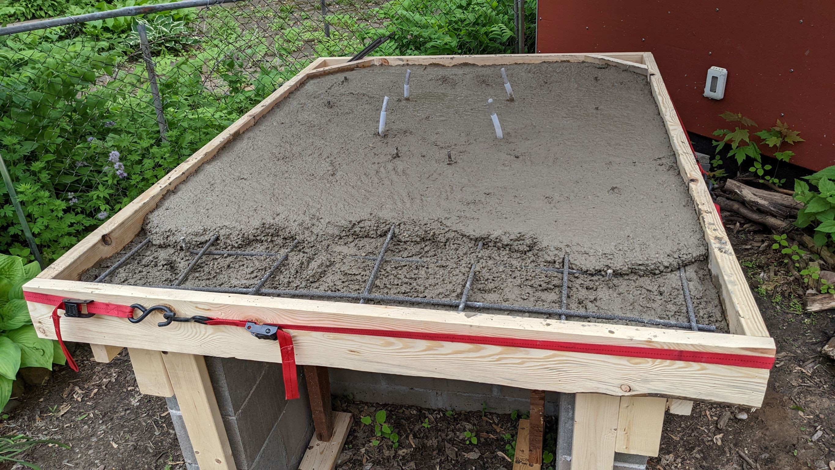

                          I used fiberglass rebar, to avoid issues from water seeping into cracks and rusting the rebar down the road. I also wove the bars together instead of wiring them, and waited till I had 2" of concrete cover in the forms before placing the grid and continuing to fill the form.
                          The first photo shows the two wood storage compartments (One faces the back) I wanted to have a wall in the middle to tie the two long walls together, and take up some of the weight of the dome. The front and rear lintels are made from lintel block chamfered at 45d with an 8" diamond blade mounted on a grinder. (needed a spacer to fit right).
                          I also placed 4 vent holes (about 1" diameter Vinyl tube for stiffness, filled with a length of thick foam backer rod. (in case the vinyl tube doesn't want to come out)
                          I rented the mixer at 8:00 a.m. and returned it at 3:30 pm (with a lunch break and a quick trip for 6 more bags) Total was 22 bags of 60# ready-mix (3,000 psi) Slab is 4" thick x 6'-2" deep and 4'-7" wide, I did chamfer the back two corners about 9" to get more clearance between the garage and fence.... it's a bit tight walking back there.
                          I will post photos of the finished slab after it's cured and I've pulled the forms. It's now curing under wet canvas...
                          Click image for larger version  Name:	Slab Formwork2.jpg Views:	0 Size:	1.03 MB ID:	446909 Click image for larger version  Name:	Formwork with Rebar2.jpg Views:	0 Size:	1.06 MB ID:	446910 Click image for larger version  Name:	Mixing Concrete2.jpg Views:	0 Size:	1.19 MB ID:	446911
                          Click image for larger version  Name:	Pouring Slab2.jpg Views:	0 Size:	1.08 MB ID:	446912 Click image for larger version  Name:	Slab and Rebar2.jpg Views:	0 Size:	1.28 MB ID:	446913

                              While I'm waiting for the slab to cure I had a few questions:
                              1). How long do I keep the curing slab covered with a wet blanket? It's been one day so far, and the top surface is already hard to the touch.
                              2) is there a case to be made for adding a closeable combustion air inlet at the base of the dome, and a corresponding closeable vent at the top of the insulated door? I'm thinking about maintaining temperature by re-stoking firewood overnight on day 2,3 or 4 to keep the oven temperature in a baking or roasting range...
                              thanks! Sixto.
                              Sixto - Minneapolis
                                • 9216
                                #30
                                1. Keep it wet for a week. The strength build up is greatest as soon as the reaction begins, then slows down. Most of the potential strength gain has occurred after one week. Concrete strength tests are usually done after 28 days, but a week is considered sufficient. Best to throw some sheet plastic over the wet blanket to seal in the moisture.
                                2. The air inlet for the oven is provided by the oven mouth. A well designed flue gallery leading to a flue or chimney with an adequate cross sectional area is important.
