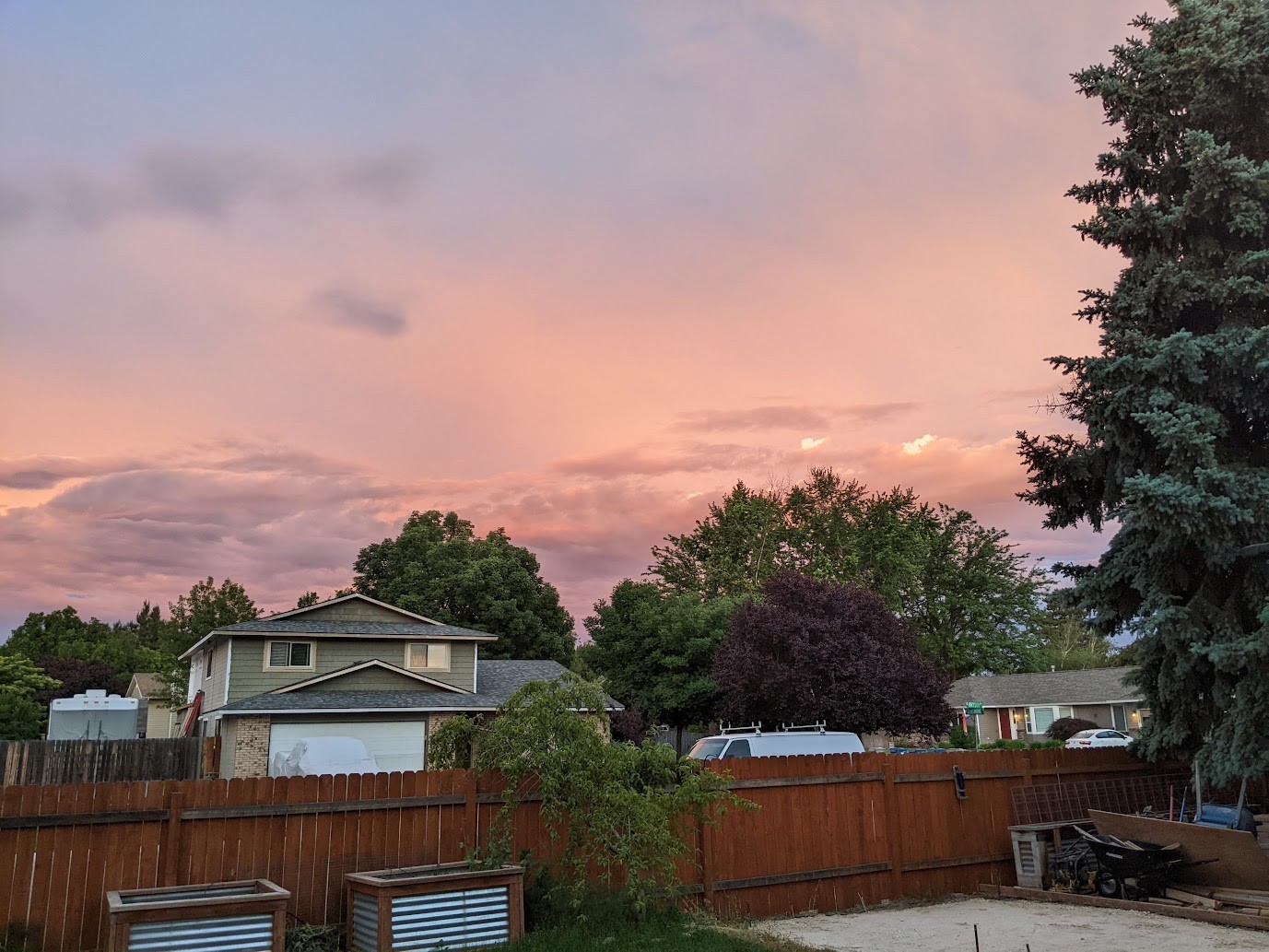

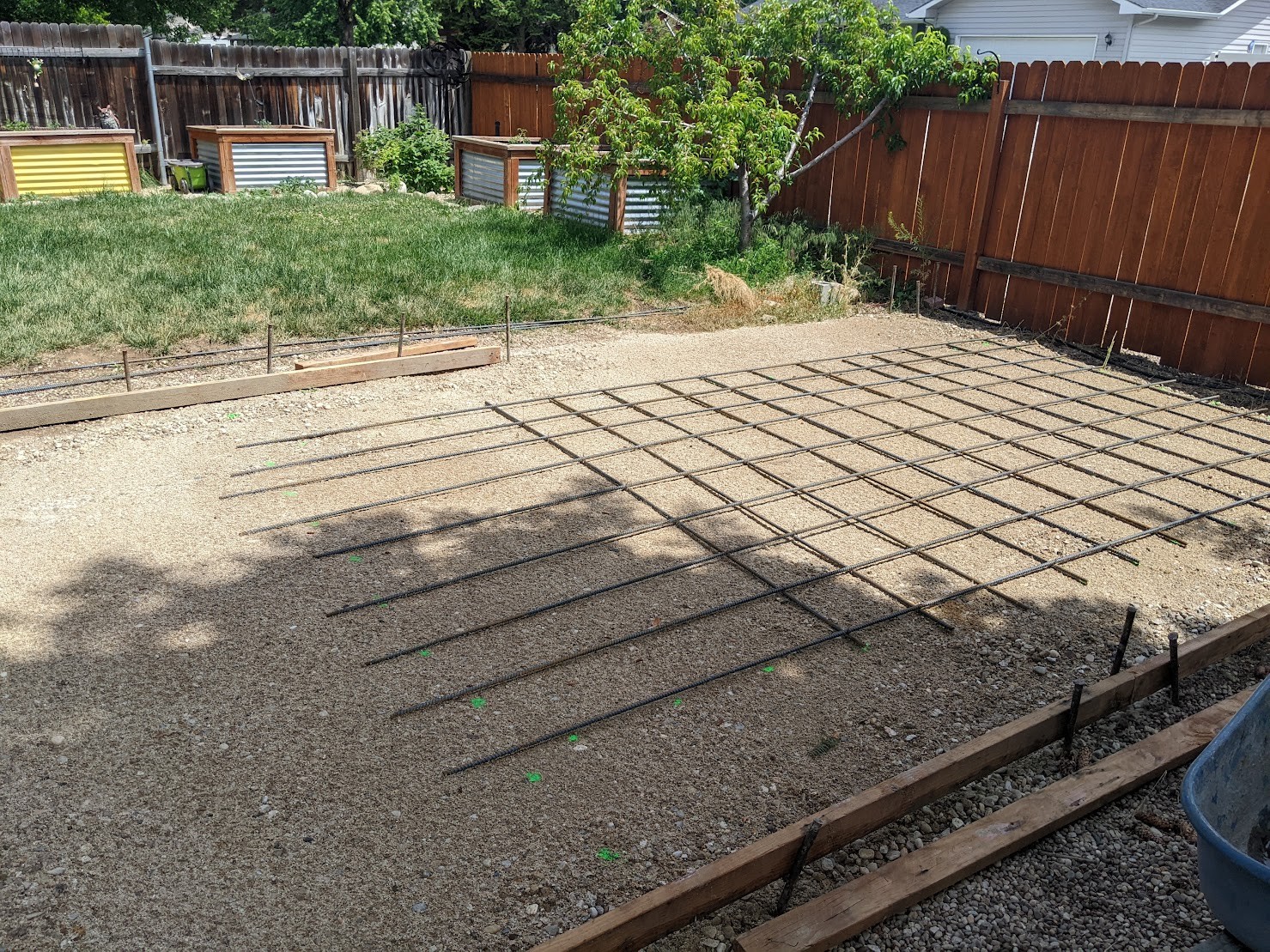

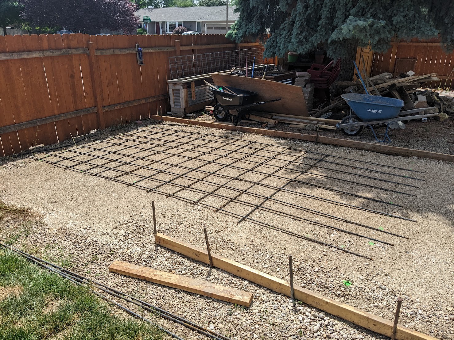

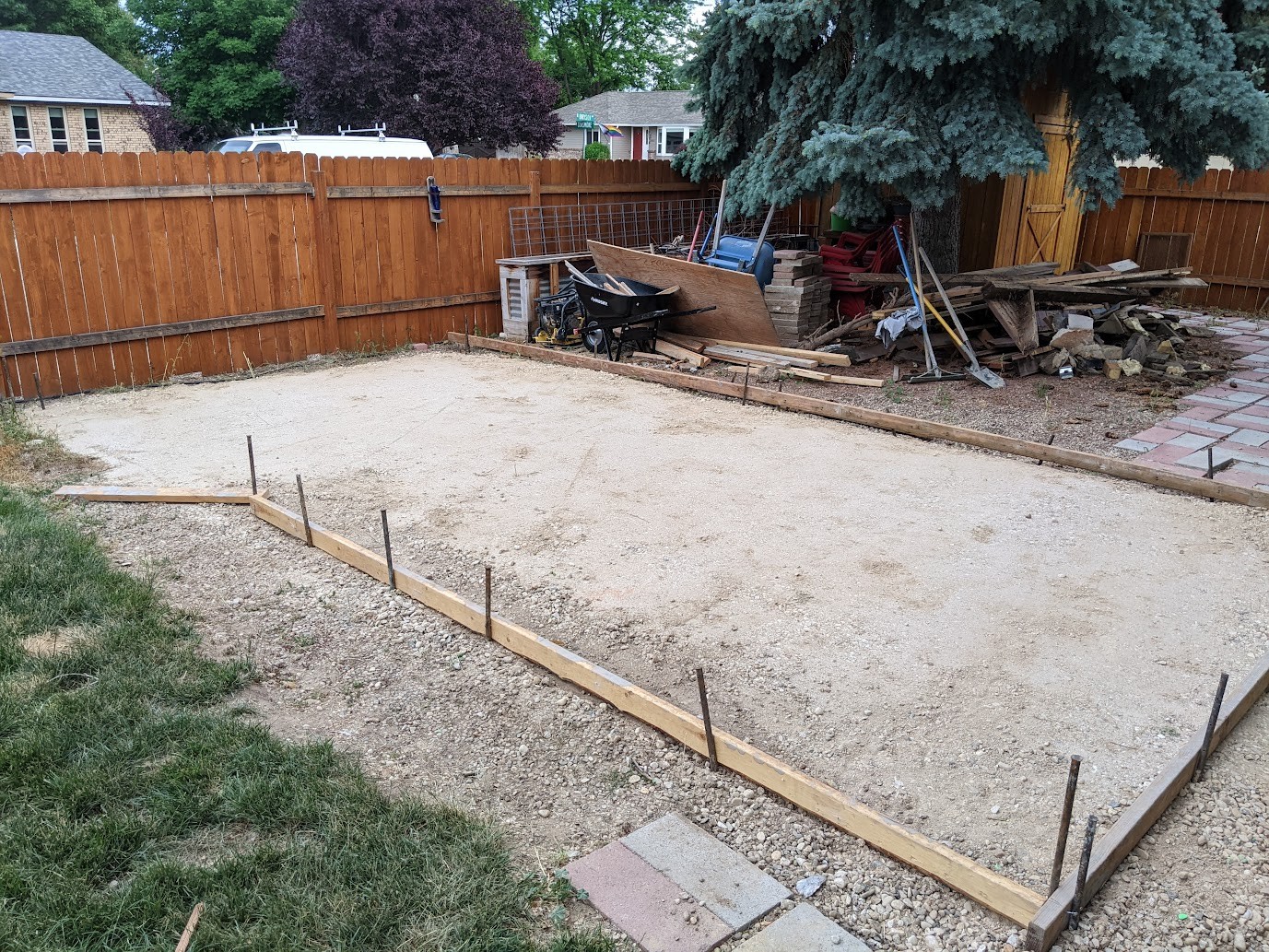

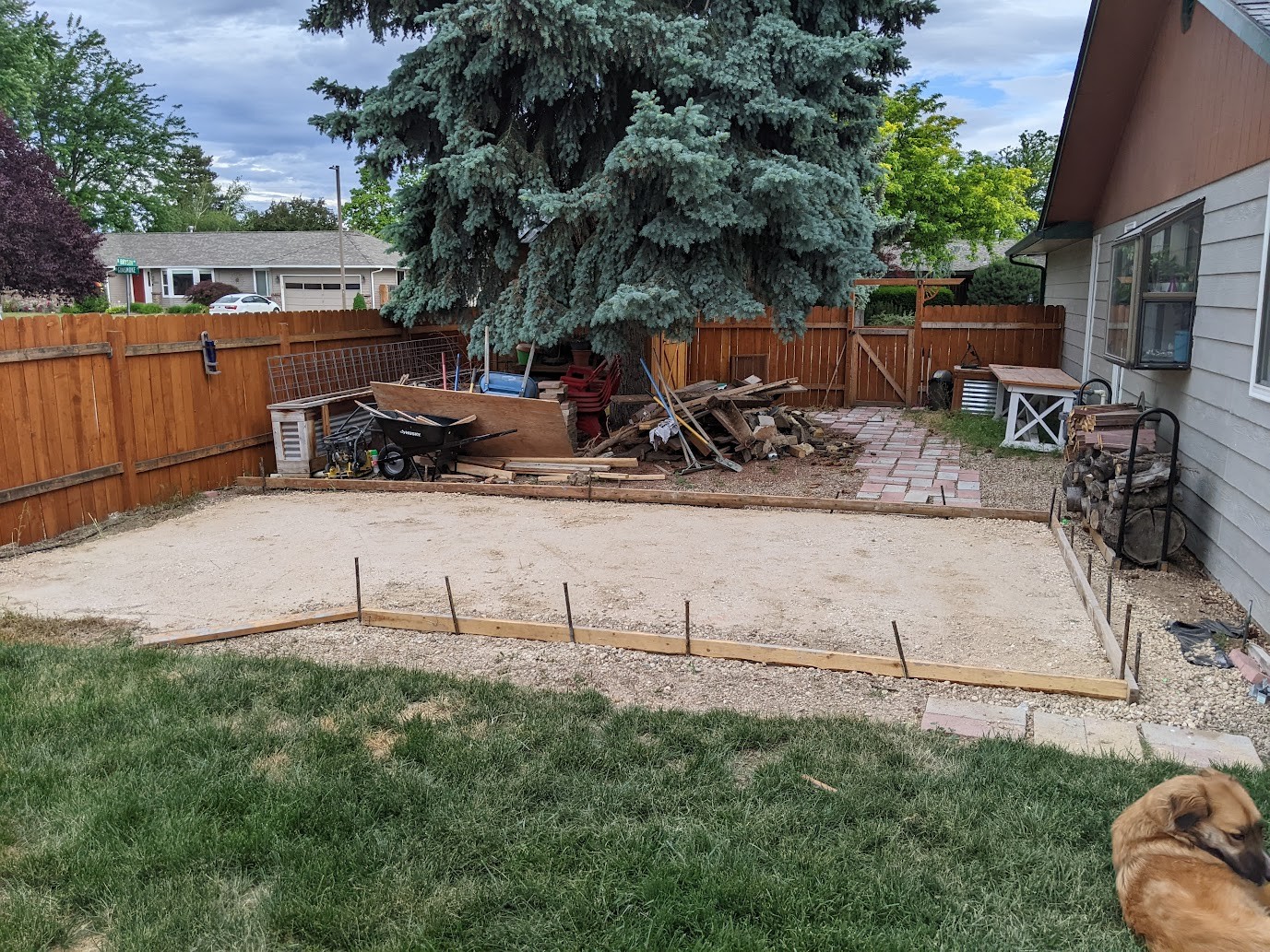

    Hi There! I'm AJ and it looks like my build is finally starting =)
    I'm going to be building a 36" WFO on a 12'x24' pad that's being poured this week. The oven is going to be closer to the fence with a metal roof pergola above to keep me from turning full lobster while cooking stuff. The other half of the pad will have a nice big 10' table that you can barely see in one of the pictures. I think we will also get some shade sail triangles to span the space between the house and the pergola to keep guests cooler. Also, some string lights for when the sun goes down.

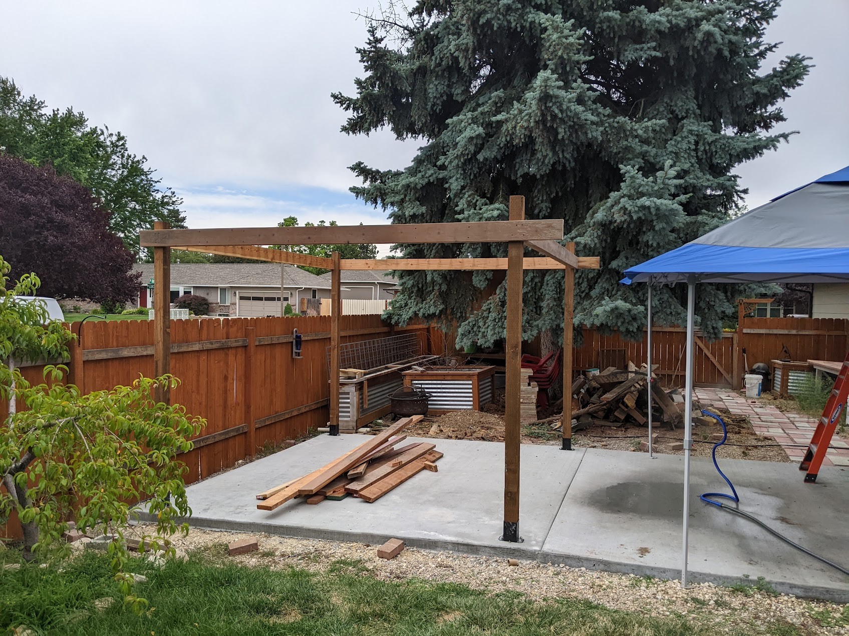

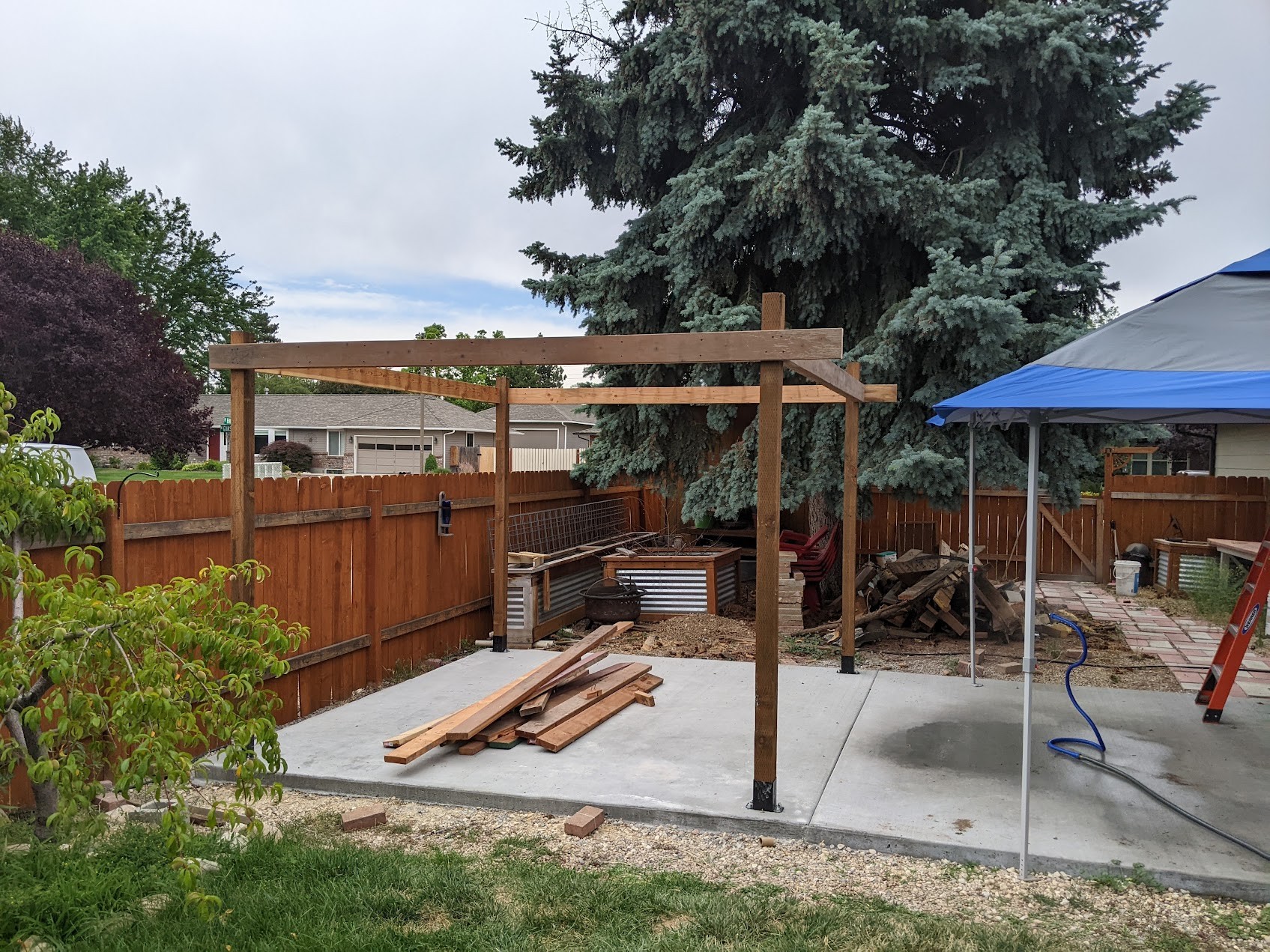

      Haven't had a lot of progress, working on figuring out the height that I want it. I was going to do 4 rows of CMU blocks, but that only gets me to about 40 inches for floor height. Adding another block brings it up to 48, which might be a little on the high side. Might toss a layer of red clay bricks under the Cal-Sil board to split the difference... My other issue to deal with is the slope on the pad. It's about a 2 inch difference from front CMU block to the back one. I'm most likely going to have to mortar the bottom row to level it out and then dry stack on that. Also want to add in some weep holes in the back so that water doesn't pool inside the block stand. Other than that, I started in on framing the covered structure. It's about 12' by 12' and the pizza oven will go in the back corner giving me plenty of room for wood storage, a prep table, and a place to hide from the sun. Here's what it looks like so far.

              Well, the Pergola is finally done so that I can start building the oven without the sun beating me into submission.
