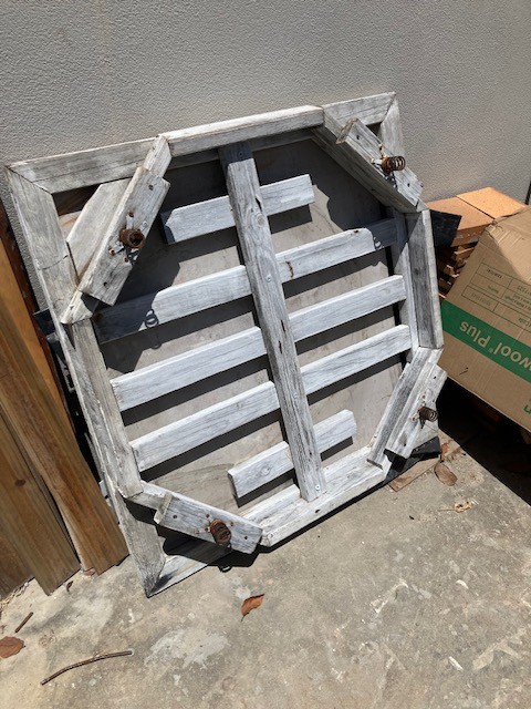

    I was trying to lay out the CalSil Board in a way that kept enough to make a door with it, but I'm wondering if it would be better to use it all and make a door out of stainless steel with loose perlite or vermiculite fill. Could also mix in a little portland cement to bind it together so it doesn't settle over time.

      I have built two metal insulated doors. I used CalSil board for my door filler. We used ceramic fiber blanket for a friends door. There is not much difference in the two doors sizes. But my friend's door is considerably lighter.

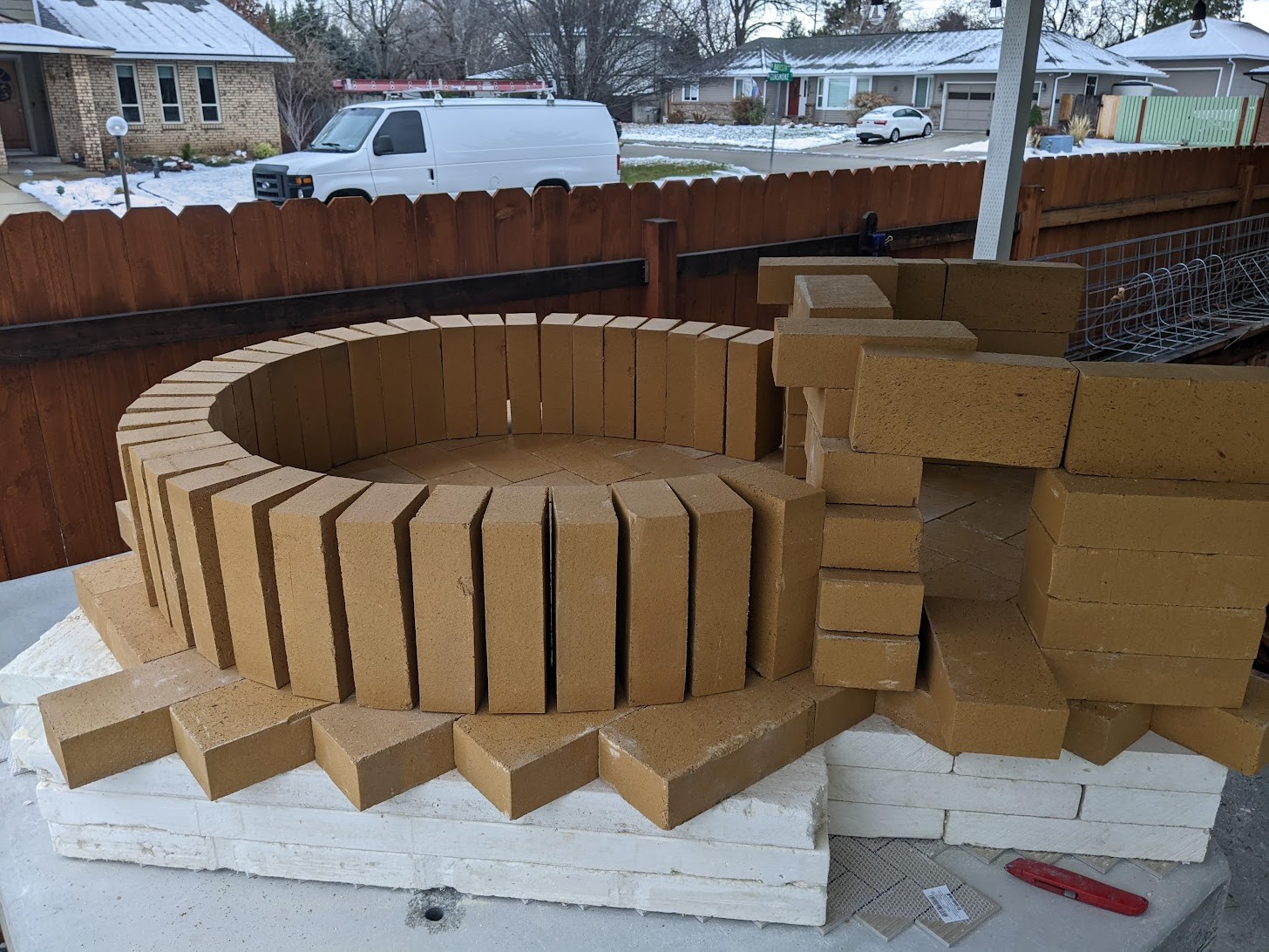

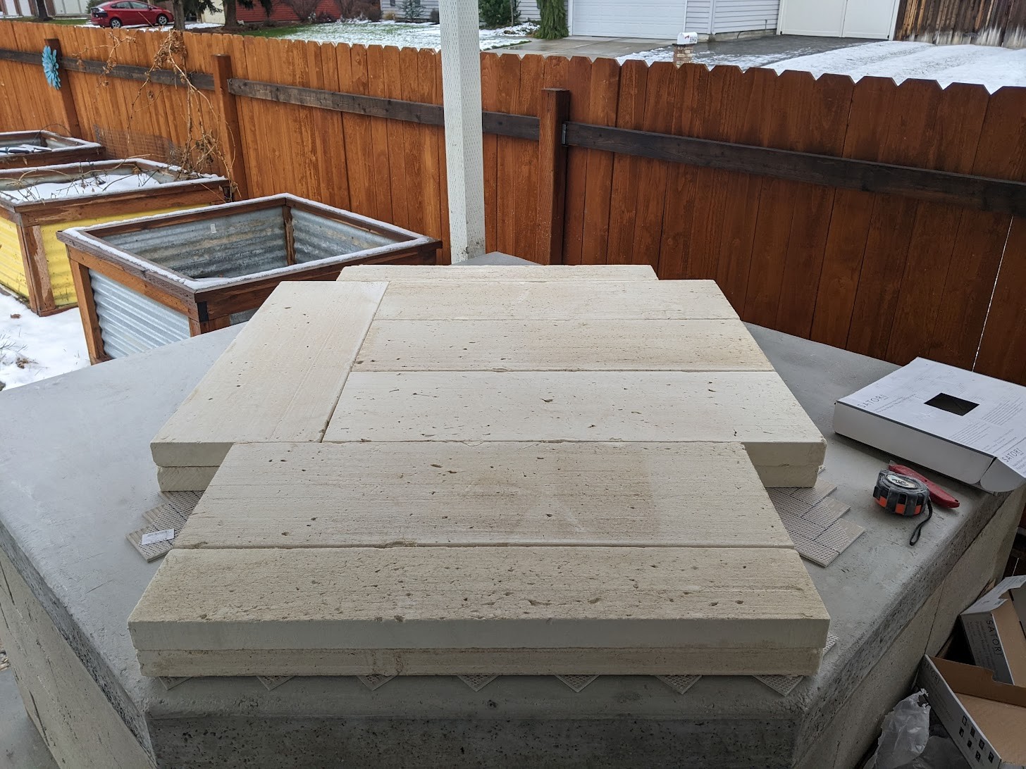

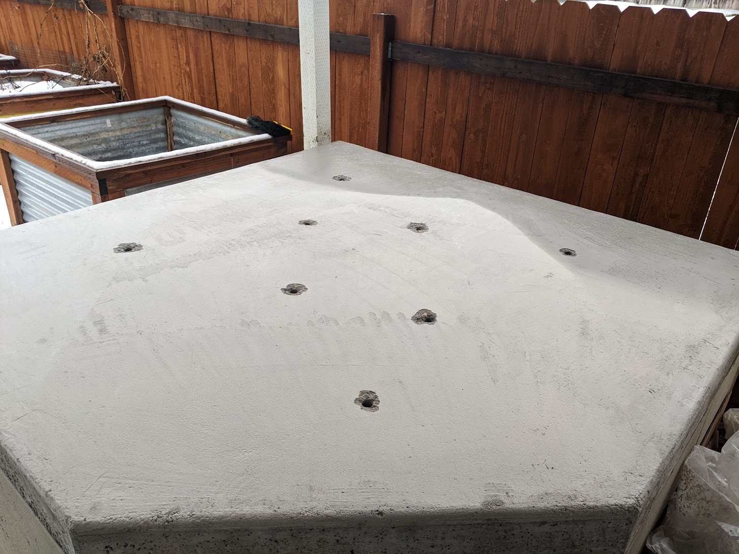

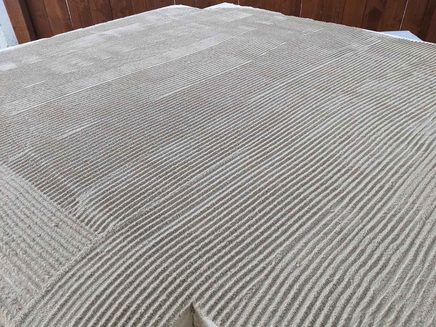

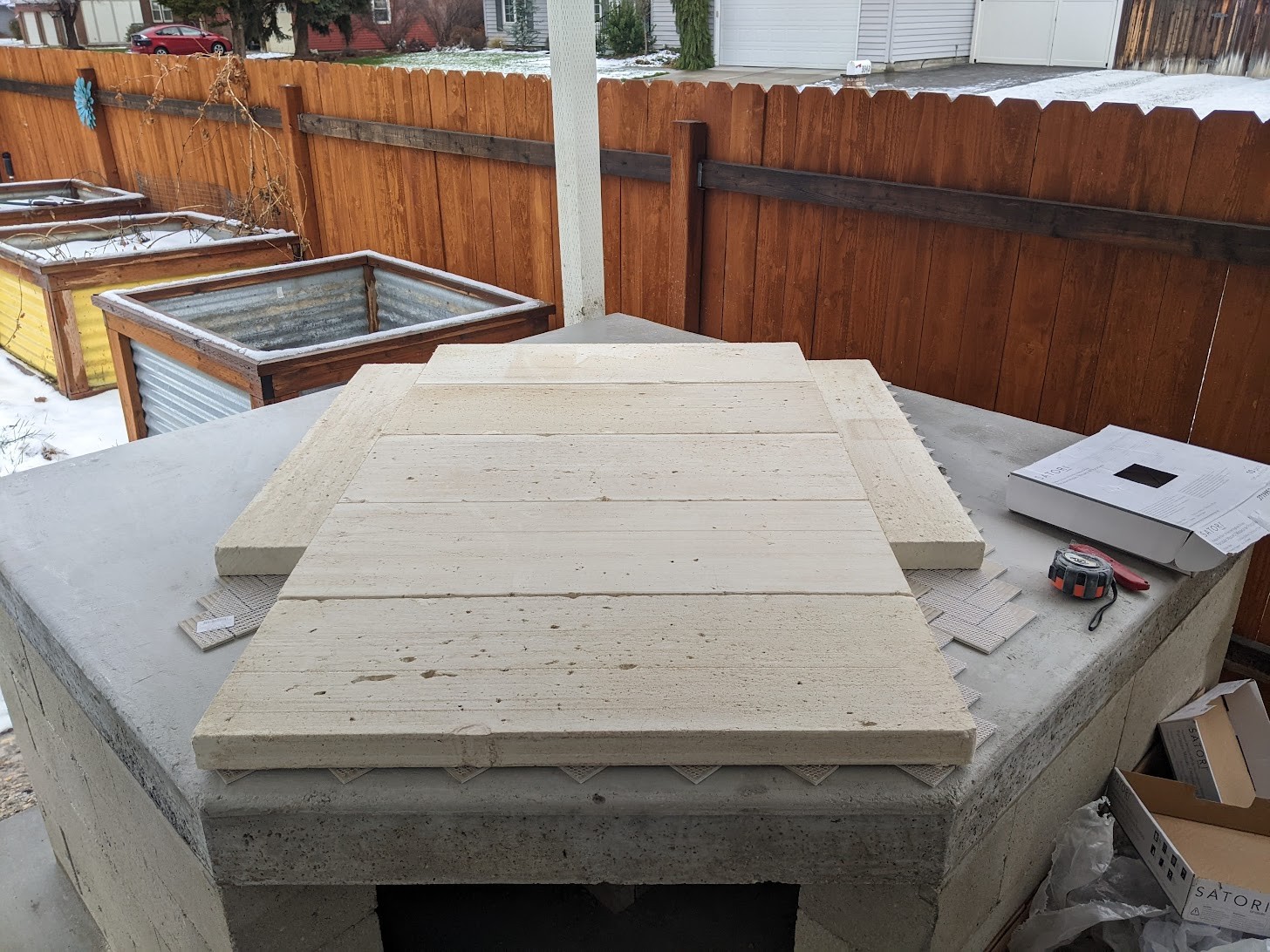

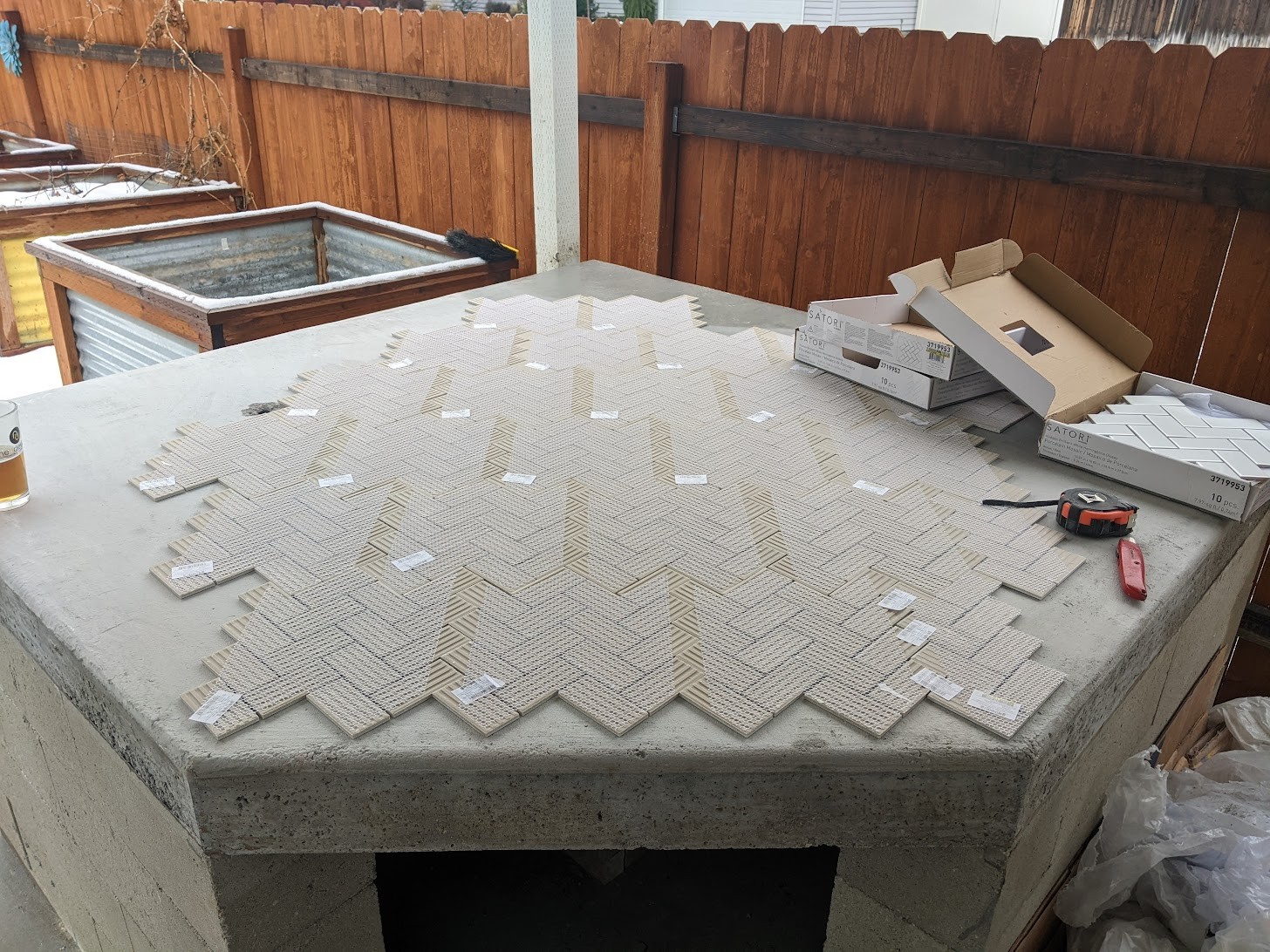

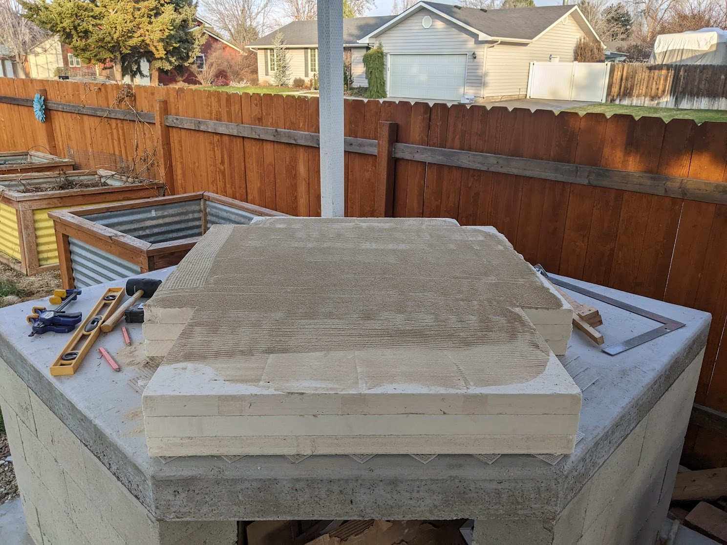

              Did some prep work today on my build. First, I punched the weep holes out from underneath and then tapped out the pvc pipe from above. Then, I laid out the mosaic tile and built up the CalSil insulation above that being careful to overlap the joints. I ended up using it all to have a consistent surface to work with. I'll figure out a door later... Then I laid out the floor without anything under it. I'll be pulling it back out and laying some sand/clay on the insulation to level it out and fill the voids then pick and choose which bricks have the best face to be the real floor bricks. Then I decided to mock up the oven to make sure I liked the depth of the inner and outer arch locations.
              As you can see in the pics, we got some snow the other day... going to slow down the build but I'll make do.

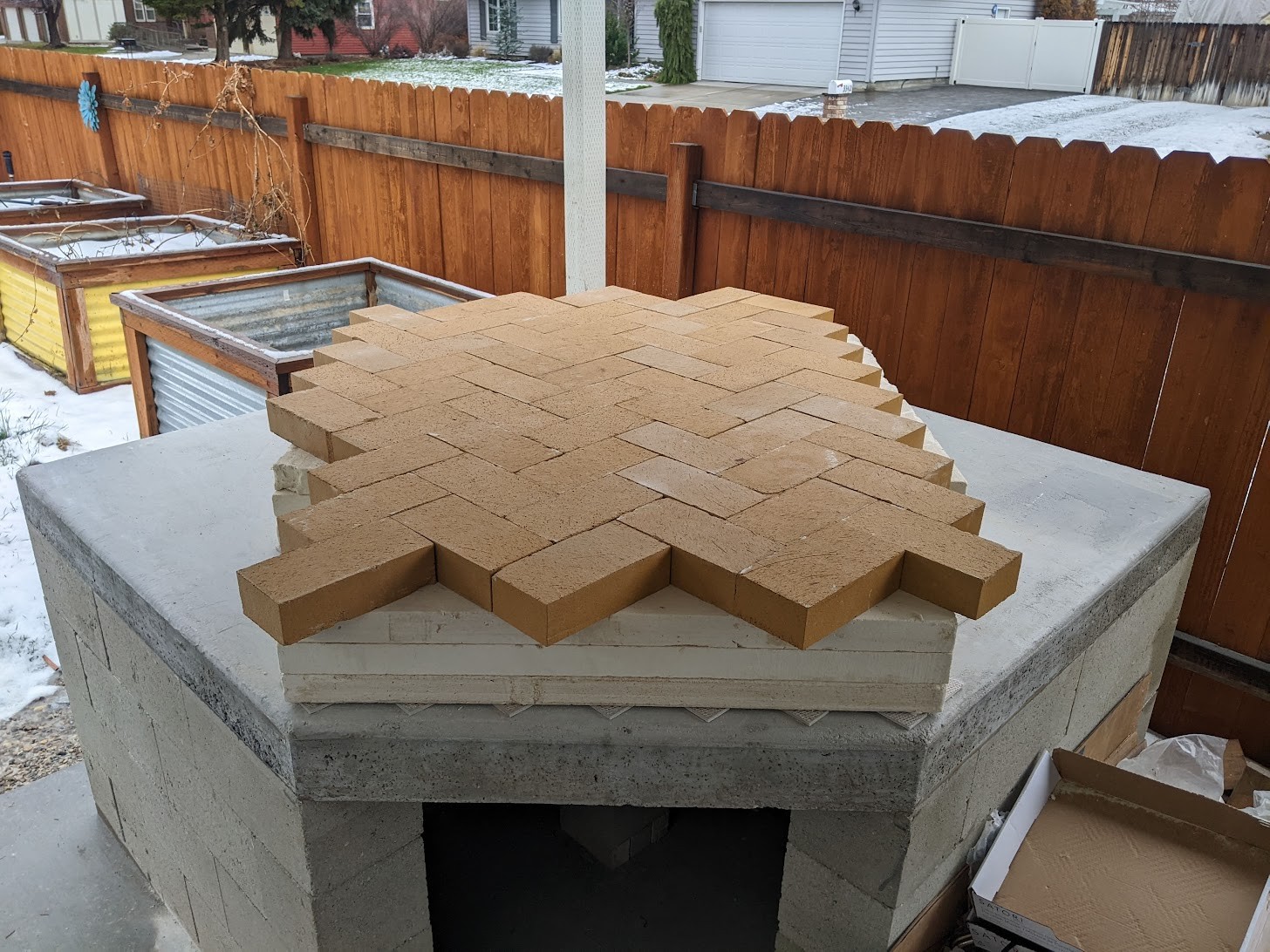

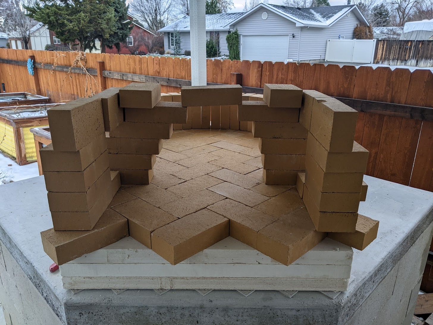

                Here's the mock up pics. Would only let me do 6 at a time...

                  With full soldiers you do have quite a bit of outward thrust where the dome and the top of the soldiers are. You may want to consider half soldiers or potentially buttress the full soldiers.

                    The soldiers were just to help me visualize the dome. I'm planning on just starting the first ring on the floor without any soldier/sailor/whatnot... I just put those there so that I could see how far in I'll be able to see without bending over.

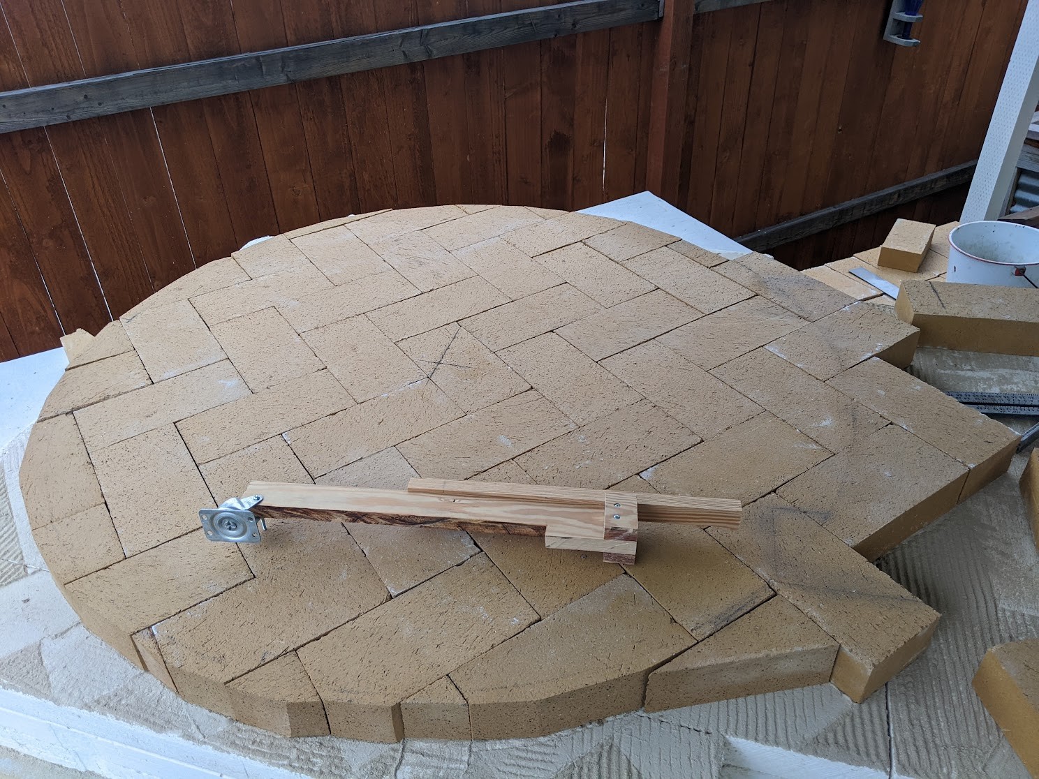

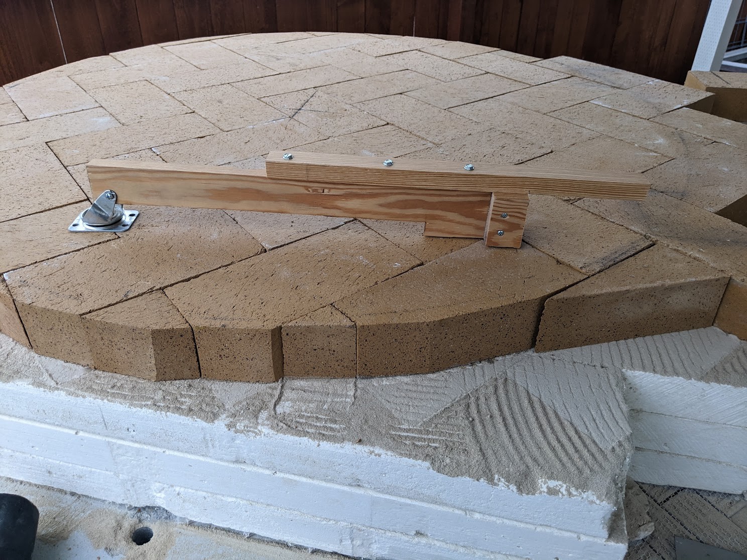

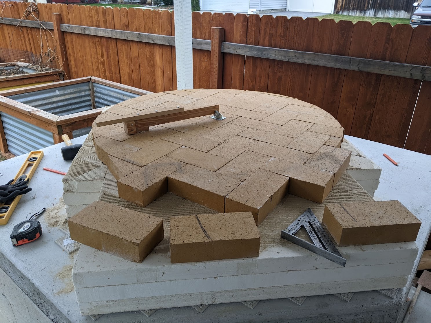

                          Been chilly the last couple weeks and haven't really been able to do much. I did make the IT and have all the stuff I need to make the tile saw jig. The caster wheel used in the IT has an offset of about an inch from the swivel point. So, where I attach the wood (where the wheel was attached) is about an inch from dead center of the dome. I decided that it was fine. The dome height will just be 17 inches and the radius 18 inches. Now I just need to figure out how to get the middle brick out to drop in the caster so that the pivot point is at the floor height. I'm thinking a couple hot glue sticks melted onto the brick might have enough leverage to pull it out...
                          Does anyone ever spread fireclay over the floor bricks and brush it around to fill up the cracks like they do with brick pavers? I'm assuming that they will get filled with ash during the curing fires, but thought maybe the fireclay would be better for heat retention.

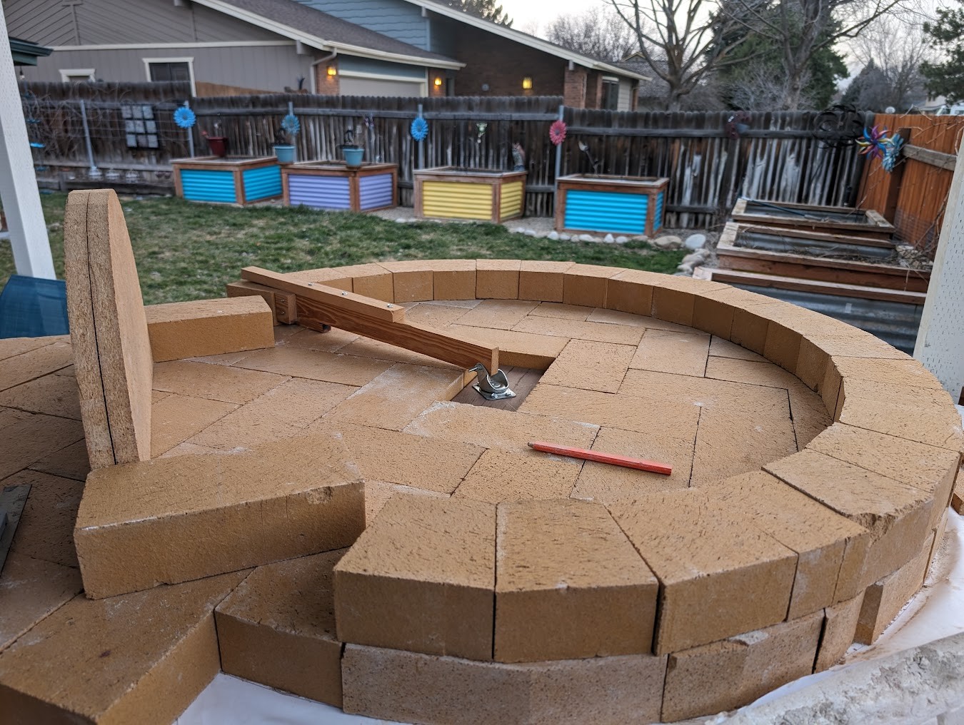

                          Today was a balmy 31 degrees F for the high and I decided I was sick of waiting on a nice day to cut some bricks. I laid down the fireclay/sand mixture and placed the floor bricks so that the bricks were as close to level as I could get. There might be a couple that I hit with the angle grinder later. Then I marked the outer edge of the dome and cut them to size. I filled up a bucket with hot water and had the pump in that thinking it would keep everything around the saw warm but the metal and brick being below freezing dropped the water temp fast and I still had to take a break halfway through to warm up my hands...
                          Here's some pics of where I'm at now.

                            To get the middle brick out, you might just pull the bricks around it; number them first with a sharpie so you can put them back in the same order/orientation. That's what I did on my second oven, though I mostly skipped the sand/fireclay mix, so I'm not 100% sure you would disturb that and make more work for yourself. Could also carefully drill a hole with a hammer drill and screw in a tapcon to use as a handle; either plan to put the brick back down with the hole facing down, use a different brick, or just fill the hole with more brick dust and try to forget it's there :-)
                            On my second oven I did go ahead and spread fireclay (from brick dust) into the cracks in the bricks. I had the same theory that ash would act as an insulator, interfering with even heating. I didn't bother on my first oven, but the bricks I had then were much straighter and I don't remember there being notable gaps. Yours look very similar to the ones I got on build #1 (H.C. Muddox brand), with lots of uneven edges). I don't know if it helped to brush in fireclay, but it made it look better, and made me feel better about it :-).
                            I found thick rubber dishwashing gloves handy to protect my hands from water, brick edges, mortar etc. though they wouldn't stand up to a brisk 31F morning!

                              Got a little progress done with the nice weather we had last weekend. Going to cut the next ring tomorrow and maybe mortar them in place on Sunday...
                              What's the consensus on mortaring the first ring? The joints are pretty tight and I'm assuming that the weight of the dome will keep them from moving. Should I put a thin layer of mortar between them to lock them in better or place them on a bed of mortar?

                                Others who built their domes one top of the floor will have a better sense, but my instinct is that it would be wise to at least set them in a thin bed of mortar underneath, if only so the bricks don't go shifting around when you go to put the next course on.
