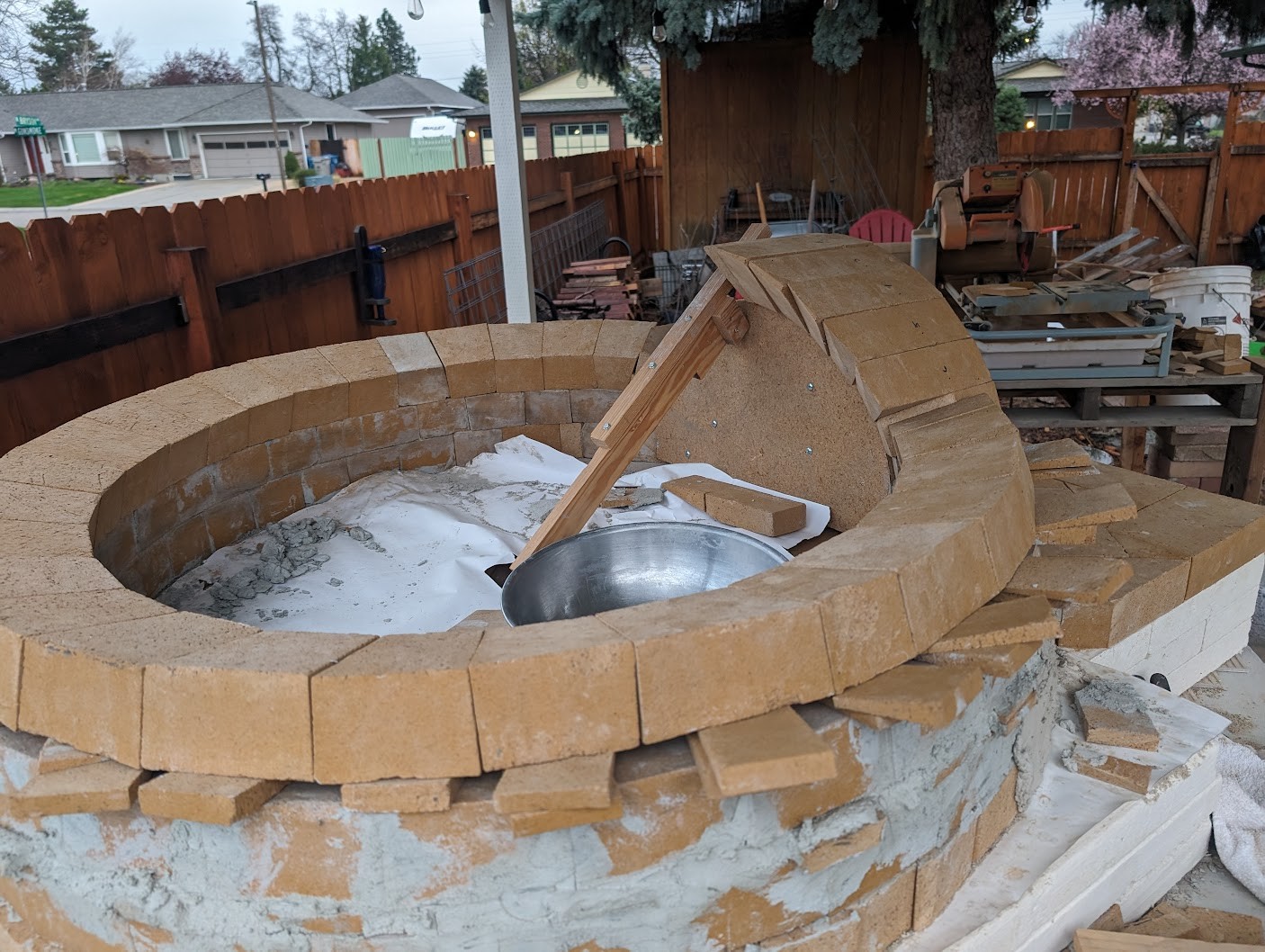

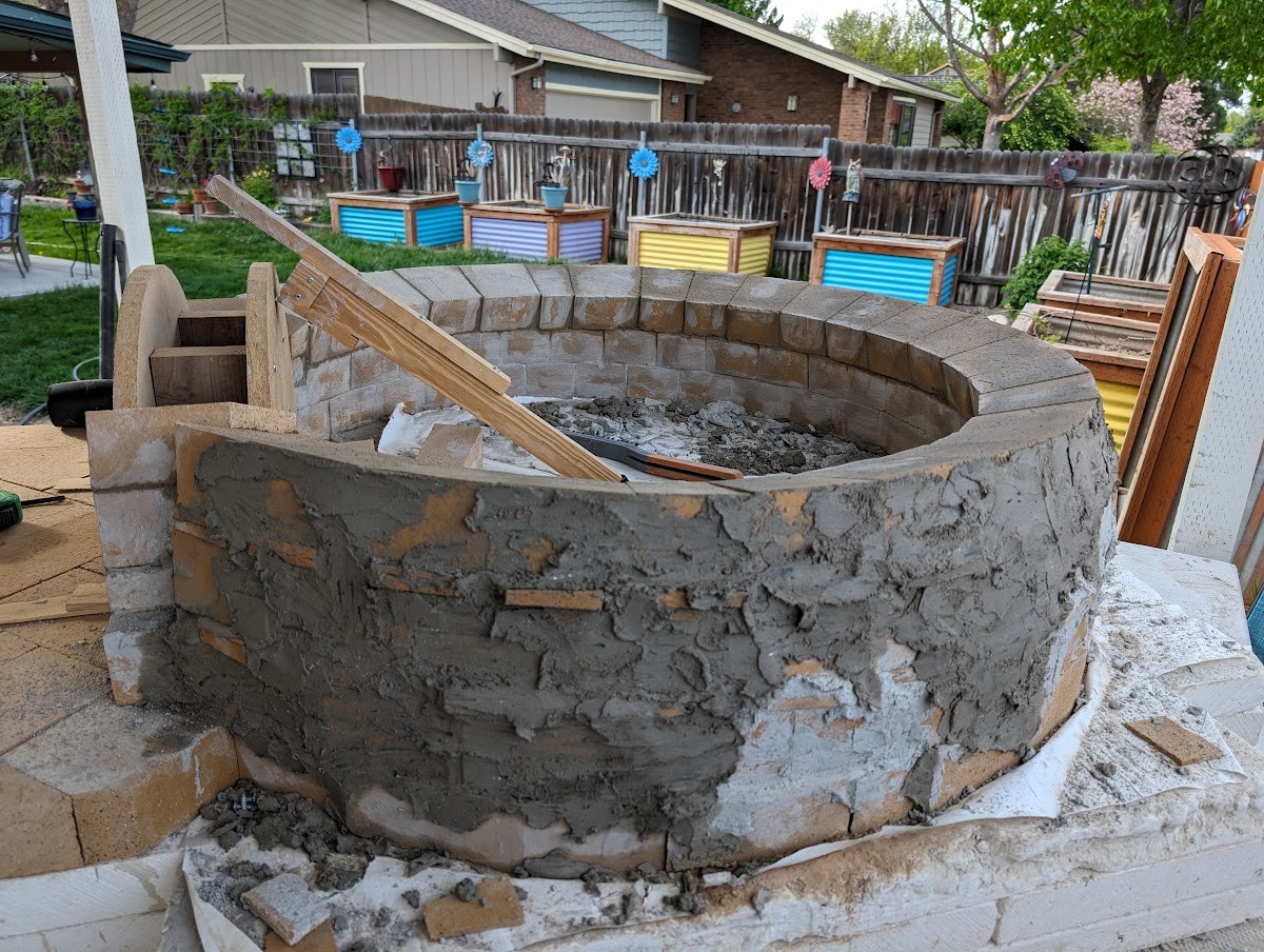

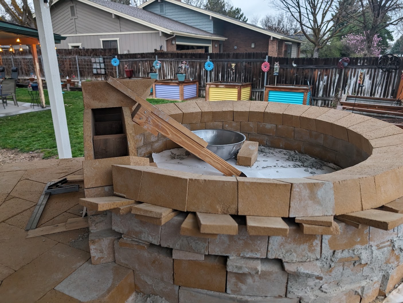

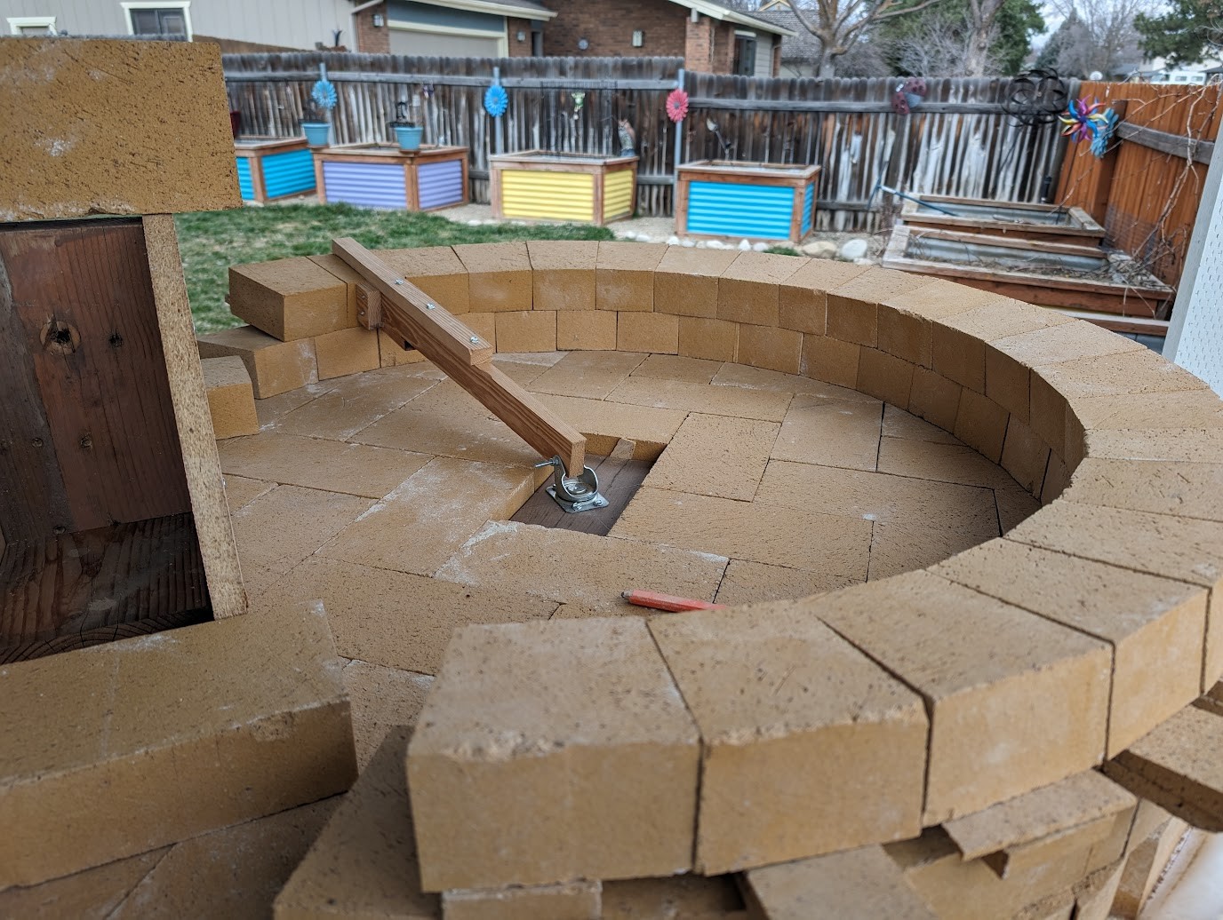

        Got the 2nd ring done after a bit of trial and error on cutting the angles... took most of the weekend to get those cuts and a storm came in before I could get the mortar in, but it's starting to take shape! I'll need to cut those shims a bit before slapping on the mortar. The 2x6 in the door is a bit too big and will need to get trimmed back a little before I start in on that part. Weather is back to being super windy and rainy with some snow/hail just for funzies... Waiting till I have a couple days with the overnight above 40 before I mortar.

          Nice looking build AJ, I like the corner design on the base.
          Don't let the design dome height get away from you as you move thru the rings. Trust your distance tool. The the 3rd-4th ring (depending on your dome shape) may start really angling inward to transition over, so be ready. Your cuts are great, I'm looking forward to the entry arches

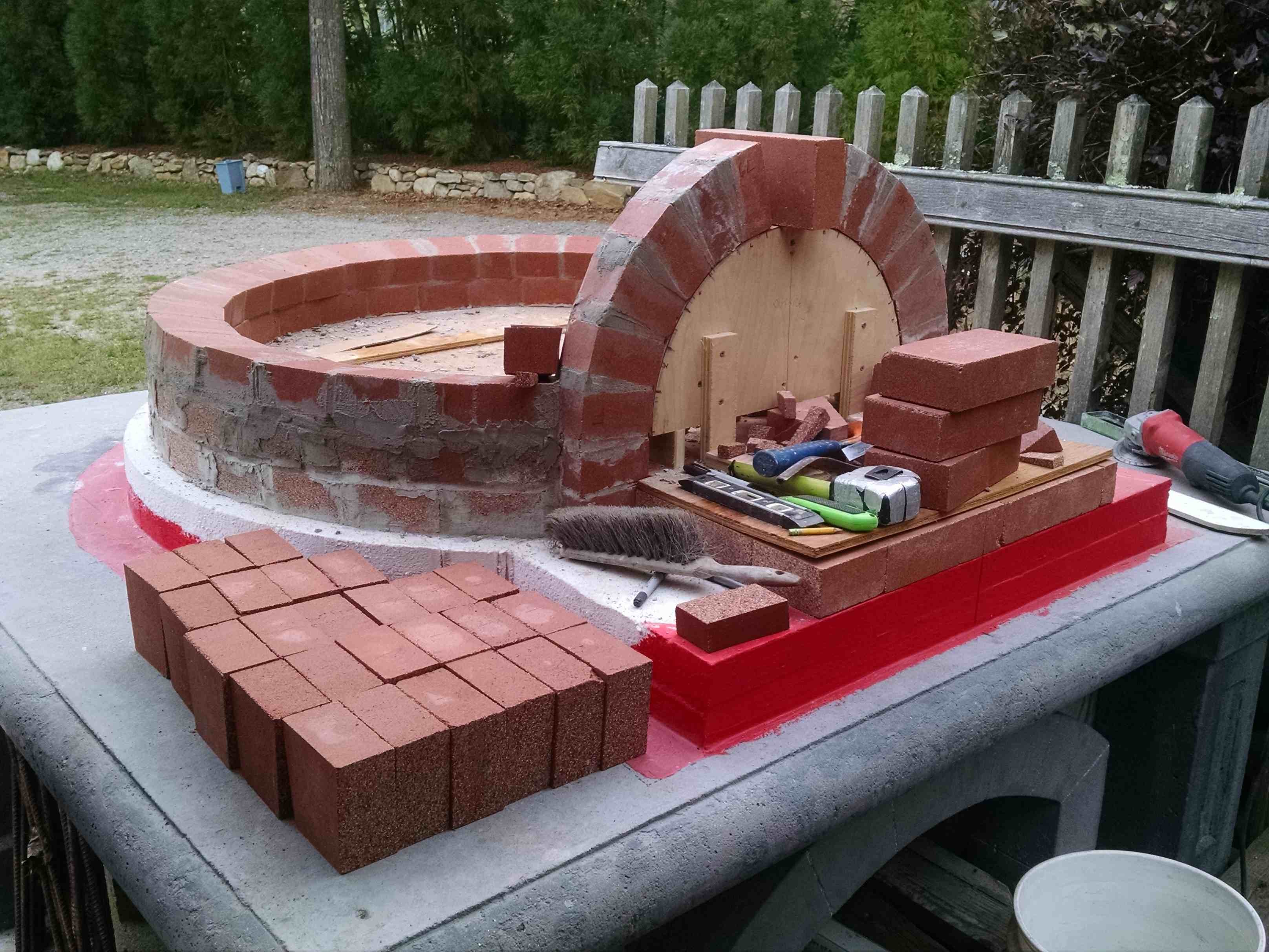

            I might have missed an earlier post...but your arch form design?
            Make sure it is assembled in a manner that will allow it to be taken apart in place after the arch bricks have been mortared in place over it.
            A few builders have built their form, mortared up the arch, then while trying to remove the form out from under the arch they've cracked some of the arch mortar joints.
            An easy way is to simply cut an inch (or two) off of the bottom of your arch form then place it on a couple of 1" (or 2") high blocks used as shims. When the arch mortar has cured, slide out the blocks, drop the form down, then pull it out from under the arch. I used scrap wood legs screwed to the form to raise my form off the oven floor.
            My arch form was assembled with screws, with enough of the screw heads accessible so it could be easily taken apart when needed. Save the arch form to use as a template if you intend on making a plug door. One less thing to try to measure.

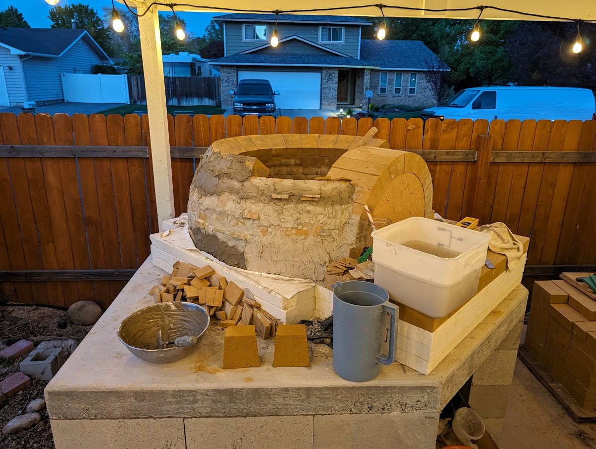

              Mongo - I'm planning on shimming the door when I start in on the arch. I cut the wood form at 11.25 inches so have room for a decent sized shim under it and still be under the recommended 12 inch finish height for an 18 inch dome. I'm also toying with the idea of attaching another board to the outside face so that the bricks stay flush against it when mortaring them in. I'm worried that the mortar joints might get sloppy though if I do... will probably depend on how tight I can get the joints =)
              Still need some nice weather to mortar in what I have and then cut to fit the bricks that butt up against the door arch bricks. The problem is, I get one or two good days to work and then its either raining or snowing for a week or two.....
              The day that I cut the 2nd ring it was 65 degrees out... when I packed in for the day, it started raining and stayed that way for a week before deciding to snow. This is what it's looked like for the last 4 days now:

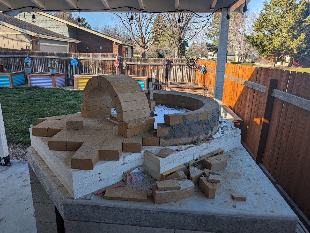

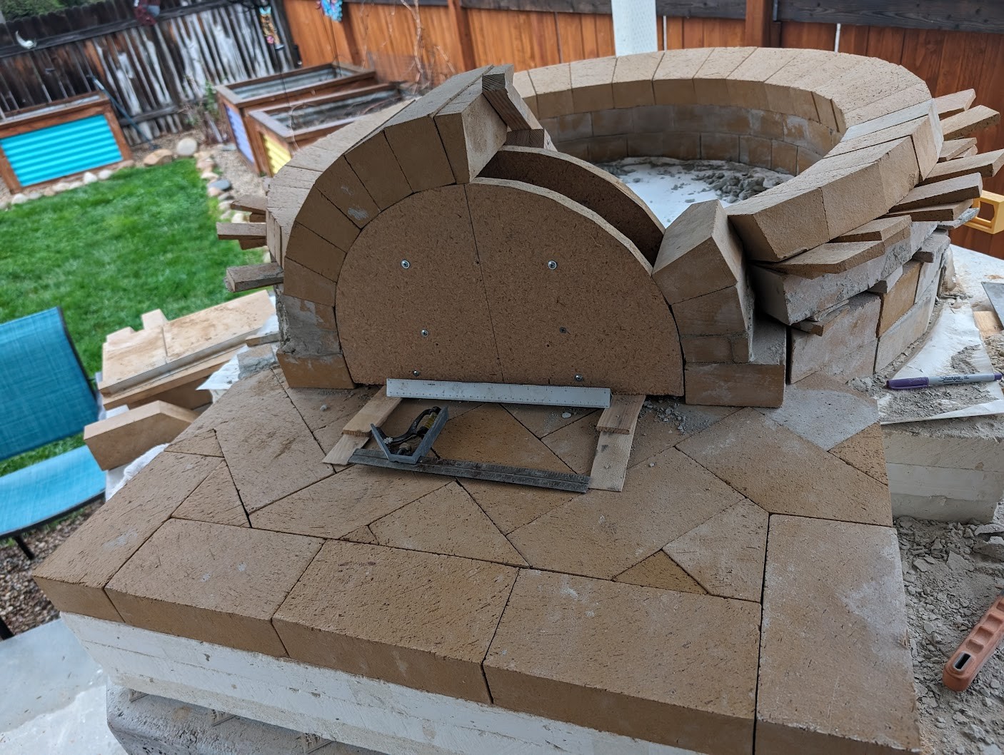

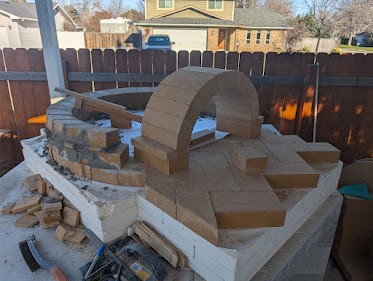

                        Got some decent progress again this weekend. I had to cut the doorway arch bricks down to 3 inches so that I could bevel the cuts without running then through both sides.. I tried one brick and it just wasn't working for me. Got the joints pretty tight and decided to see if it would hold shape without support or mortar =) first two rings mortared in and the arch is started. I still need to cut the inside of the arch bricks to match the dome. I'm not sure about where to cut the top yet since it depends on where the rings run into the arch... Going to cut them as I go and mortar them in as needed. Doesn't look pretty on the outside but that will be covered anyways. The inside is a little off here and there, but I'm the only one that will ever notice...

                          #72
                          That (the dome/arch intersection) was one of the hardest parts of the build for me to conceptualize when I was planning the build. However, once I got to that point in the build and saw the structure rise in front of me, it became so very clear and simple. Instead of me rehashing, check out this post and see if this helps. It's not the only way, but it worked for me.

                            #73

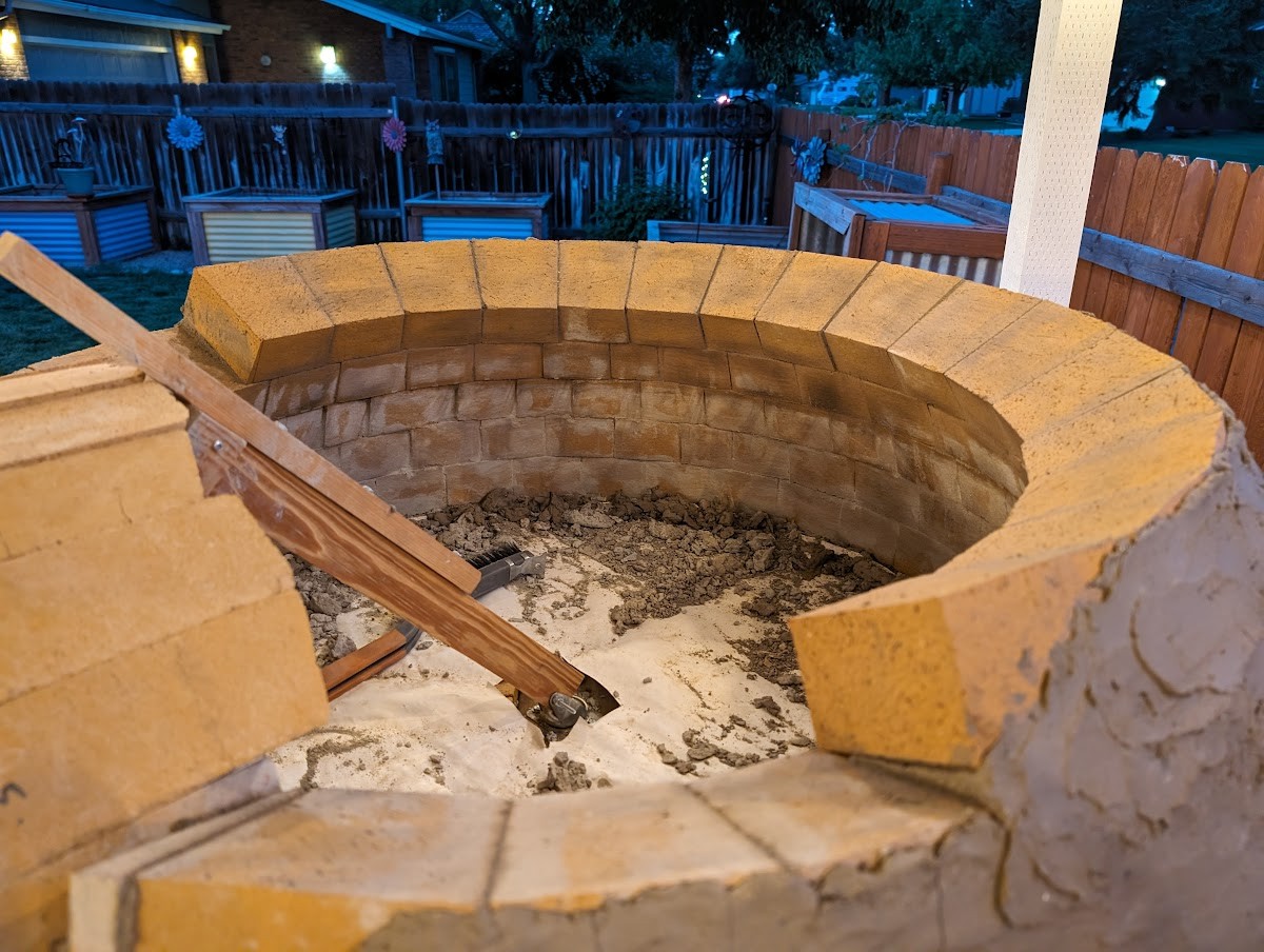

                            More progress in between bad spring weather. We got an inch of snow yesterday after about 4-5 inches of rain over the last week...
                            I cut the inside dome shape on the bottom of my door arch and now I'm trying to figure out where to cut the top. So far, I'm just figuring it out as I go and cutting them to meet up with the dome bricks. That seems to work out fine.
                            I got the 3rd ring cut and dry fitted and didnt like how the bottom ring looked. I had the first ring bricks dry fitted together tight and then when I mortared them together the little bit of mortar I put between made the last couple bricks a little wonky. I decided I could take apart what I had done and cut them down a little bit to not have me looking at the error every time I'm cooking in the oven... While I was at it, I decided it was time to finish off the landing in front of the arch. It cleaned up the front nicely and made it look like I actually finished something =) Funny enough, I was under the metal roof pergola cutting the landing bricks when the weather turned from light rain to 1/4-1/2 inch hail with a downpour shortly after... Talk about loud! freaked my dog out and we had to run the gauntlet back to the house to get out of the worst of it.

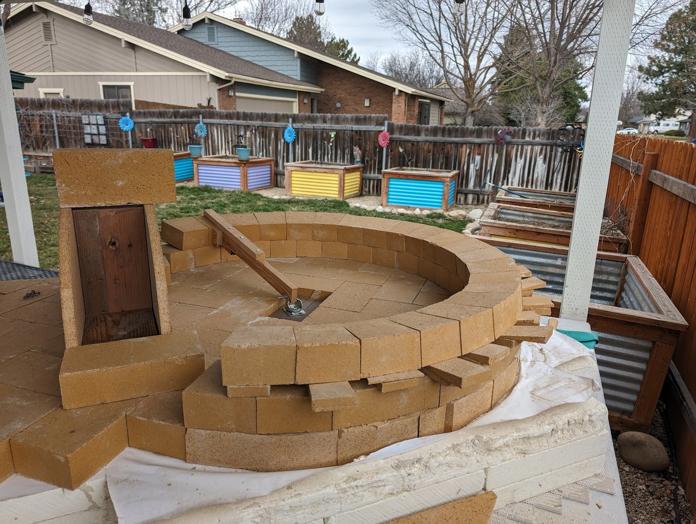

                                #75
                                Had some nice weather and got into a groove this weekend. Got the 3rd ring mortared in, cut and mortared the 4th ring, and cut and mortared most of the 5th ring. It's getting to the point where the bricks won't hold with friction so now I'm mortaring as I go, which actually goes faster than making the entire ring before mortaring anything in. Heading out later this week for my oldest graduation from college, going to try and get some work in at night after work this week before I leave. Getting close to the time I'll have to order the anchor plate and chimney sections so that I'm not waiting on them when I get to that point...
