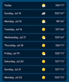

    Working on the chimney buildup and may need to go get a shorter 1 or 2 foot section of chimney to make it easier on me. Should be starting the drying fires next week just in time for temps to get stupid here... Picture doesn't look clear, gonna be 101 on Sunday the 7th, then 104, 107, 110, and 108 on the following days......

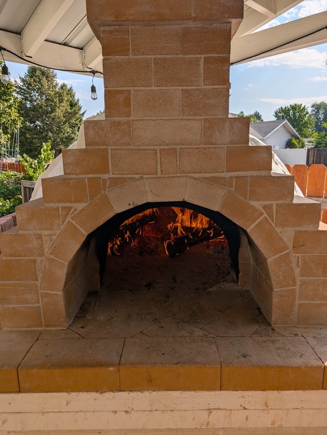

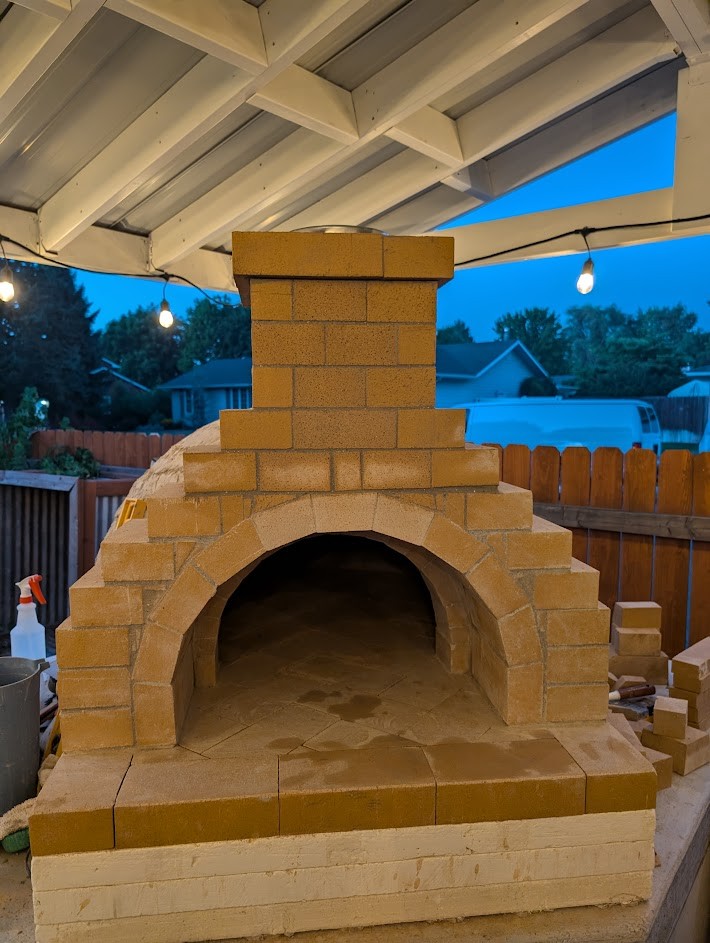

            Finished the buildup for the chimney

              Looks good. I like your stair steps over the arch - nice touch!

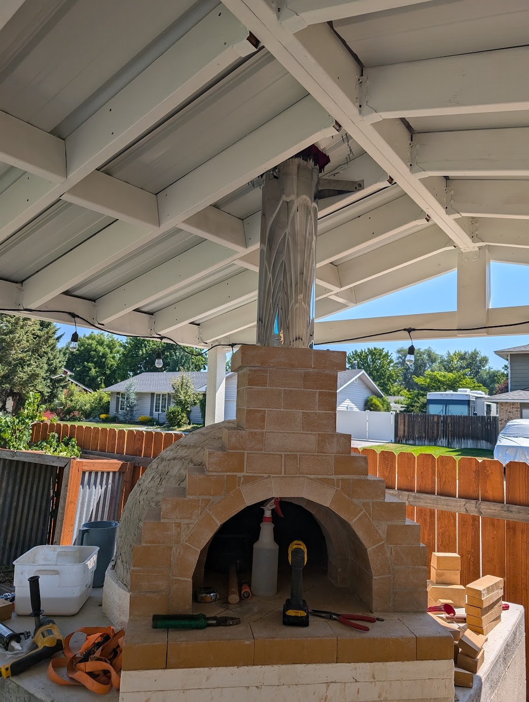

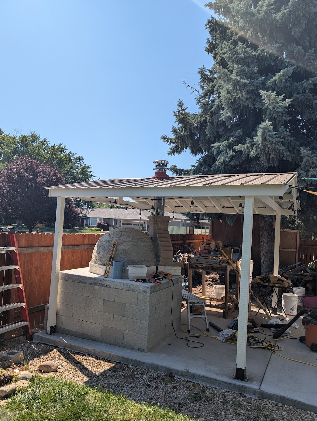

                Well it was only 102 degrees yesterday, so what better way to spend the afternoon than cutting a hole in the metal roof, installing the chimney, and screwing/silicone the roof boot on top of the hot metal roof? I should have used my temp gun to see how hot the roof was before I climbed up there in shorts and tried to put my knees on it....
                Next up is wrapping/wrestling the CF Blanket around it and starting the slow drying fires. Best thing to do is keep it at recommended temp for most of the day, right? Also, since the top of the dome will be hottest, is it better to keep that at the day's temp or better to let that get hotter and use the more middle of the dome wall as the temp reading spot?
                Still debating if I want to add another 12" chimney section above the roof or not and how I should hide the ugly screws from the waterproof roof boot on the underside of the roof...

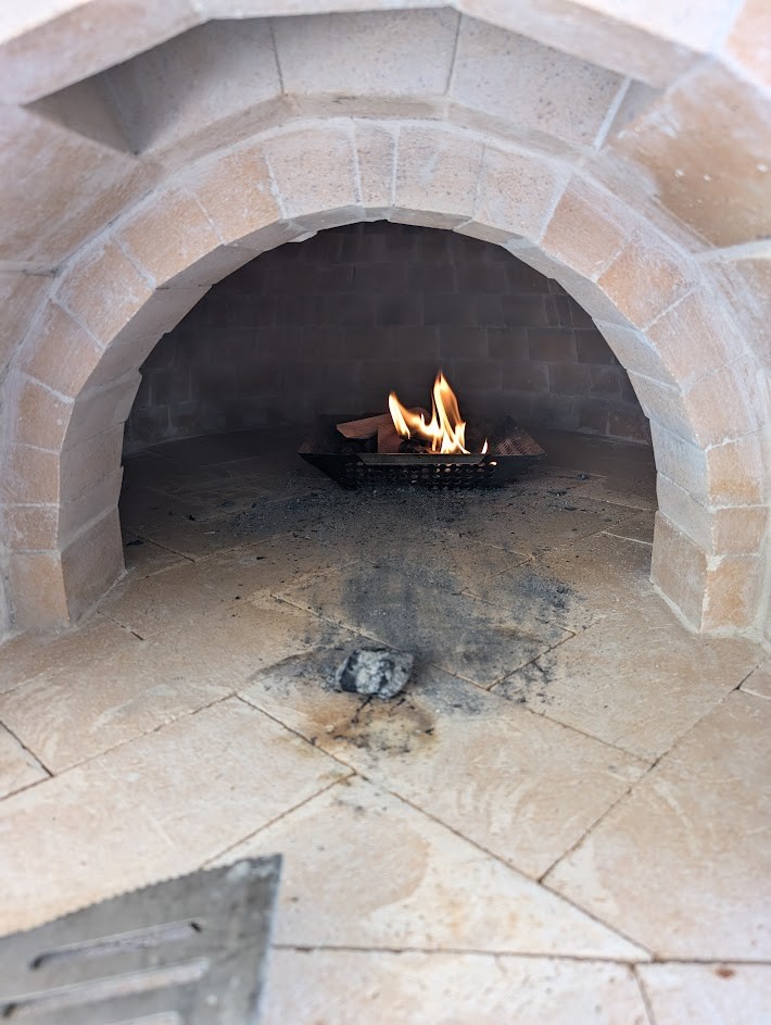

                  Cat on a hot tin roof. I would start with a couple briquette fires before an open flame. This will get you around 200 F without any flame impingement and you can cook a dutch oven meal if you are so inclined. Remember, when you start with wood, that one extra log can easily spike the temp to high. If you see steam you are too hot and too fast. The turtle wins the race in curing. This is where we see builders get excited and over heat their ovens and leading to potential cracking.

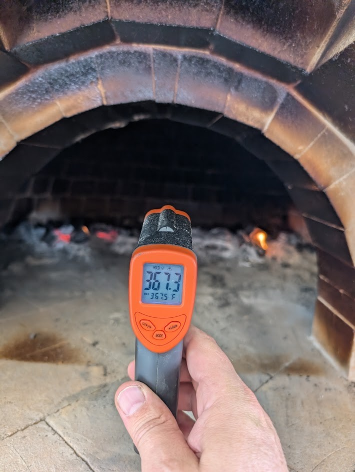

                    Well, it was a balmy 108 yesterday and I decided that I might as well add to the heat with some fire. Started the first fire and kept it going for about 12 hours in the mid 200 degrees. It was smoking out the front pretty bad and just plain smokey in general. Thankfully it was 108 degrees out and everyone was inside with the windows shut I started without the insulation on since it was so hot out, I figured there wouldn't be a temperature gradient to worry about in the brick. Towards the evening when it was down into the low 90s, I put on a layer or two of CF blanket and bricked up the door for the night. It was at about 250 when I went to bed and when I woke up it was still 175 inside.
                    Today I bumped up the temp a bit and held in the mid 300s all day and the smoke was a little more manageable. I did notice some moisture on the plastic I wrapped over the CF blanket, so it's looking like it's working. The temperature stayed in the mid 300s without much effort, but when it started dropping I had to make a new fire since the bbq briquettes were pretty much spent. I had a few times where the bricks read over 400, but that was when the small chunks of wood were on fire. Dome blackened up pretty good with the fires today.

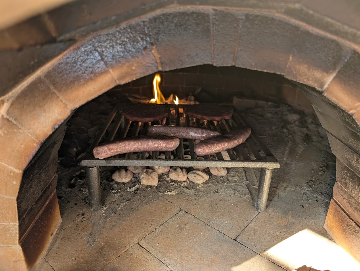

                    After keeping it in the 300s all day, I decided to try and cook some burgers and brats for dinner over the coals. Turned out great, but I made a greasy mess of my vent area Hopefully I can clean it off with one of the hotter fires later in the week.
                    Tomorrow will be a little higher yet and mostly wood fire. Need to figure out something good to cook for dinner at the 400-450 range... maybe lasagna

                      Wet ovens are typically smoky while the water is being driven off. When you get the start using a full load of wood with lots of coals, pull them out over the grease spot and it self cleans the brick.

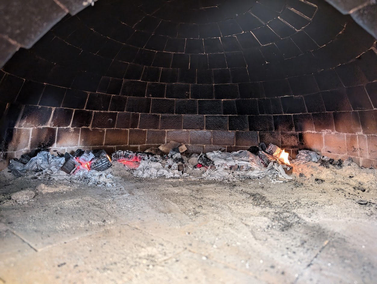

                        The last couple days of drying fires have been more difficult to maintain the temperature. I usually end up going 100-150 over with an active fire in the oven, but by the time it is down to embers I'm back within the range for the day and it holds for an hour or so before I have to light another fire. This morning I managed to clear half the dome by accident when I was supposed to be in the 600's for the day. With me holding the oven at temp for 12ish hours per day at each 100 degree step, I think most of the moisture has been driven out by now.

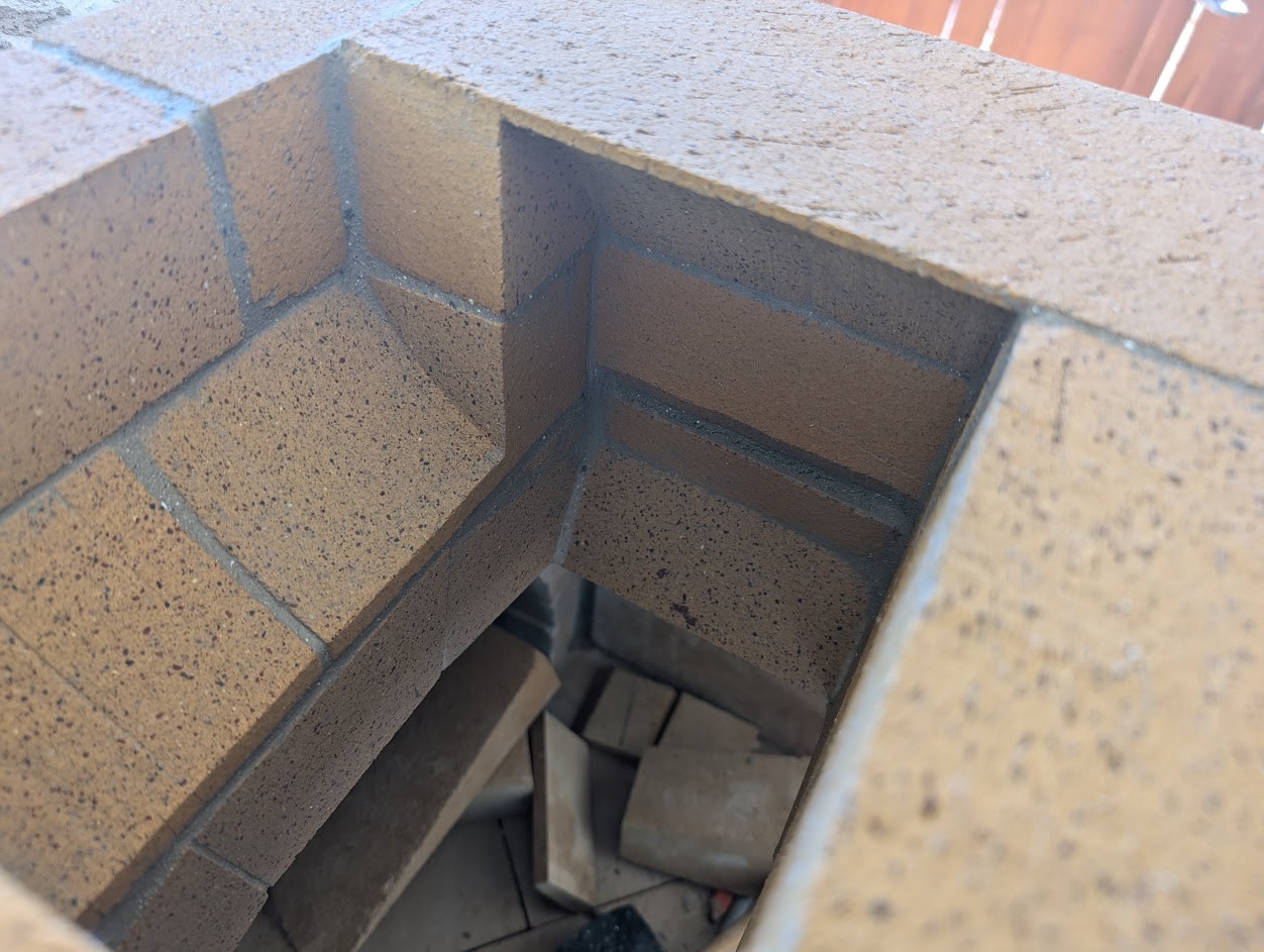

                                A more graduated flue opening with the larges square inch opening at the bottom and your flue pipe cross section being the smallest could help if you're having exhaust gas flow issues. It's logical to me that it would. But I'll let others with more experience chime in on that.
                                But flow might not be the problem, it may simply be that single thickness of chimney brick between the hot exhaust gasses and your face. Before demoing anything I'd even consider sliding a thick piece of rigid CF board insulation into the flue on the other side of those chimney bricks. Cut it slightly oversized and friction fit it in place. Shoot some temps on your next fire, then install it, shoot another set of temps, see if it changes things at all. Obviously that depends on your geometries and where the flue pipe lands.
                                Something like the photo below.
                                I'd hate to see you demo that work, it looks nice.
