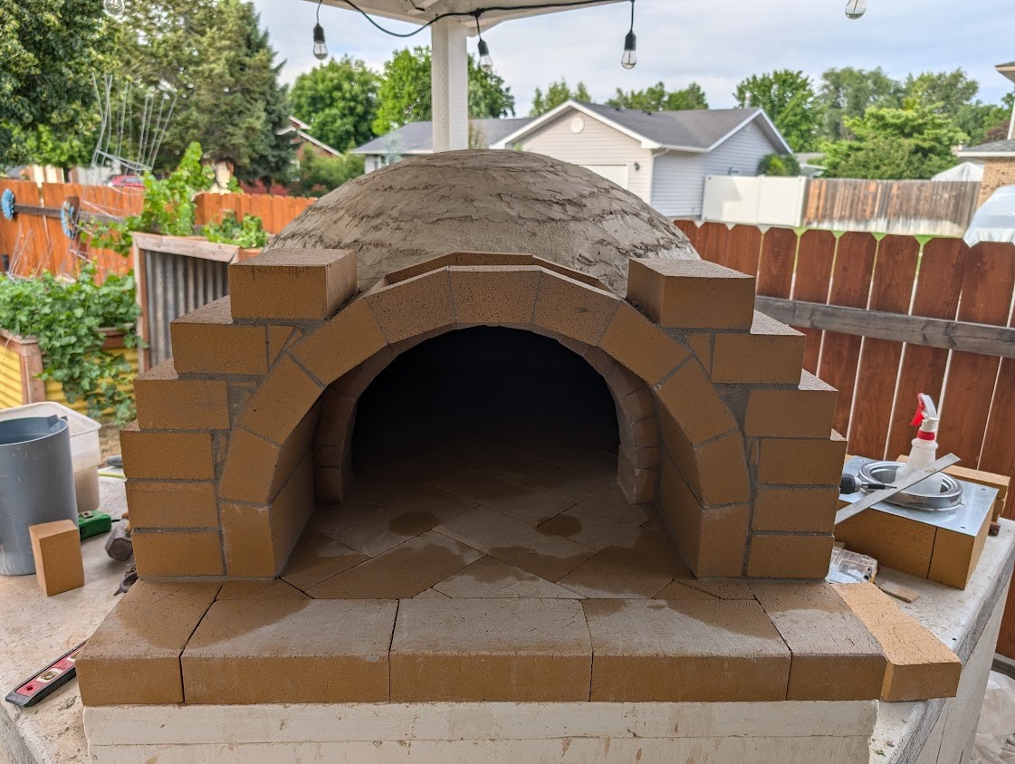

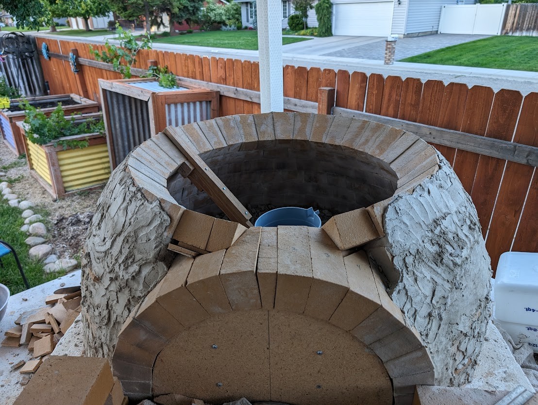

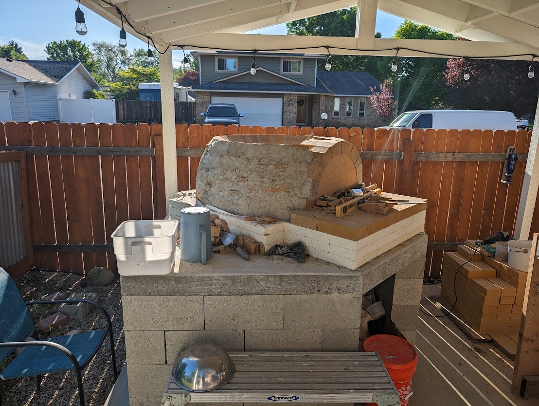

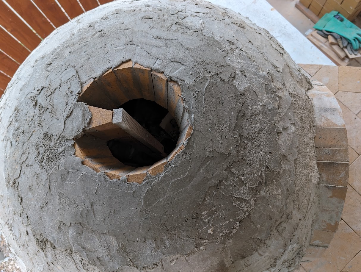

    Back at it after the graduation and some other weekend trips. I got the 5th ring finished, mortared in the 6th ring, and almost made it over the arch. I probably could have made it over the arch, but felt the arch bricks would have been pretty small at the top. Had to get creative with filling in the gaps after messing up a few of the angled cuts on the arch...

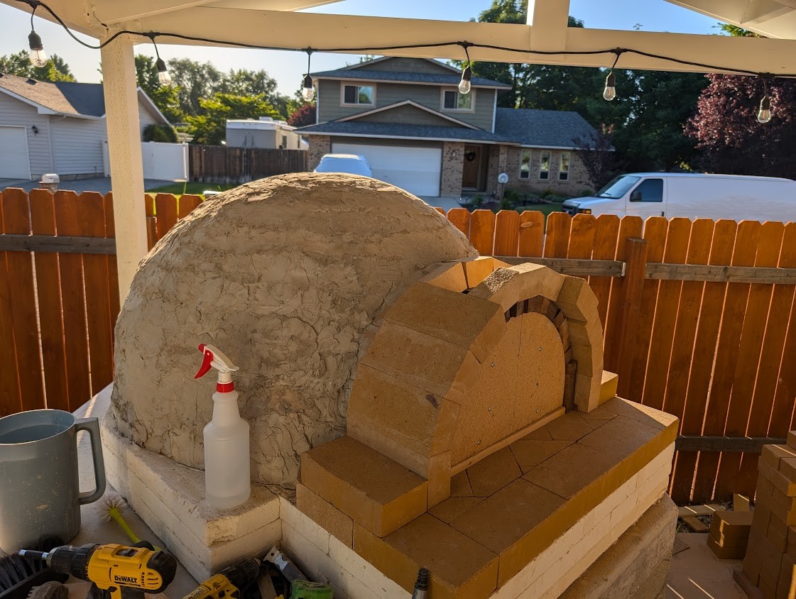

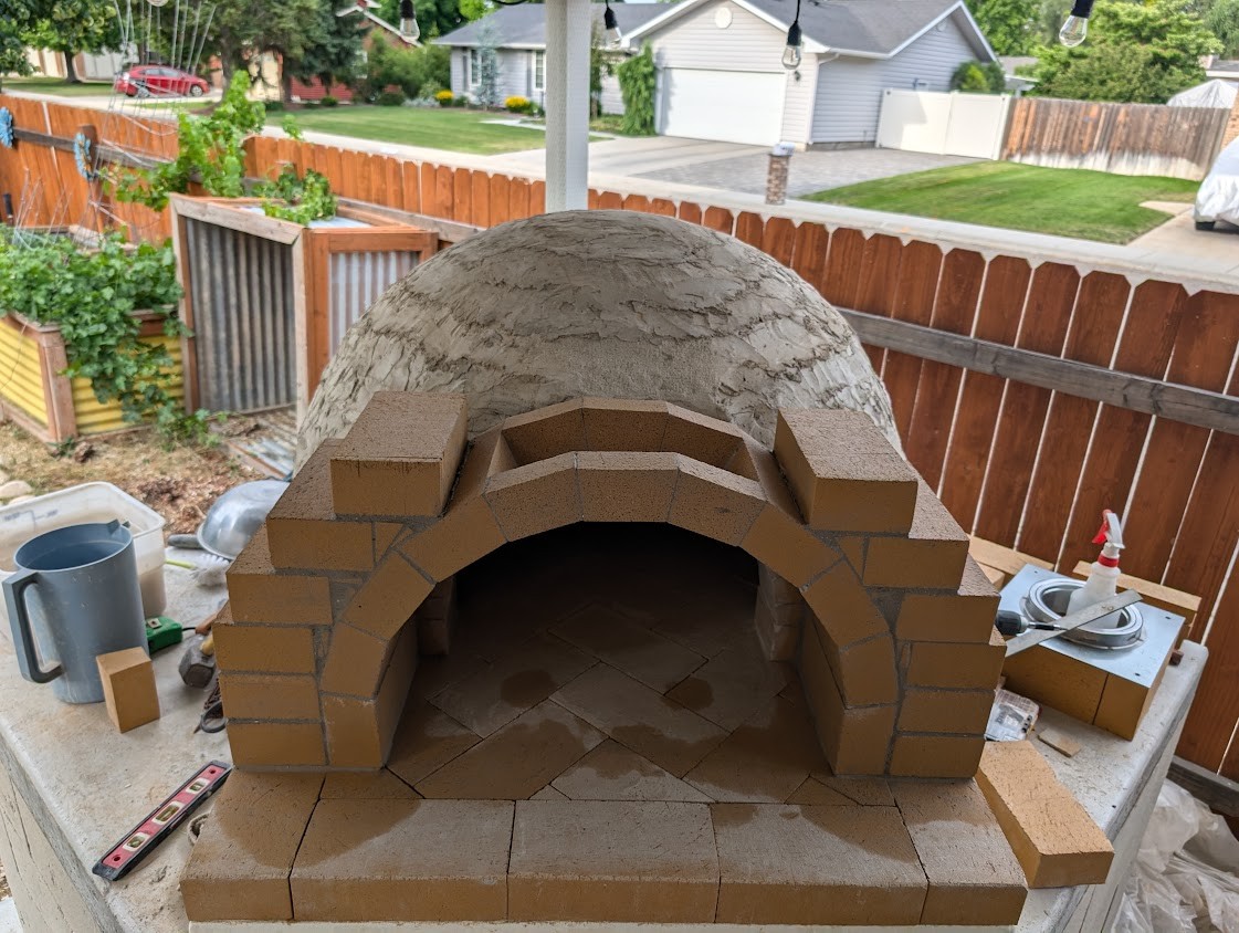

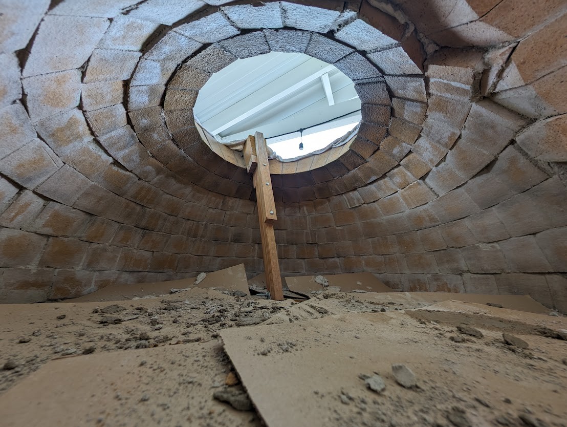

      7th ring finished and made it over the arch. Working on mortaring the 8th today. Steep angle only let me mortar in a few bricks then had to let them set for most of the day and come back later to get another 10 or so mortared in. No pics on 8th yet since it got dark on me while getting the mortar to set enough to put another brick in place.
      Looking a little sloppy inside compared to some of the builds I see here, but I think it will perform just fine for me =)

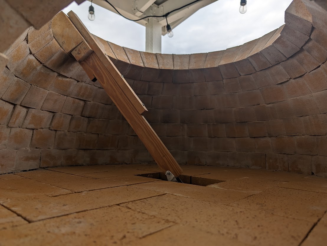

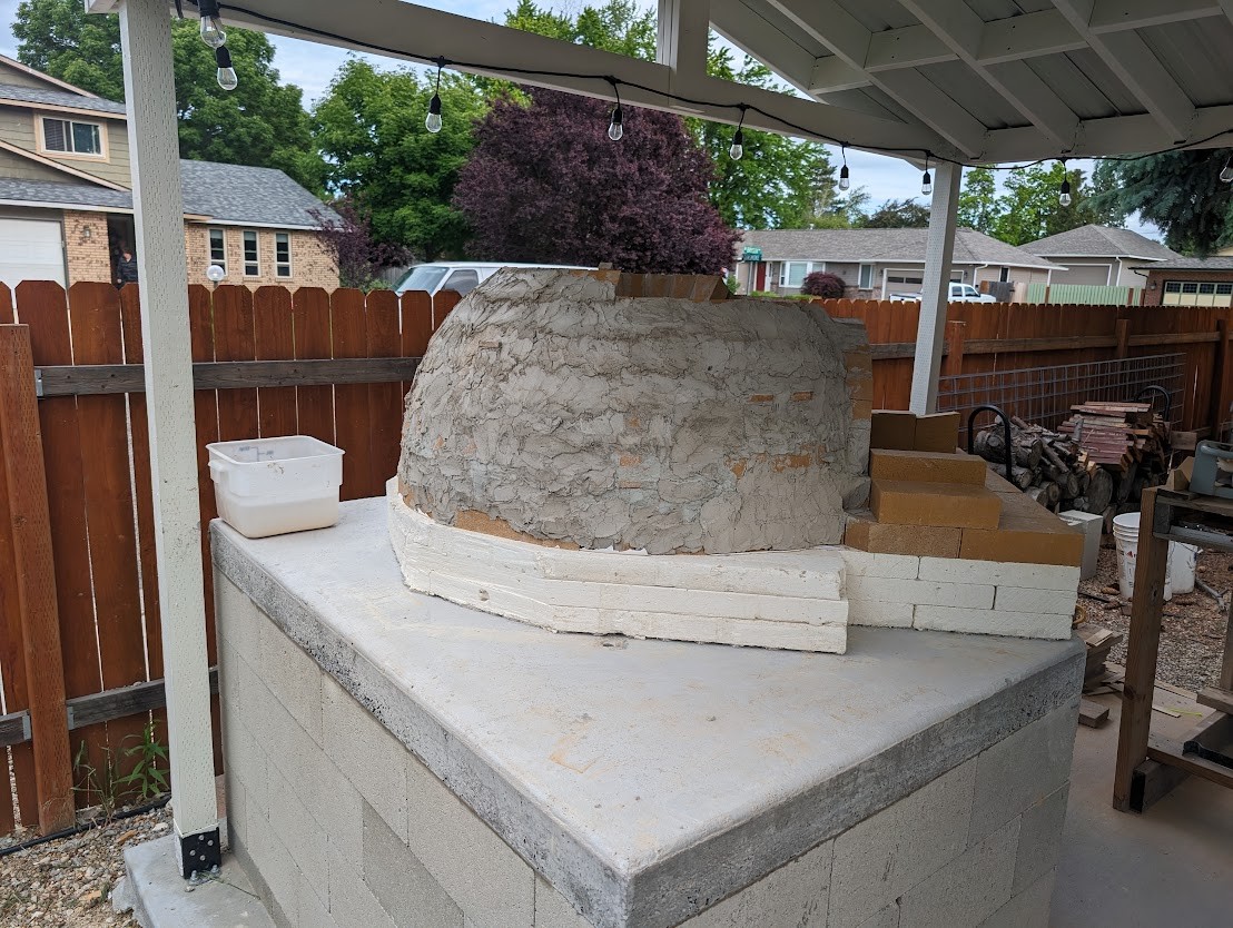

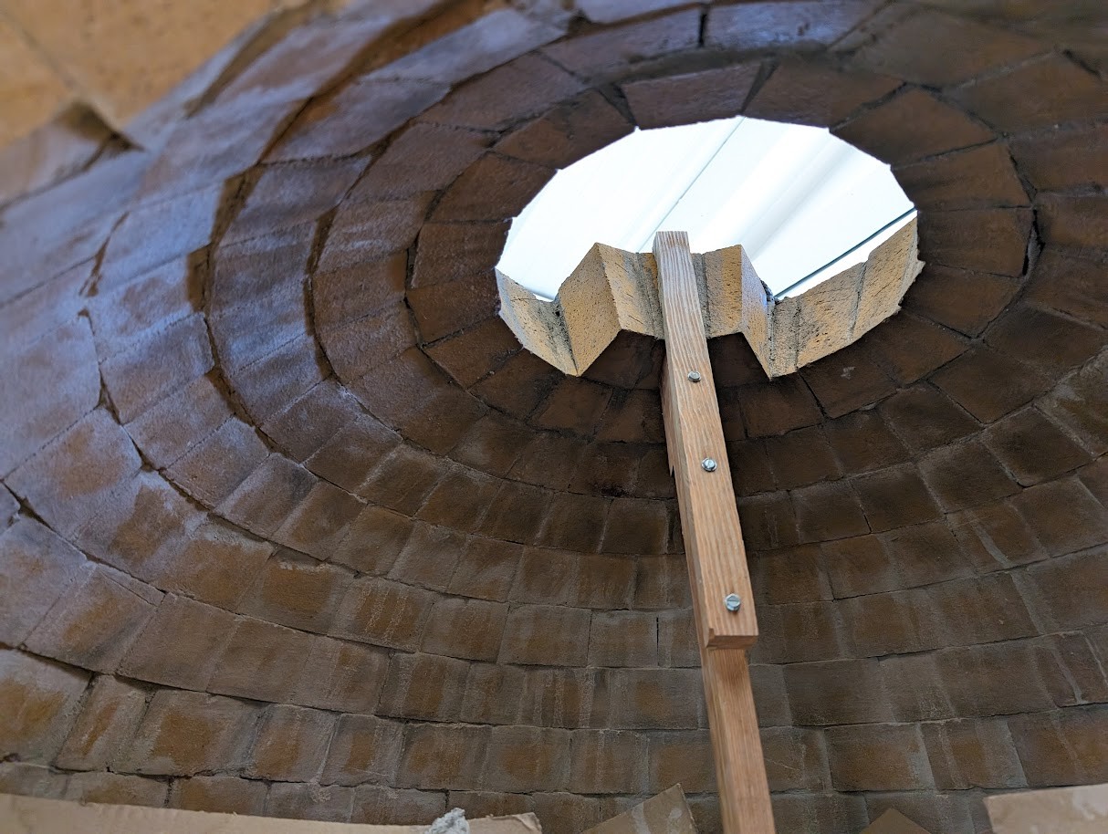

        Another ring done... I think I have 3 more left before the plug.

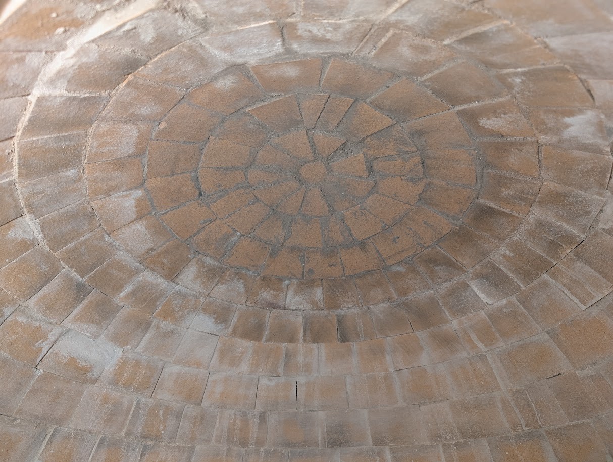

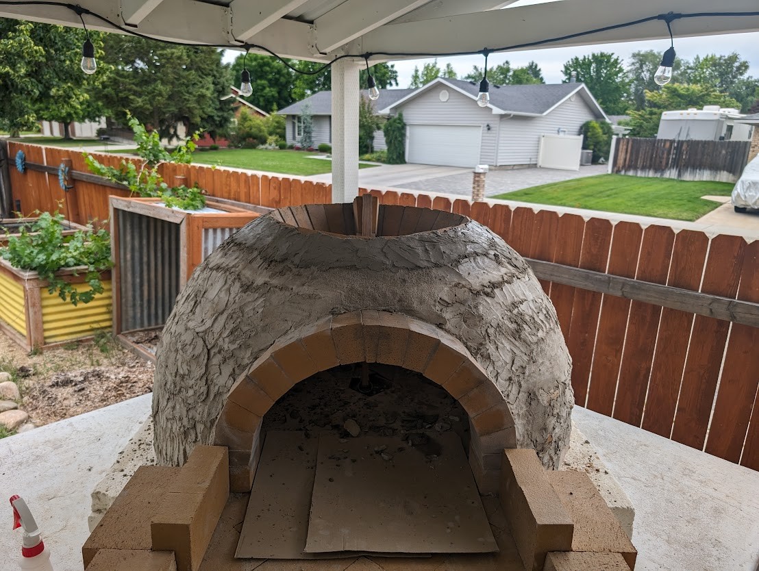

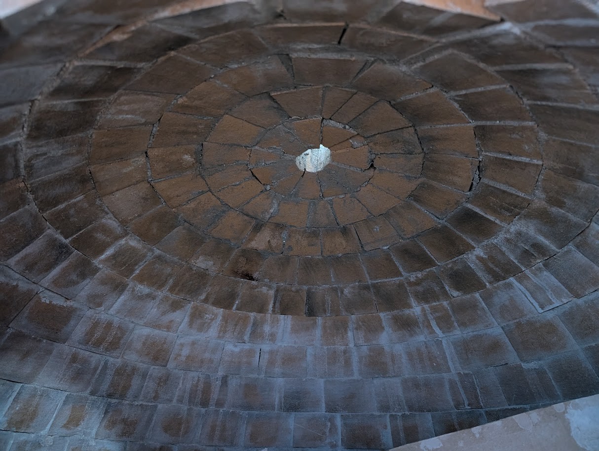

          Next couple rings done

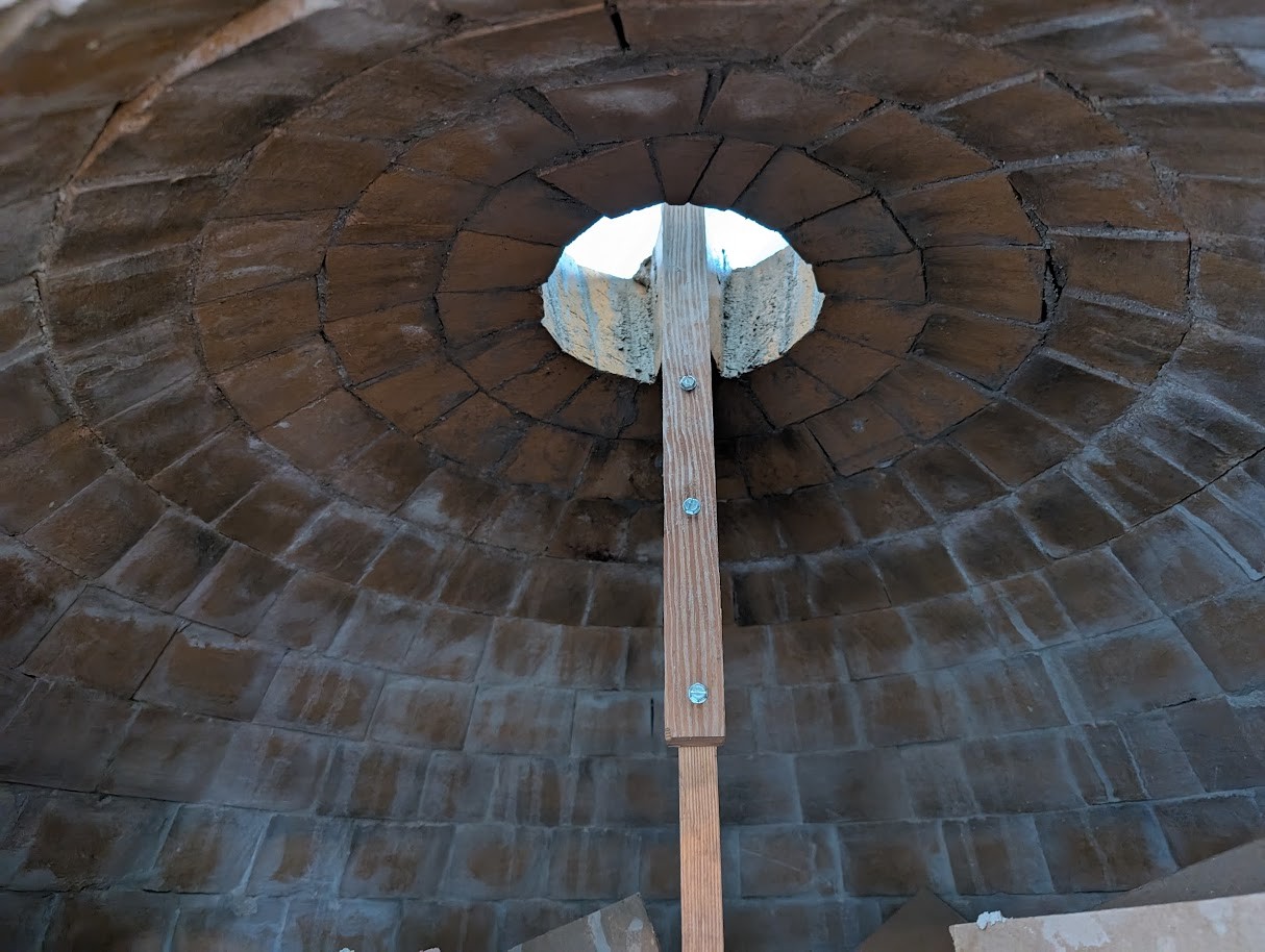

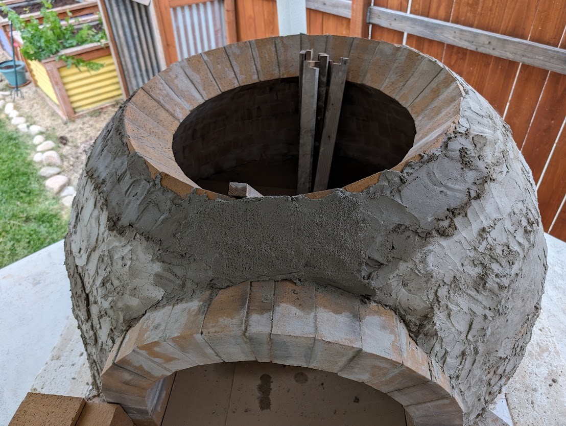

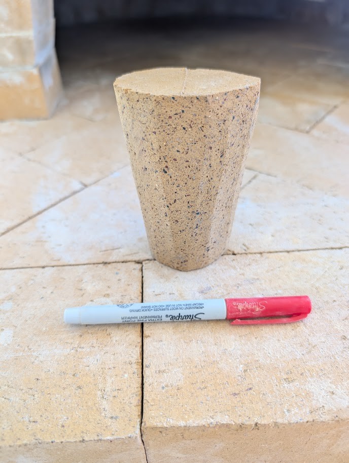

            Plug and Done! Next up is figuring out the vent and chimney.

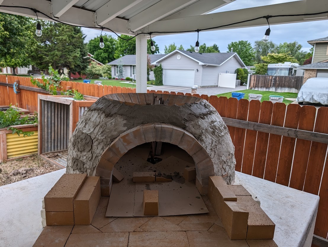

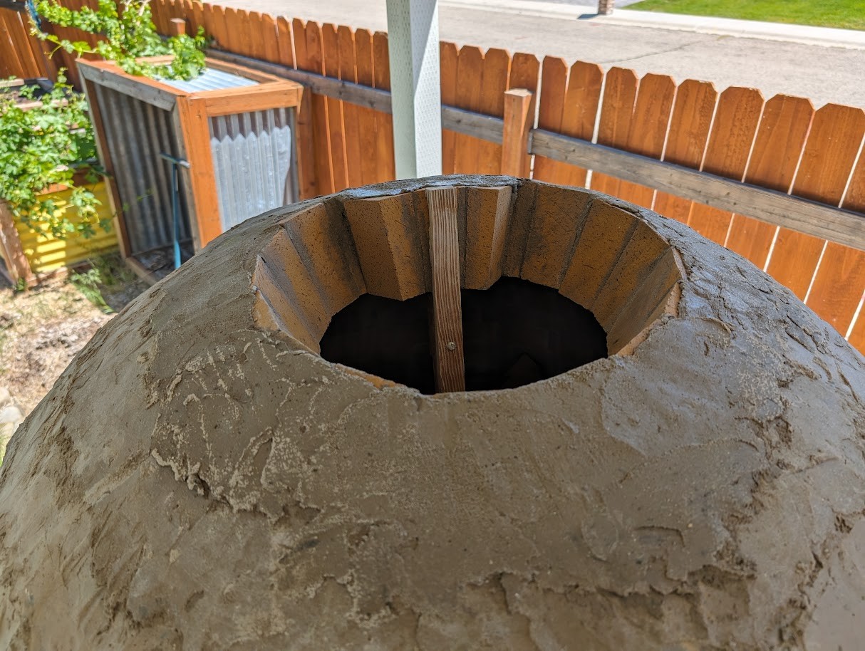

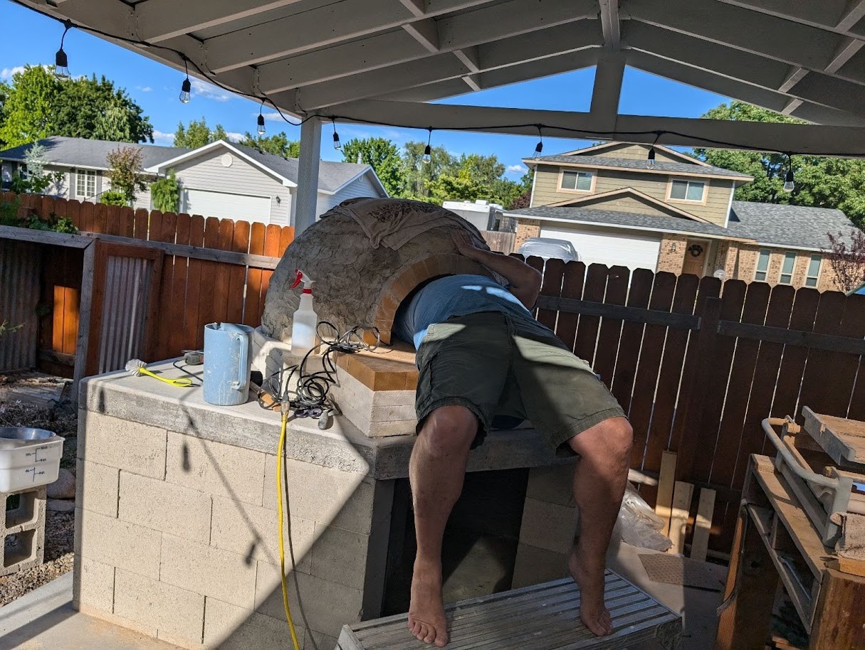

              Almost forgot the pic of the oven eating me... hehe

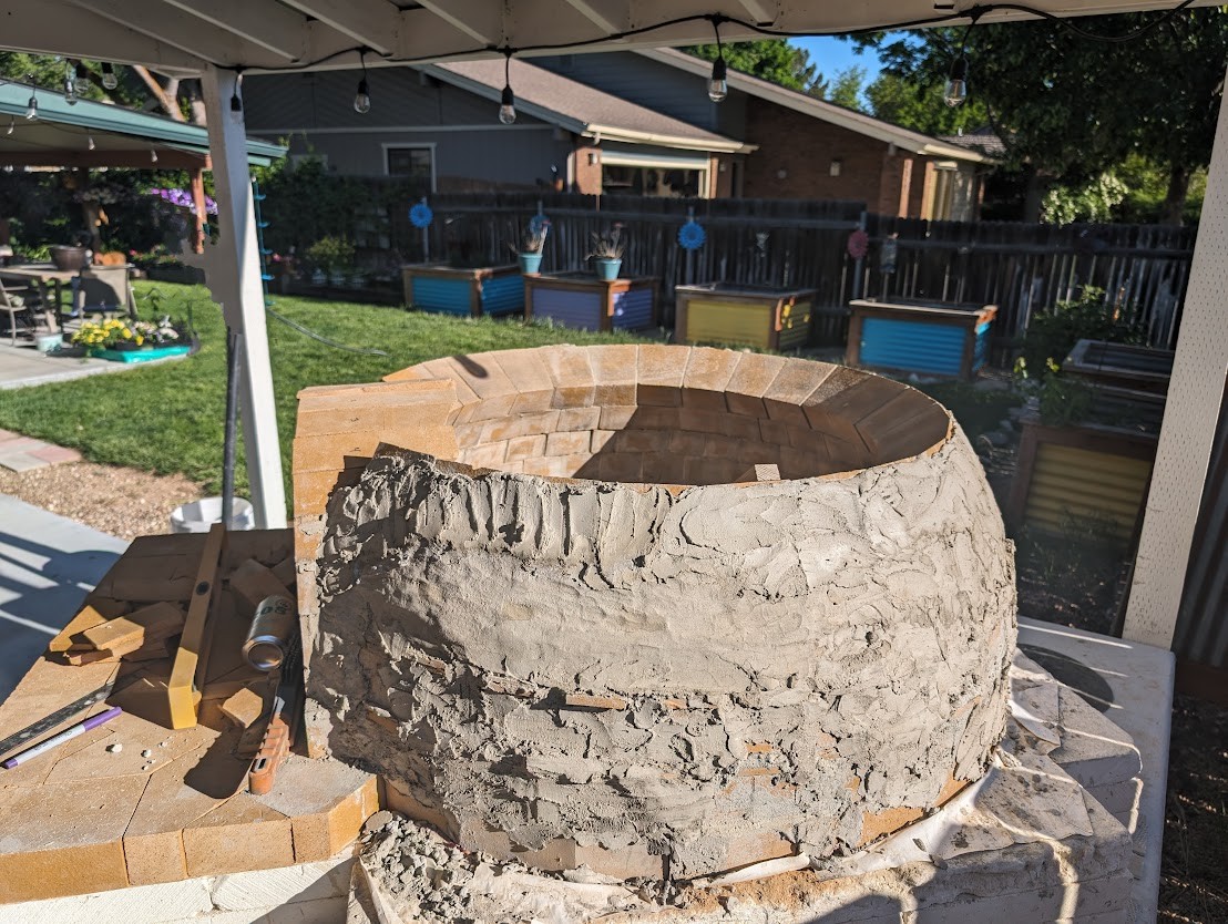

                    Been working on the vent area off and on due to the heat wave.. had to special order the anchor plate and that just came in, so now I'm building up the brickwork to get to the point that I can put the chimney up through the roof. Just have the chimney buildup and the front arch to do and I'll be done with brickwork! I have lots of ceramic fiber blanket still to wrap around the oven and trying to figure out a way to lock in the front bricks so that when I tile up the front, they dont pop off the tiles when the get bumped hard...
                    Have an idea for a door. Going to use some expanded metal type of stuff for the structure, wrap that with the ceramic fiber blanket and use some wire to sew it together. Then wrap the CF blanket with a carbon felt welding blanket, and stuff the inside with more CF blanket or left over CalSil board. Sounds like a good idea in theory, we'll see how it works once I get it built =)
