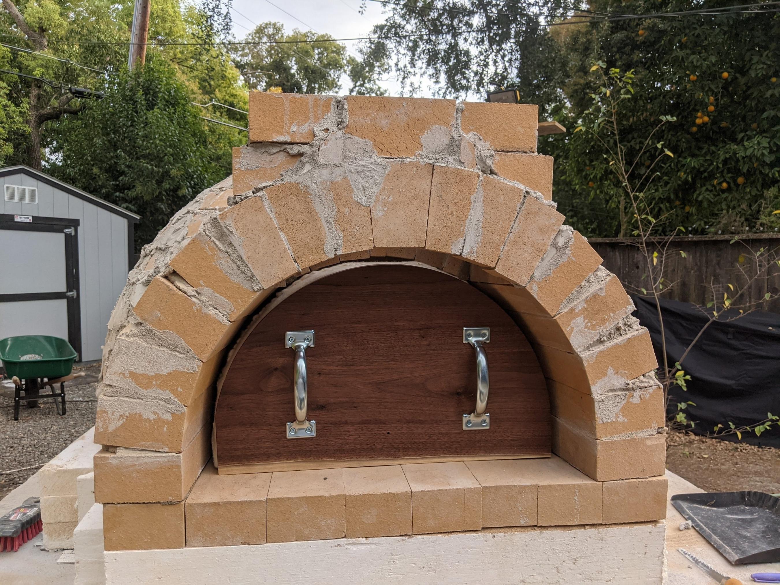

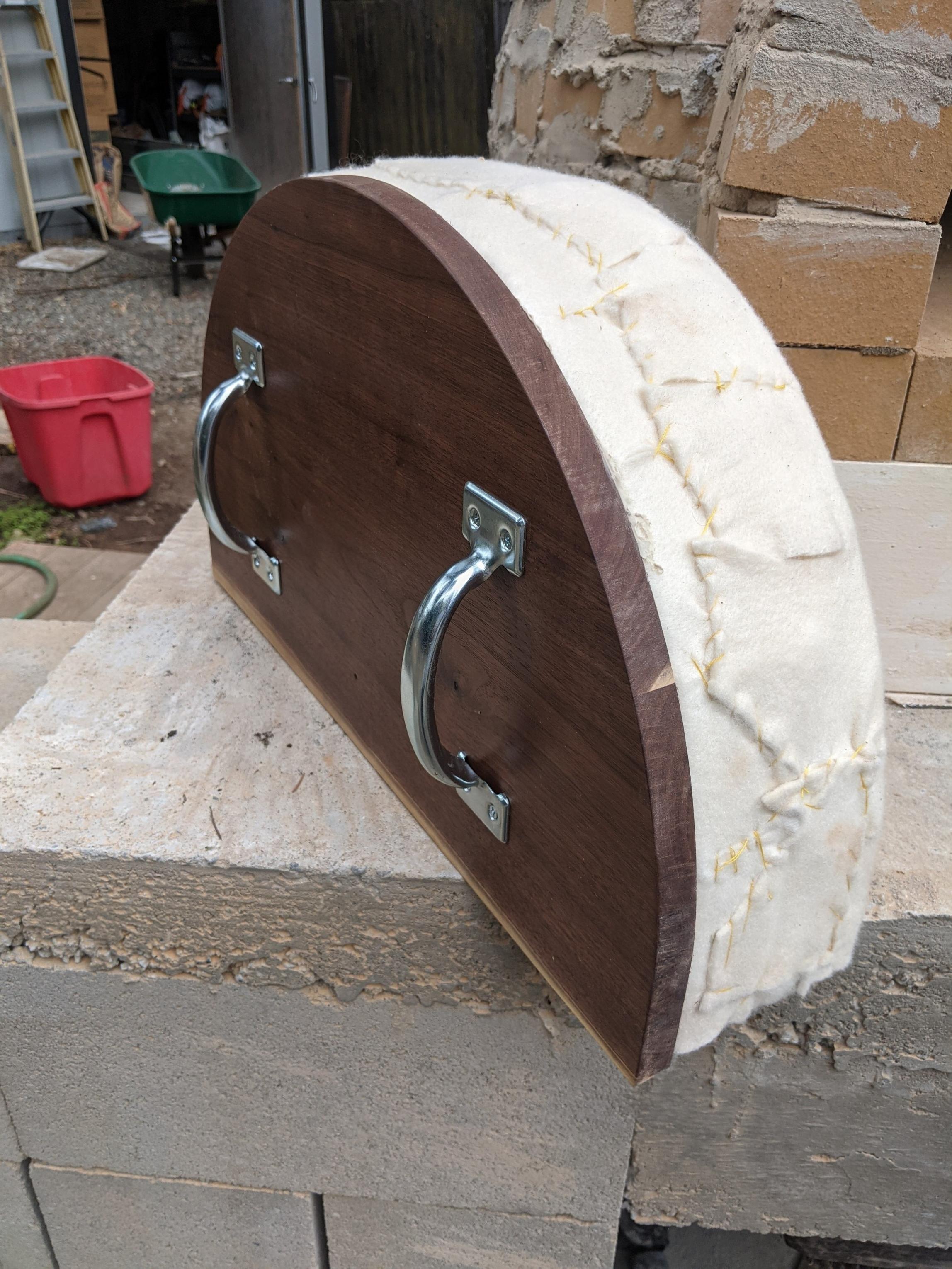

      Pulled the damp towels yesterday, and I'll start curing with the light tomorrow. In the meantime, finished my vent, and also my door. Four coats of spar urethane on the walnut front piece, and a whole bunch of Liquid Nails Extreme Duty between the wood and the Nomex to bond them. With my initial tests of hefting it about, the combination of adhesive and stitching seems to have done the job to keep it as one cohesive piece. Weighs in at a bit over 11 pounds, not bad for 4 inches of insulation (the CalSil pieces alone weigh about 7 pounds).
      Most of my chimney parts arrived except for, annoyingly, the base plate, which I ordered the wrong one of. Ah well; means I can be more patient about the mortar on the vent hardening up, reducing the odds that drilling the tapcons shakes something loose.

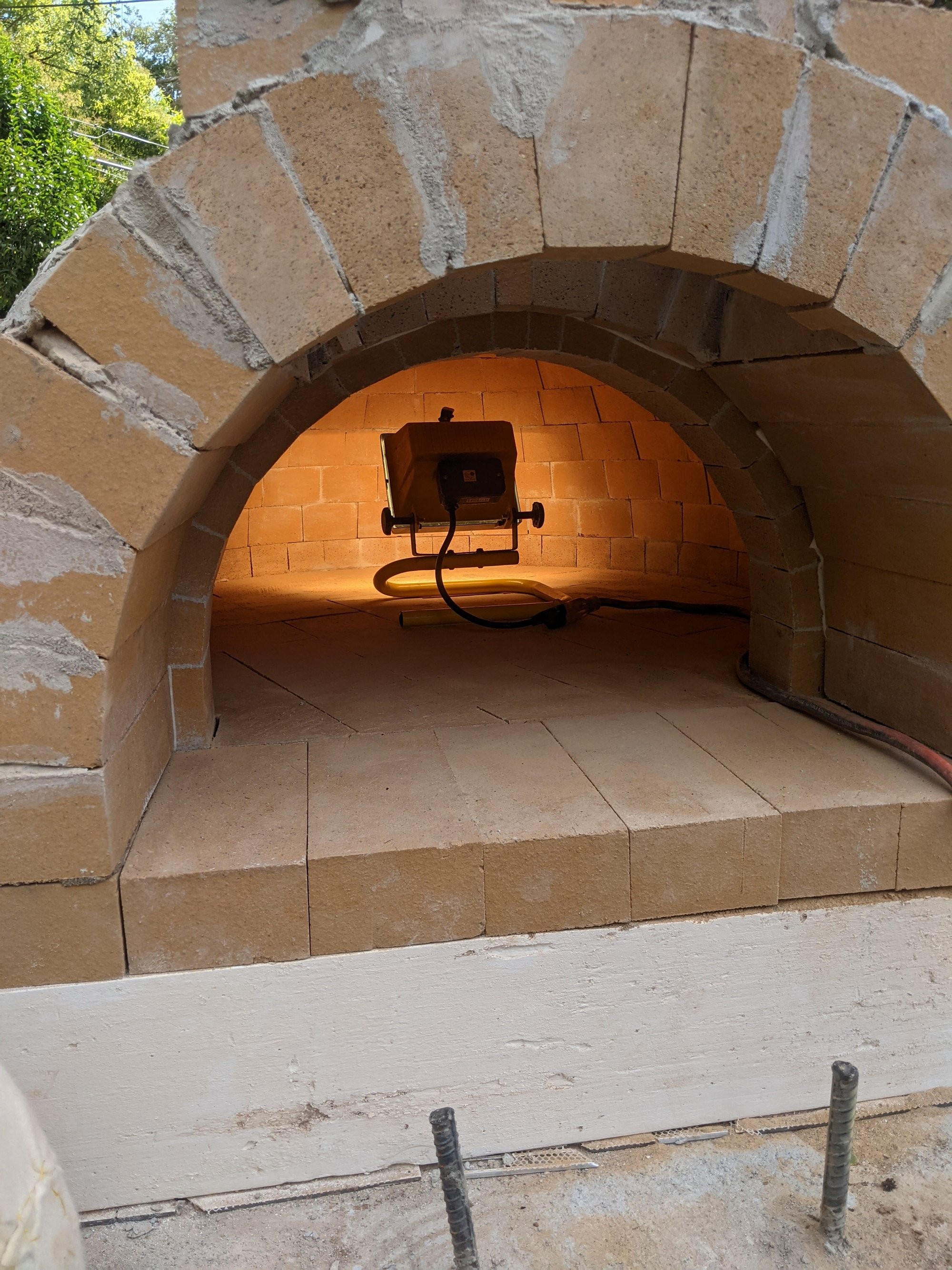

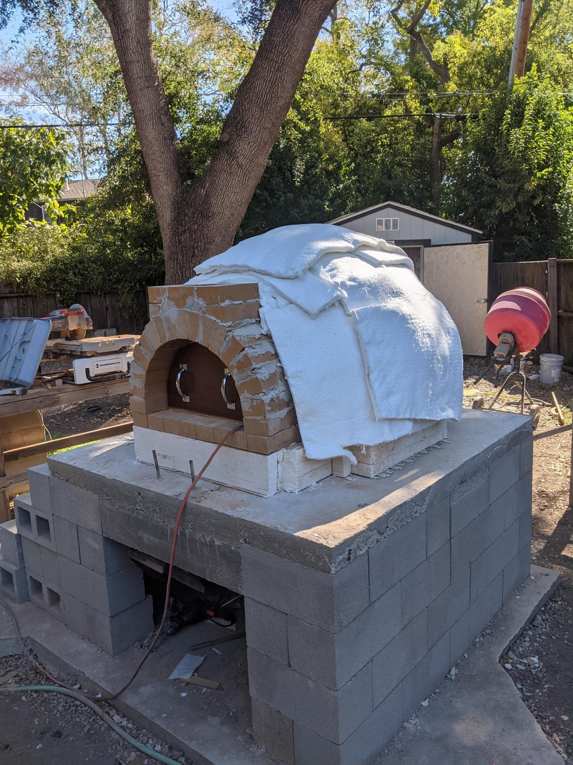

        Had the light in since yesterday afternoon, got the dome as high as 150F. Today I put on the blanket insulation. Despite doing a pretty good job (I thought) of cutting it to fit tightly, I ended up with way more than I really needed. Three 25' rolls of Morganwool got me 4" all around and something like 6 or 7 on top. Should get pretty good heat retention! This afternoon, after the insulation had been on for a couple hours, the dome registered 170F just with the light. Not sure I need to bother with heat beads, but I'll keep the low heat going for a while.

          That halogen work light (acquired from my dad, who found it on the side of the road years ago) is doing yeomen's work on curing in combination with the insulation and my door. This morning the oven floor was around 200F, the dome was at 220F and I could see steam in the rays of the light. Could just about smoke something at those temps! Firewood delivery comes this morning; I'll still start small, but I feel pretty good about a 300F fire not generating too much steam!

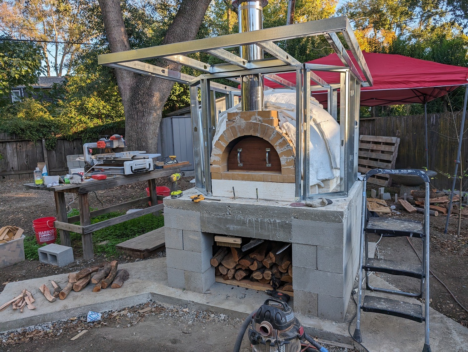

                Started working on the enclosure, cutting track for the metal studs, but nothing picture-worthy as yet.

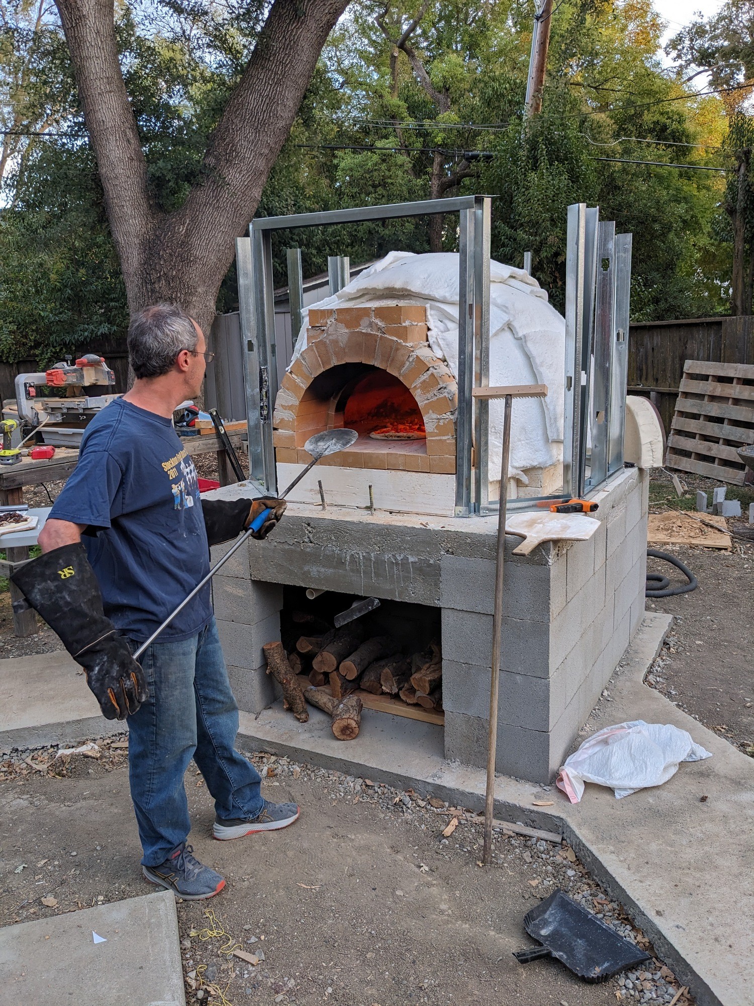

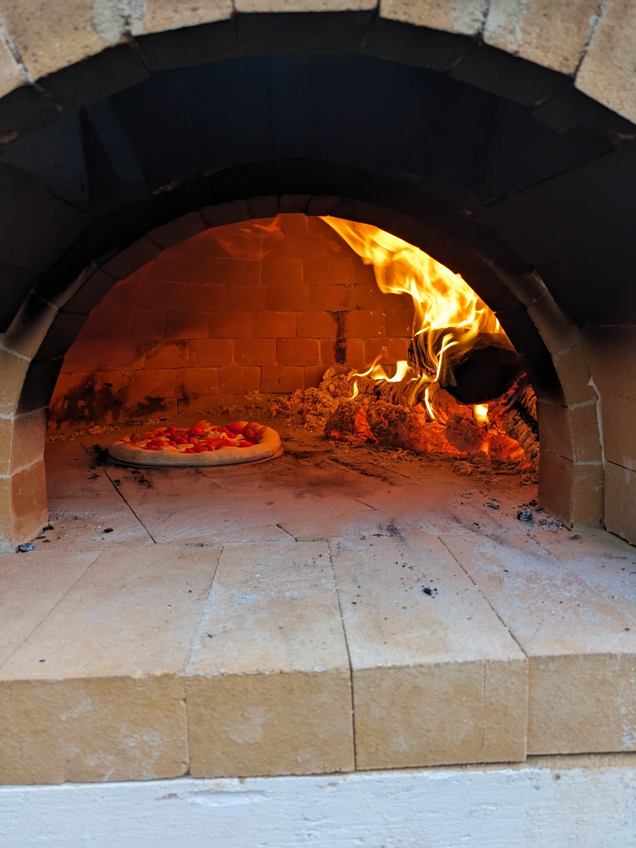

                  First pizza bake went well! Invited my parents over and baked five pizzas. The dome cleared a little slowly and a little unevenly compared to my first oven (some dark patches remained here and there) so possibly still a little wet, but I didn't encounter any cracking. This will be the real test for the Nomex door cover, as I extinguished a full pizza fire with it.

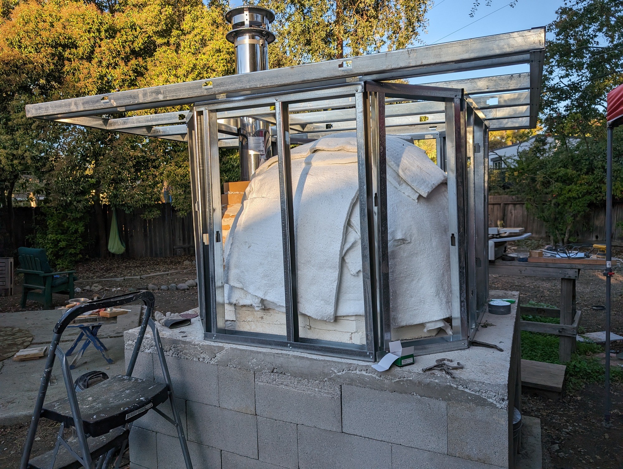

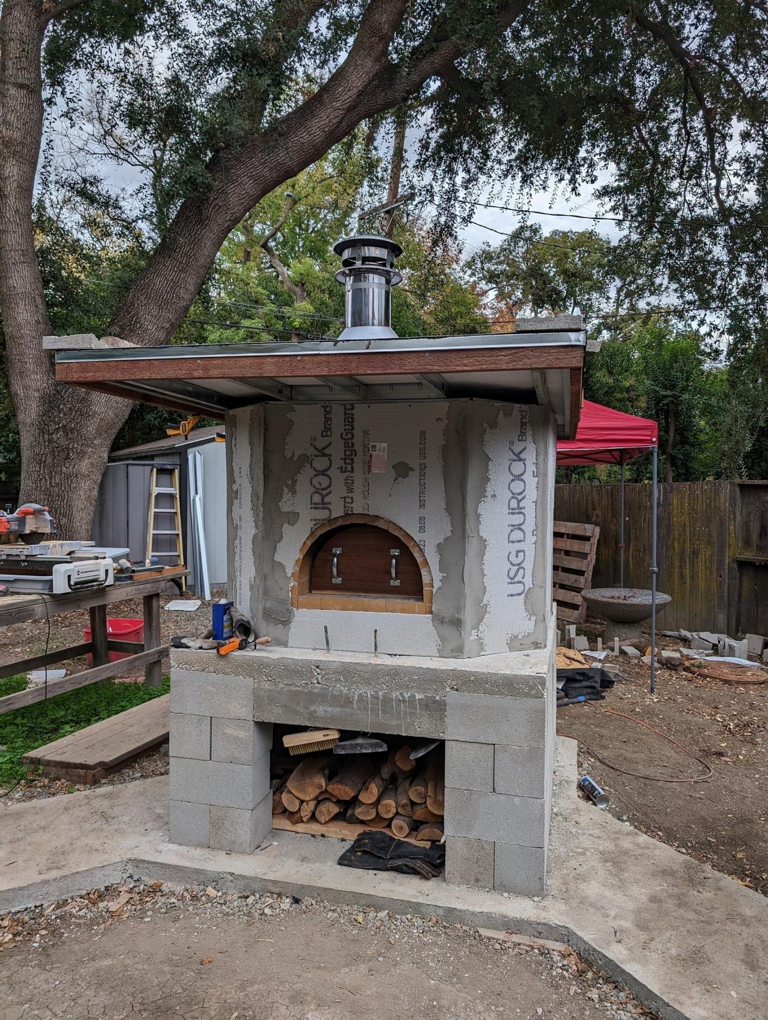

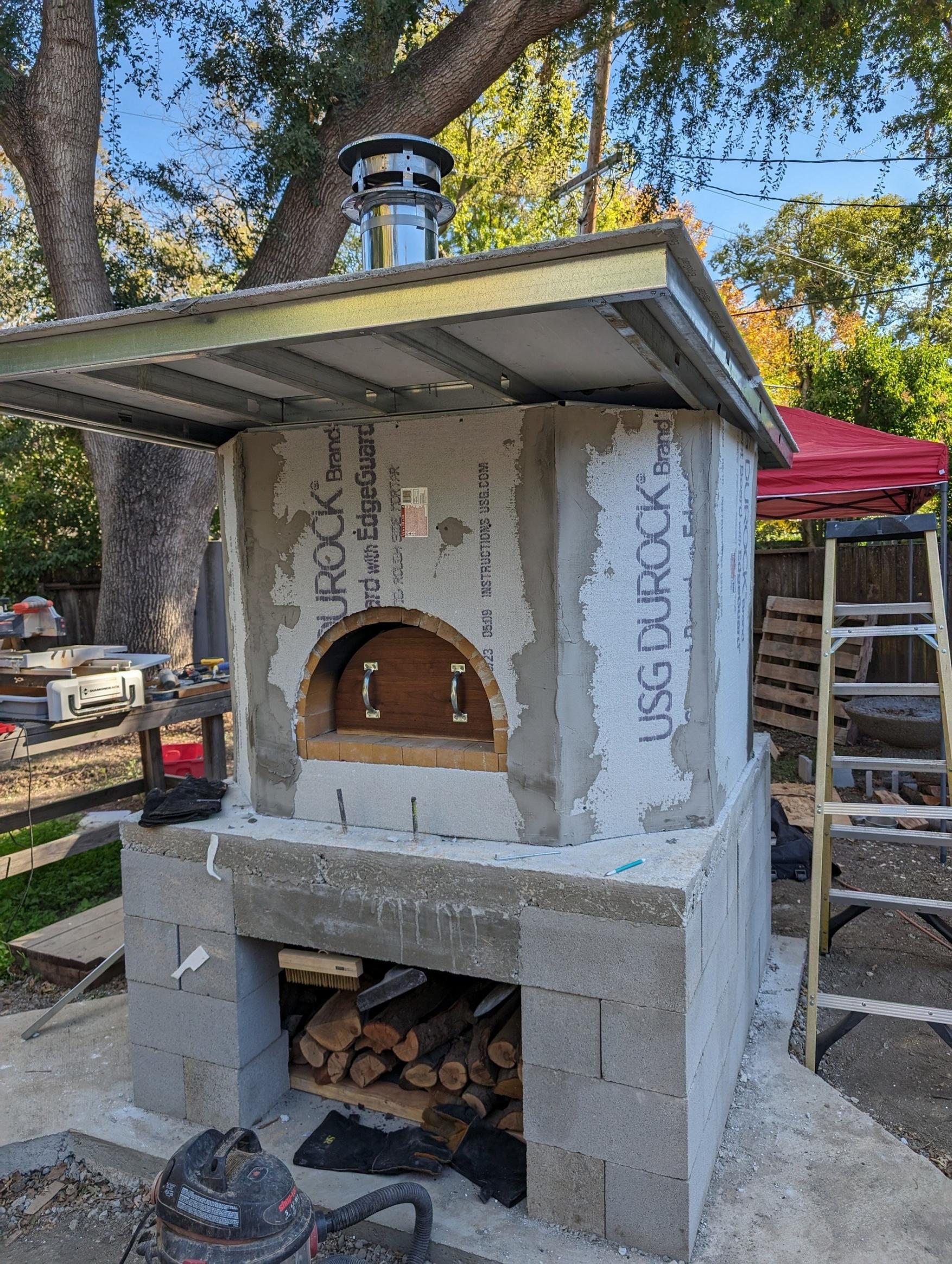

                          Finally got my chimney base plate this week, so I have a chimney at last. Hoping that will get the smoke out of my face on the next fire-up. Over the course of the week I got my enclosure all framed up, finished attaching the roof structure today. Started to cut down cement board for the walls, but haven't put any on yet; probably get to that this weekend.
                          Aiming to get a full roof on before the rains start in for real; in non-drought years it can rain almost daily from November through March. Since I (more or less on purpose) made the pitch of the roof so low, I'm basically down to flat roof materials as options on top of the cement board roof deck. Thinking about just hiring a roofer to do it, if I can find one who will do a job that small. I think what I might save in labor doing it myself I'd lose in materials costs for adhesive and such that I can't buy in small enough quantities and wouldn't be able to re-use the excess (never mind that a real roofer would surely do a better job than I!).

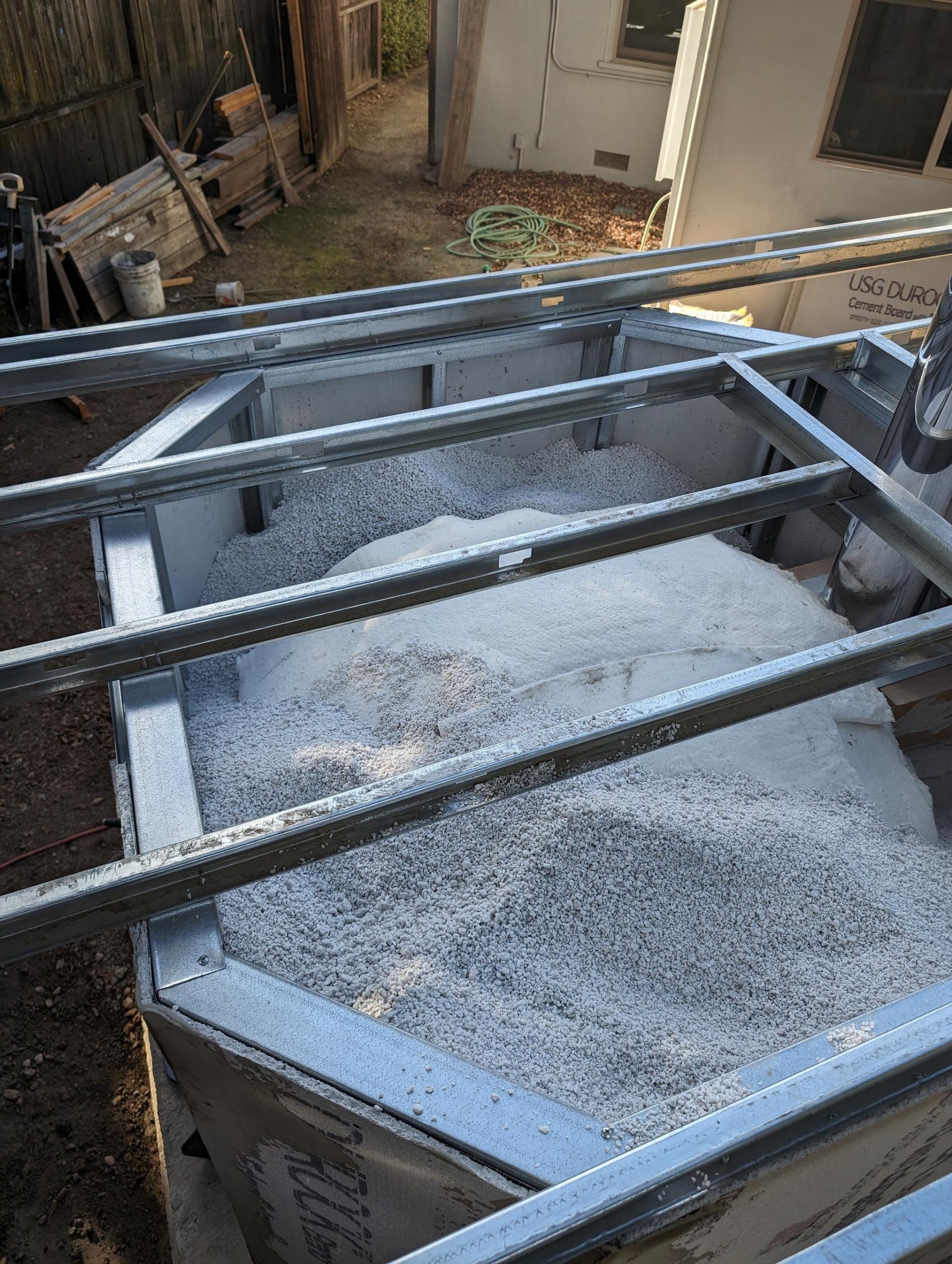

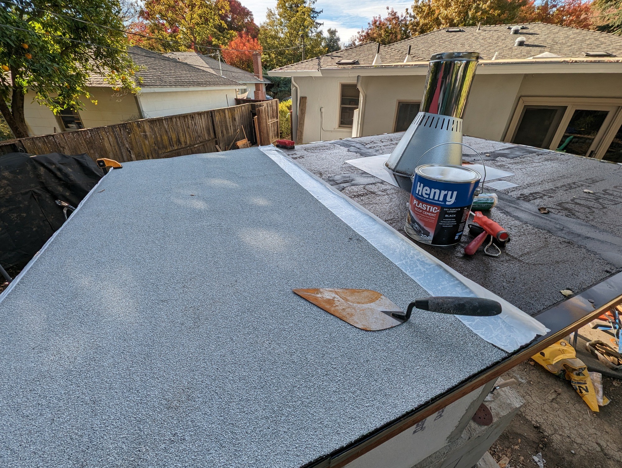

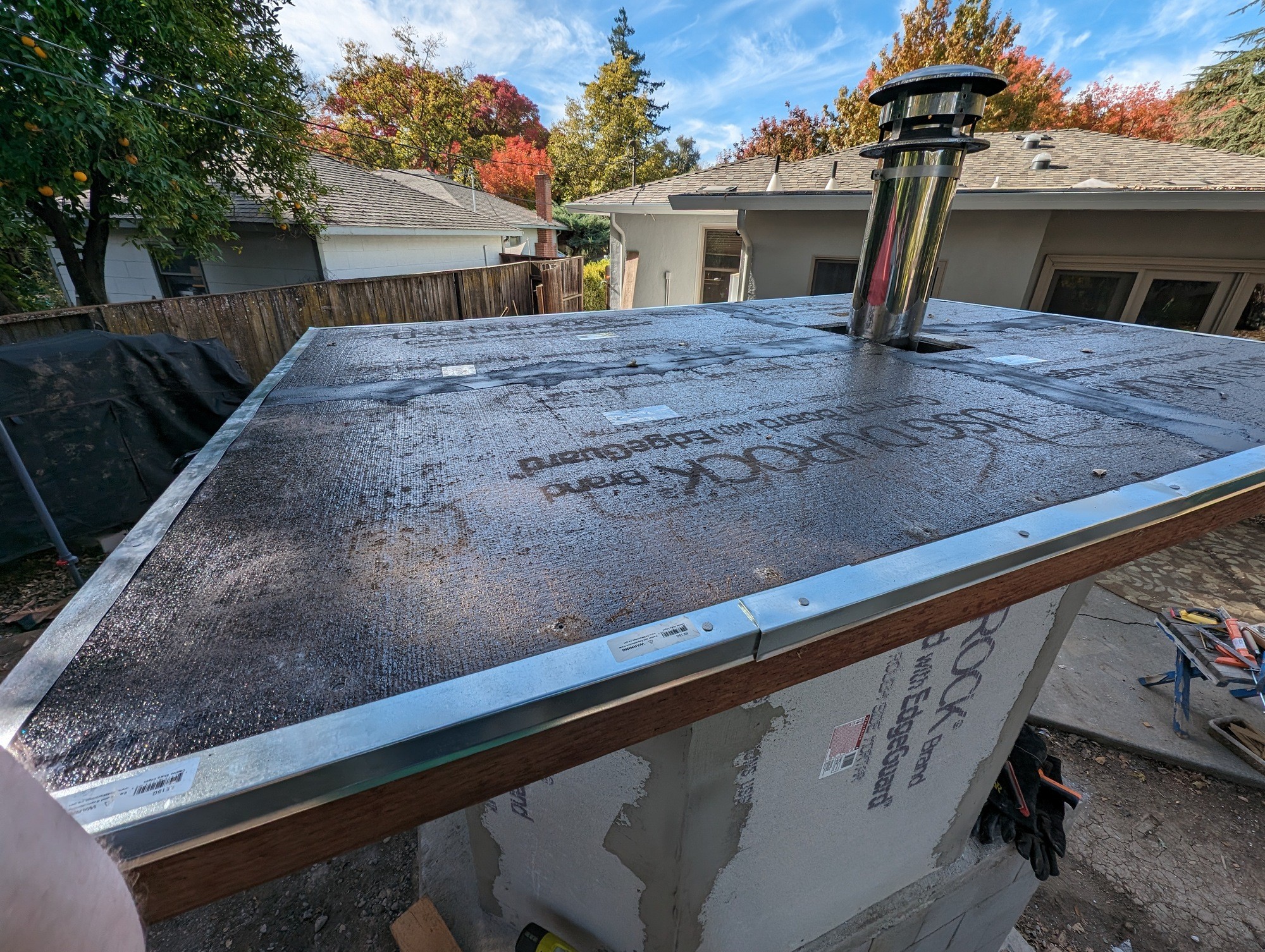

                            Got my enclosure walled and roofed over the last couple weeks. Putting cement board on 20ga metal studs is a pain in the neck, let me tell you; even with special self-drilling cement board screws, getting the fasteners in without completely destroying the edges of the board was an exercise in frustration. Once I had the boards up and the joints taped with thinset and mesh, I filled the enclosure with a whole bunch of loose perlite.
                            For the roof, I ended up going with a "peel and stick" asphalt rolled roof, and did it myself. I had two roofers out; one wanted $1100 for the job, the other said he didn't know how to do a roof on cement board, but when I suggested the peel and stick approach, said that would work, but he didn't use the stuff. The roof roll and accessories were under $200, so pretty reasonable. Got the roof on just in time for some heavy rain (literally; started pouring about 30 seconds after I pressed the last strip of roofing into place). Seems to be holding up!
                            Also finally (if belatedly) got my permit for the oven approved by the city planning department, ending a 5+ month odyssey. Now I just need the building inspectors to sign off (my town takes permitting seriously to an unbelievable degree). Got the roof framing signed off before the roof went on, so theoretically I should be able to get a final inspection soon.

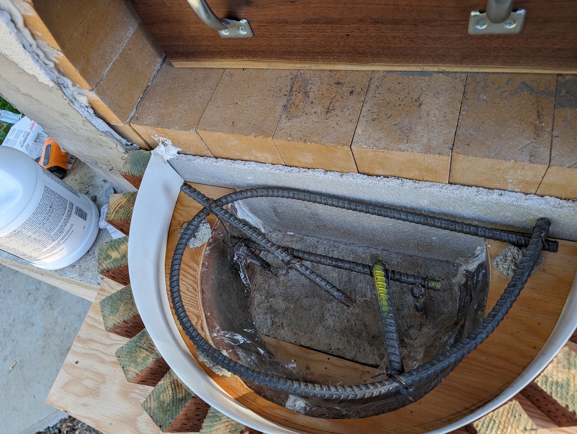

                            Going to try to get the raised platform for the landing counter poured this week, so that exposed rebar will finally be enclosed, but after that I figure to be done for the year; counters and exterior finish can wait for the spring.

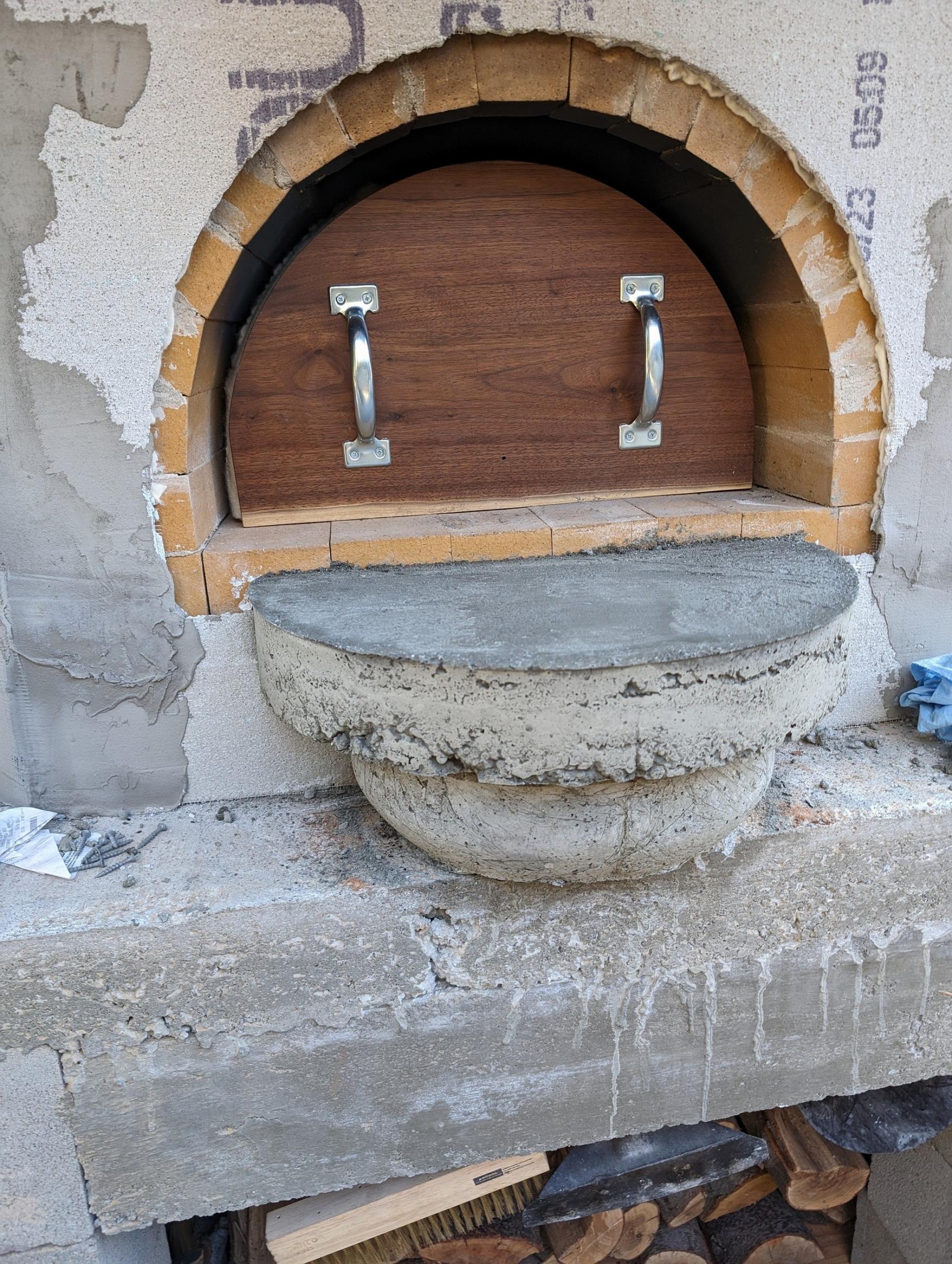

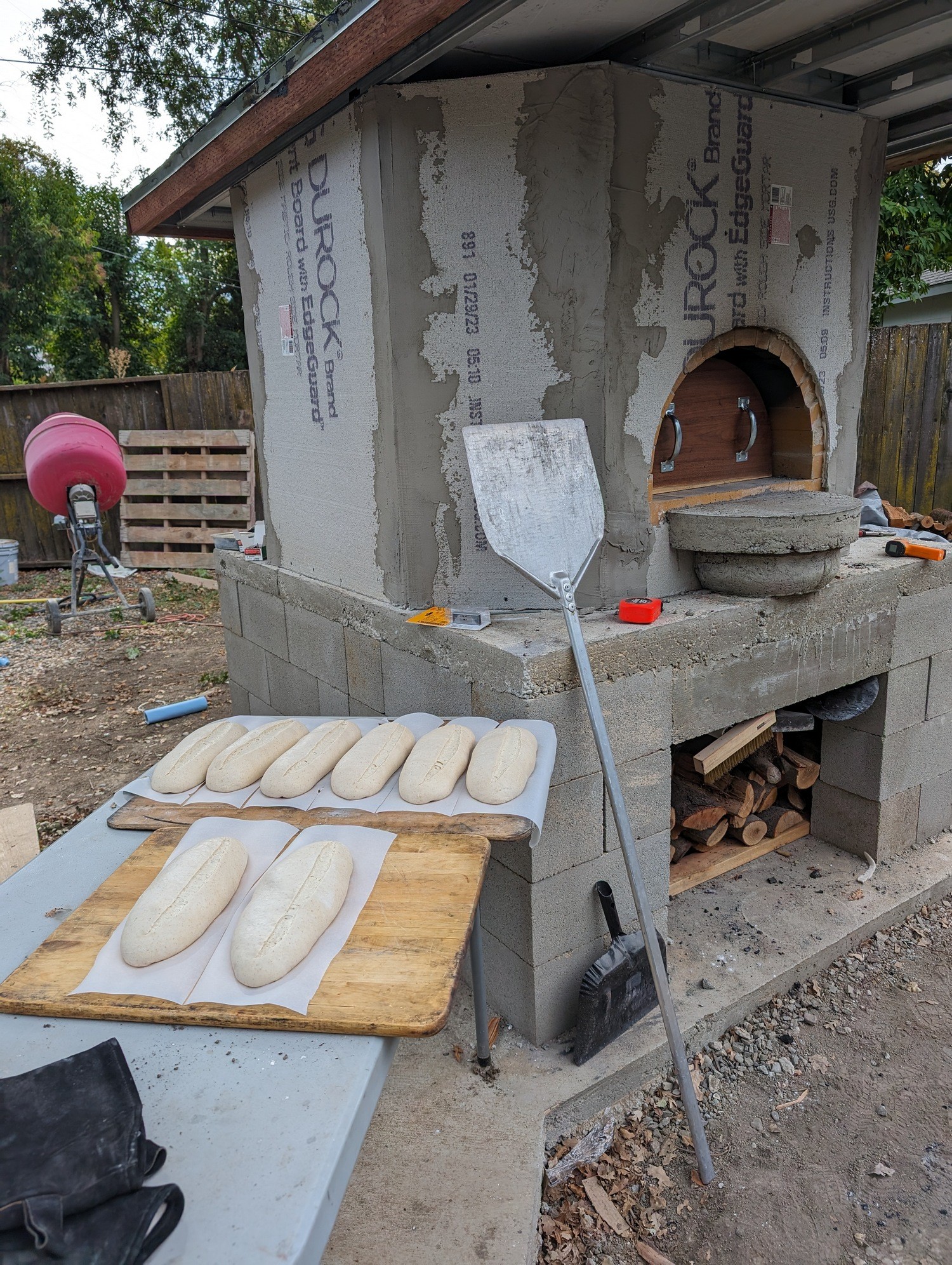

                              Formed and poured my landing platform this week, using a mix of materials to get the shape I wanted. Came out reasonably nice, though I wasn't quite as attentive in getting rid of voids as I could have been; partly a consequence of needing to mix more concrete after a single 60lb bag almost but not quite filled the form. I'll fill the voids with some mortar, I think. Longer term I'm thinking small glass mosaic tiles would look nice, so the surface just needs to be smooth, not pretty.

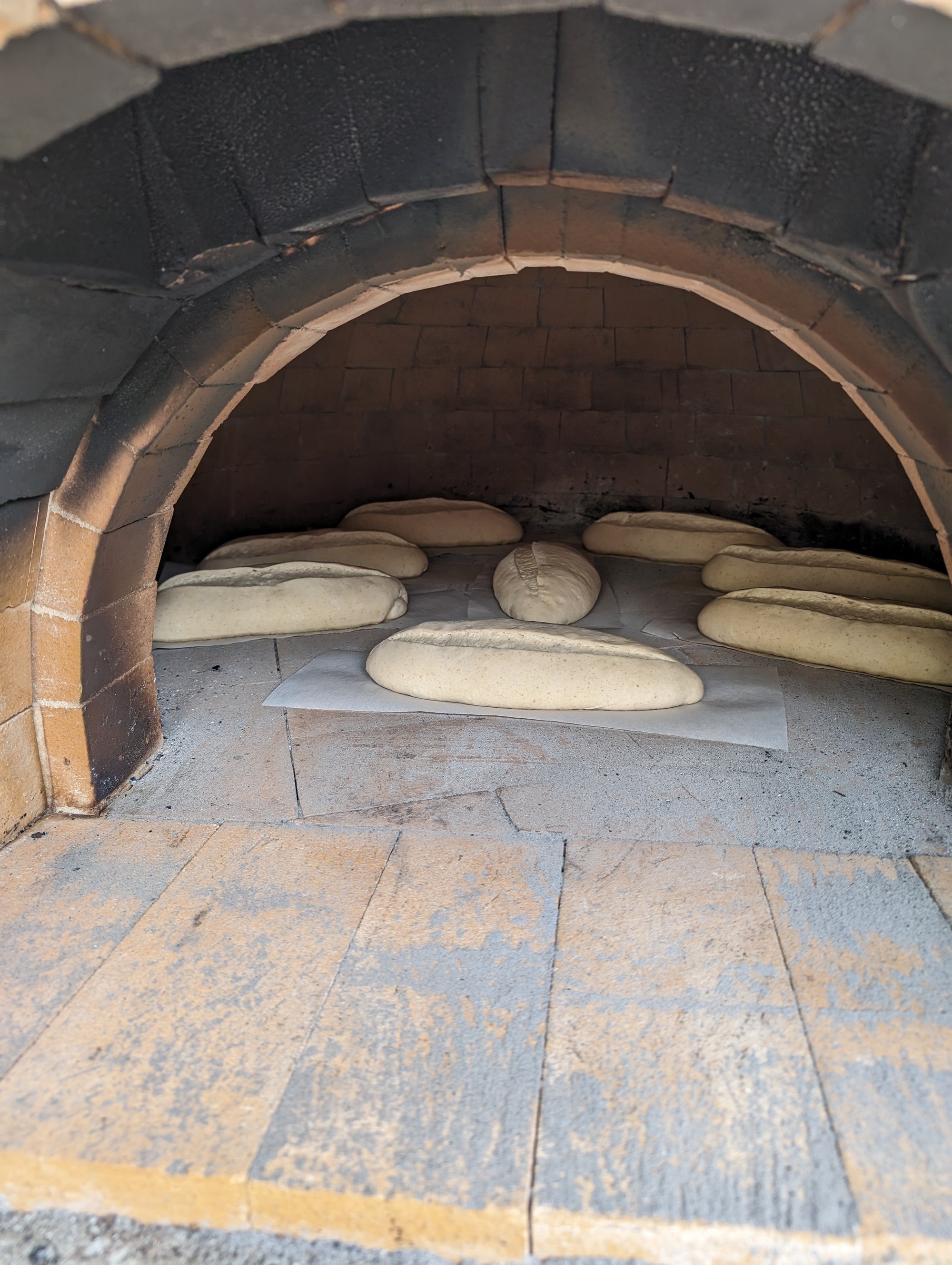

                              Heat retention continues to be pretty marvelous. Made pizza again on Sunday, and since I planned to make bread, I added two additions of wood (three logs total) after finishing with pizzas. This morning the oven was over 550F inside. Had to leave the door open for a half hour to get the temps down to around 500F, so I could bake a batch of sourdough without scorching the bottoms. Next time I'll add a bit less fire, or plan a batch of baguettes to take the sting out of the floor before loading larger loaves.
