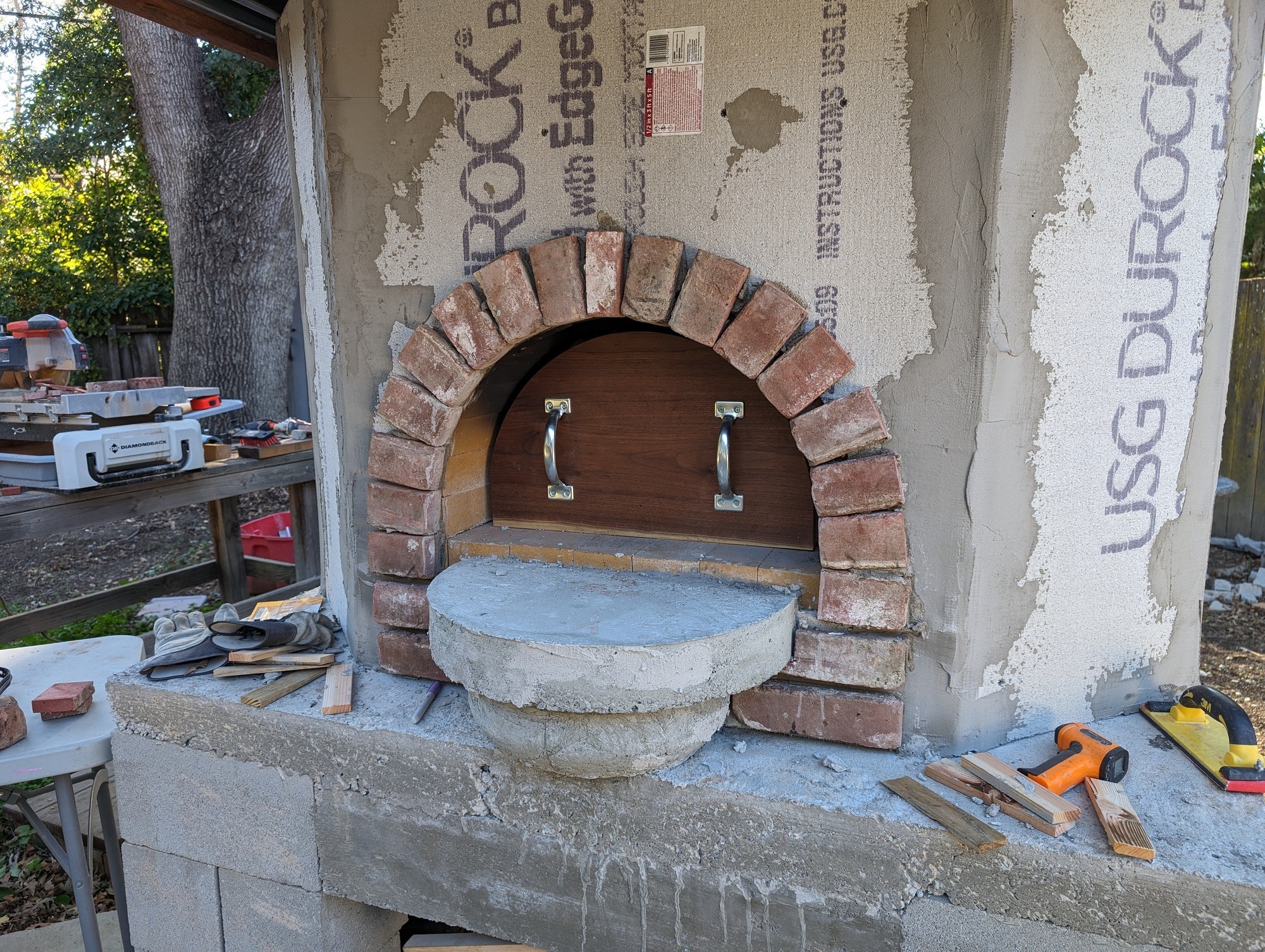

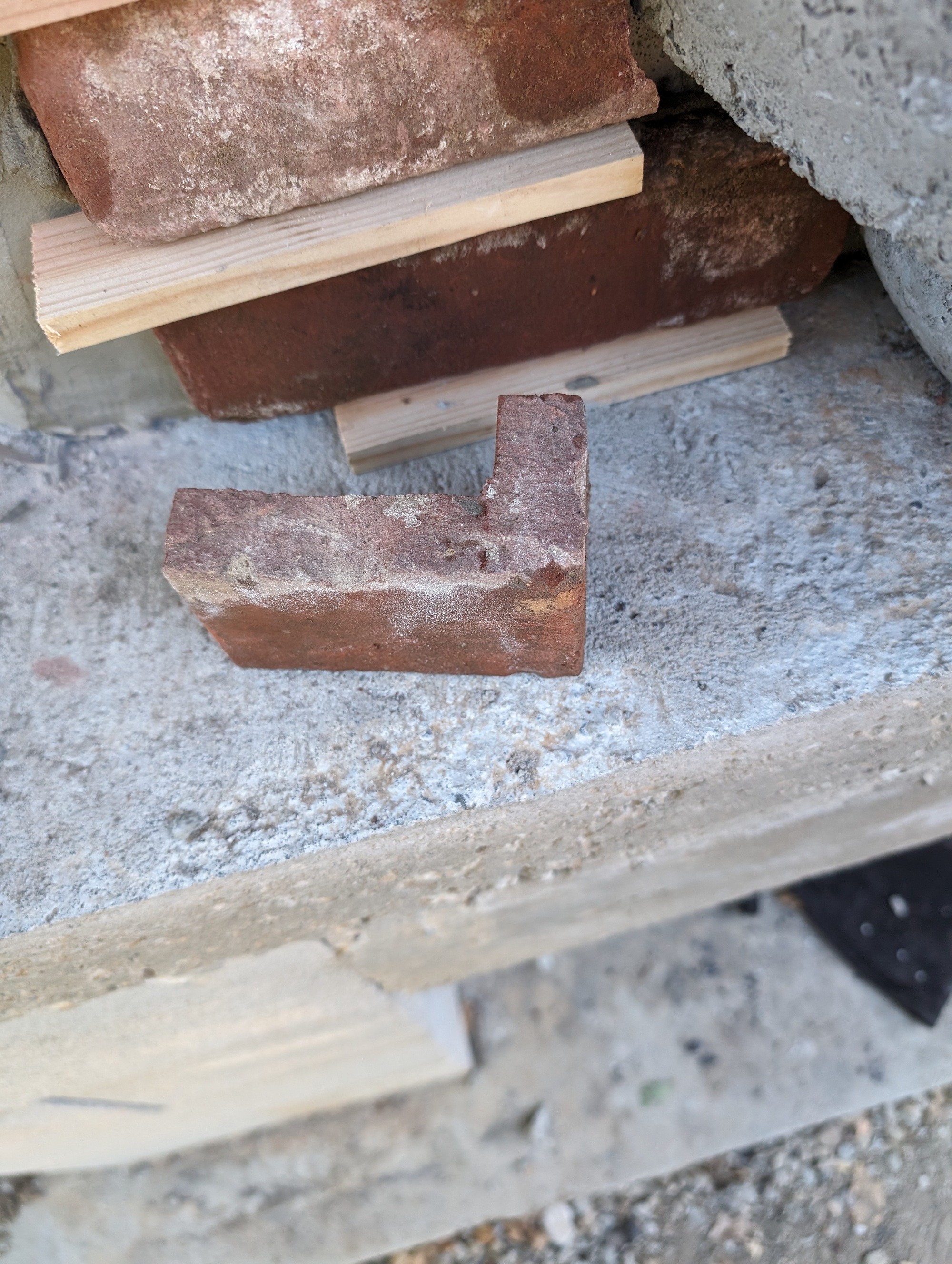

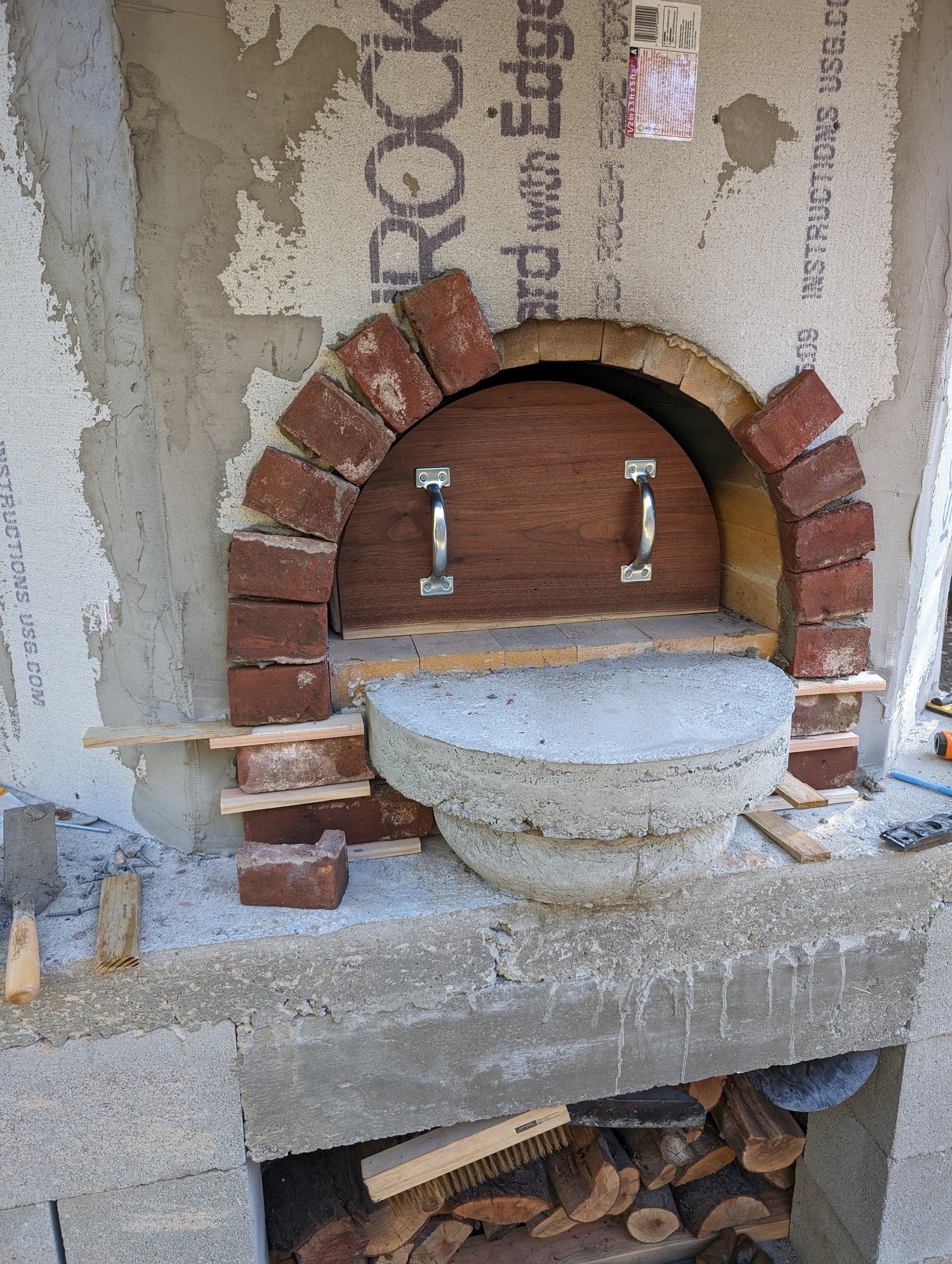

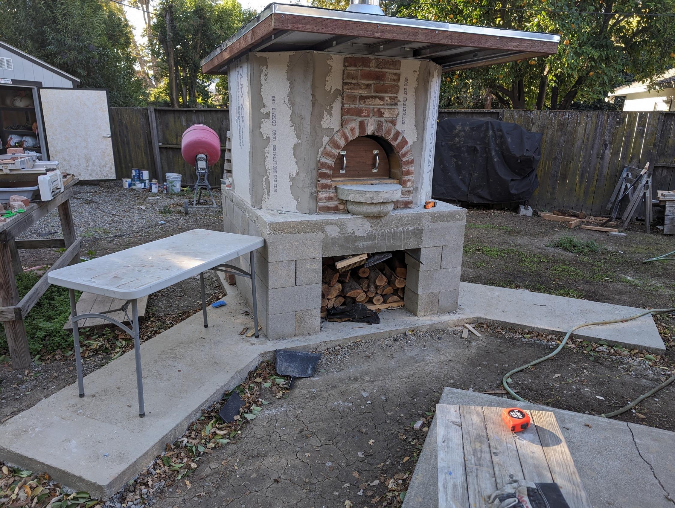

      Started my decorative arch yesterday. Made L-shaped thin bricks so as to bond to both the firebrick vent arch and the cement board exterior wall. The bricks are from a big stack of old clinker bricks left to us by the previous owner of the house. Apparently all reclaimed from a 100+ year old hotel demolished in nearby Sacramento. I had been thinking of doing similar brick veneer for the base and counter walls (plan for the rest of the enclosure walls is stucco/render), but realized that while "no extra money cost" is a nice feature of that idea, "making ~900 brick cuts" is a bit of a drawback :-P. Now thinking of shelling out for natural or cultured stone veneer from the nearby brick yard.
      But anyway, the clinkers make a nice decorative arch, and I think I'm going to continue upward with the bricks to the roofline, as if the whole "chimney" were protruding from the wall.
      In other oven news, I got the final sign-off from the city building inspector, so my oven is now fully legal and permitted.

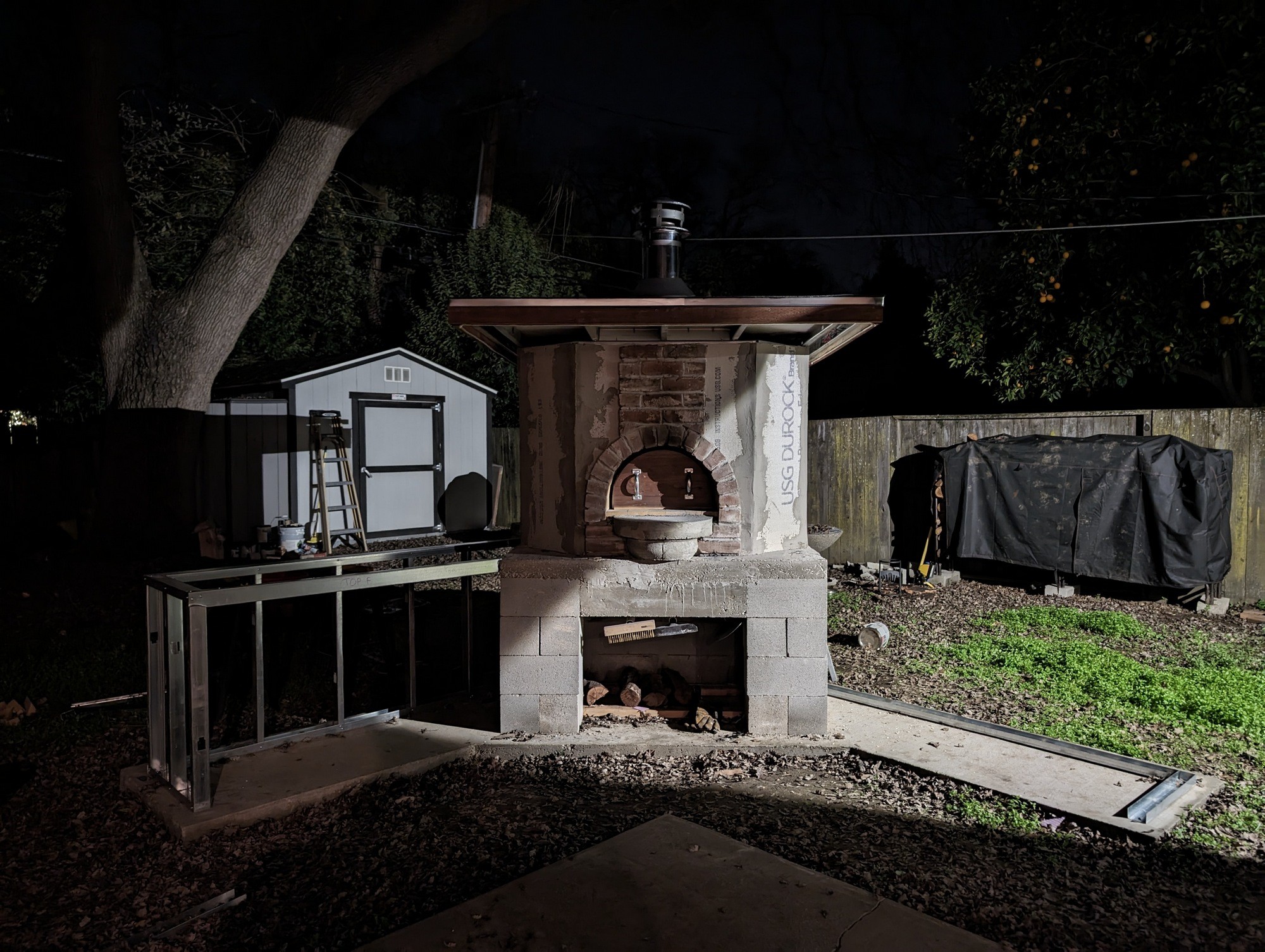

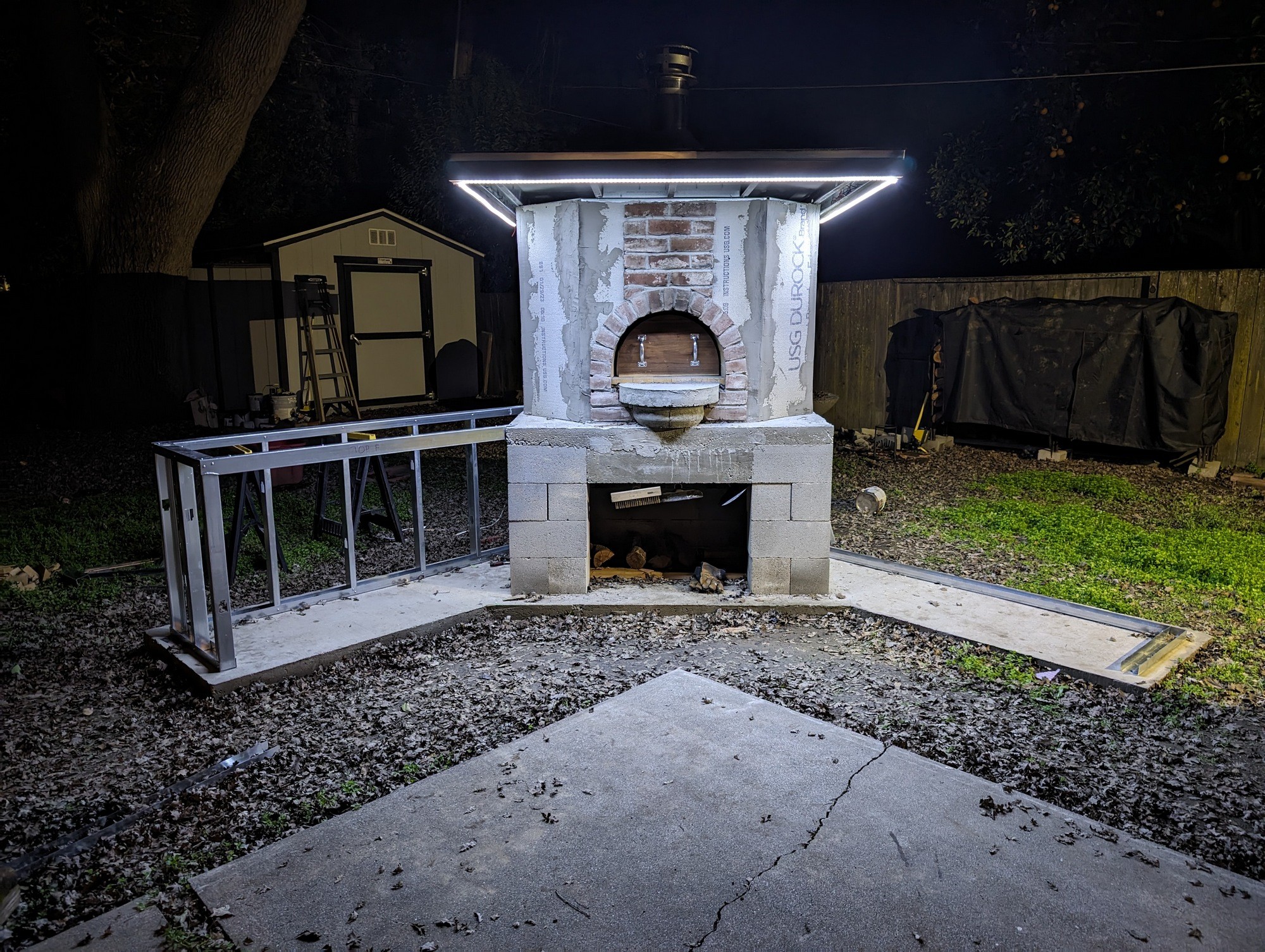

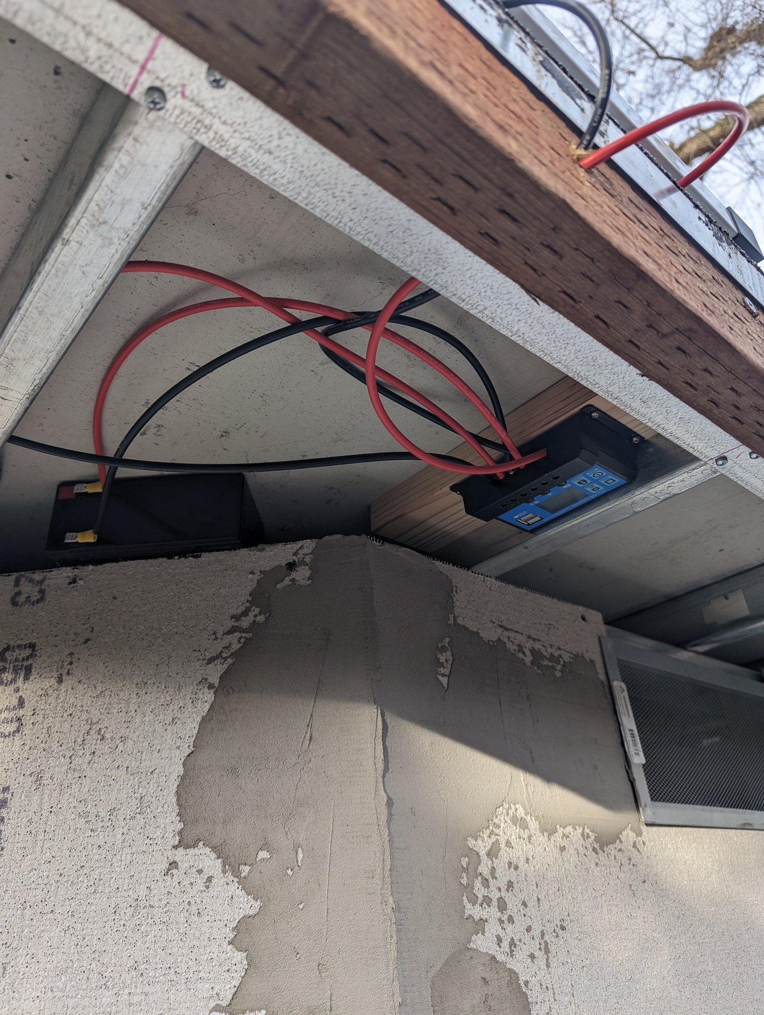

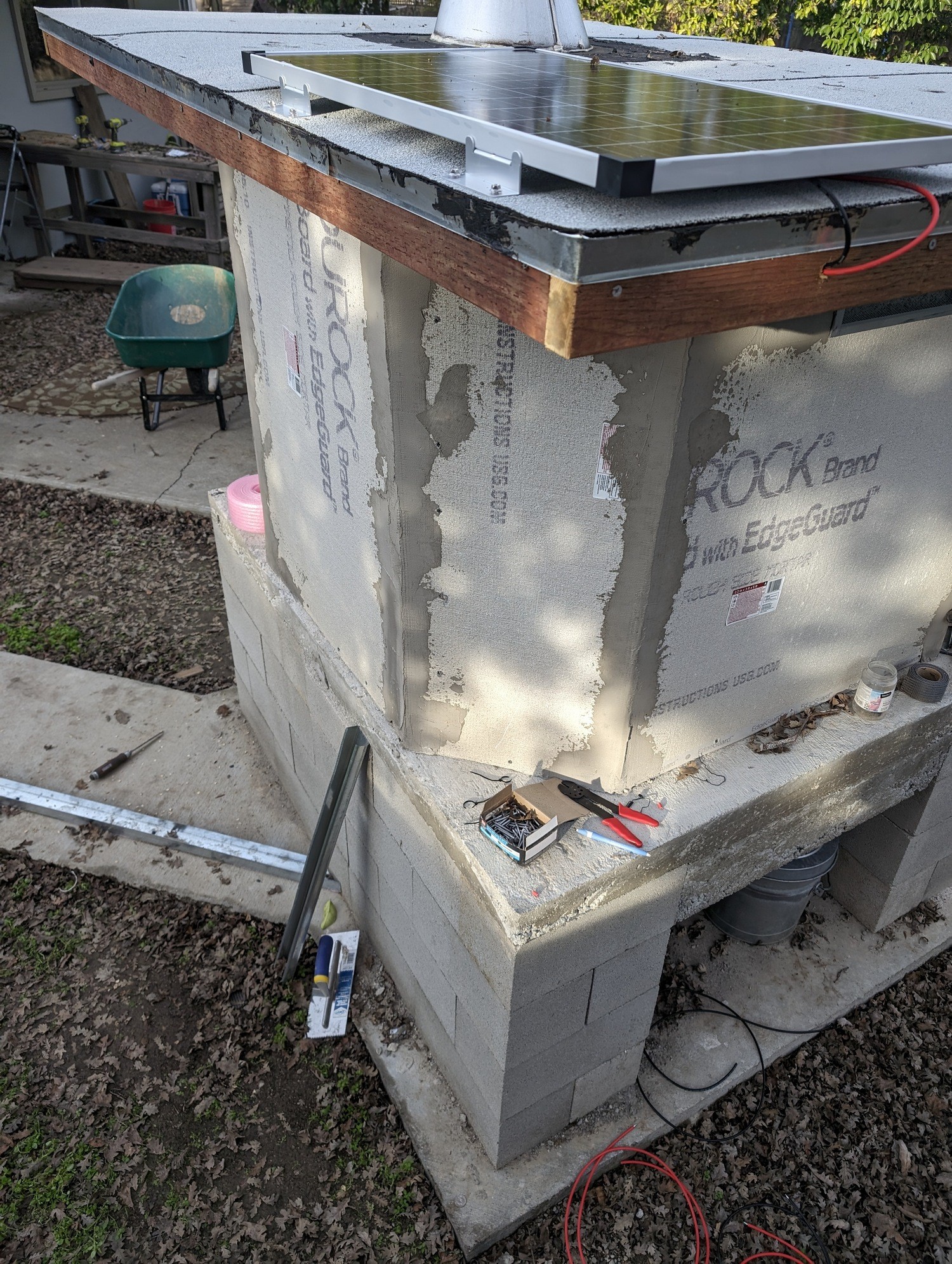

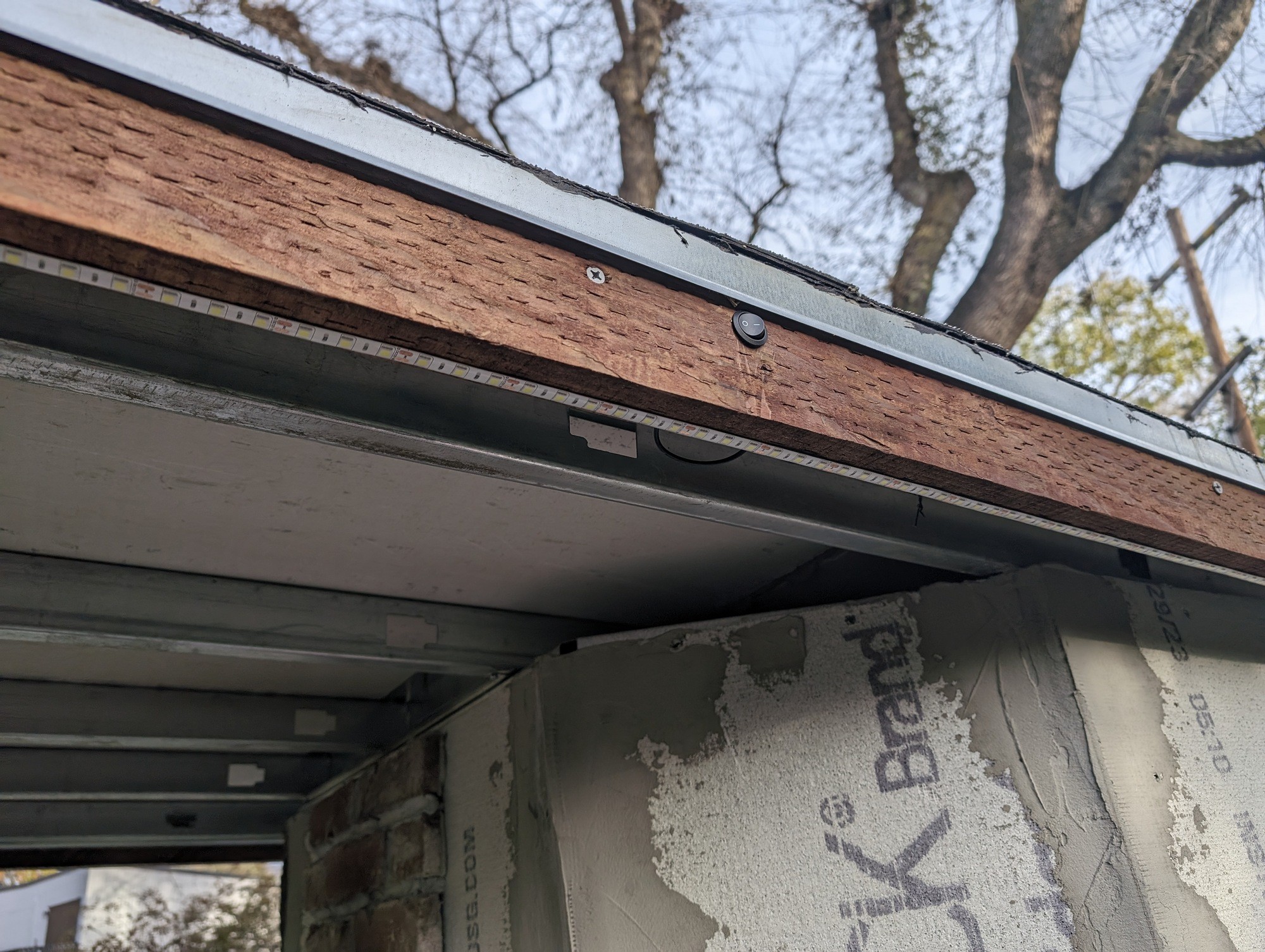

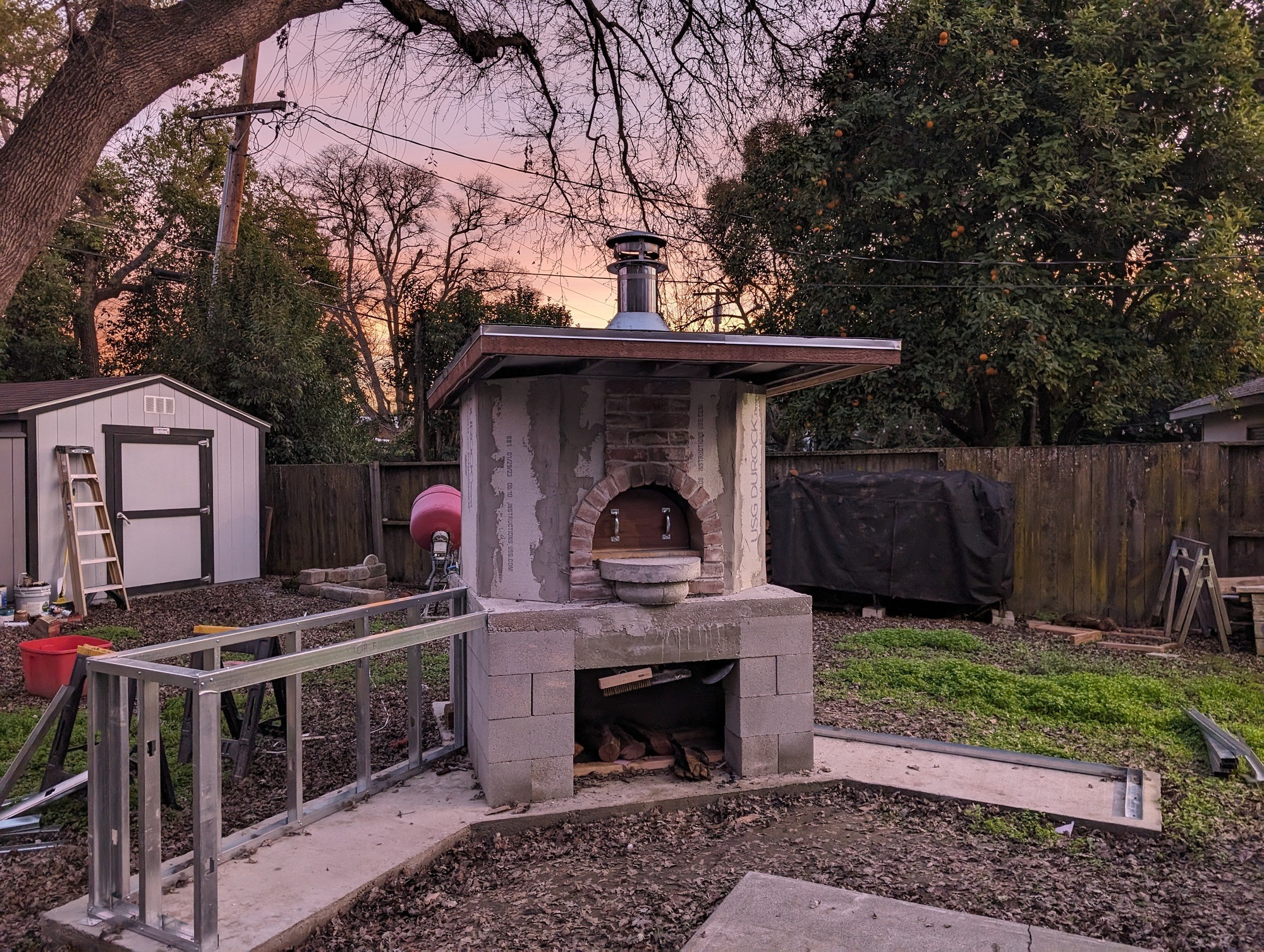

            Had a bit of good weather in the last week, so I started on my counter frames. Bigger advance is I added lights. This time of year, making pizza in the dark is a pain; the light of the fire isn't quite enough to see what I'm doing. So, I set up a 100W solar panel on the roof, wired to a controller and a 12V battery that sits inside the enclosure frame. A cheap DC rocker switch and a string of LED strip lights, and I go from this (except darker--my Pixel 8 is way too good at taking pictures in the dark):
            To this:
            Looking forward to next week's pizza bake! A few more pics of my lighting setup, plus the sunset was pretty behind the oven as I wrapped up today.

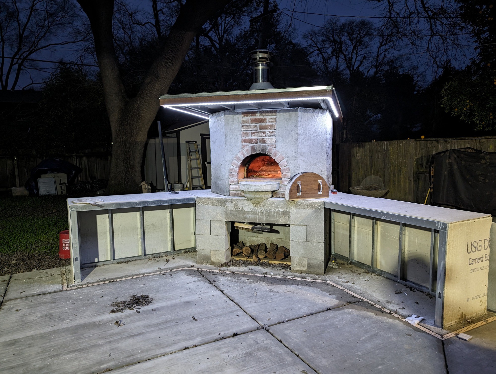

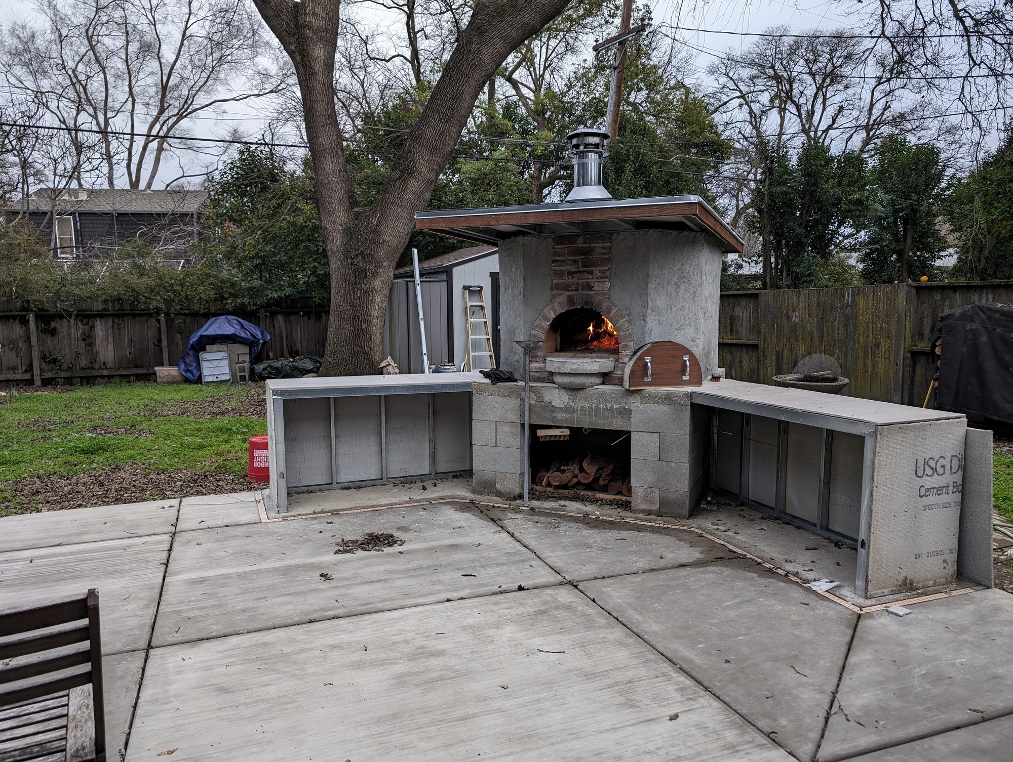

              Have had some additional spells of nice weather, punctuated by some really torrential rain. During the former, I finished building my counter wings, and also got a base coat of stucco/render on the enclosure. Also, we paid a contractor to redo and expand our (pretty sketchy) existing concrete patio so that it's both (a) flat and (b) extends all the way to the oven foundation. Between the counters, the lights, and a good place to stand, last weekend's pizza bake was just dreamy :-).
              May get some more work done in the next couple weeks during breaks in the weather, particularly taping and mudding the joints in the cement board. However, we need to make some aesthetic decisions before going much further. As I see it, the color coat of stucco should go on before the veneer on the base, and the veneer before the countertop material. But the veneer and the stucco need to match each other, and especially match the counters. So, need to pick a type of veneer and counter before going any further, then find a color pack to match those...decisions, decisions.
              Not sure if it'll happen, but the ideal would be to get counters installed in time to do a pizza party some time in the spring. We'll see!

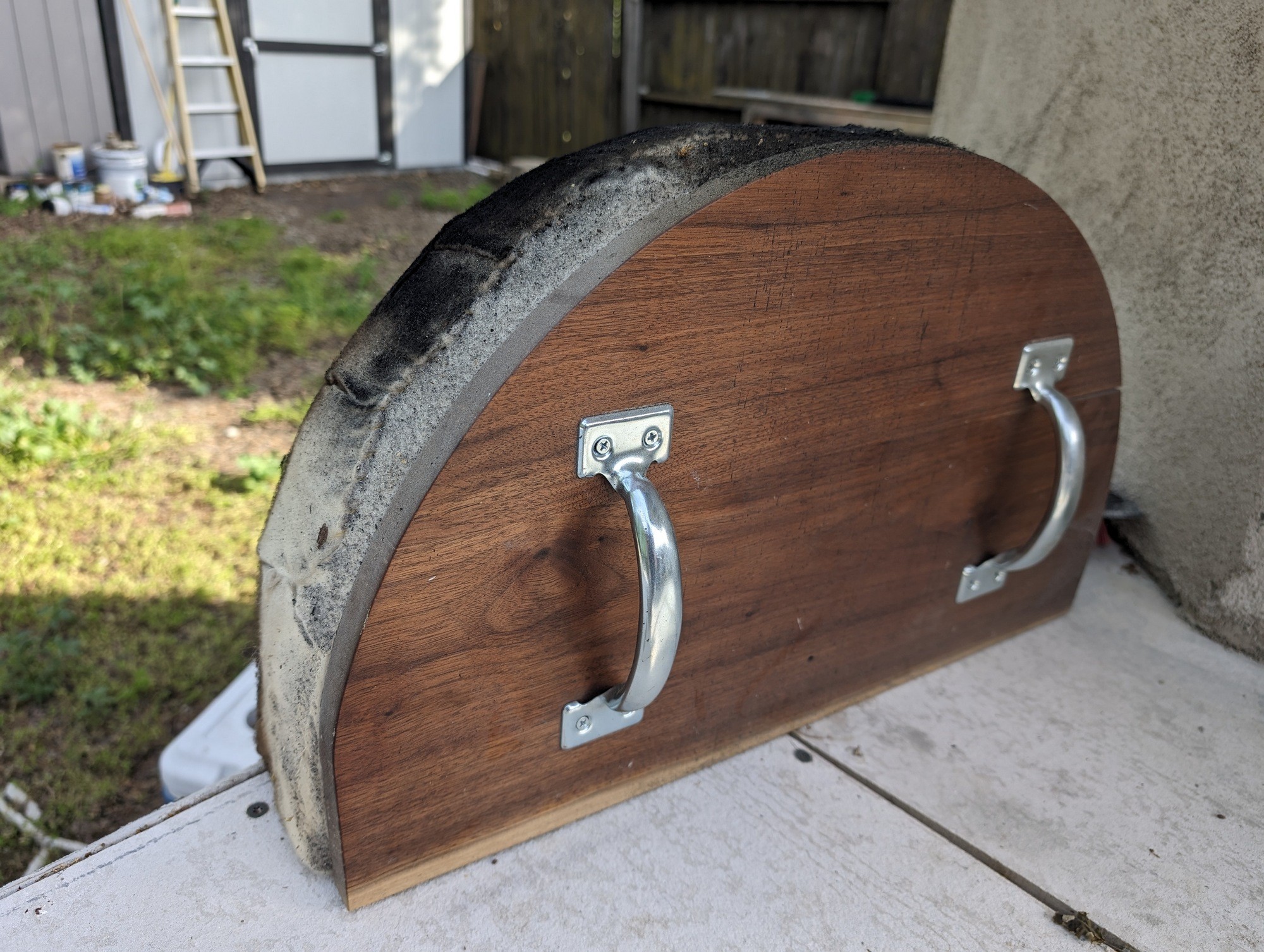

                  Hey AJH . Door is holding up very well--still seems firm and holding together, and generally keeping heat in very well. Only blip is that my outer wood fascia has cracked a bit at the glue line on the right side. My thinking is that it's less a failure of the wood or the glue, but rather due to the placement of the metal handles. I think after a very hot fire the metal expanded faster than the wood, and pulled the glue joint apart. In hindsight, having the handles span the glue joint was a mistake. Ah well--still works, still looks reasonably nice.

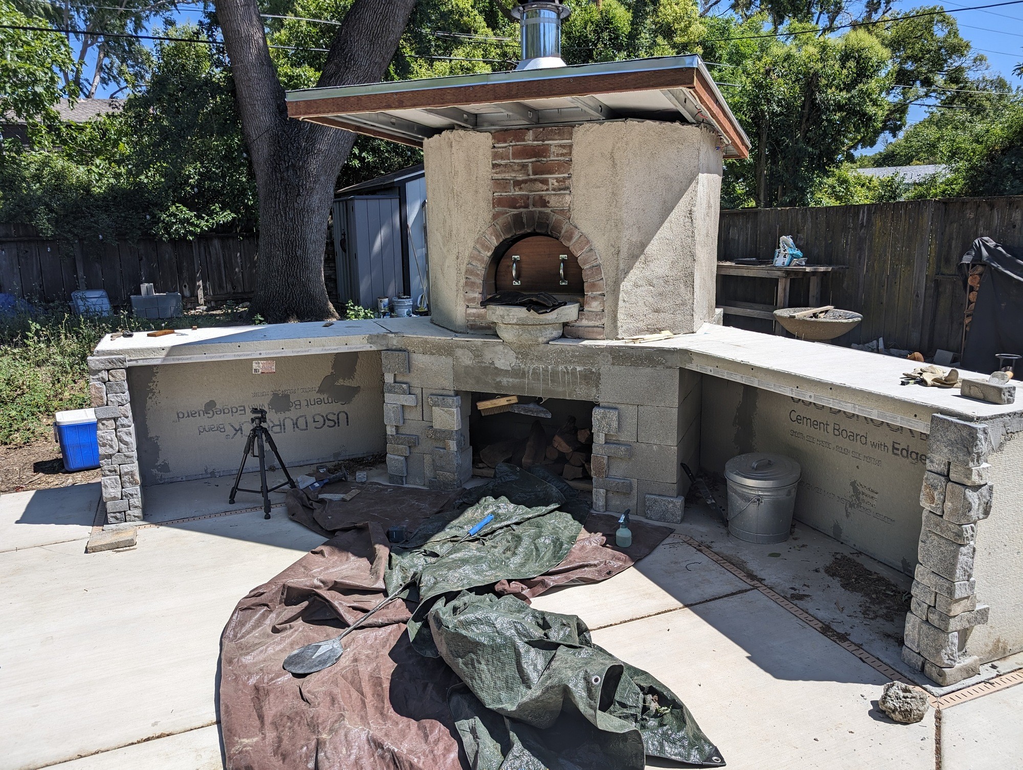

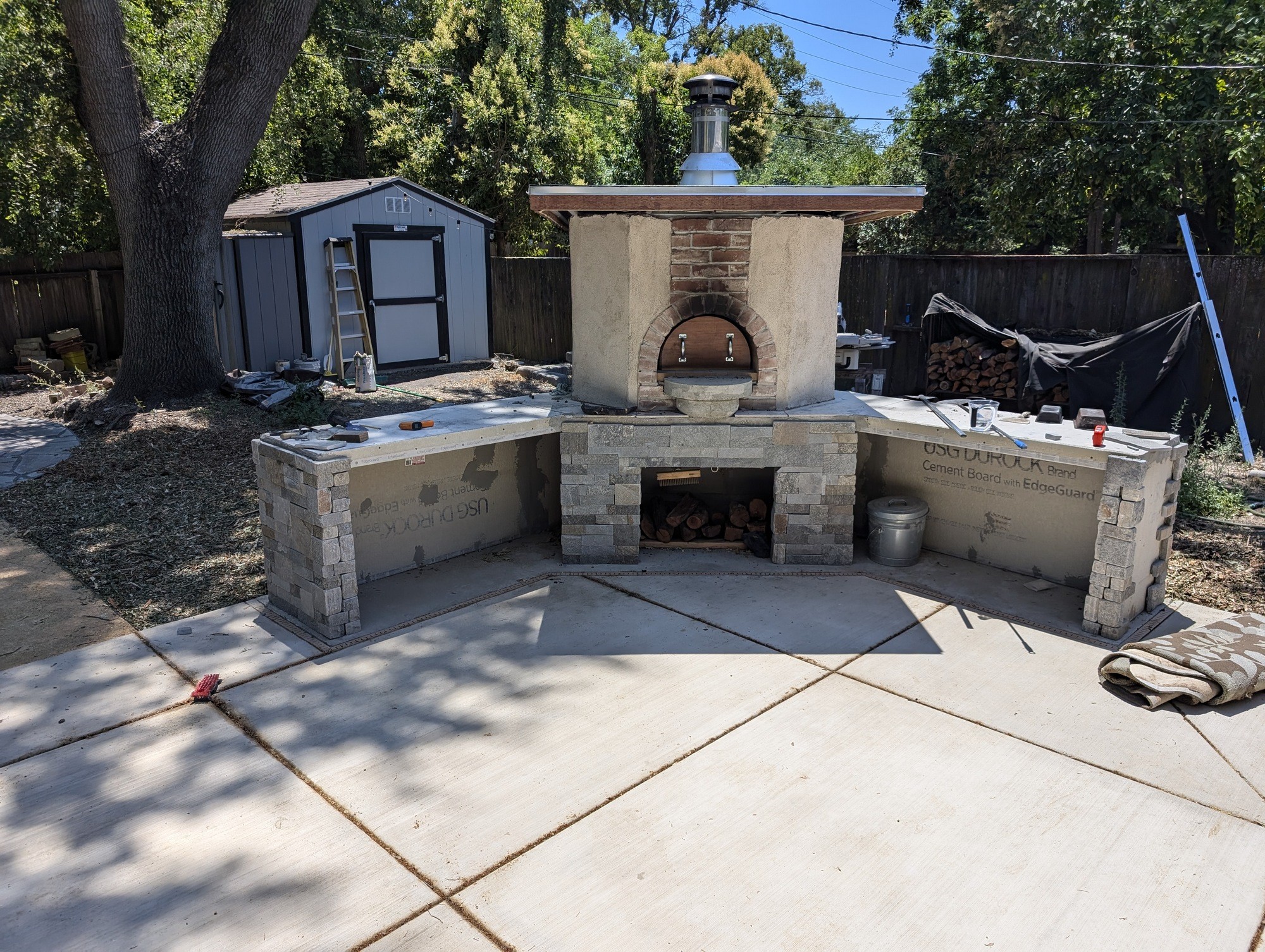

                    Little bit of progress on the aesthetic bits, but haven't shared pictures in a while. Finished the countertop structures and put stucco on the enclosure a while ago, and this week started stone veneer around the base. Just corner pieces so far, but starting to look promising.

                      Made a bit more progress on the stone veneer over the last few months, though it's been just stupidly hot here in northern CA; well over half the days in July have been over 100F. I've been popping out to my garage woodshop in little bits to work on project there, but it's been too hot to stay out for the 1-2 hours necessary to make use of a reasonable batch of thinset. But it finally cooled off the last couple days, so I made some progress. This picture is a bit old--I've since finished the short end on the right side, as well as maybe half to two thirds of the back since it was taken.

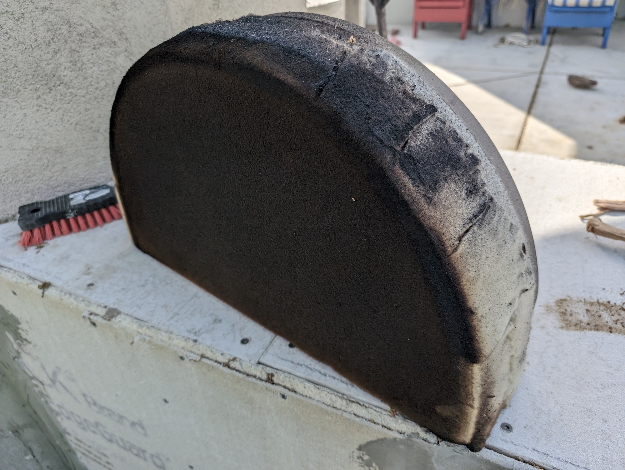

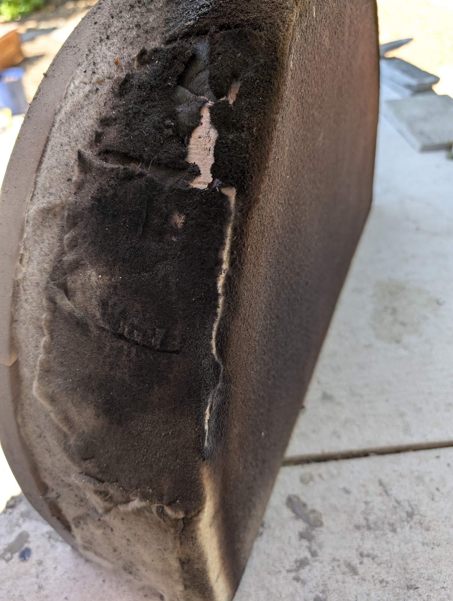

                      In other news, my Nomex door coating has not held up after all. Mostly it's fine, but along the edges where it's folder, it has deteriorated and started to tear. I ordered some carbon felt welding blanket as an alternative, and have pinned it to the outside (with the pins through the nomex closest to the wood, where the heat has been less. The welding blanket has more "squishiness" to it than the nomex, so I'm hoping it makes a slightly better seal as well.

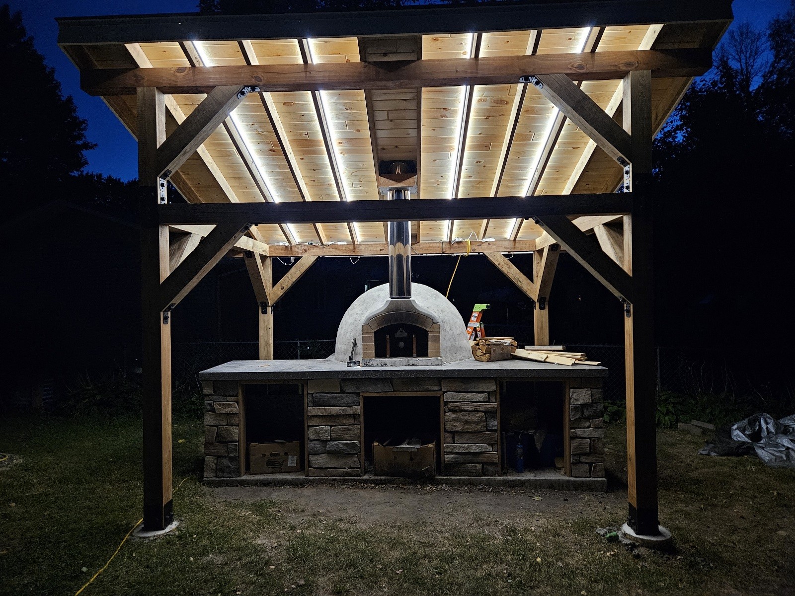

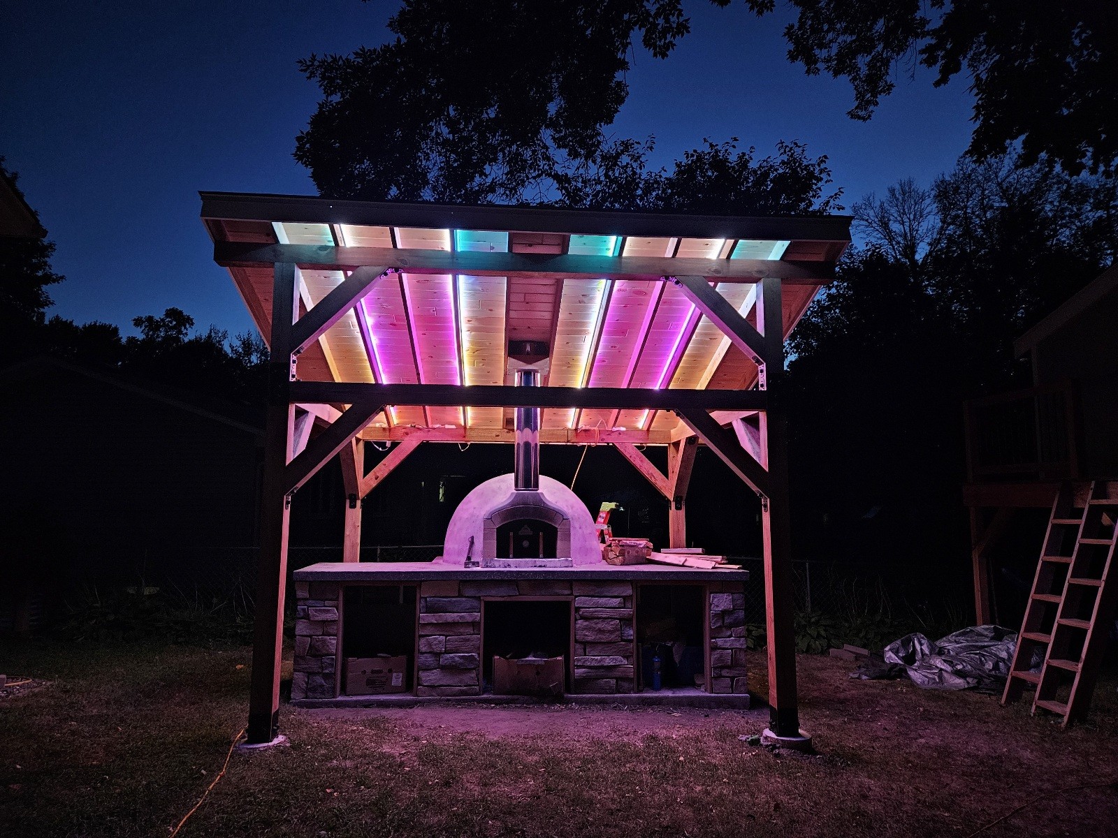

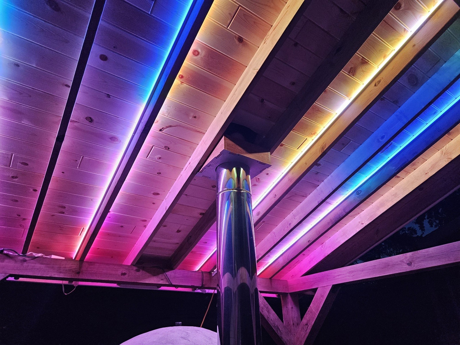

                        Hey rsandler have you been able to get any more done on your oven? I have once again been forging ahead with my oven. I am hoping to get everything water resistant before it freezes. As it is I just managed to get my roof more or less done. I need more chimney but it is on order. I also just finished my lighting. You were the inspiration for what I did. I may have gotten a bit carried away but that is what these projects are for. I ended up using 28M or almost 92' of govee M1 led strip and diffuser Chanel. The lighting effects are incredibly vivid and white light is completely capable of allowing you to read.
                        Randy
