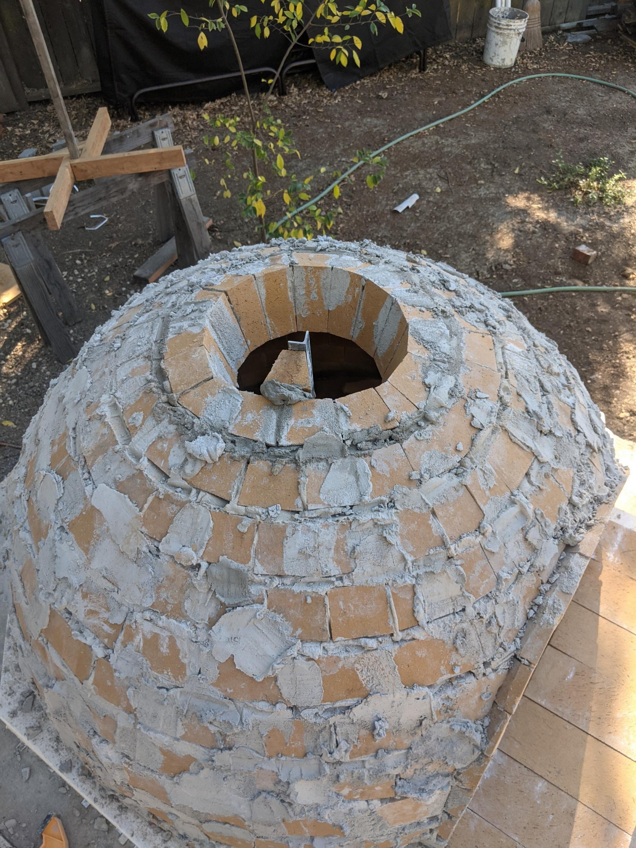

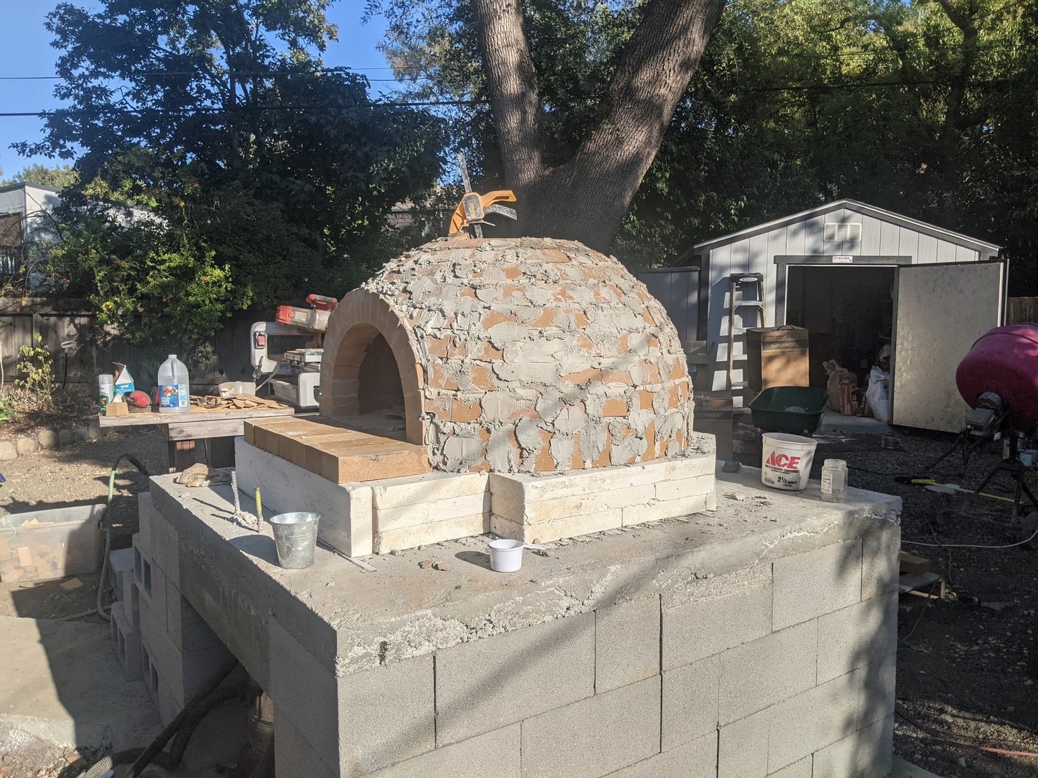

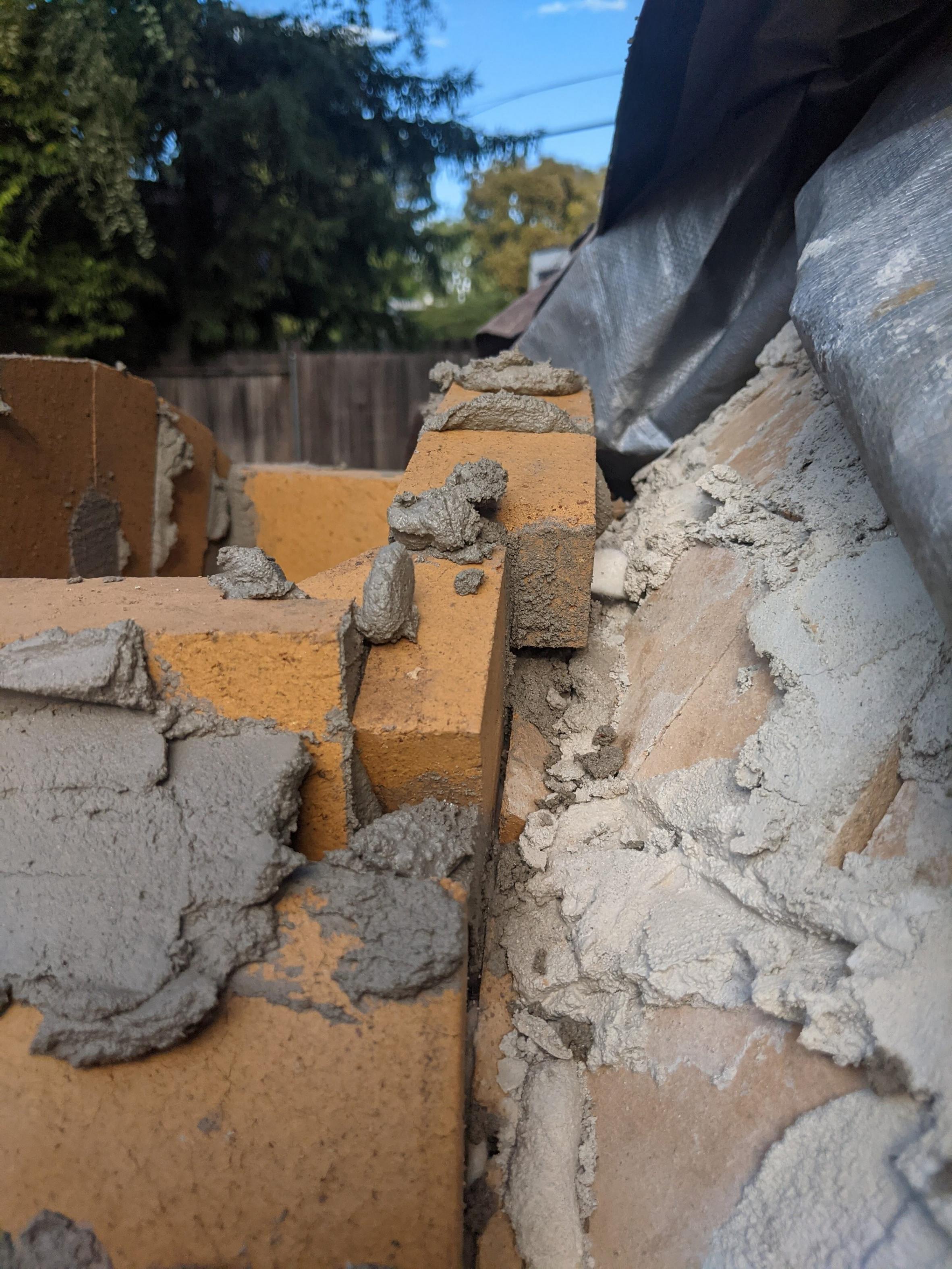

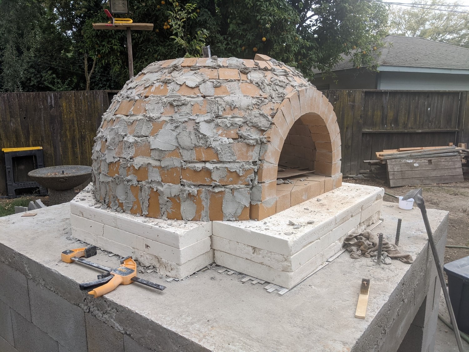

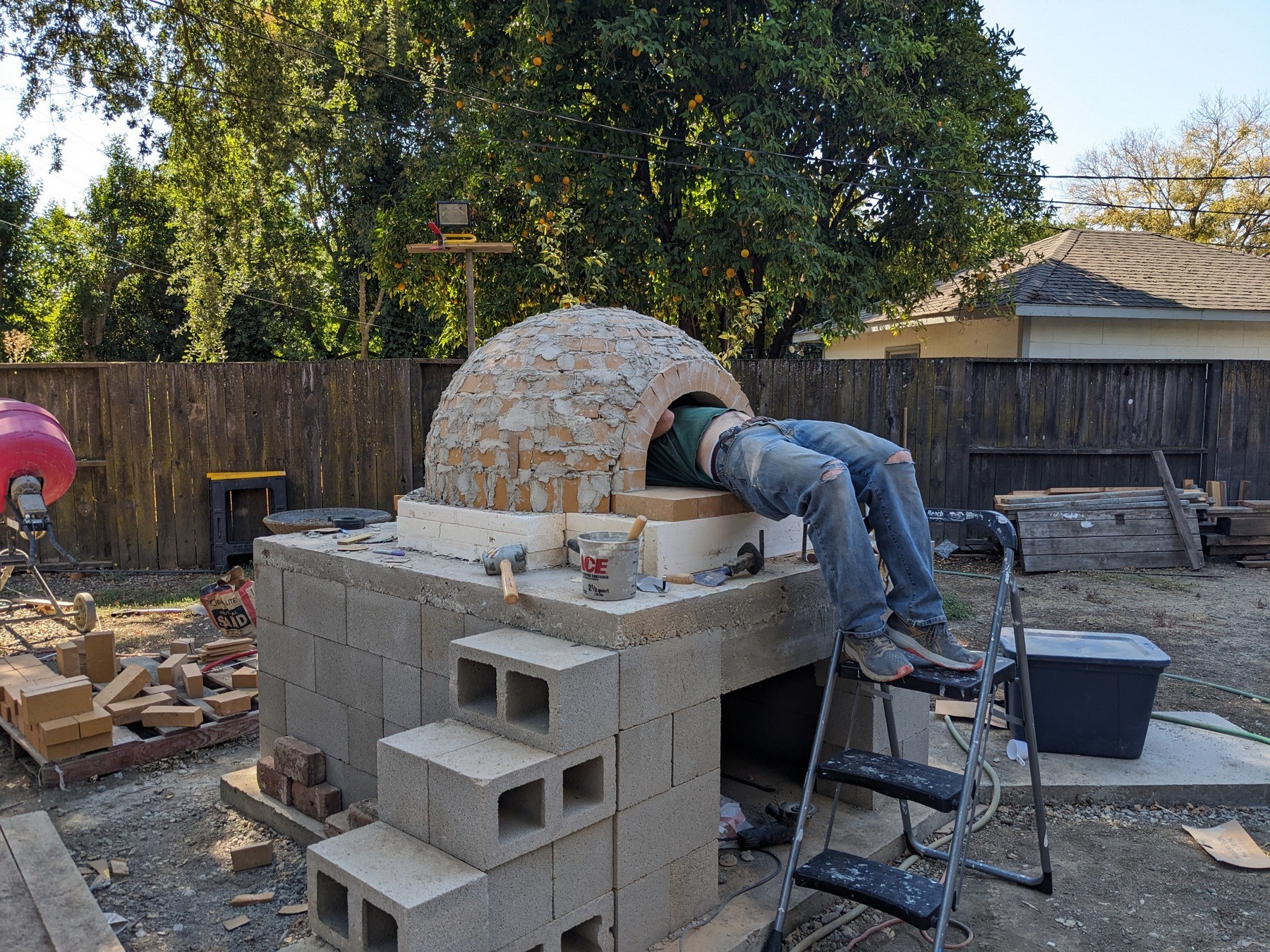

    Finished course 7 during the week, and 8 today. Getting really close here, though going slower and slower. Probably jinxing myself by writing this, but so far have only had one brick fall, when I tried putting a second brick on a course (6, I think) without leaving the first brick overnight and knocked both loose. Dome calculator says it should take 10, then a plug

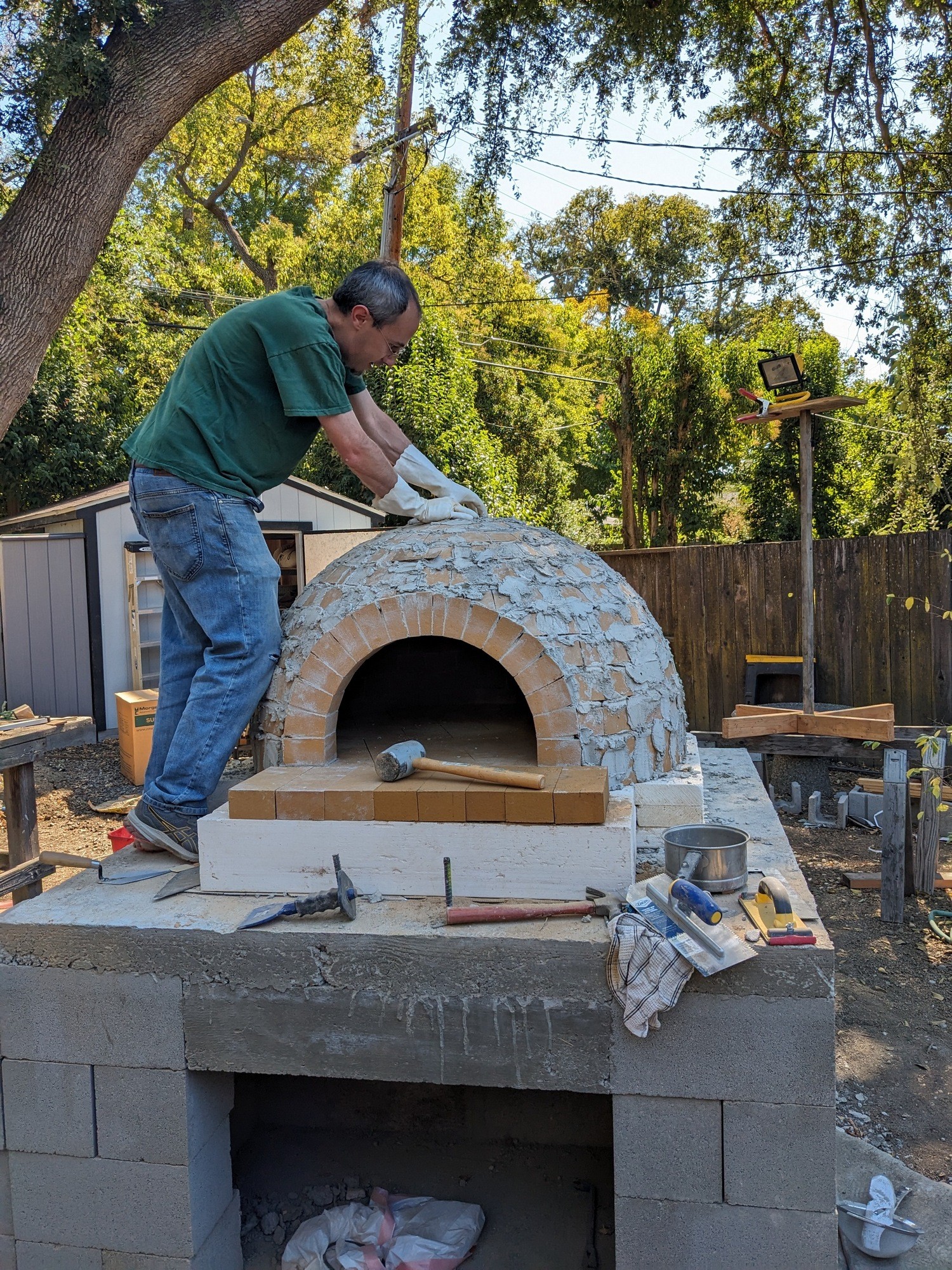

    Starting to get my entry set up in between bricks, so as to wait for the mortar to set up a bit. Because of the unevenness of the edges of the bricks, having a bit of trouble getting reasonable seams in the floor, so resorted to ripping the edges straight with the brick saw.

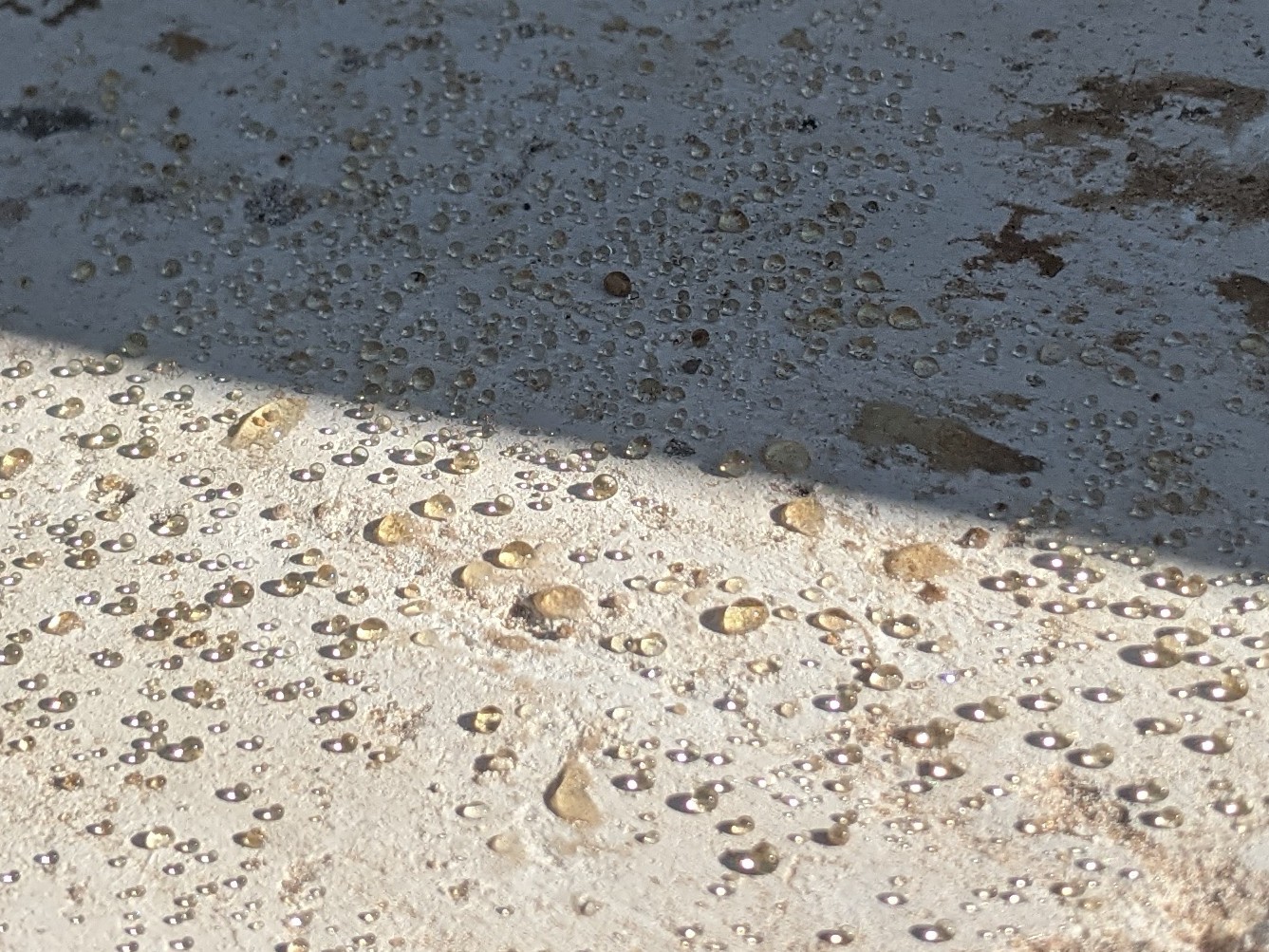

        Got about half of course 9 done this afternoon before needing to quit to make dinner. Onr interesting thing--the newer Thermo1200 CalSil boards are supposedly water resistant. I can now really verify that. Yesterday I test-placed some bricks for my entry floor, which had been soaked in order to rip the edges straight. Today I picked them back up to work on leveling a bit with sand/clay mixture, and found that there were perfect, brick dust-infused droplets of water just sitting there on the CalSil where they'd seeped from the bricks. Pretty wild!

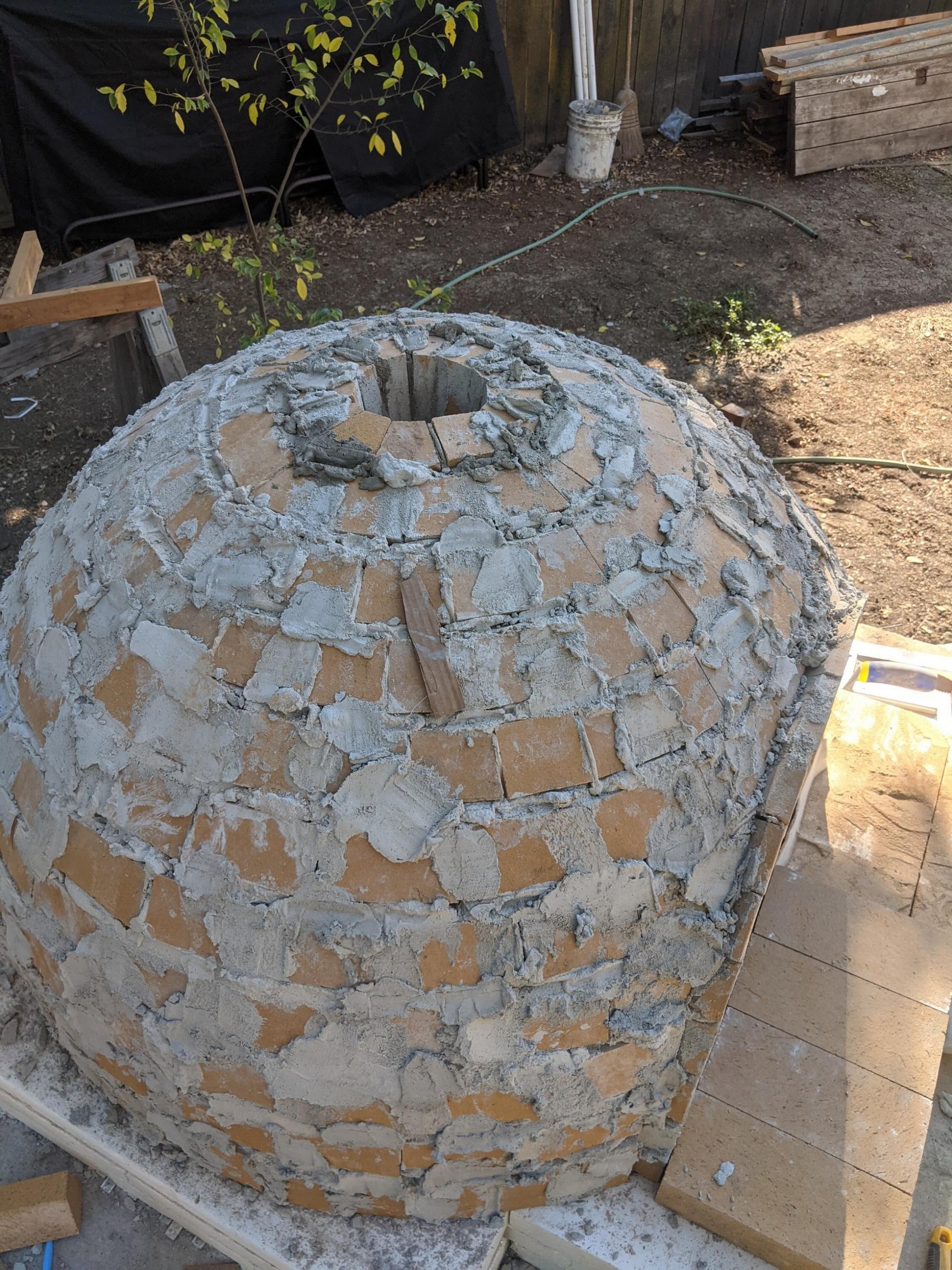

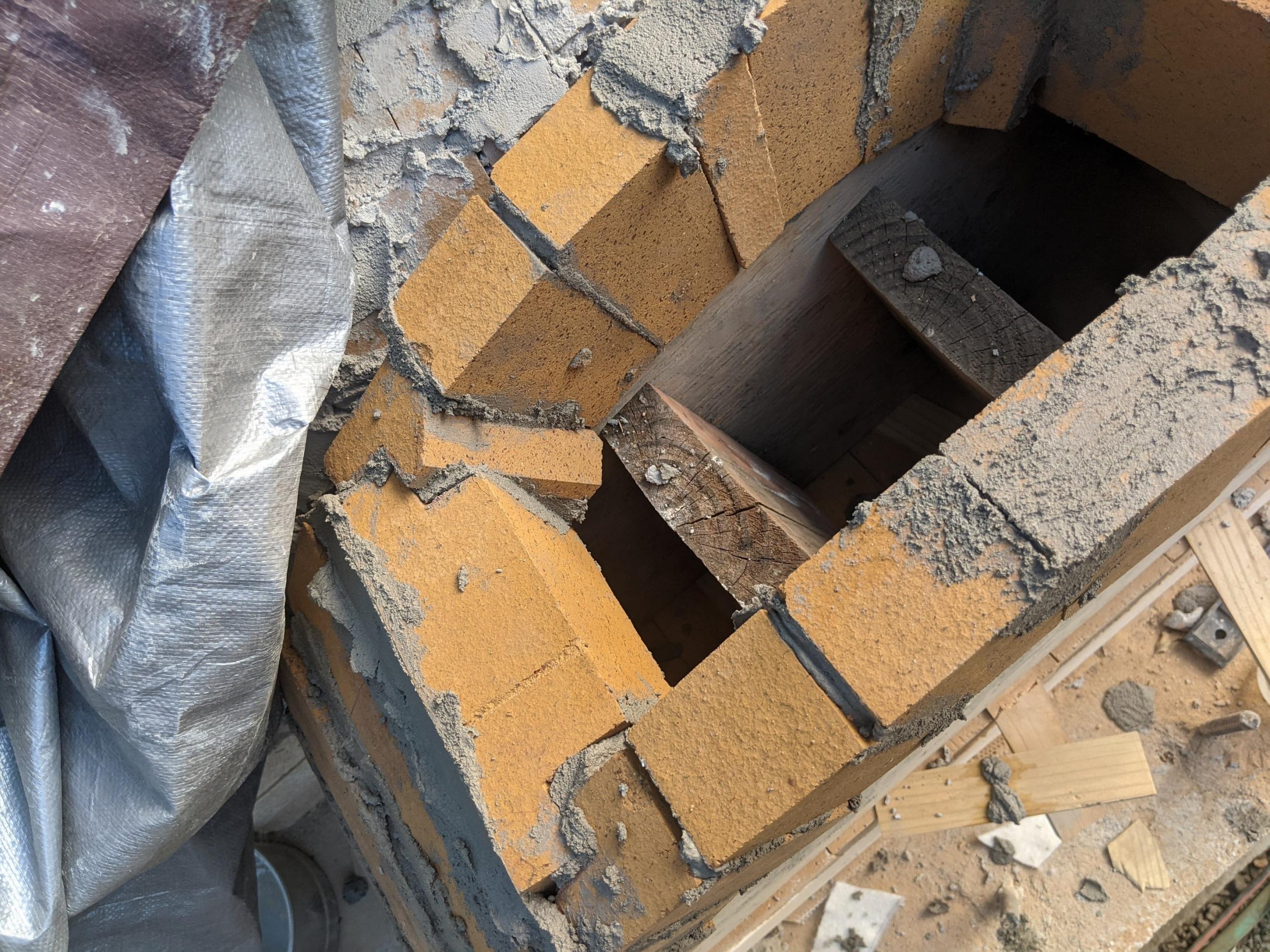

          Finished course 9 yesterday. Course 10 is looking to be a bear though. Tried putting a started brick up last night after closing course 9, but managed to knock it loose while trying to clean up mortar from the inside. Thought I managed to get it reset, but the slightest tap on it when I checked in the morning knocked it loose. Reset again this morning, but the mortar joint cracked during the day, and as soon as I removed the IT around 2:30, it fell off. I set it a third time after thoroughly wetting both the starter brick and the course below, and will go again tomorrow. Based on the calculator and my measurements, 10 courses should do it--I'll have a bit over 4" left to span with a plug. Just have to get the durn bricks to stay up!

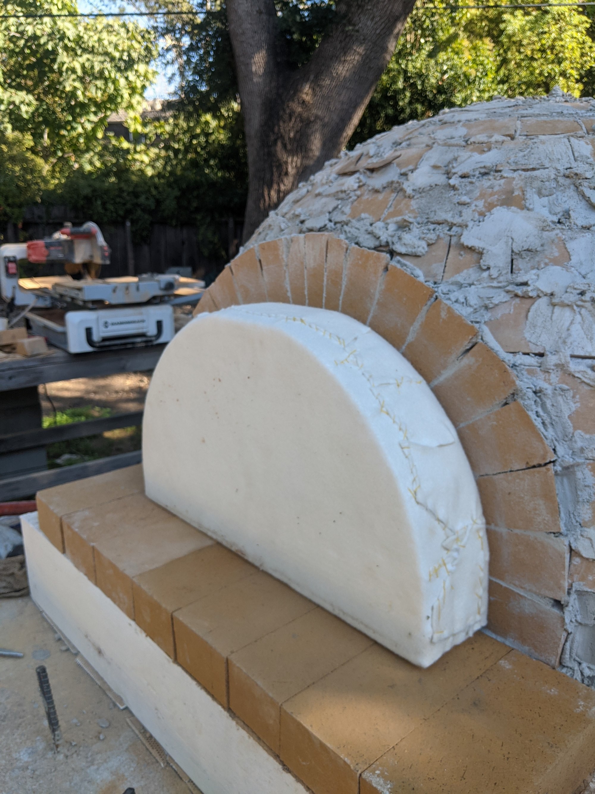

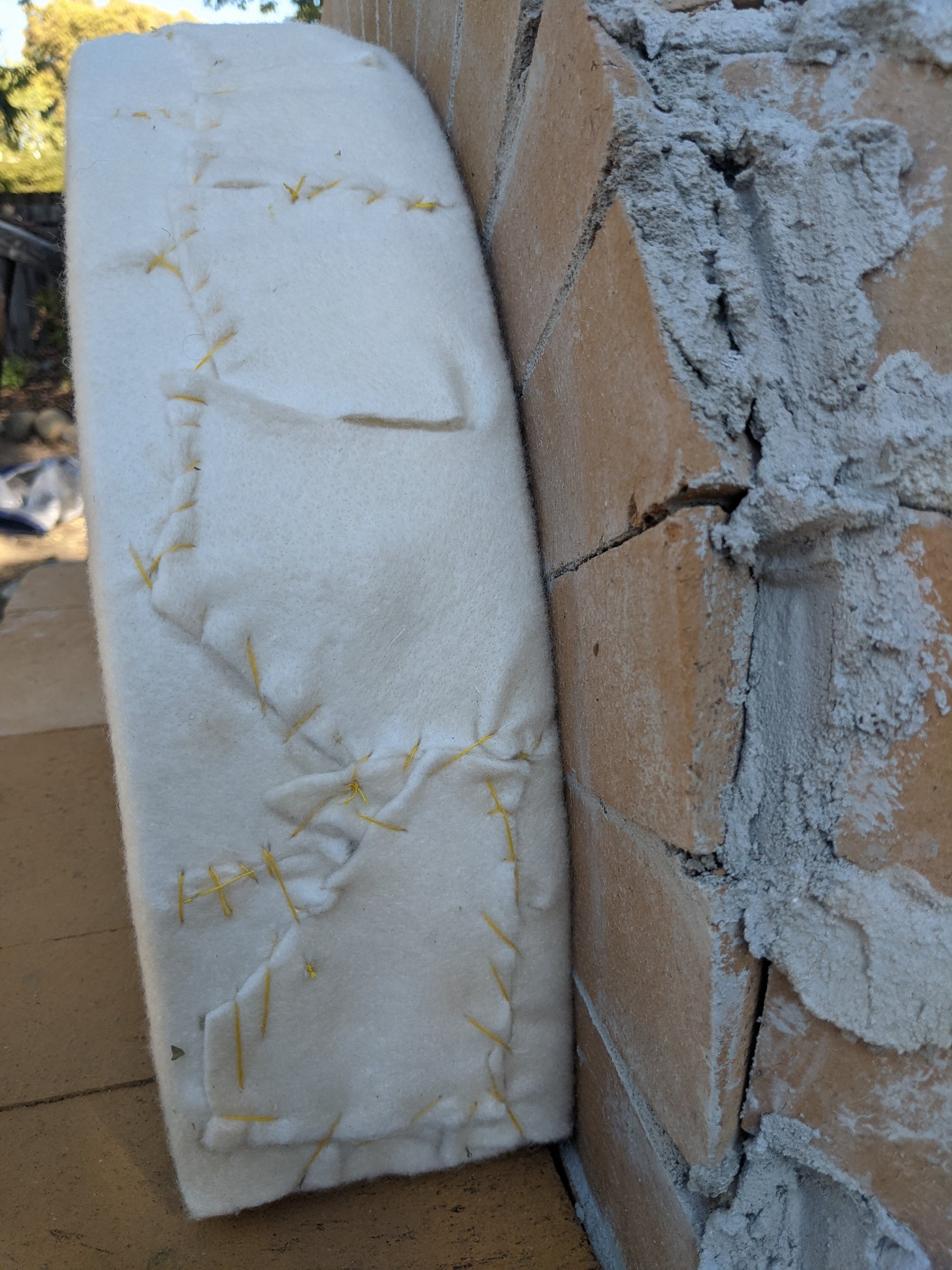

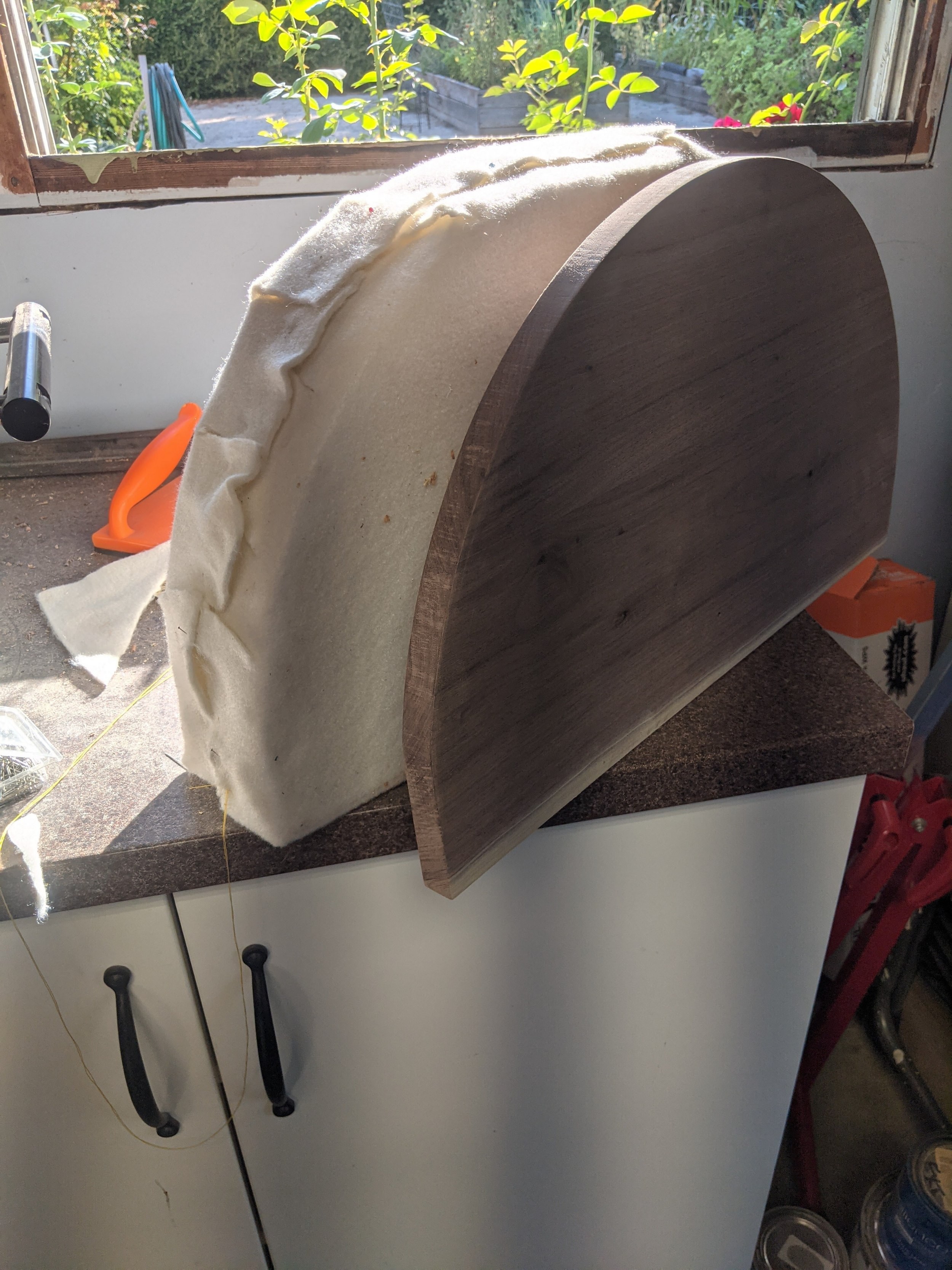

          In the meantime working on my door. Got started shaping the CalSil blocks, the wood face and the felt. Tomorrow I'll try sewing the Nomex after I get a curved sewing needle. Did a quick test with the calsil loosely wrapped in felt, and discovered that my arch is not quite as in-plane as I thought it was, so I've got some nervy angle grinder work ahead of me to even that out. Sure wish I could just take a hand plane to it like I would with wood! Also seems that the Nomex felt likes to catch on the rough surface of the firebrick landing. May need to look into something smoothing for the bottom surface; Kevlar skids, perhaps.

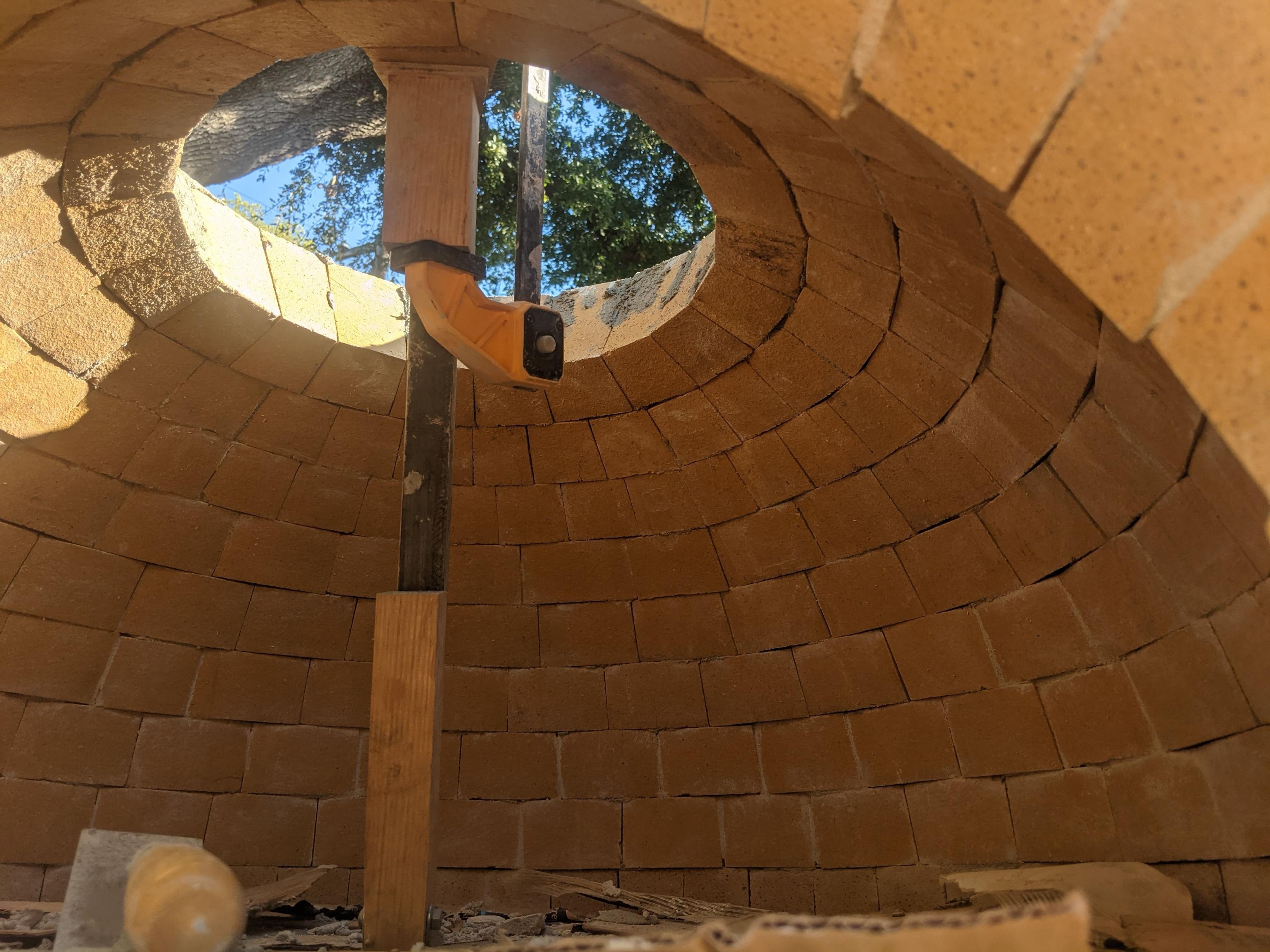

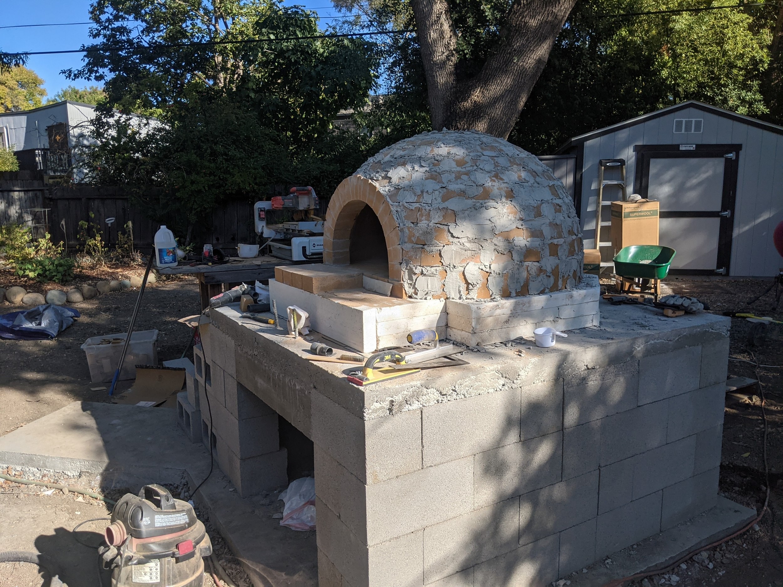

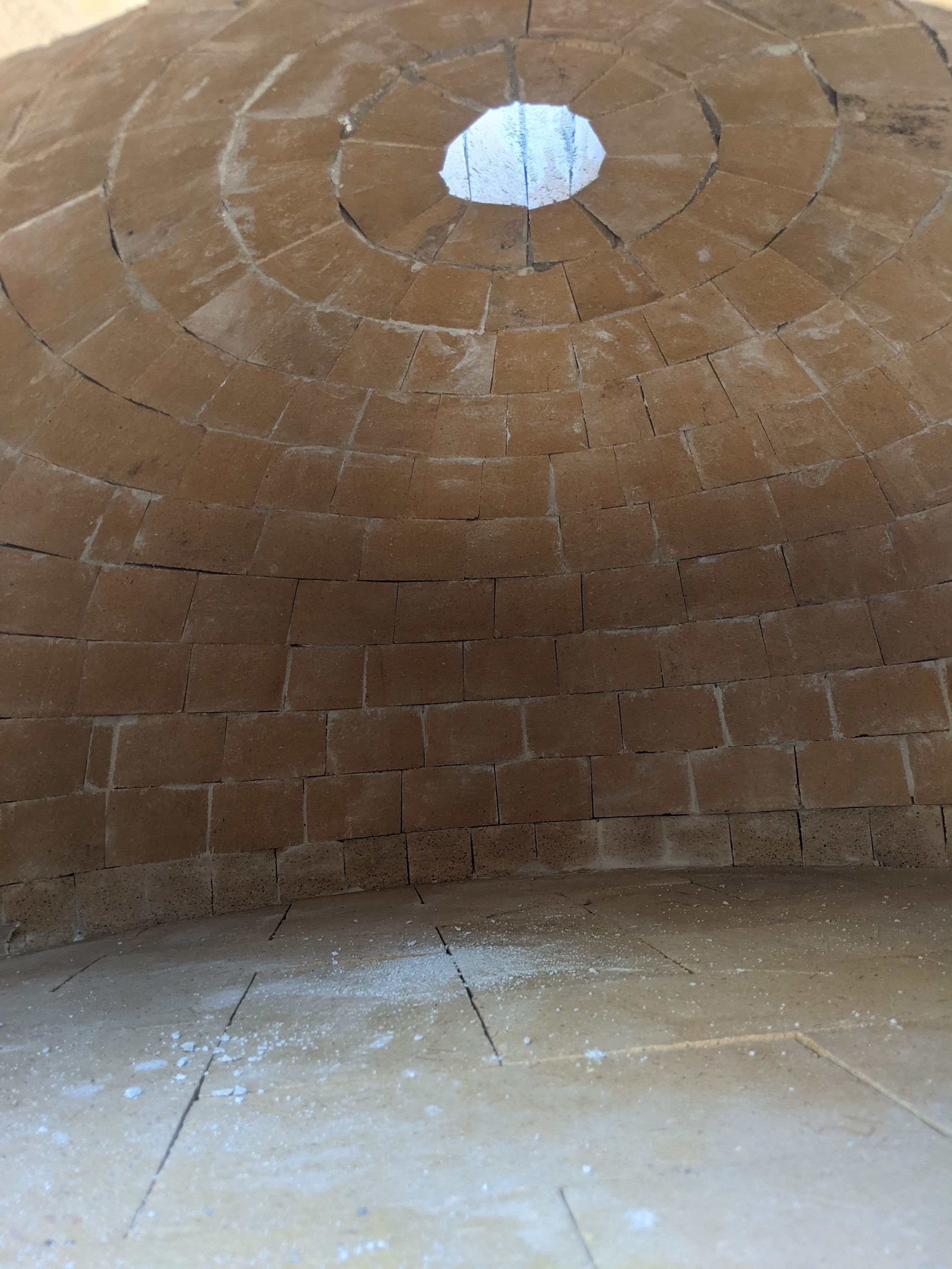

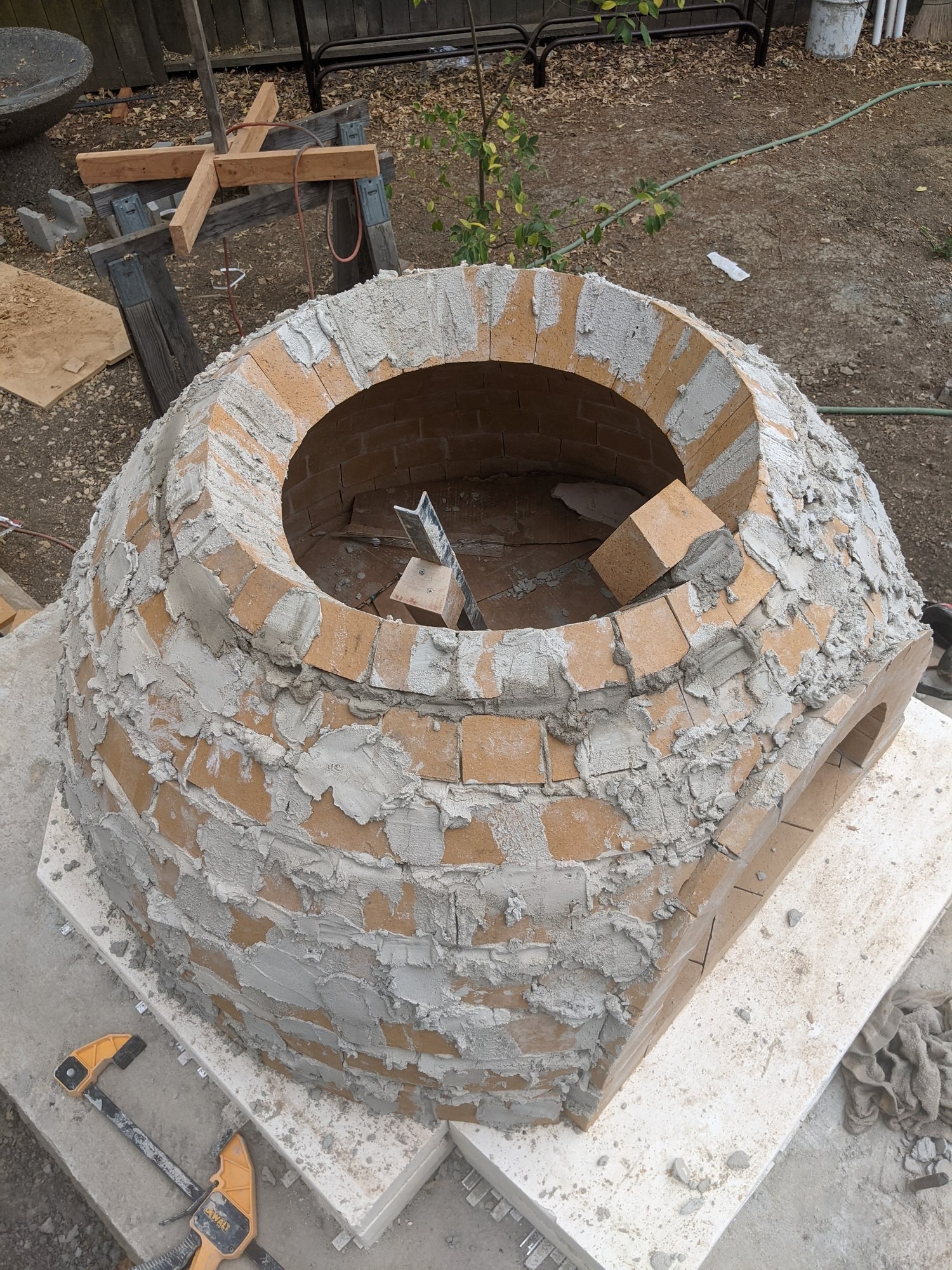

            Course 10 complete! Good thing that course was small, because man it was a pain! But it's done. Just have to cut a plug and the dome will be closed. Hurray!
            Also did a bit more work on my door. Got the fabric cut and pinned, but only have put two stitches in, mostly to try out the curved upholstery needle I bought for the job.

              Done! (Ish; still insulation, and vent, and enclosure and...). Cut my capstone this morning and laid it this afternoon. Summoned my wife and kids out to make a little ceremony out of placing it (with obligatory sarcastic commentary from the 12yo ). Did a bit of the usual awkward cleanup, including trying to squeeze some extra mortar into my more unsightly gaps with a cheap pastry bag.
              Also finished upholstering my door (that's what you do with a door, right? Upholster it?). I'm really pleased with how it's turned out so far. Despite my fairly rough stitching, the cover is tight enough that if I lift by one side, the other insulation board doesn't slide around. I suspect that if I weren't bothered by the look,* I could just sew on a couple of heavy-duty nylon straps to the outside as handles and be done with it. More importantly, despite the unevenness of the arch, the felt has enough give that it seals tight without any grinding of the bricks. Only gap I could detect is right at the bottom corners, due to the door corners being a little rounded, and there being a little gap from my thermal break. Good stuff! As long as the Nomex can stand the heat, this should be a pretty effective door.
              * I'm not excited about having the plain felt surface for the door, but I was joking with my family that I could have embroidered the outside surface to make it look nicer, if I had that skill (I do not). The notion of an embroidered oven door amused us considerably

                You may find that the contracting arch will jam the door so tight that it will be really difficult to remove. I made a similar door for my first oven and had trouble with this problem. most builder/owners find a door that sits against the flat face works better than the door sitting inside the oven mouth and copes without the contraction of the mouth becoming a problem. See how it goes.
                • rsandler
                  • Apr 2012
                  • 363
                  #53
                  david s in fact, this door sits against the flat face, largely on your recommendation. Since my arch is a touch out of plane vertically, I was really pleased that the felt-covered door still seems to make a pretty tight seal against that face.
                    • 9208
                    #54
                    Ah yes, my error. Looking closer at it I can see that it doesn't sit under the oven mouth. My apologies. It will be interesting to see how it performs.

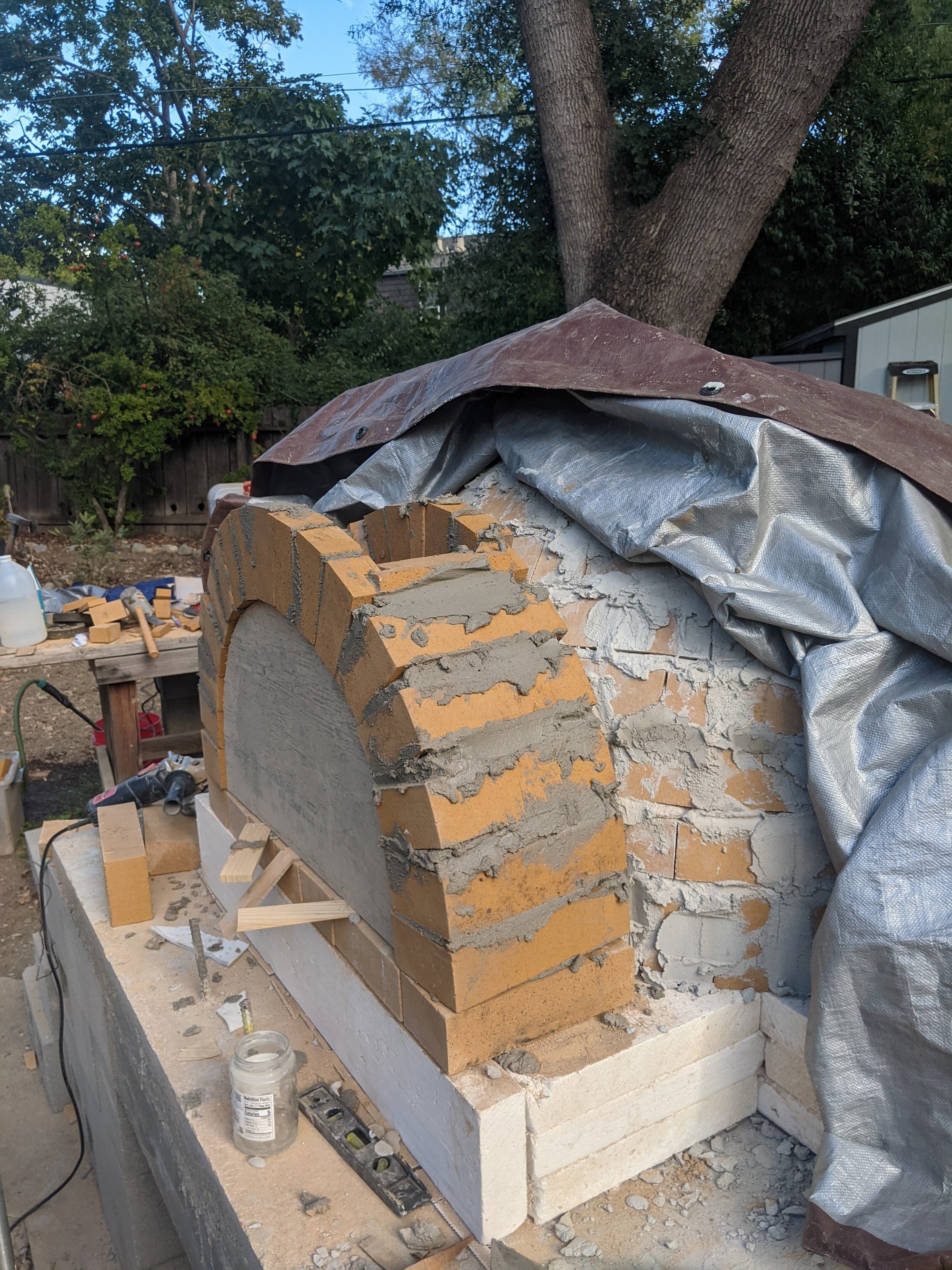

                        Made pretty good time building my vent today; managed to get the whole arch put together. Rather than doing an S shape for the middle segment, I built up both sides to around 45 degrees, then placed a brick cut at 45 degrees in the center, with both the center brick and the outside bricks notched so that they'd sit together. The theory is that the middle bit is then braced on the front and back arches, and so more stable than just having mortar. The front is all higgledy piggledy, but I'm planning a decorative arch to cover it once I build the enclosure, so I didn't worry about it, and just tried to make sure it was all stable.
