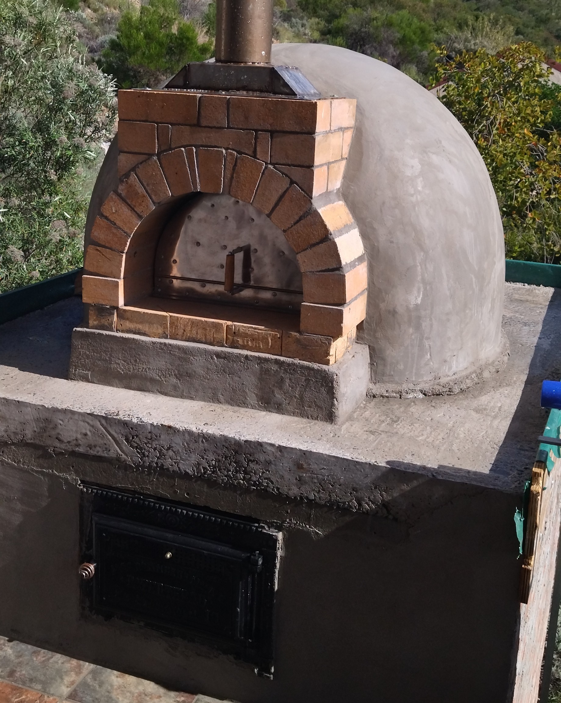

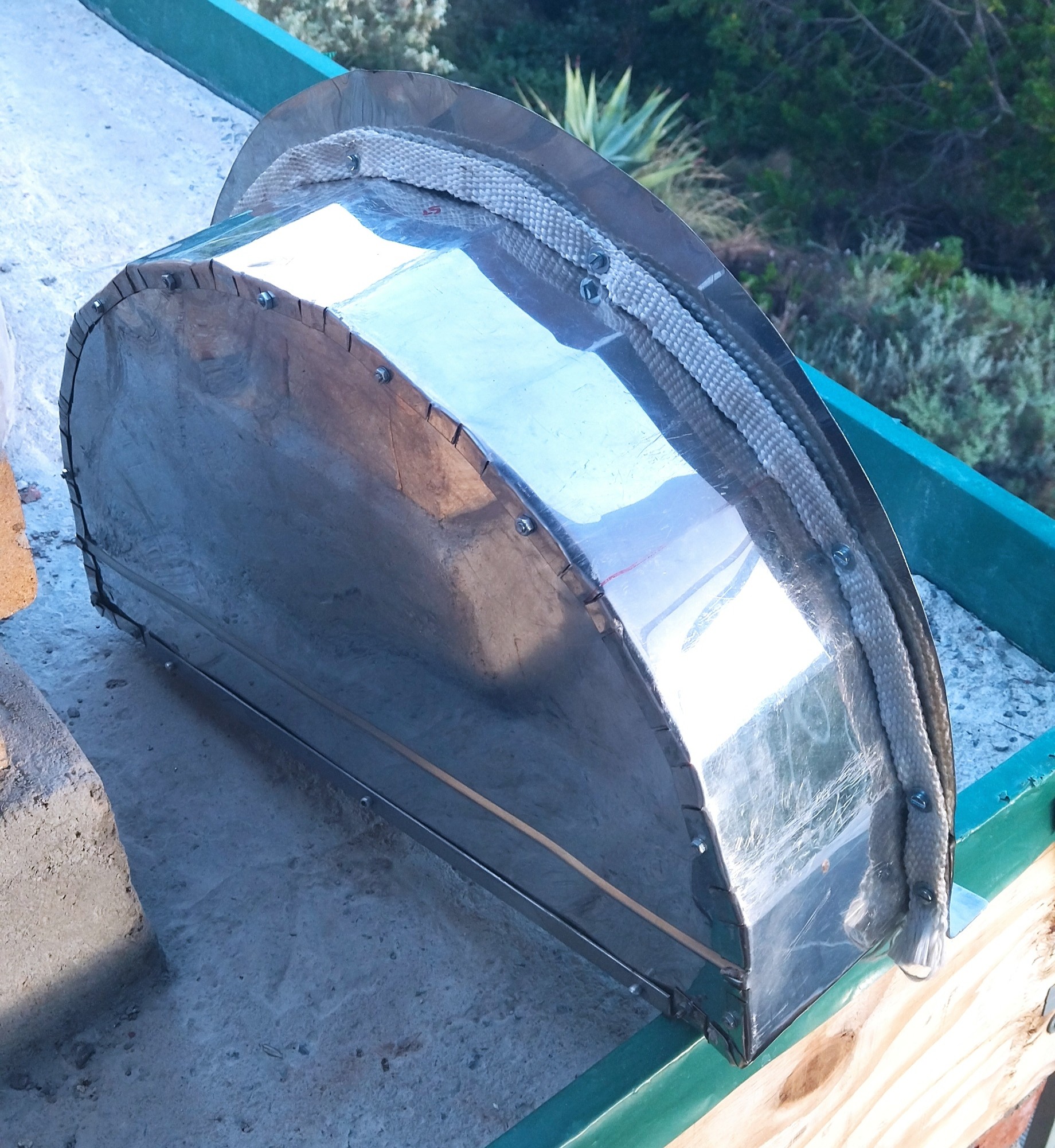

    Hi guys,
    Above are some photos of my progress with the oven, including the inner door, the vermiculite layer, the final render, and the store room on which the oven is built.
    This storeroom gets hot when the sun shines on it, would a layer of vermiculite / cement and render work in solving this problem?
    Has anyone done this,? If so how should I go about it, without it collapsing after a while?
    Thanks again for all the input and support you guys have given me to reach this point.
ID:	458677 Click image for larger version
ID:	458678 Click image for larger version
    Leave a comment:
ID:	458675 Click image for larger version
