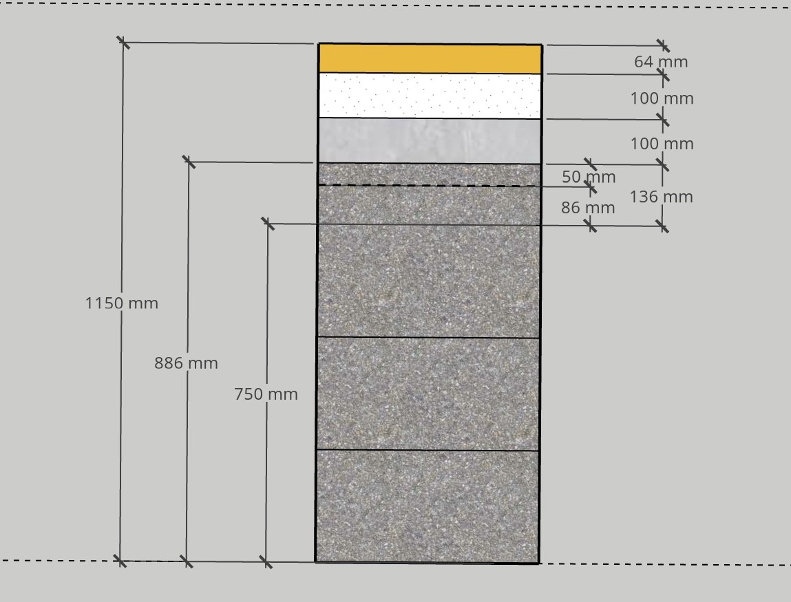

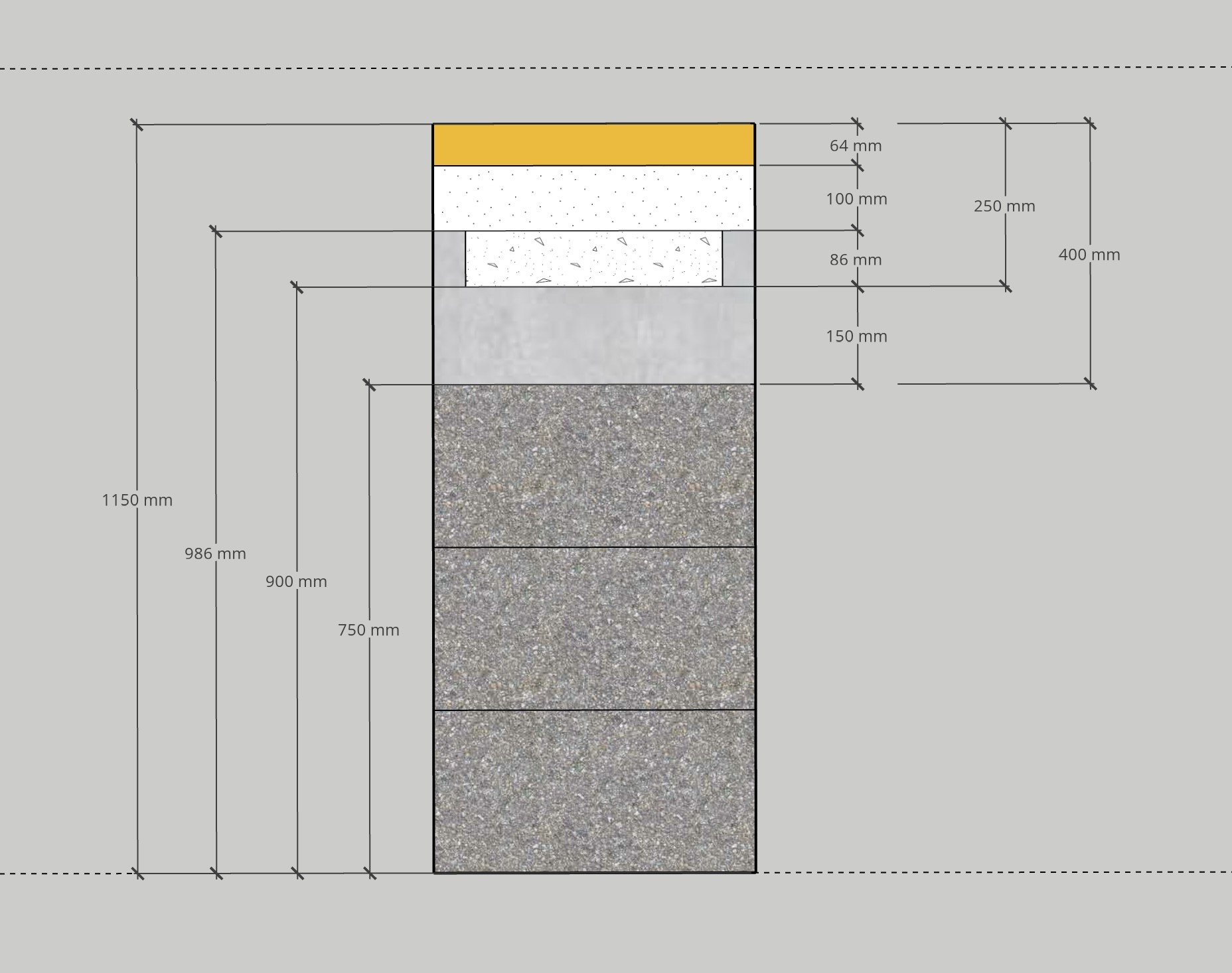

    david s I understand you said in your opinion its not necessary to have additional vermiculite insulation on the hearth under 100mm ceramic fibre insulation floor.

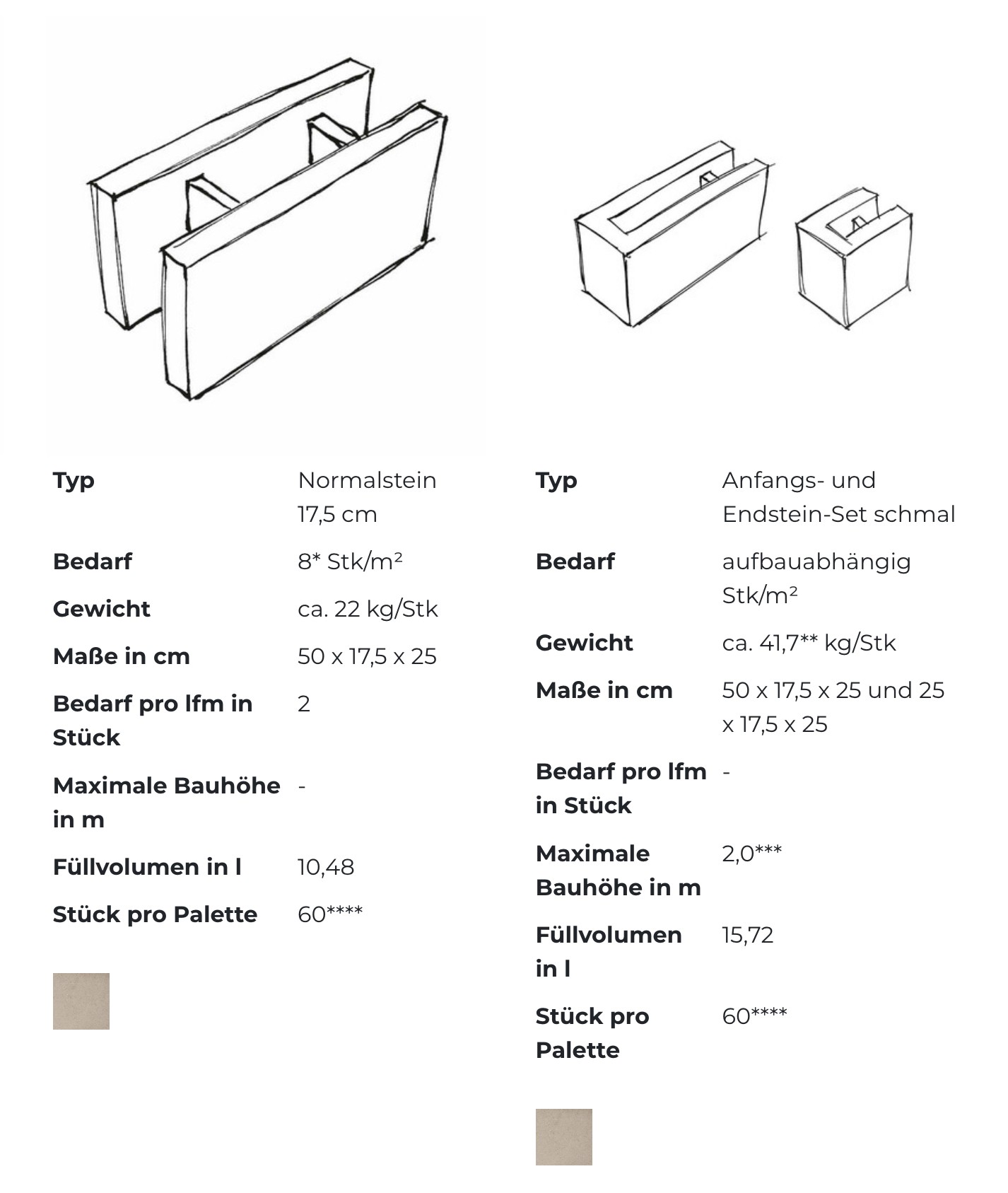

    In my case, here in Germany we have schalungssteine, which are quite a different format to cinder blocks. I‘m using L500xH250xW175mm (Illustration below.) Aiming for my final height of 1150mm for the floor, it requires cutting the fourth course of blocks down to 136mm. I‘m considering the possibility of eliminating the fourth course altogether, which leave me with 86mm to fill, which I could with a layer of vermiculite/perlite insulation. In the plan below, the hearth is 150mm (100mm above the wall, 50mm inside the wall), so I would need to change that to 150mm above the 750mm wall. It would reduce the height of the space below the hearth from 886mm to 750mm, but would save me on blocks for the fourth course, and the cutting of the blocks.
    Above the hearth, it would then be 86mm Vermiculite/perlite insulation, 100mm Ceramic fibre insulation, 64mm firebrick floor, total of 250mm. My floor will be inside the dome first course with the come first course on the ceramic fibre board. (Image below right)
    Question: Would also do away with the need to put mosaic tiles? I‘m a bit unclear about the order and structure with this. I see the advantage of putting drainage holes in the hearth, which is straight forward and planned. If I do the vermiculite/perlite layer, is there a way to lay the mosaics under it, perhaps covered with a layer of plastic with holes and then the vermicrete? Or not necessary then at all?
    Question: Vermicrete/Perlite mix. For this layer of insulation under the ceramic fibre, what ratio would you recommend so that it is strong enough to support the ceramic fibre and then oven? I considered laying an extra layer of concrete around the vermicrete on top of the hearth to enclose it on the sides. I could do this, or leave it, depending on whether it would be better for support of the vermicrete layer.

    Regarding the layer of vermicrete under a 100mm calcium silicate board I don't believe you'll achieve much because 100mm is already way more than most oven builders would use. The thicker the insulation is the more it suffers from the law of diminishing returns. Additionally the large amount of free water a vermicrete layer contains needs to be removed prior to building over it because moist insulation of any kind does not work very well. We've had reports of oven performance getting better months after completion because that underfloor moisture is difficult to remove. A 100mm cal sit is already dry so this problem is largely removed. However should water get in a space under the insulation created by a layer of tiles with wide spaces and some holes in the supporting slab, do a fine job of allowing moisture to escape. If you have your heart set on doing a vermicrete slab it should be a 5:1 ratio for sufficient strength. The vermicrete over the dome does not support a lot of weight so a !0:1 there is better. (see attached table for strength to insulation relationship). Some weed matting placed over the tiles is enough to prevent the vermicrete from blocking the pathway between the tiles, but enough to let the moisture pass. Also attached is an experiment I did for drying a vermicrete slab that helps explain what's going on.
