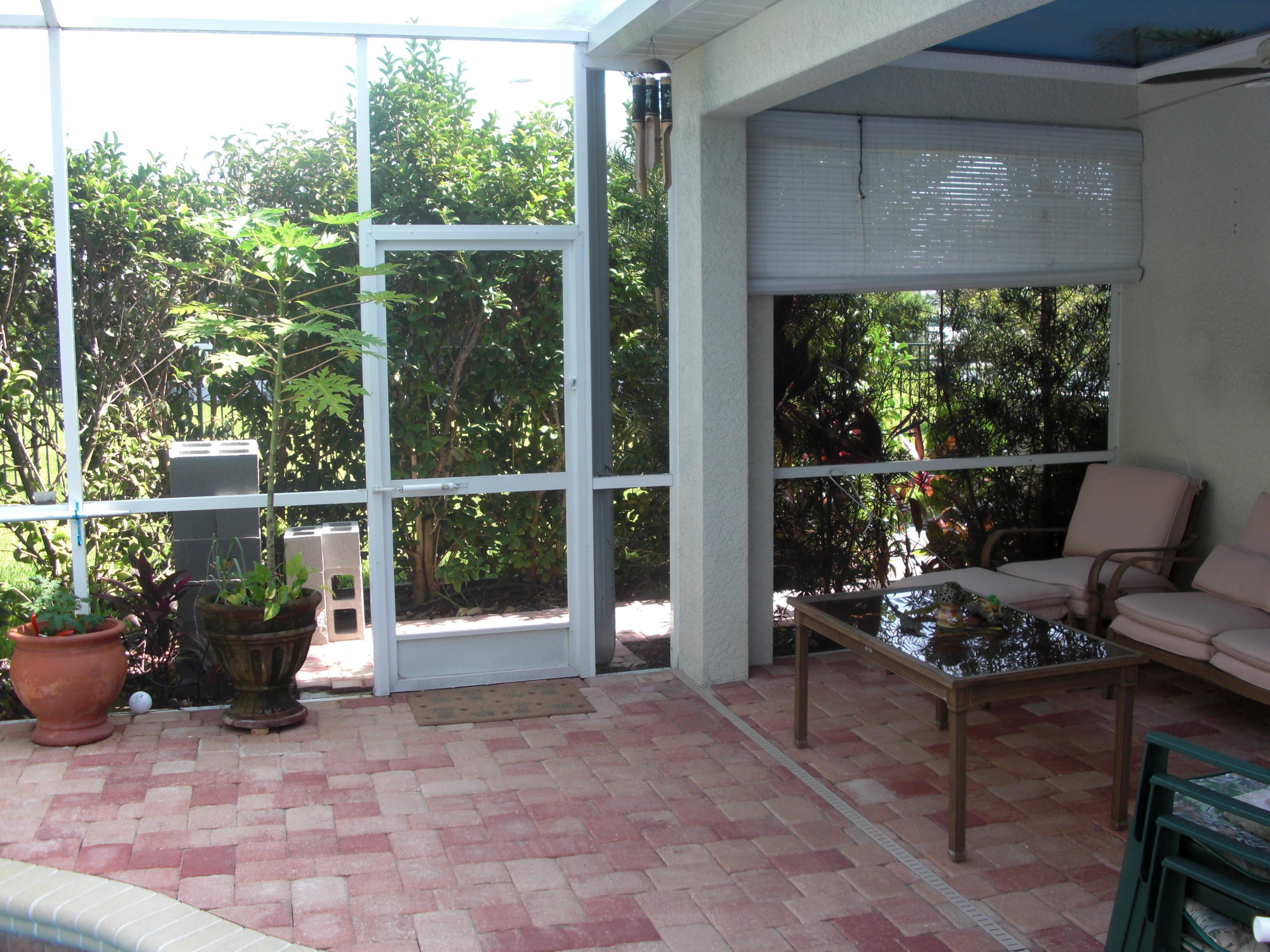

        Day One, October 18th, 2008.
        After taking waaaaaay too ong deciding on where to put my oven I (my wife) decided that there were just too many bugs, misquitos,, etc. out in the back nature area where I had planned on placing it so I (wife again) decided to have it as part of our pool area thats screened in.

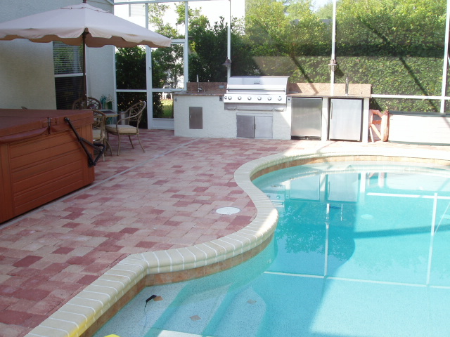

        The designated area is on the opposite of the outdoor kitchen.

        Now all I have to do is move the door to the opposite side of the column, remove the screen, remove the pavers, and then lay block. Piece of cake right?

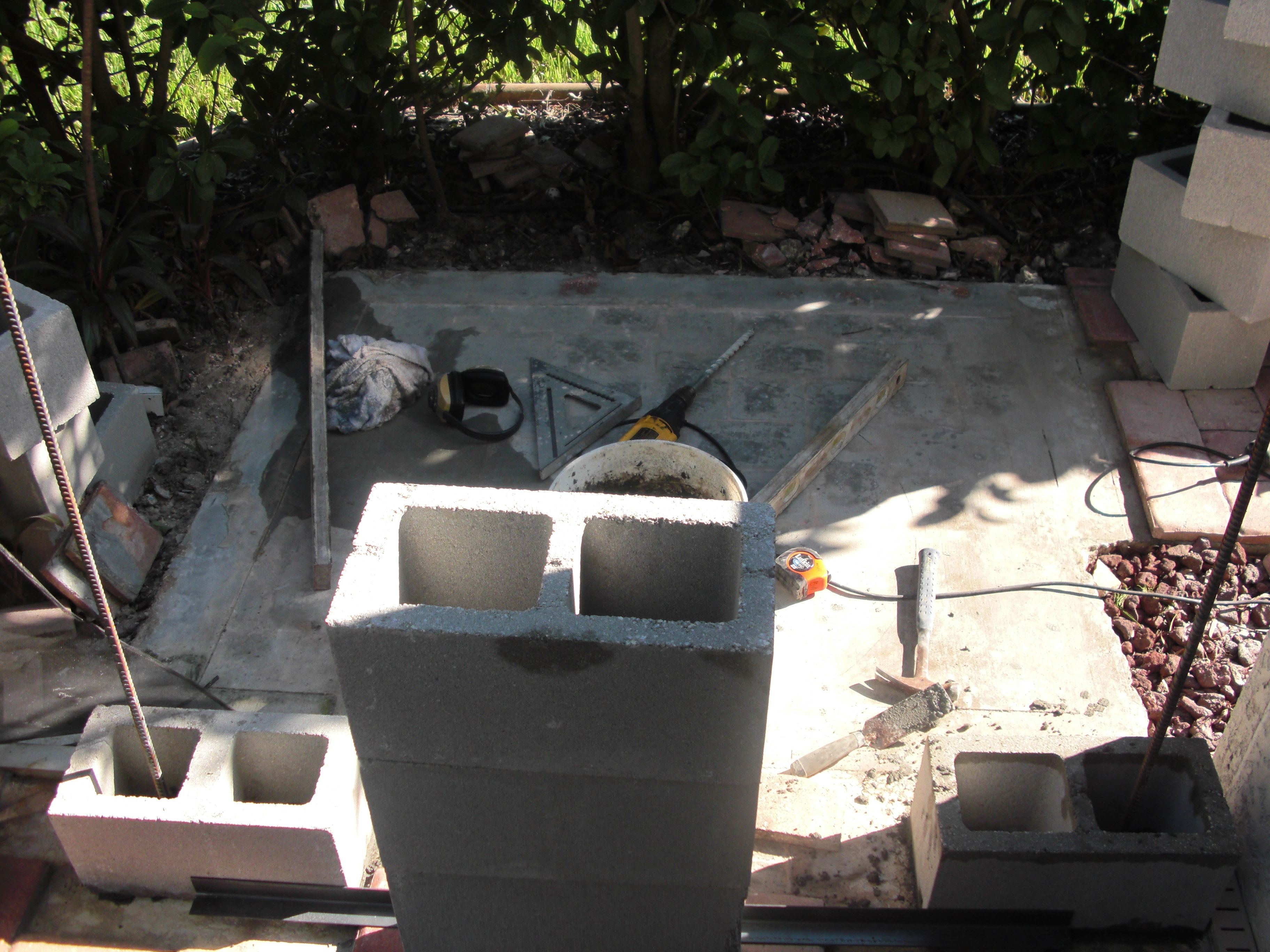

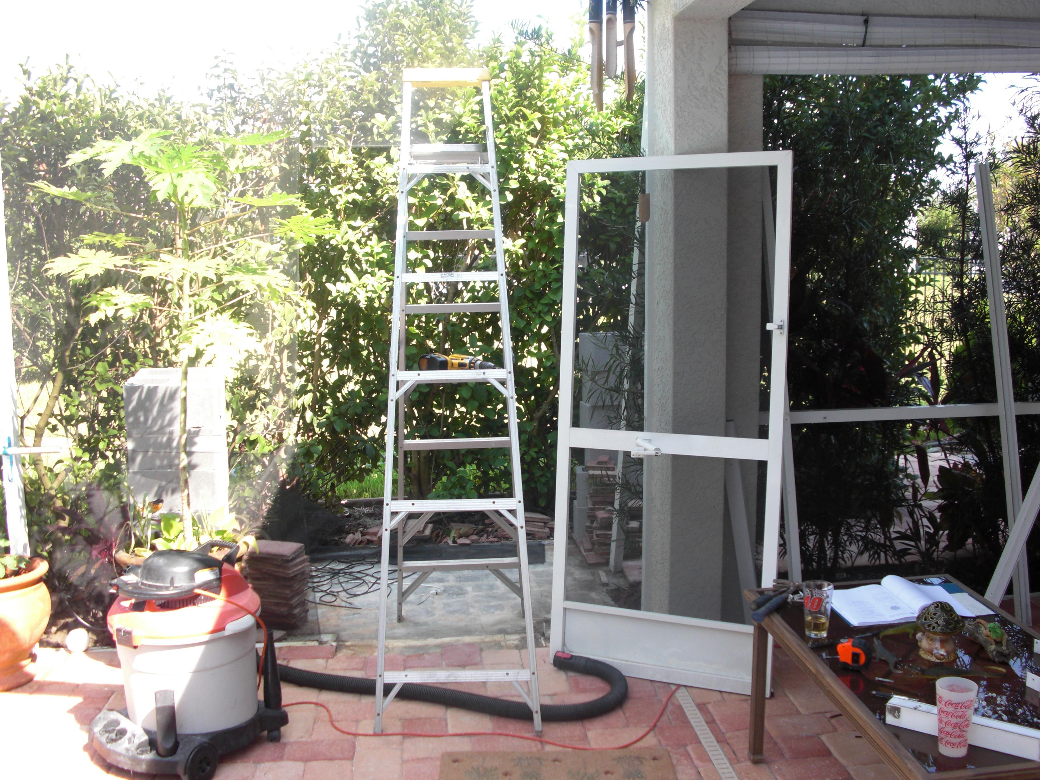

          Day One-Part two,
          I was fortunate to already have a massive slab pored a few years back when the pool contractor did my walk way down the length of the house. I asked if I can form the boards and just have them poor, they said yes. Score! I made the sidewalk 4" thick except in this area due to the sloping ground so I formed it up with 2x6's and they showed up with the cement that they use for roads..? It had larger aggregate but holy crap, it's almost impossible to drill through! Sounds like tempered steel.
          Here is my door that was moved, plus plants, shrubs, pavers, screen, and yes I can make a huge mess quickly.

          At this point I'm exhausted but ready for concrete!

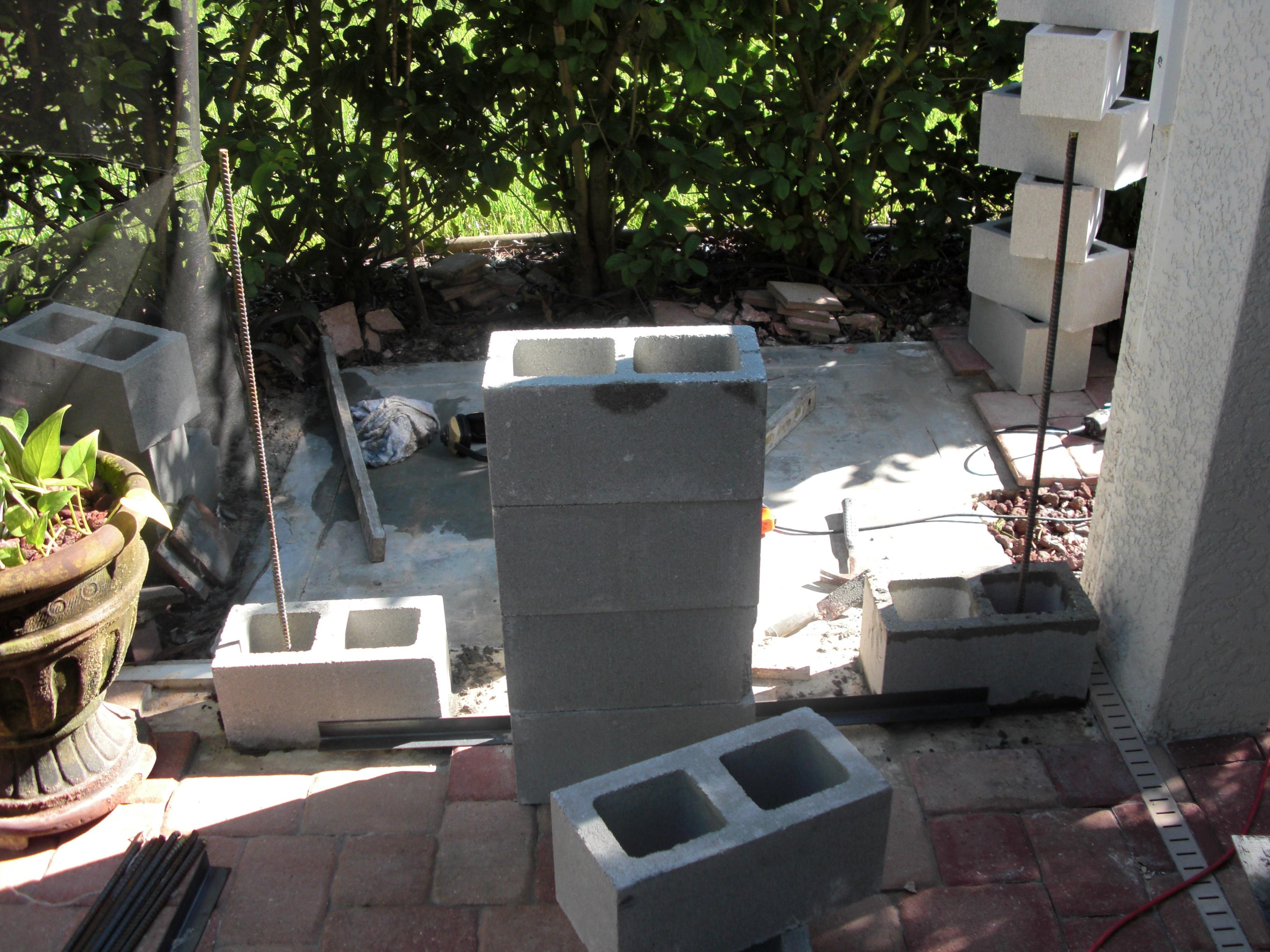

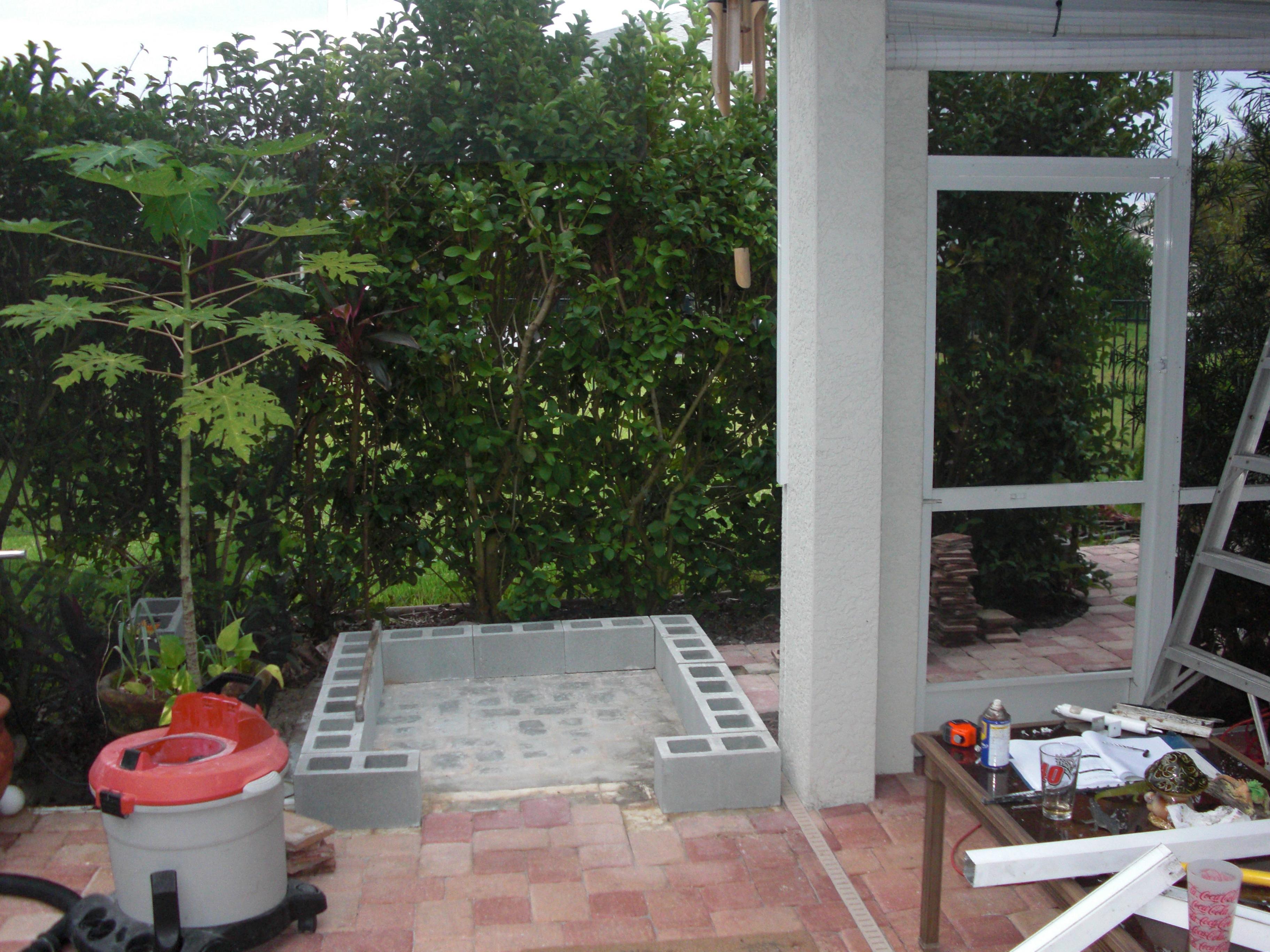

                Build Day Three (my notes say two but I cannot remember),
                I was hoping that if I starred at the spot long enough it would start itself. No luck, guess I need to get going.
ID:	272755;Click image for larger version
ID:	272756;Click image for larger version
ID:	272758;Click image for larger version
                Bill,

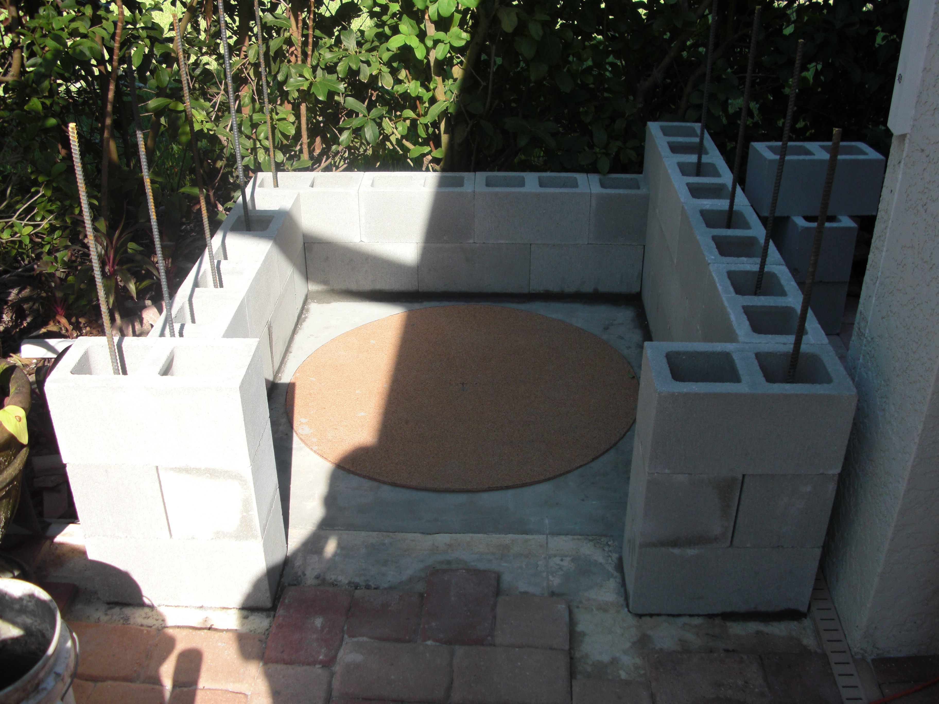

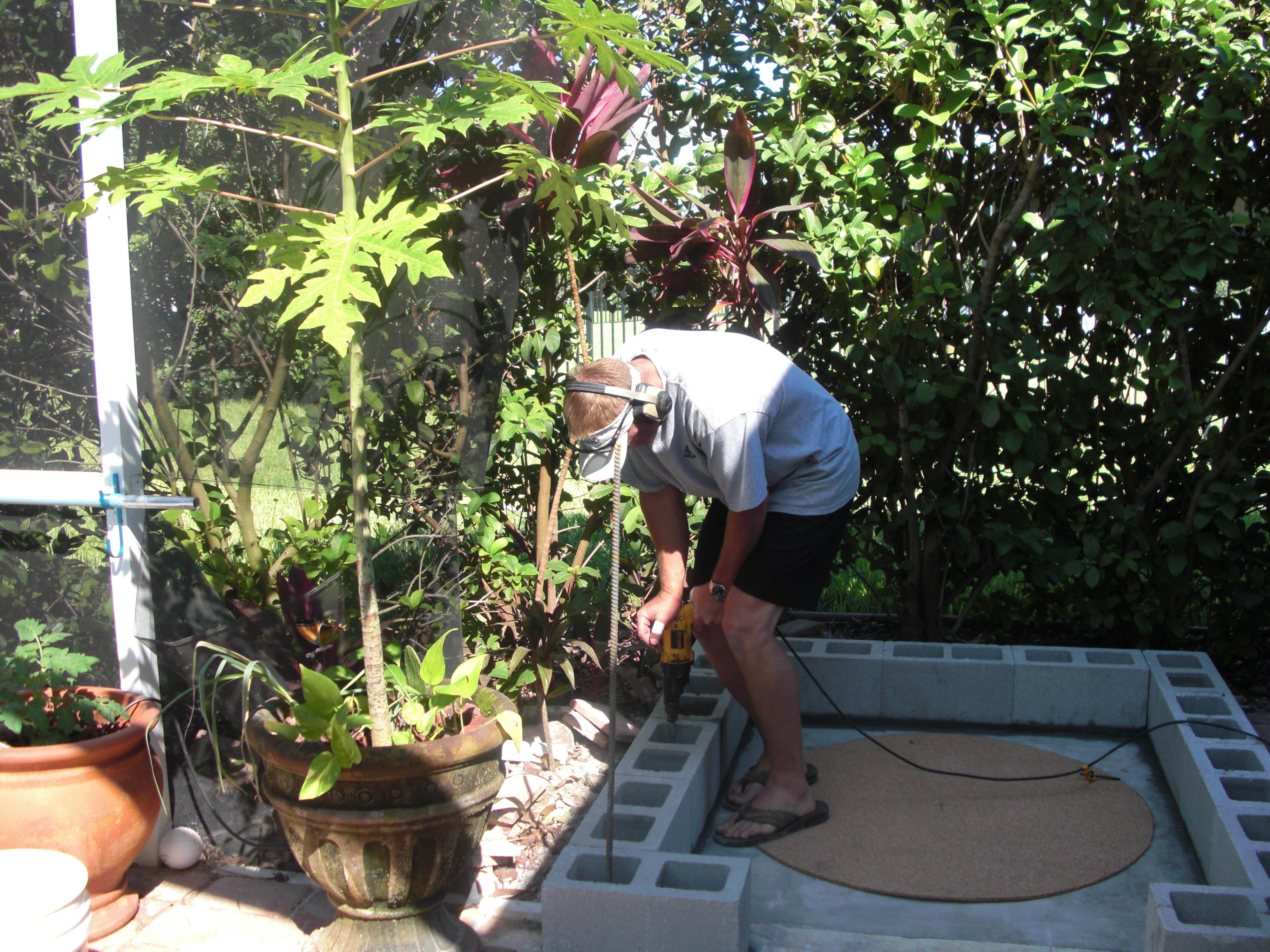

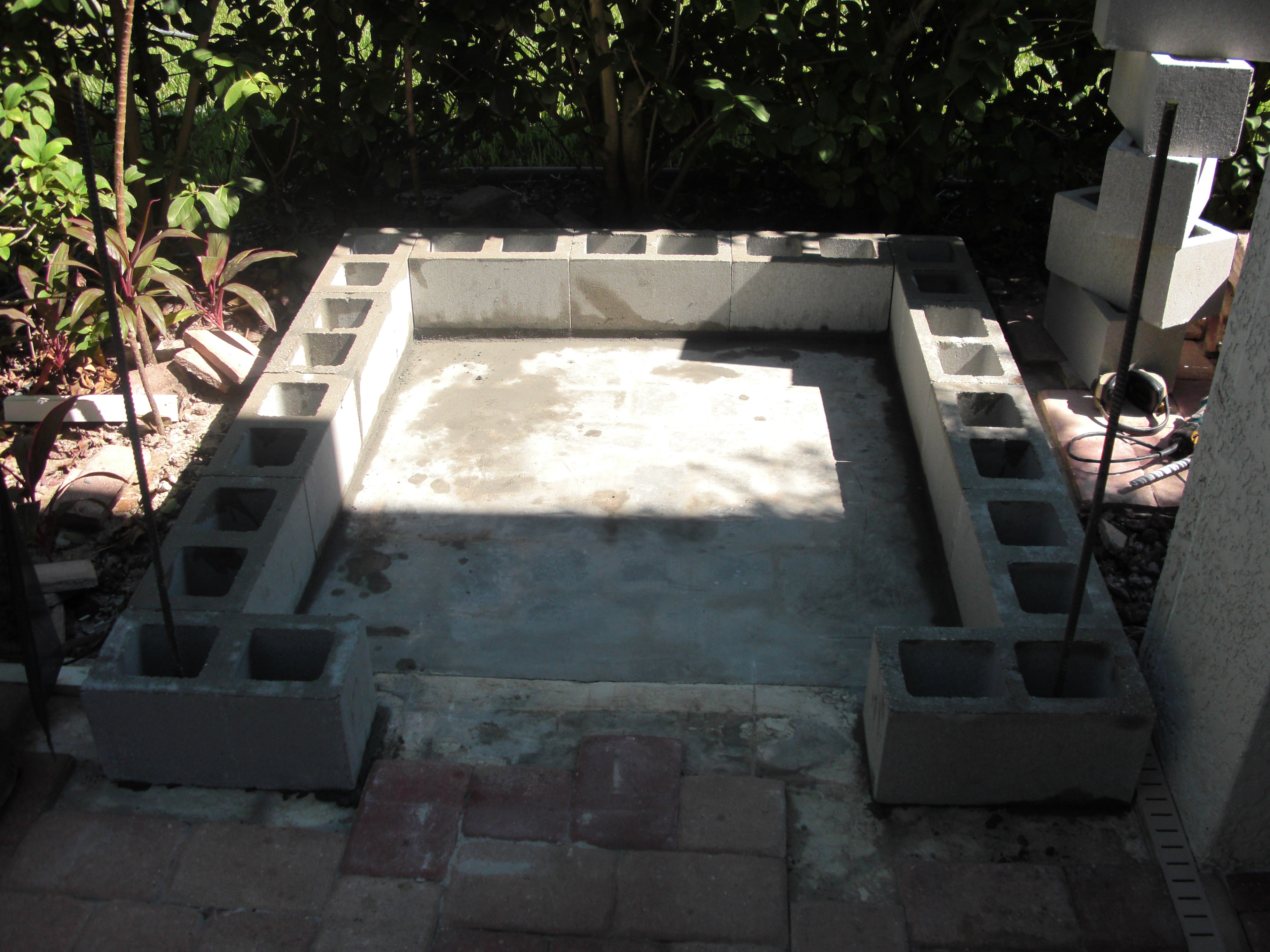

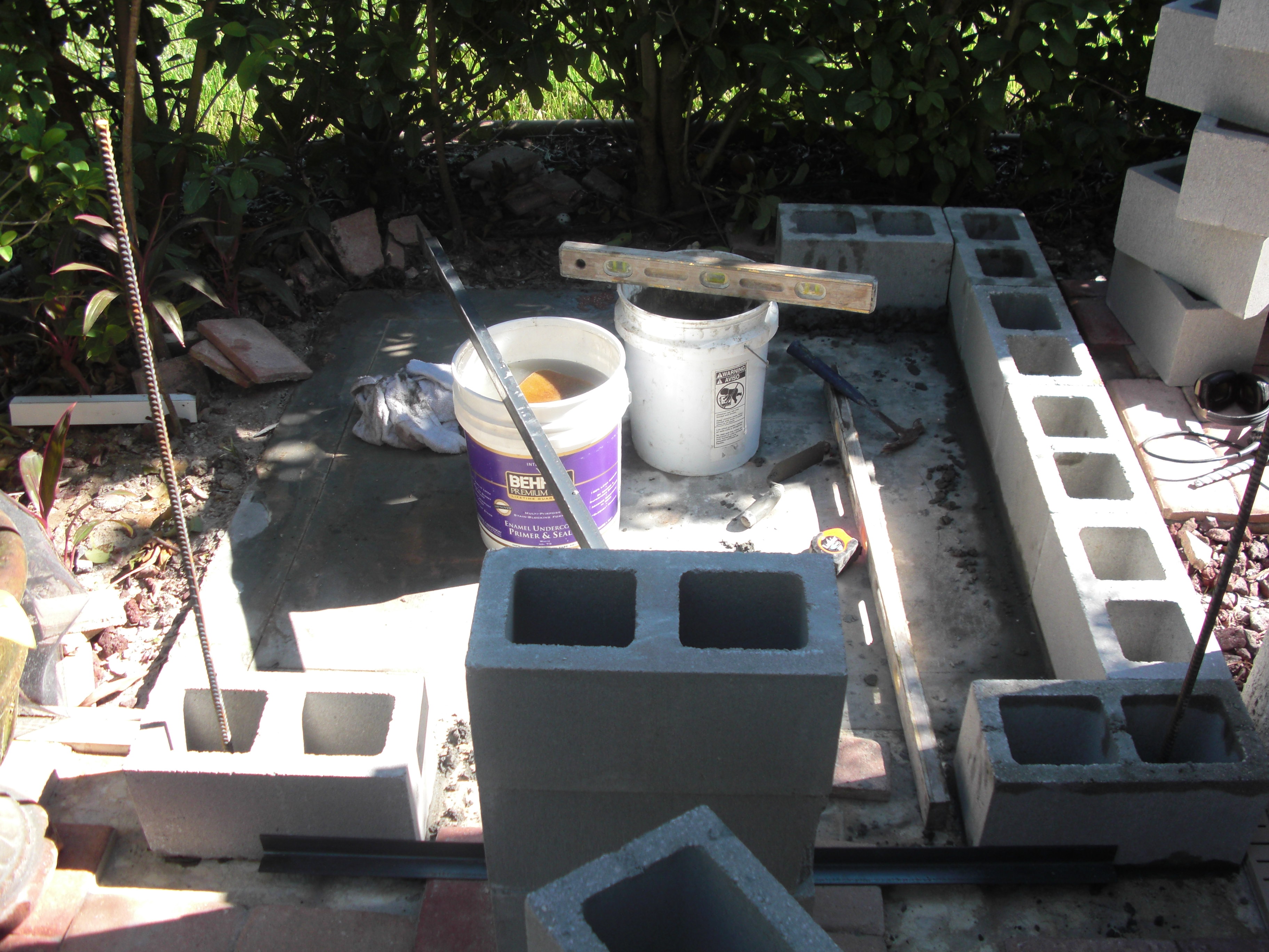

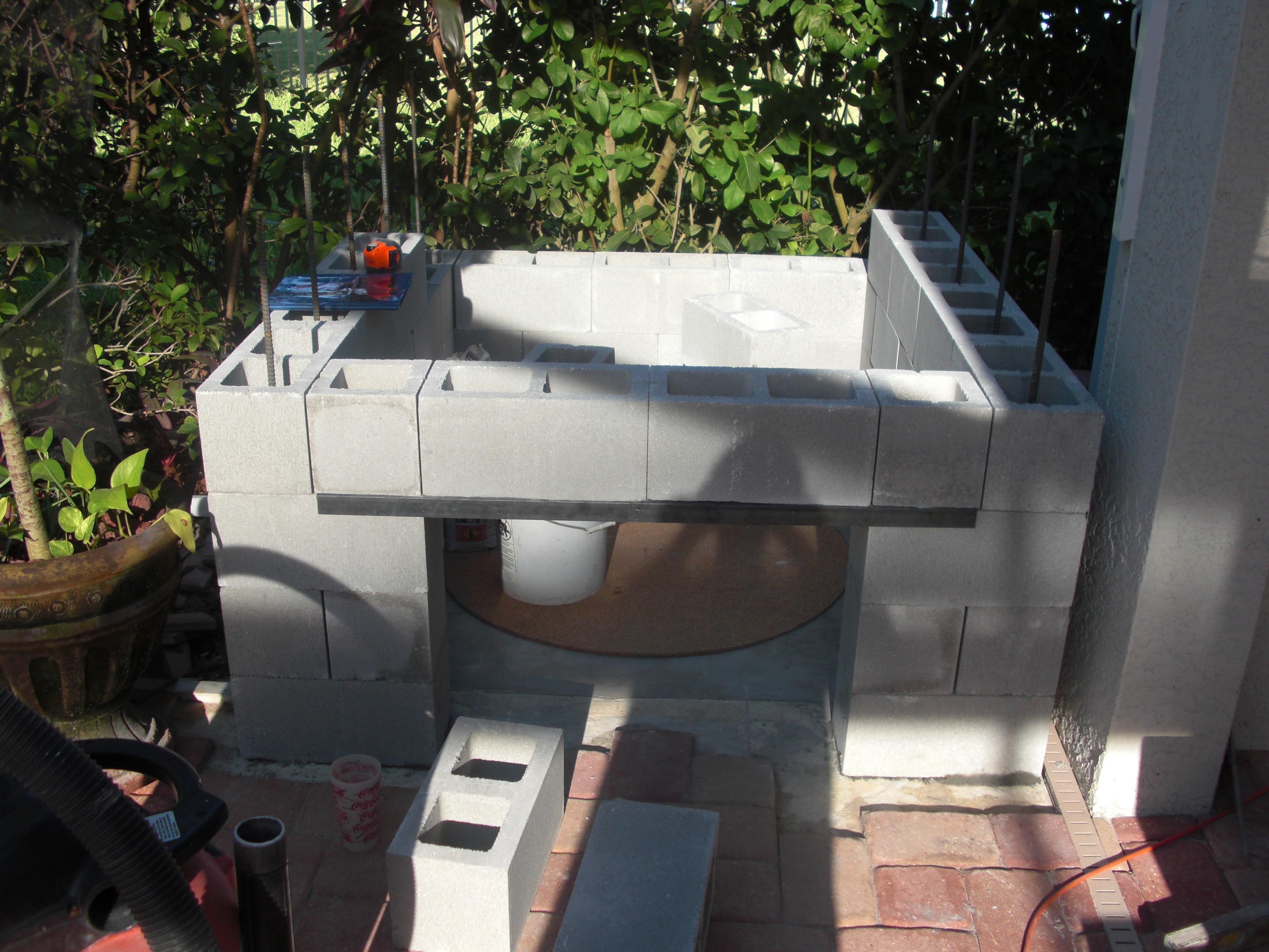

                    Build Day Four,
                    First course is set, leveled, and ready for rebar.
ID:	272760 Checking out the position of the dome
ID:	272761Trying to drill through that freakin highway cement! Check out the Florida steel toe shoes, I believe Reef makes them
ID:	272762Blocks going up quickly.
ID:	272763 Almost finished.
                    Bill,

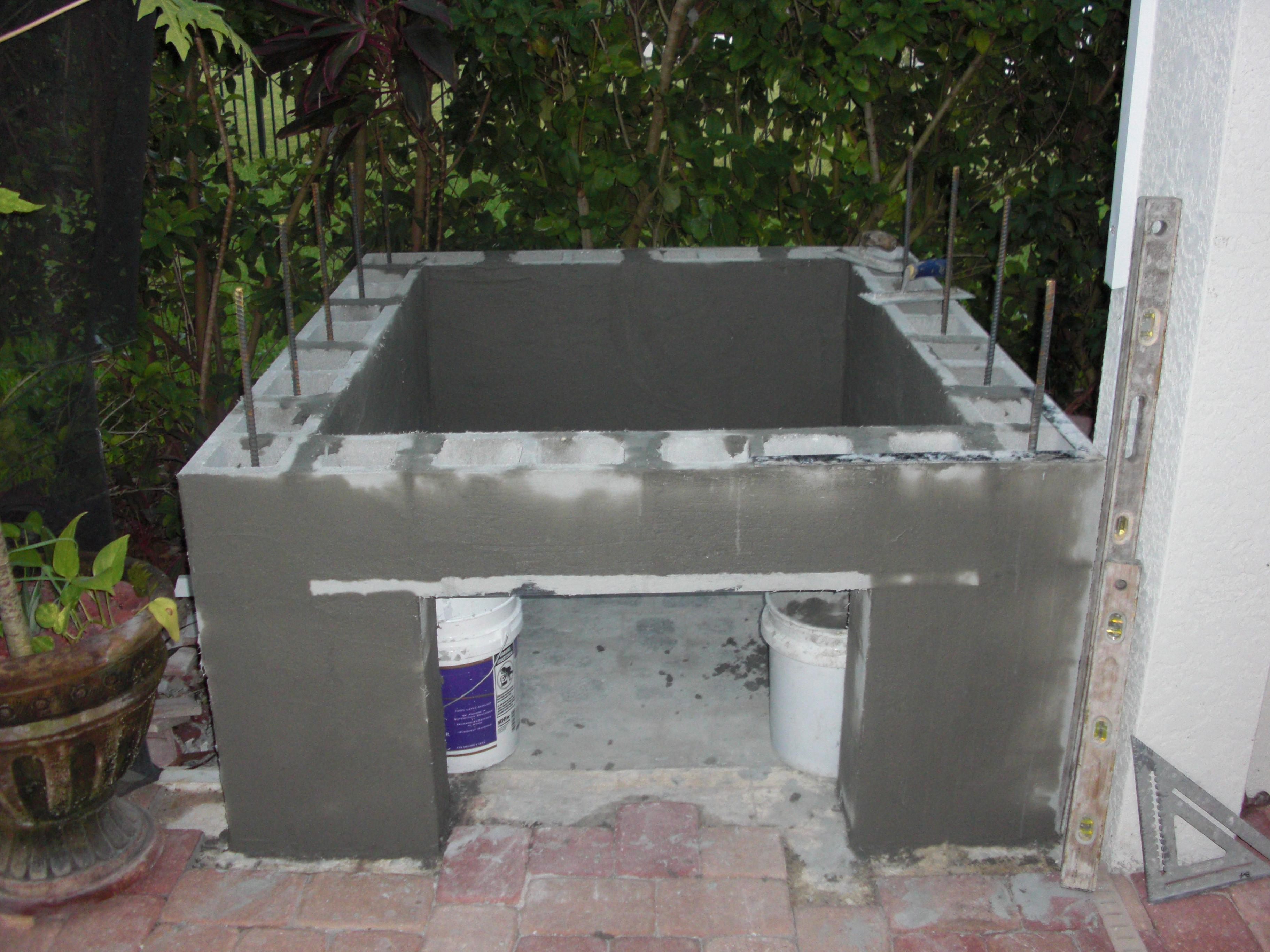

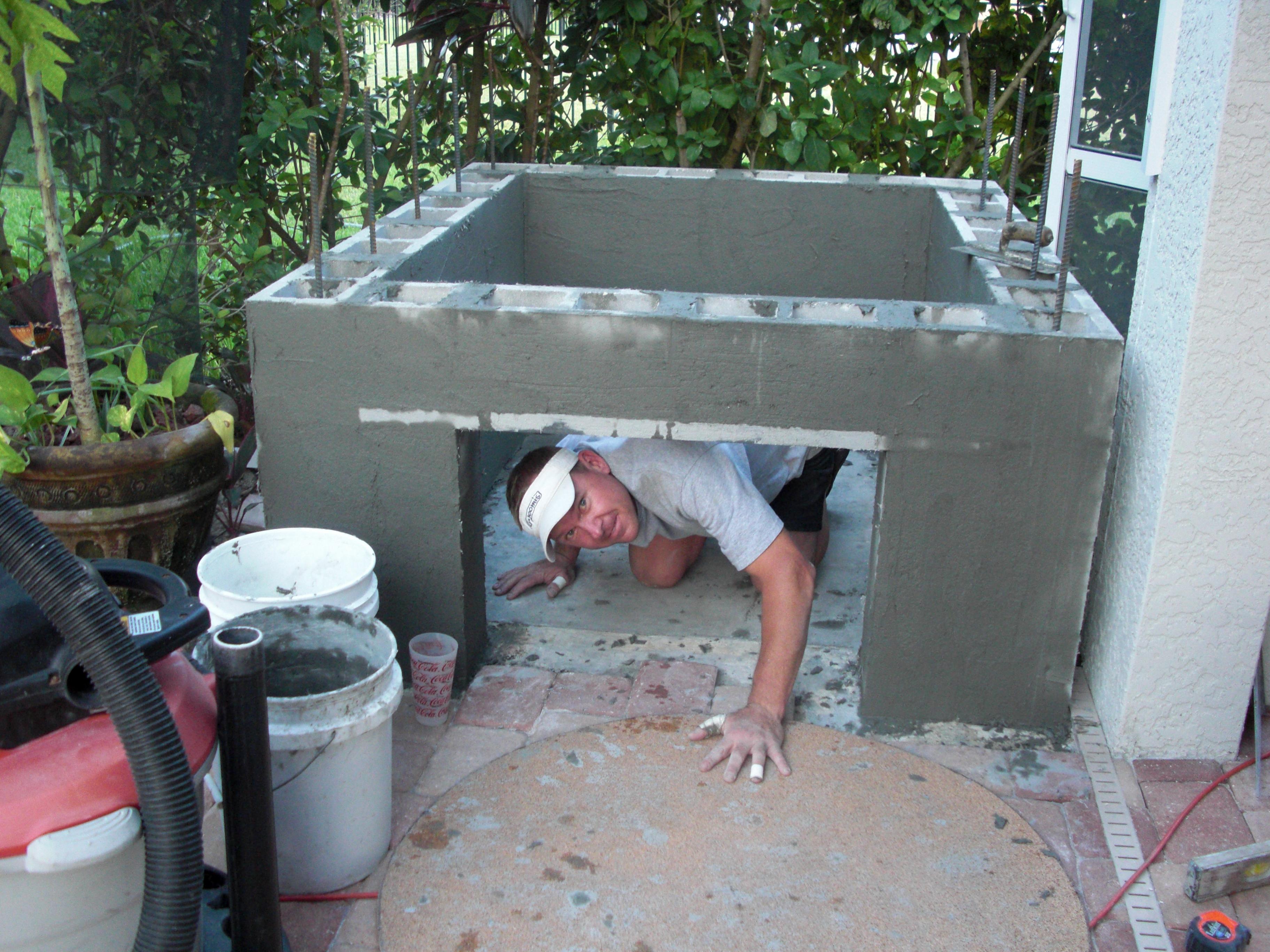

                      Build Day Four-part two,
                      After the blocks were set I decided to use a a wall bonding agent I read about. Yes I know that I'm going to pore concrete in each hole and it's not necessary but I was having visions of my son, his friends, and a football and a large pile of blocks...
ID:	272764 Out of mortar and I'm done!
ID:	272765 My daughter thought it was funny that I couldn't get out that easily

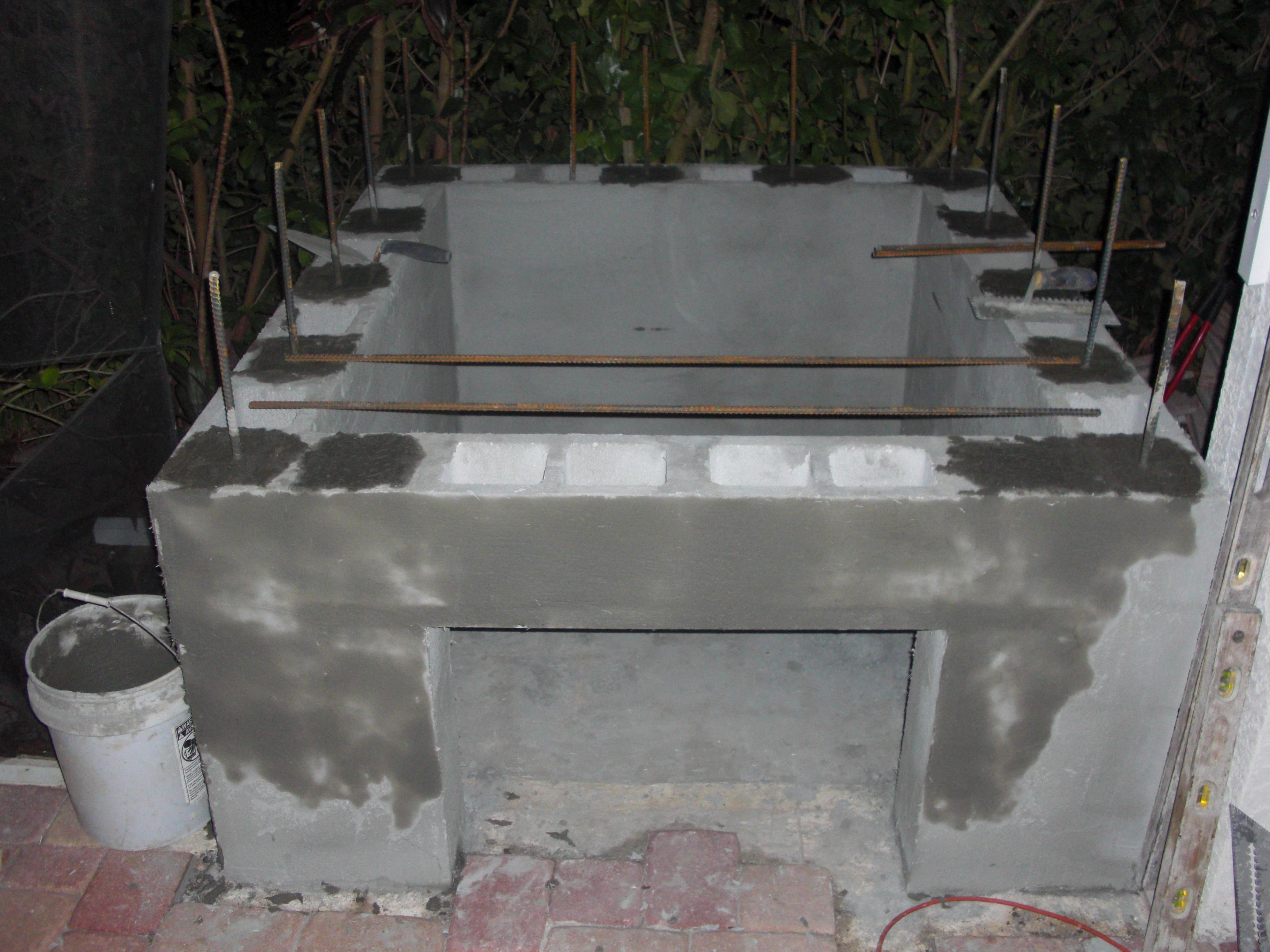

                        Build Day ??? No notes, just aches and pains I think this is day 5, evening of Wednesday the 22nd.
ID:	272767 Concrete going in the holes, rebar getting cut.
ID:	272768 More progress, more rebar, more concrete. Love those 80lb bags!
ID:	272769 I hate this time of year when it gets dark so early. I managed to get this done in just under two hours. Daylight is gone, heading in.

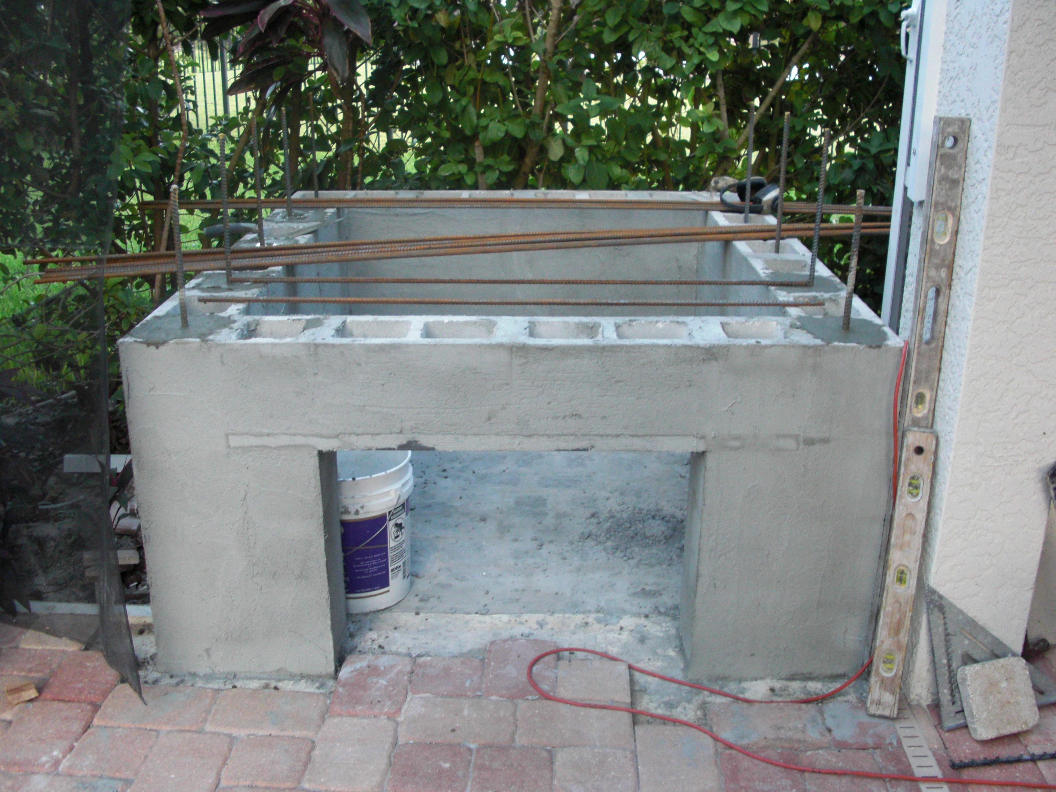

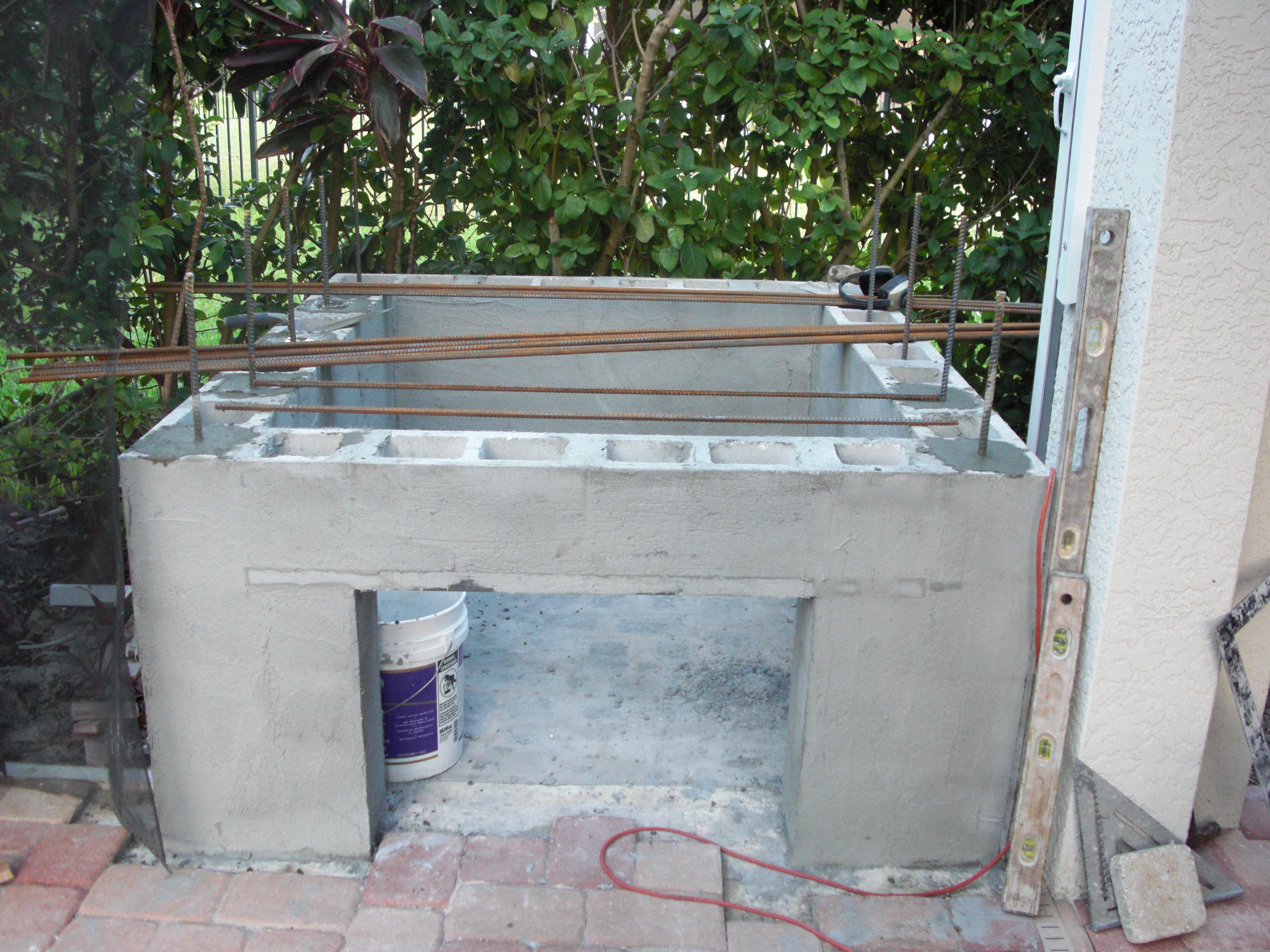

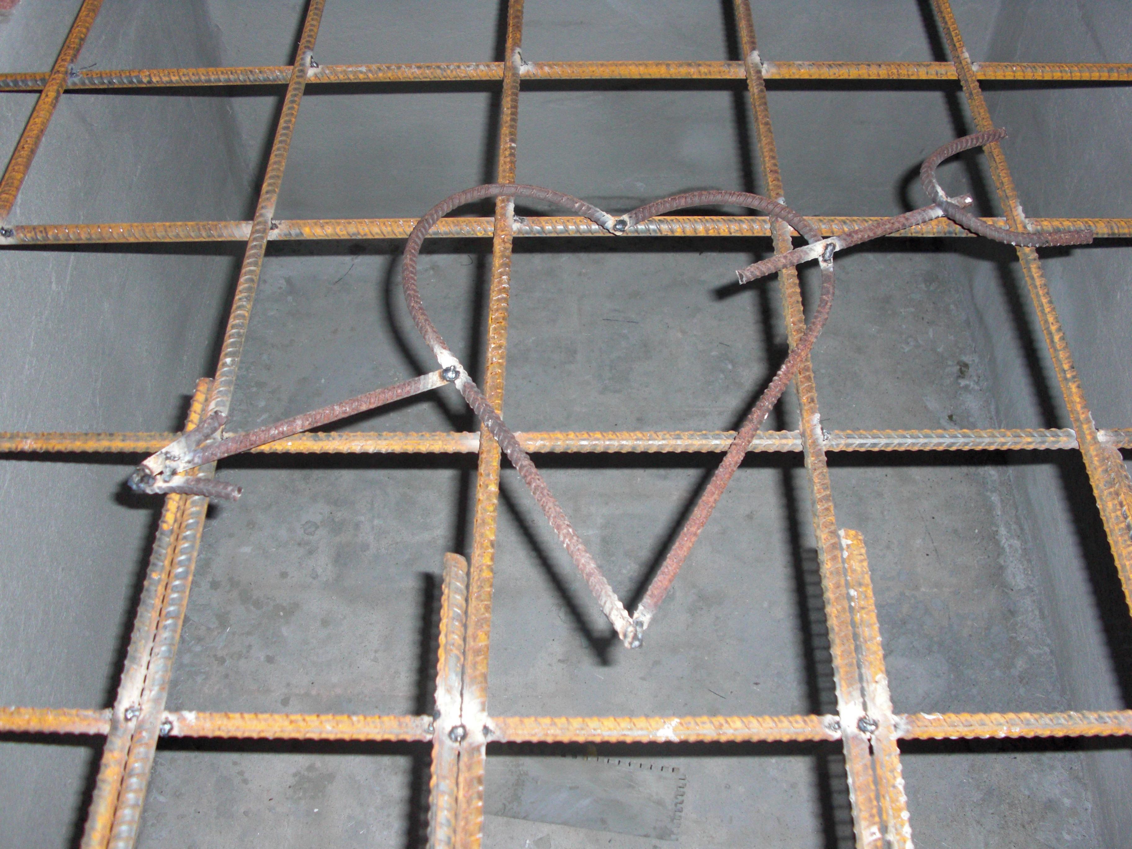

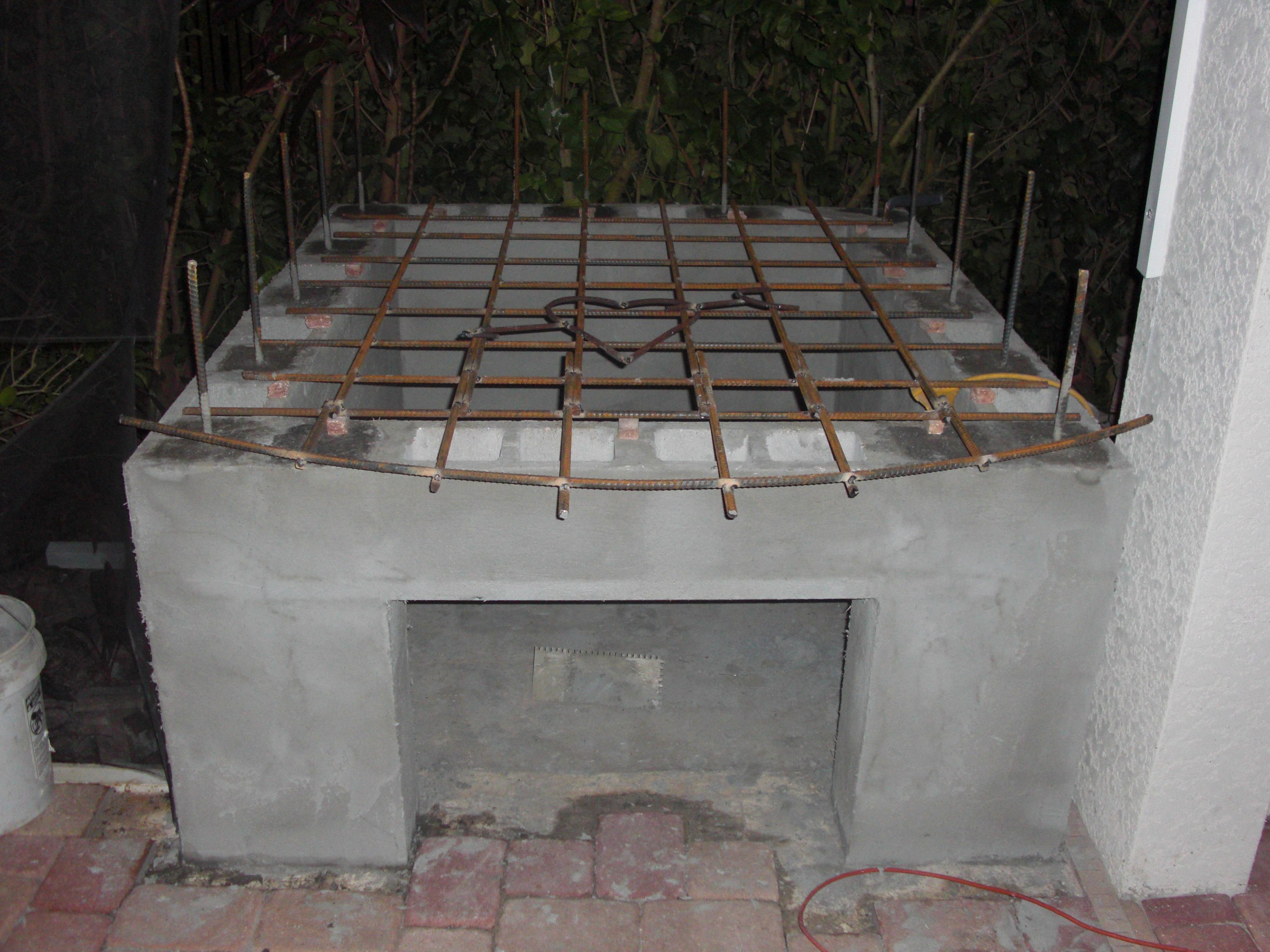

                          Build day Five part two,
                          I remembered that I decided to stay out late, fight the bugs and get the rebar done since it supposed to rain inches the next day.
ID:	272770 Rebar complete

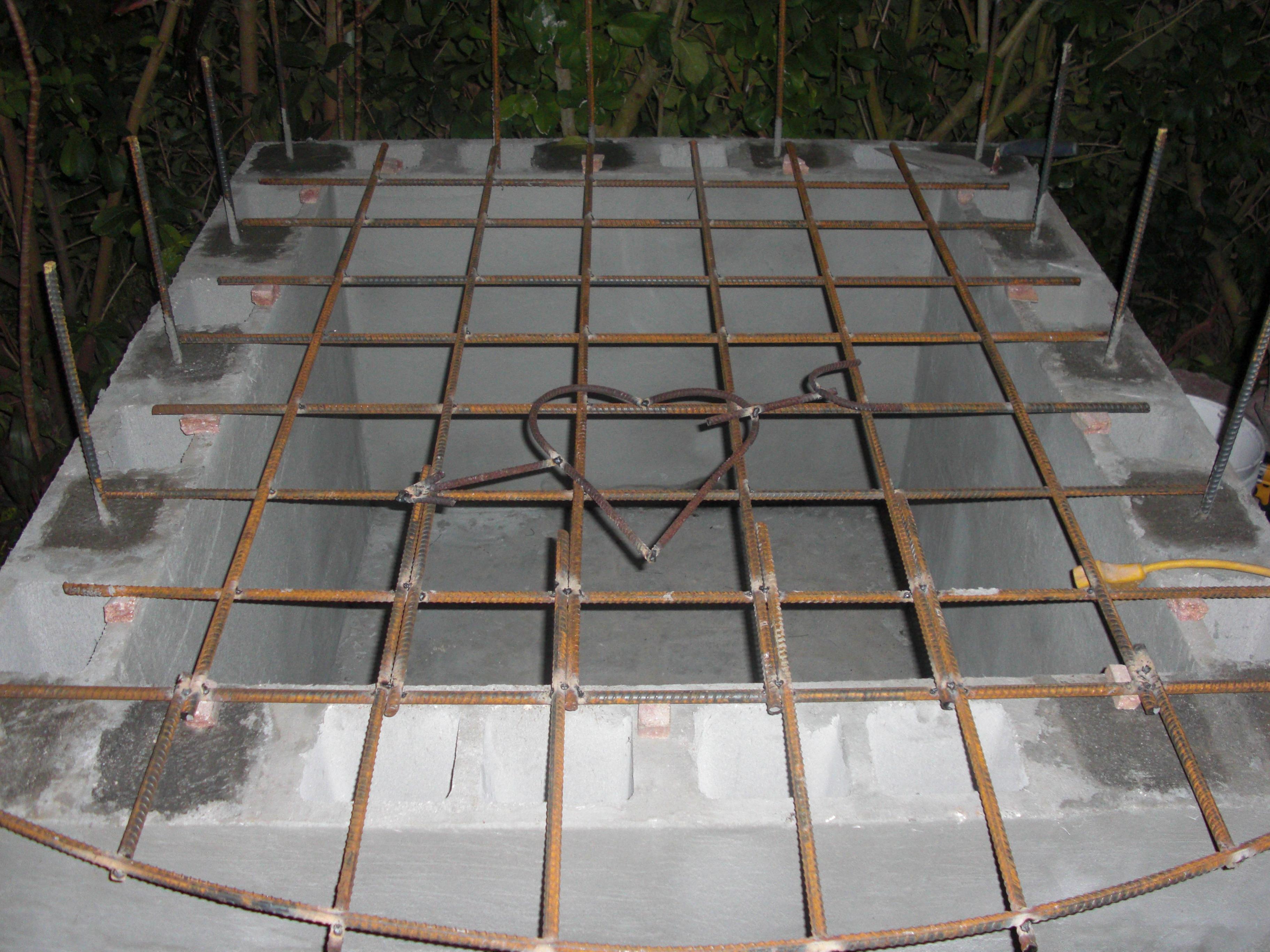

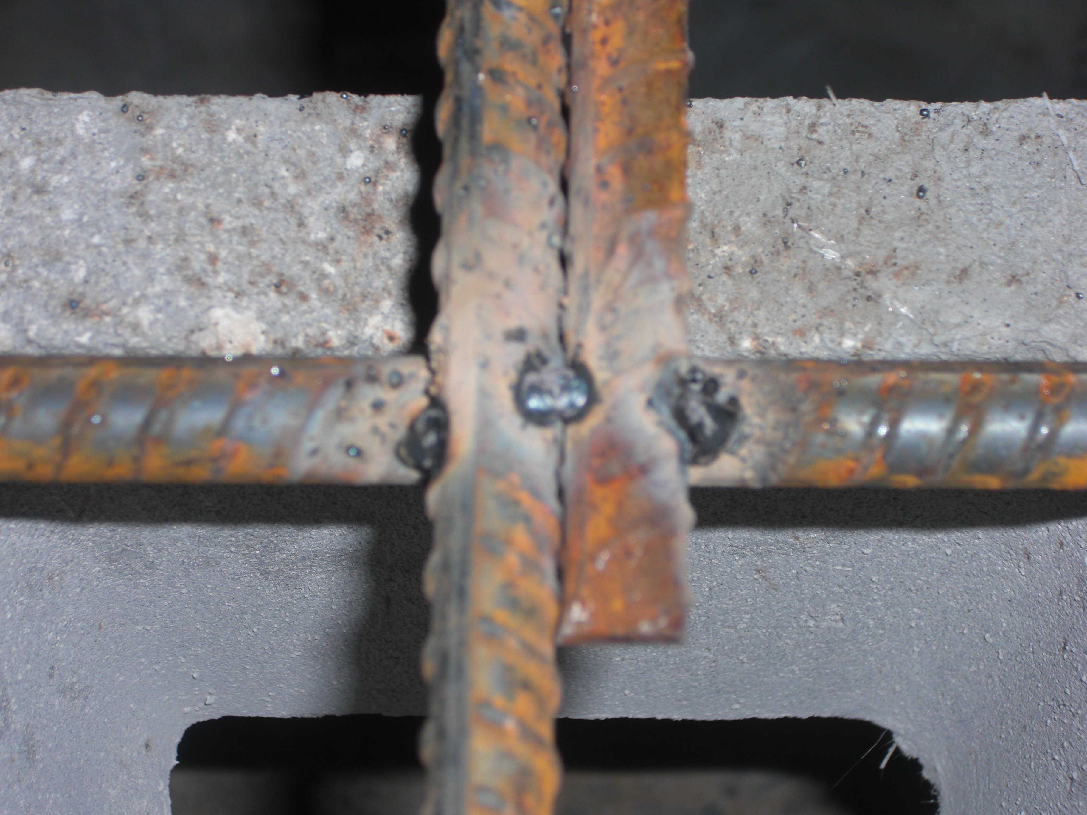

ID:	272771 Yes I welded them. I could have wire tied them but hey, never pass up the opportunity to use ALL of your tools
ID:	272772Talk about making pizza with love! I was tired and getting silly.
ID:	272773 Ready for form boards and concrete!
                          Bill,

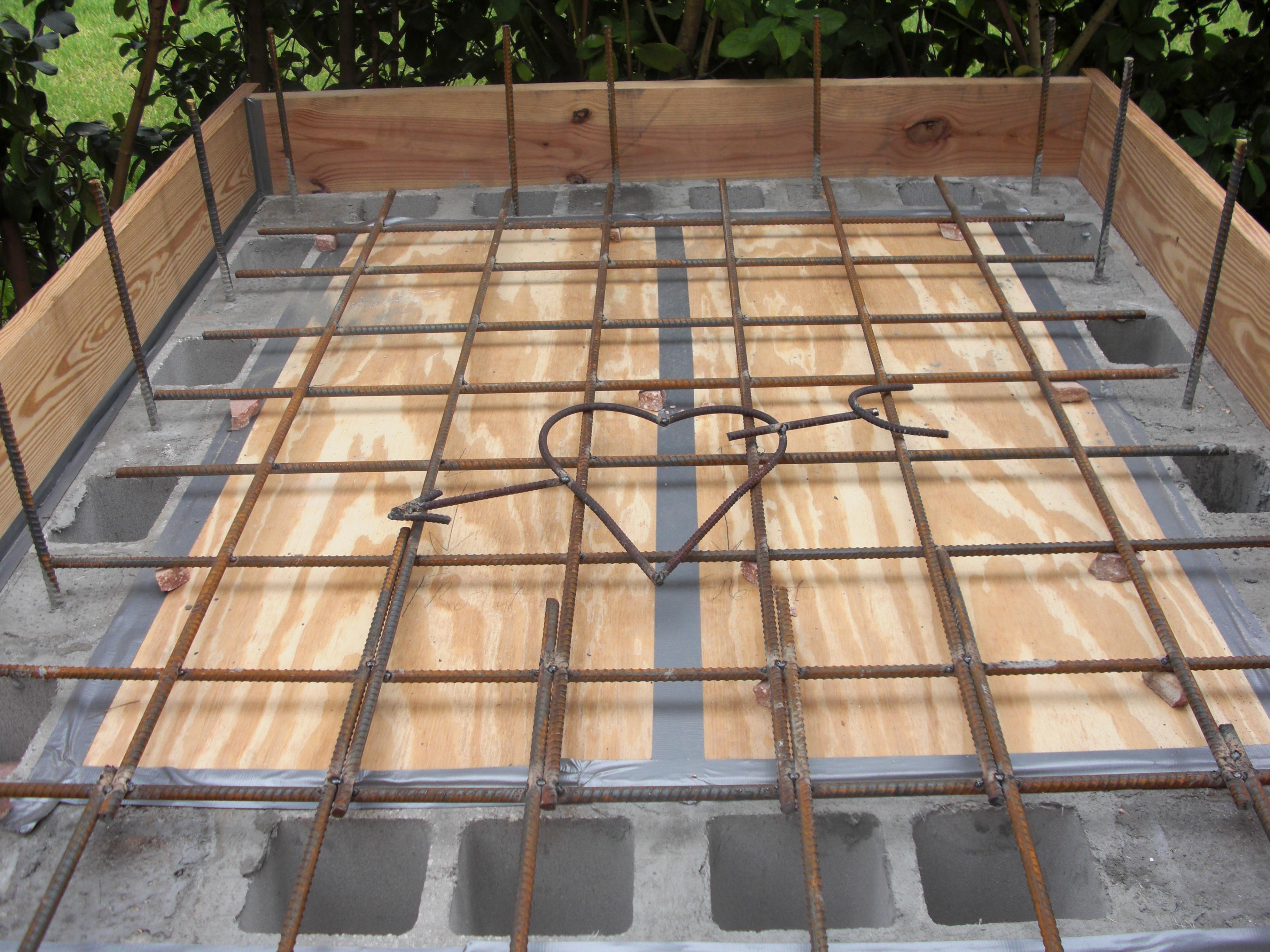

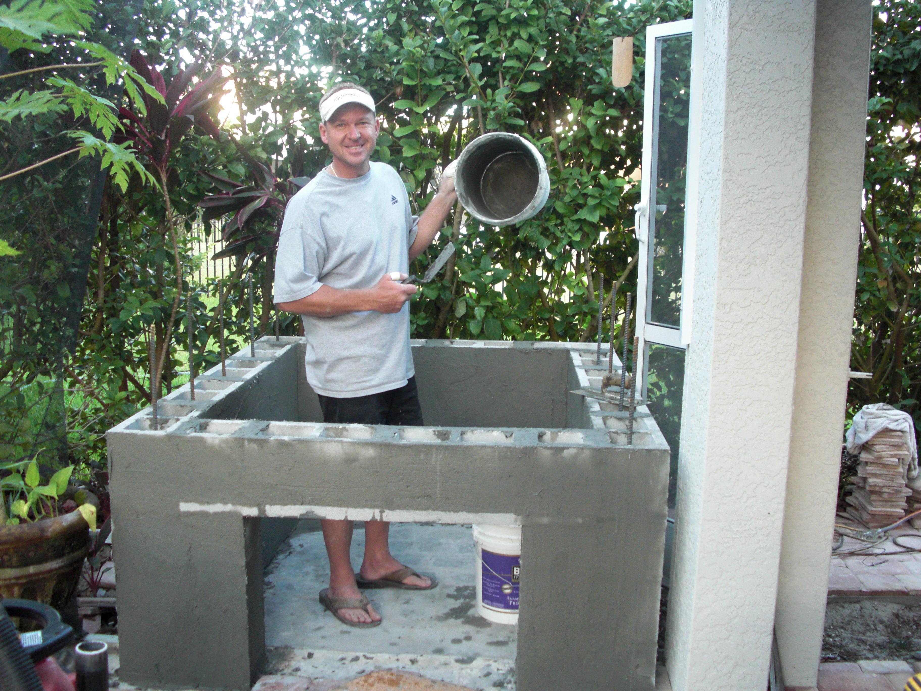

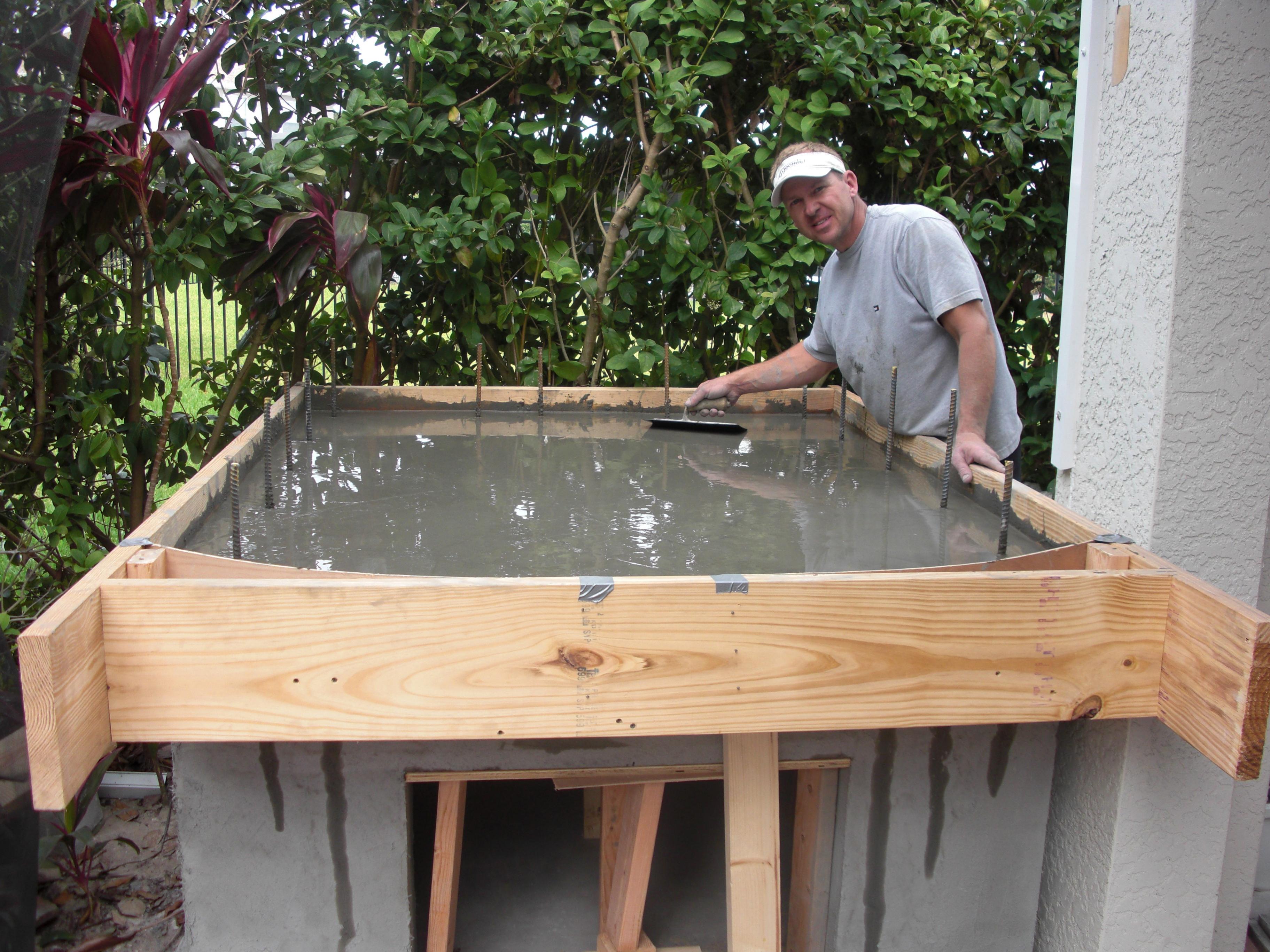

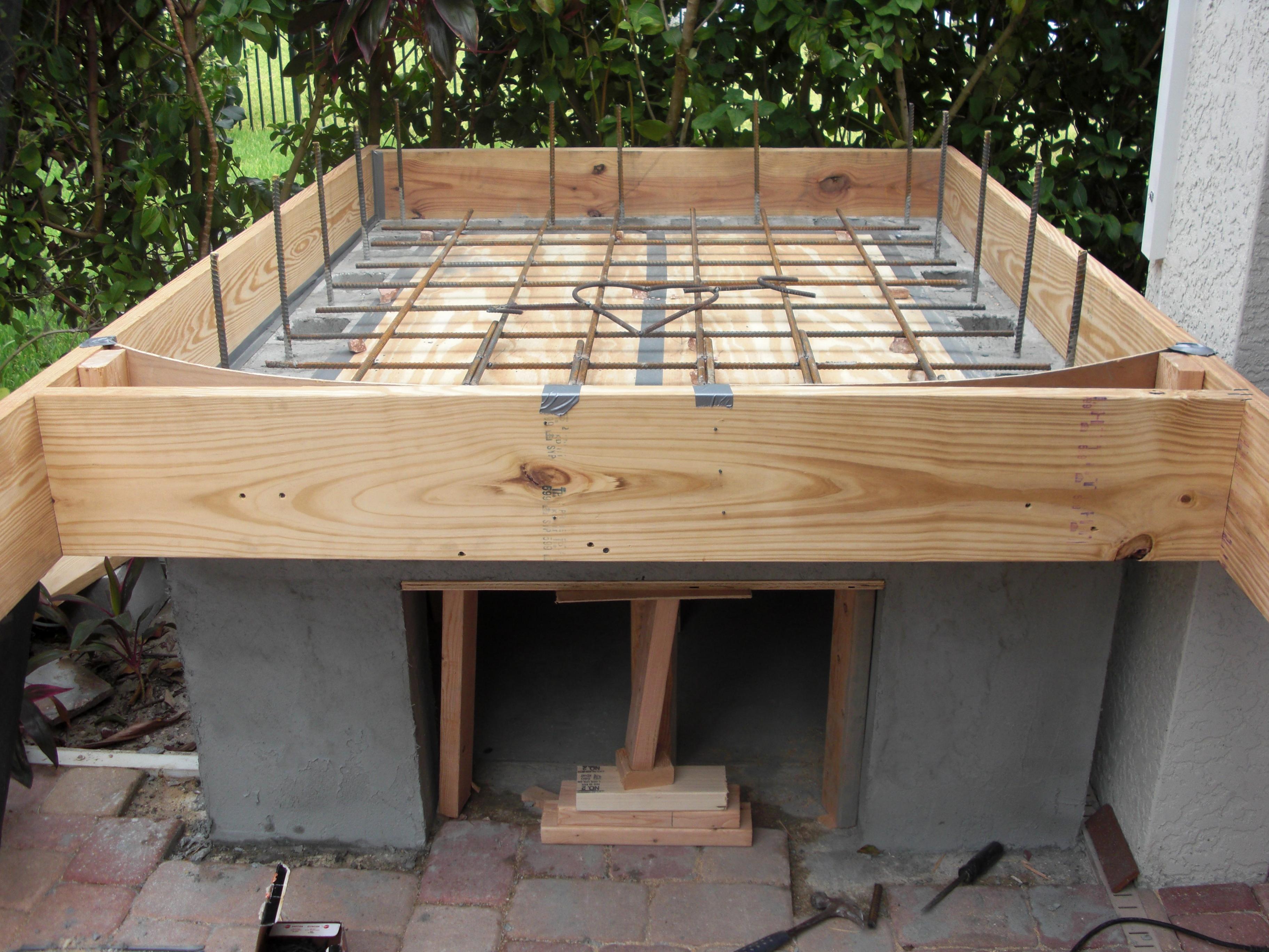

                            #14

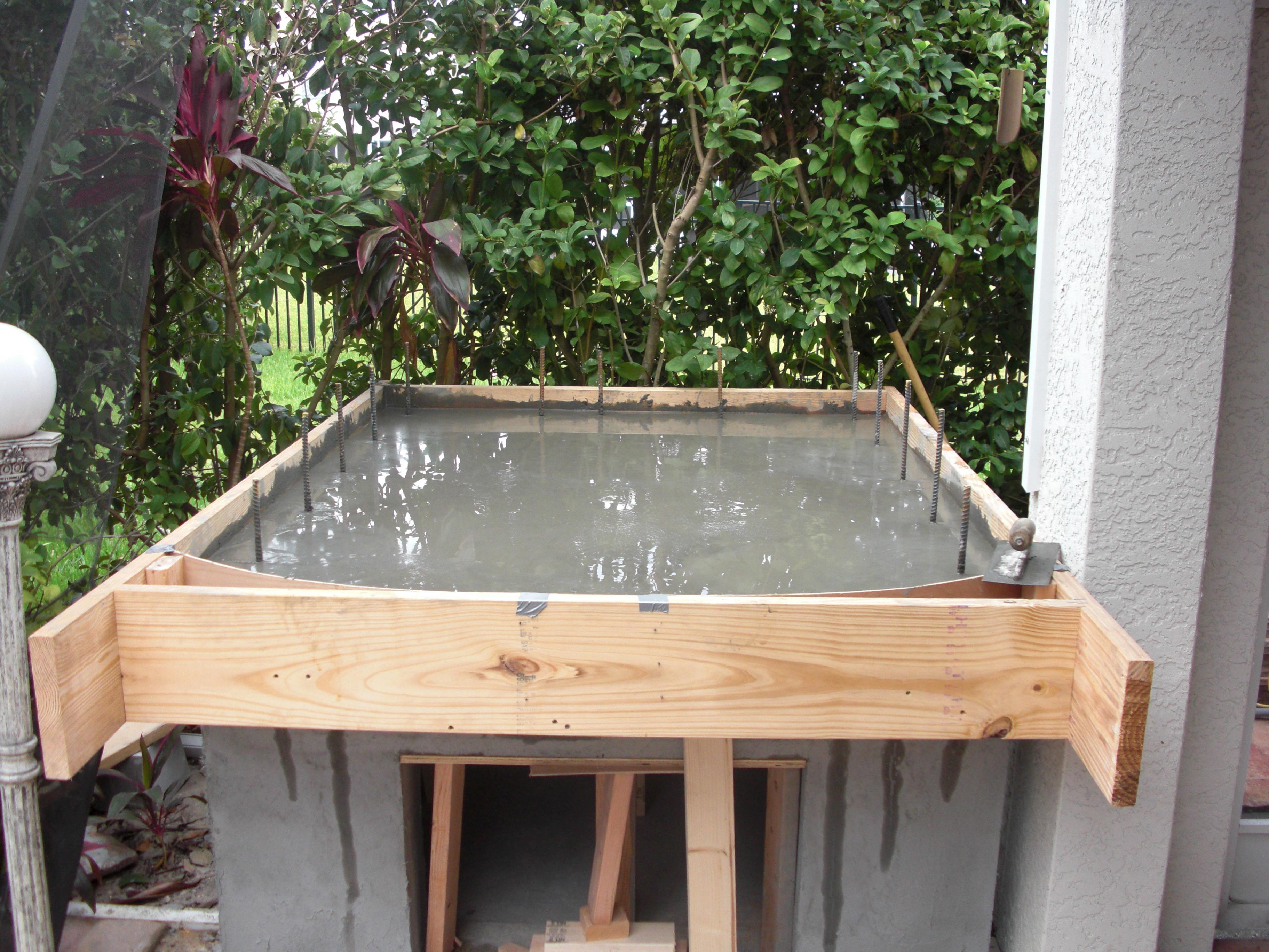

                            BIG DAY;
                            I got up early and got the form boards up.
ID:	272774;Click image for larger version
ID:	272776 Got off work a little early, mixed the cement and putting the final touches on it. (cheesy photo op smile)
ID:	272777 Done! Here comes the storm!!!
ID:	272778 Boy Scouts paid off! Boy did it rain; we received at least 2 inches...
                            I'm done until Saturday; then it's Vermiculite time!

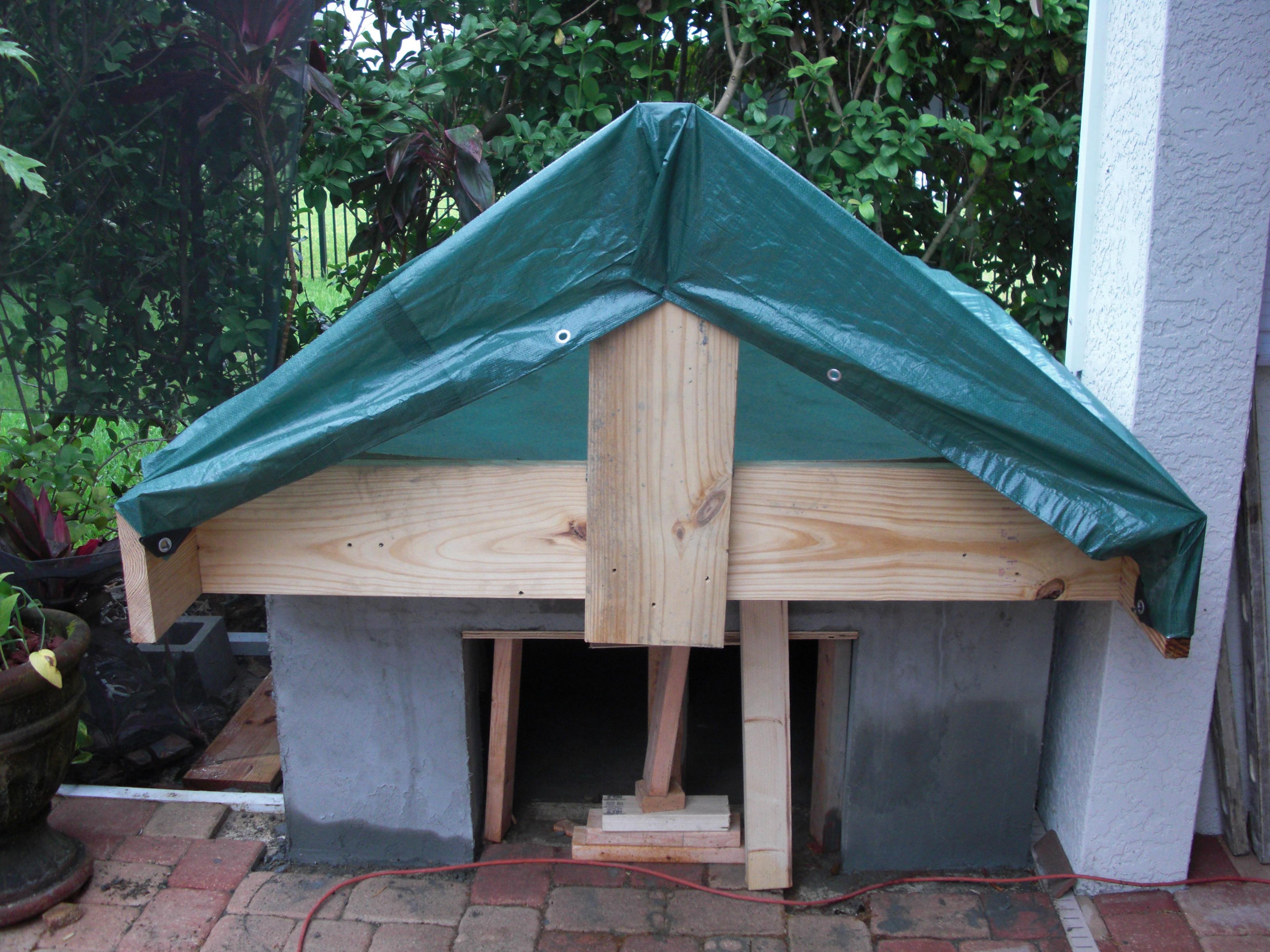

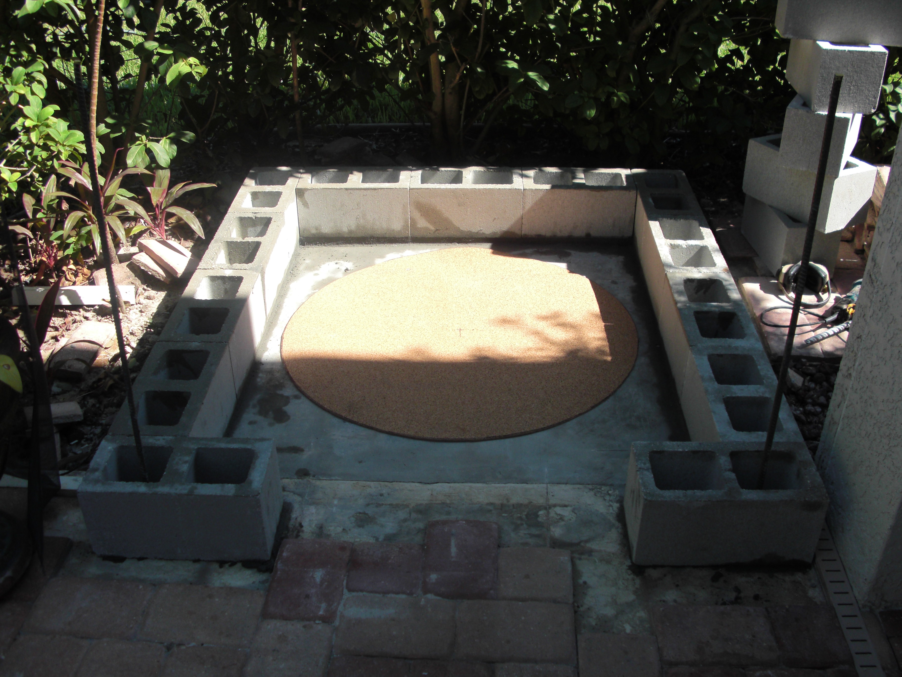

                              #15
                              Saturday the 25th;
                              [ATTACH]9450[/ATTACH] This is actually Friday evening on the 24th. The tent worked perfectly! Curing nicely and staying dry.
                              [ATTACH]9451[/ATTACH] That night I formed the base, mixed the Vermiculite, and called it a night. 4.5" of vermicucrete! Saturday it was strong enough to remove the form boards. I was too tired to take any pics during but it went smoothly. The vermiculite mixed easy; just weird stuff. I expected it to be more like screed mud but instead it felt a little rubbery.
                              [ATTACH]9452[/ATTACH] Concrete going in around vermiculite. Deciding on which stone to use on the base. I'm leaning to the one on the right.
                              [ATTACH]9453[/ATTACH] All the cement is in, troweled, and ready for a nice curing.
                              [ATTACH]9454[/ATTACH] Done, heading in.
