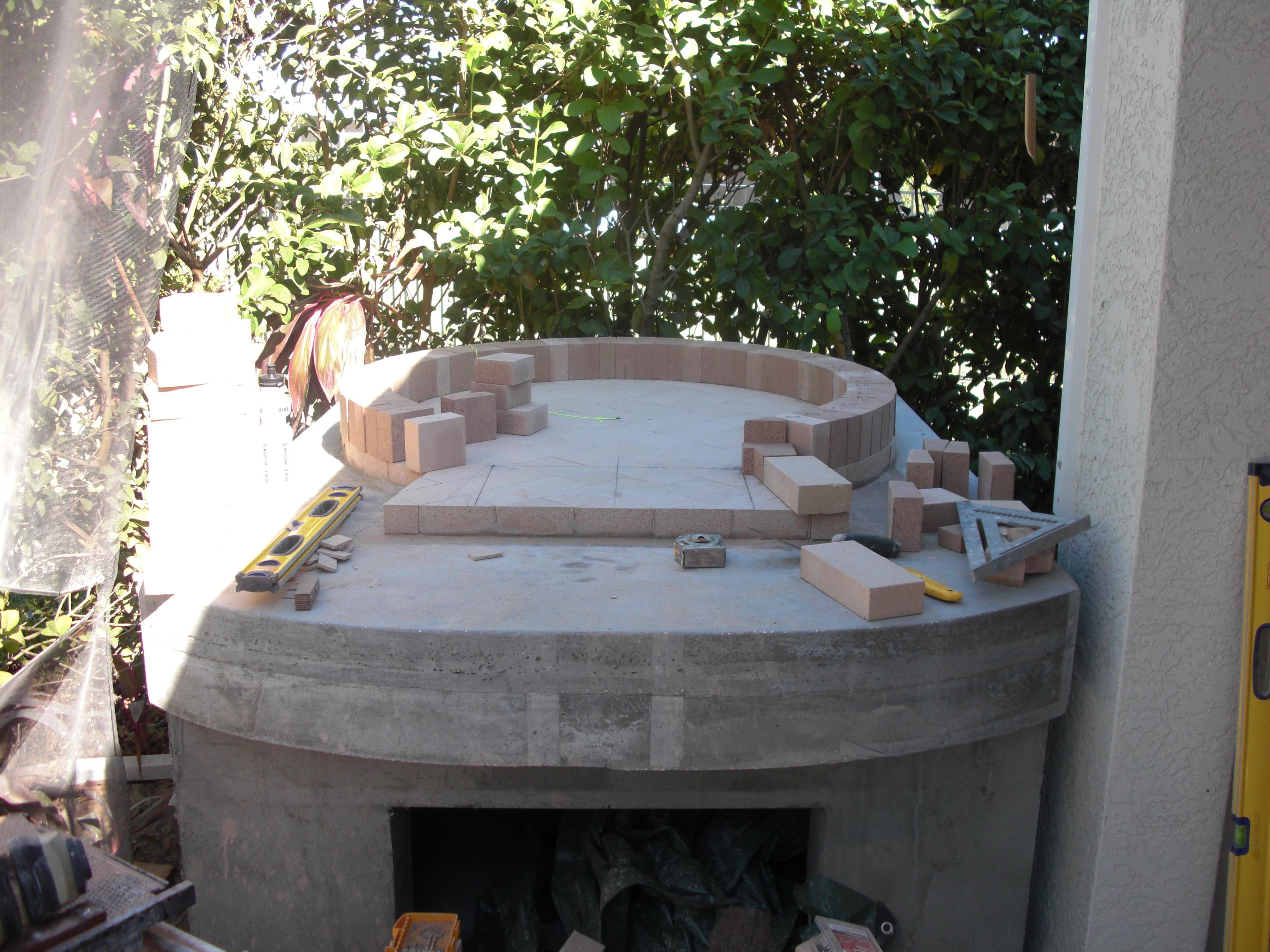

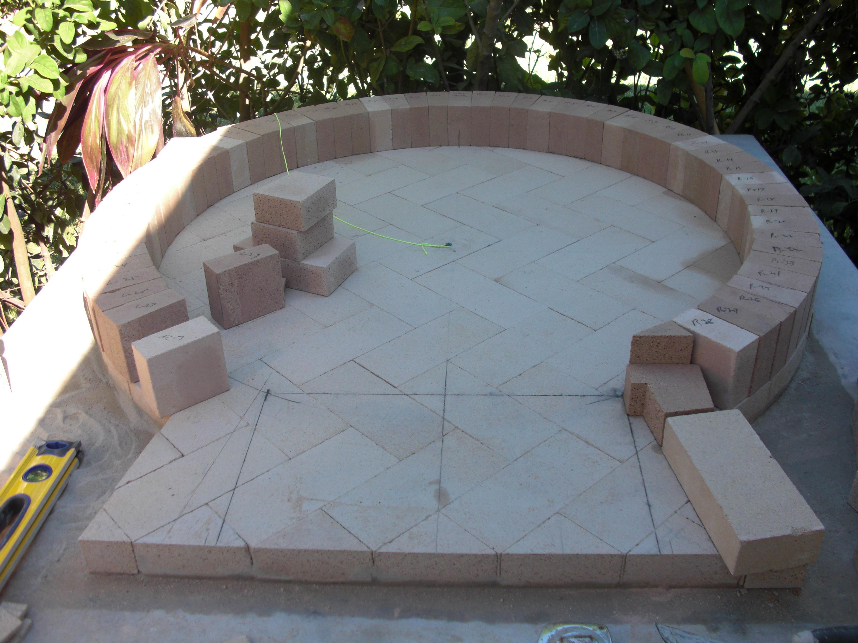

[ATTACH]9455[/ATTACH] Did I mention how much I dislike this time of year when it get's dark so early? I managed to get the floor layed out, cut, and leveled. I used the 1:1 mix of fireclay and sand. I mixed it like thinset but let me tell you those bricks suck the water out of it soooo fast you need to have your level on top of it immediately! I also picked up a few new levels. I was wondering why my old level was never consistent...One side was level, the other side was off a quarter bubble... And I thought it was me...

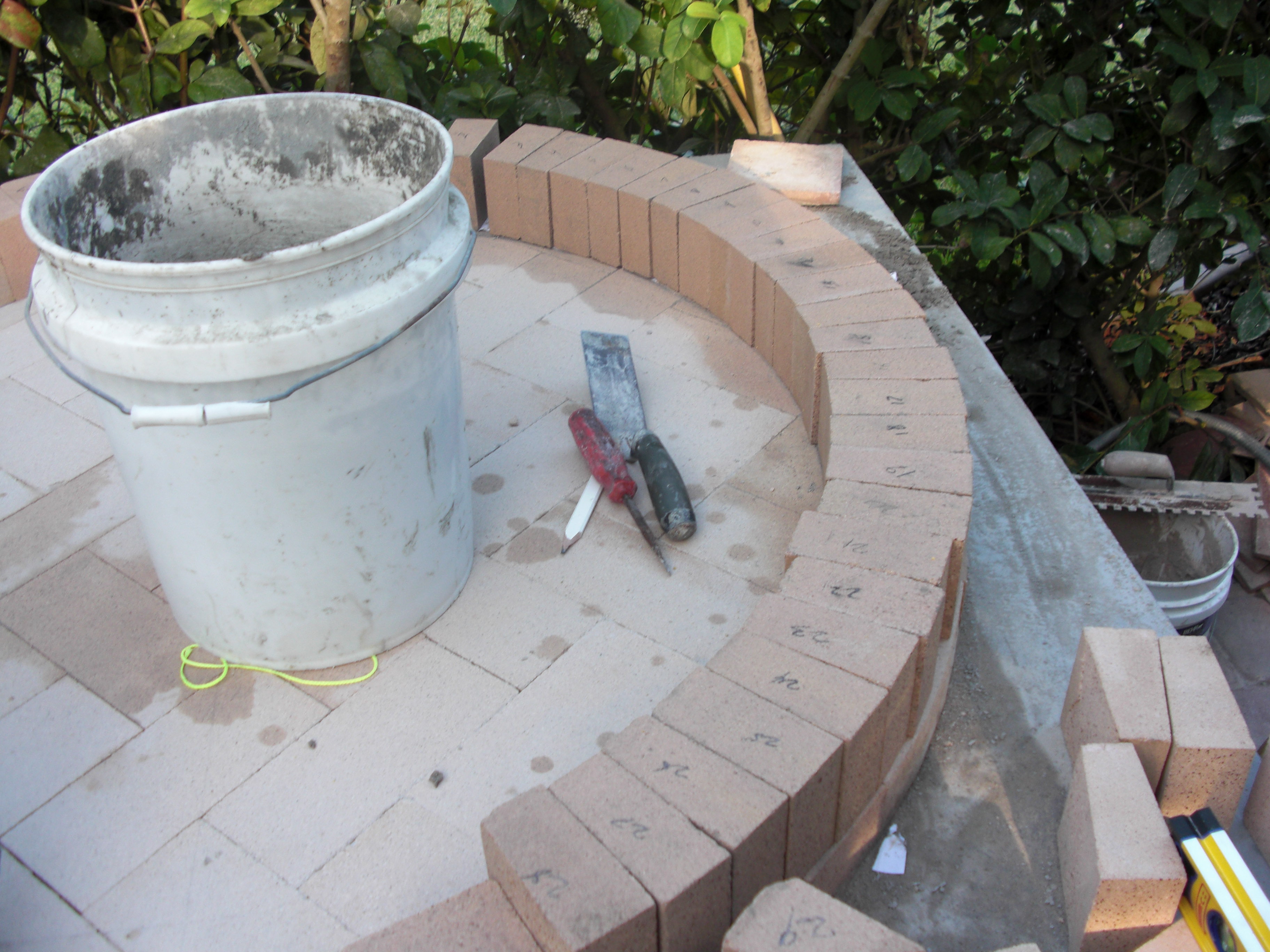

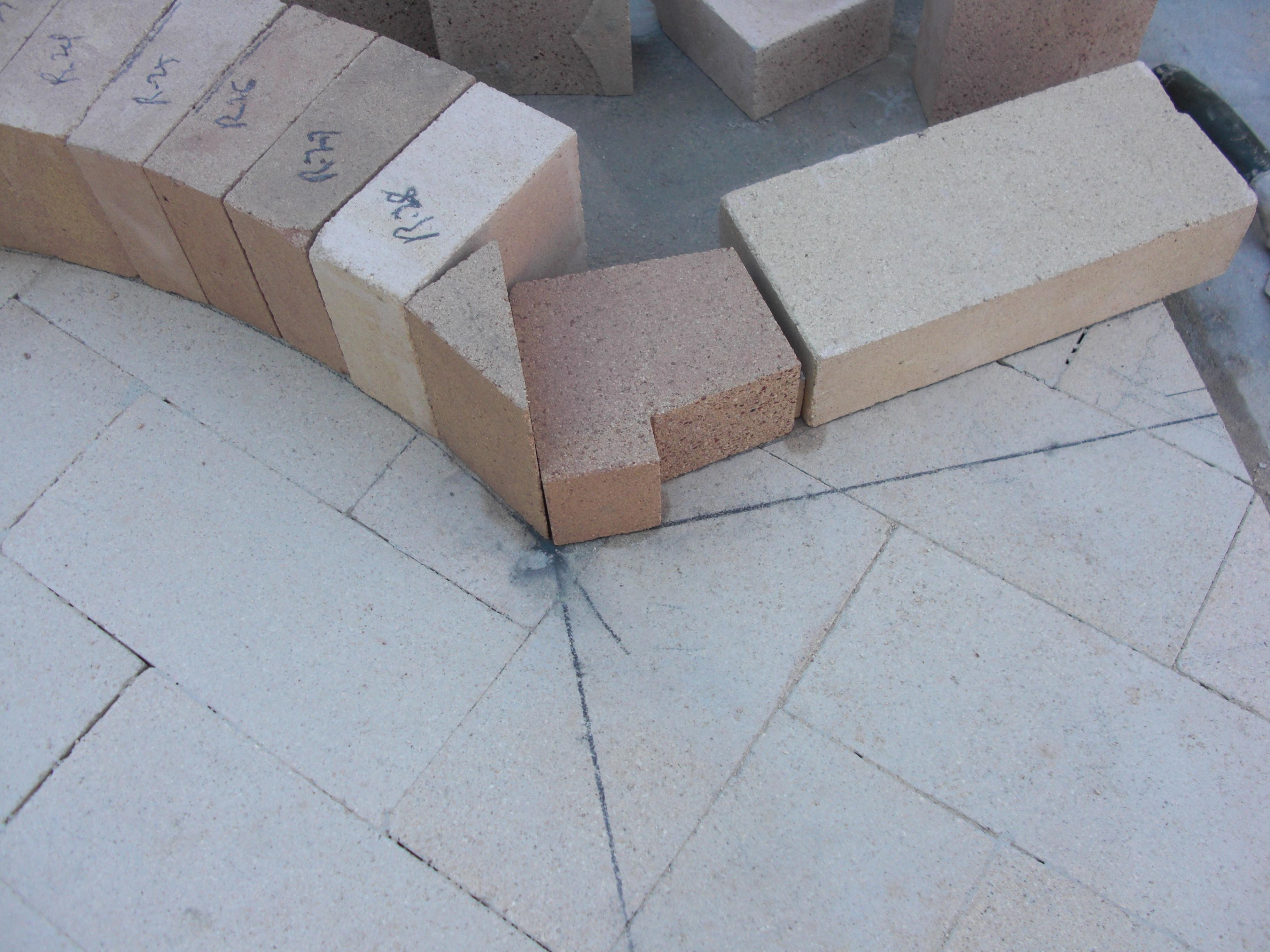

[ATTACH]9456[/ATTACH] I cut the first course and made a make shift gage to help keep me round and pitched correctly.
[ATTACH]9457[/ATTACH] Closer shot of the gage and floor.

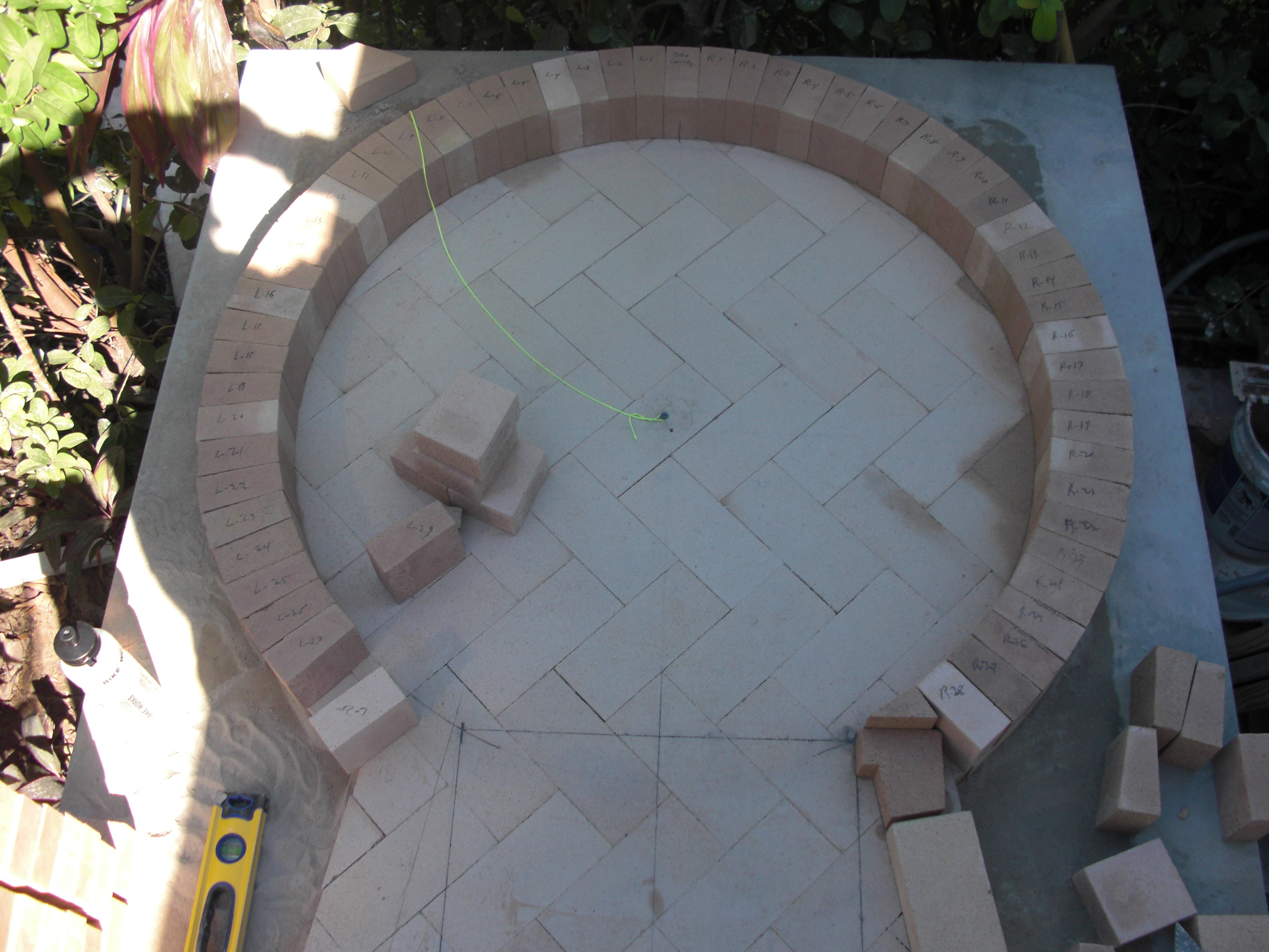

[ATTACH]9458[/ATTACH] I decided to call this MOAH. Mother Of All Hearths! Holy crap that thing is huge
. I guess I could use it for a bunker if we get a hurricane this way
. I may still use it but I placed the tried and true string to help with the angle cuts.
. Easily resolved by placing an uncut half brick every Fourth spot. I kind of like it now so I'll just say I planned it that way.
