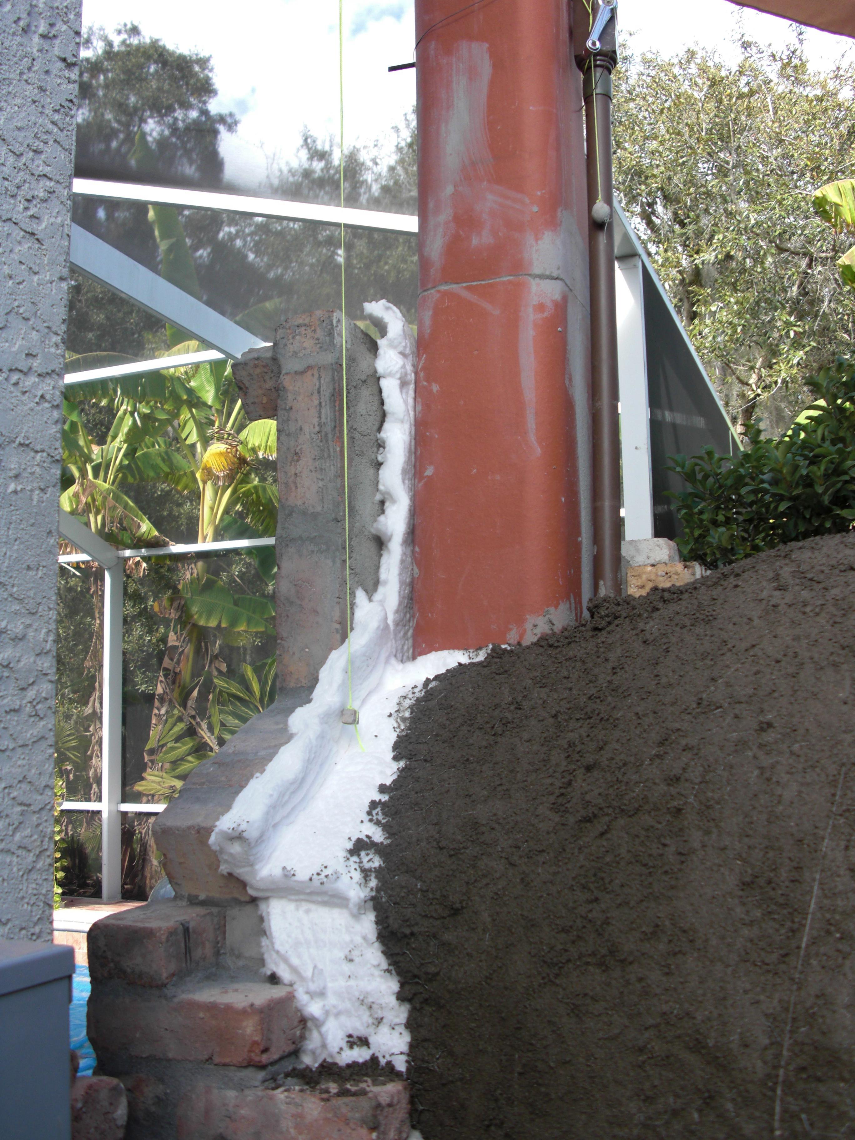

              A few more shots.
Name:	Misc December 2008 025.jpg
ID:	273752 Vermiculite going on. Love getting my hands dirty.

ID:	273754 Brick work is getting close to being done. Well at least what I want to get done by Saturday. Surprisingly, the vermiculite was not even warm when the oven was at 500f last night. Very impressed so far.

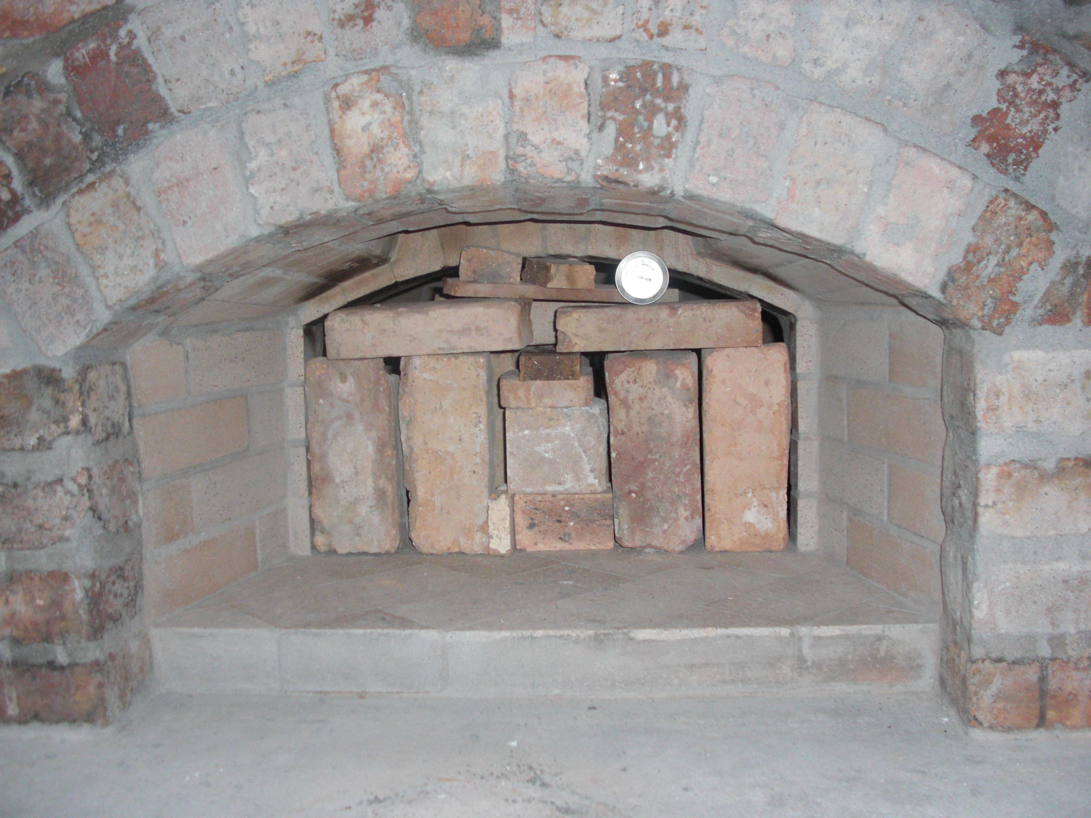

                12-9-08
                Just a quick post. The oven temp is at 175-ish. It's been sitting with this make shift door since Sunday night with no additional fireing. I'm going to assume that it's doing it's job right?
ID:	273763 Here's my super cool door!
ID:	273764 Still around 170-175f after shutting down Sunday night at 500f. Way cool.

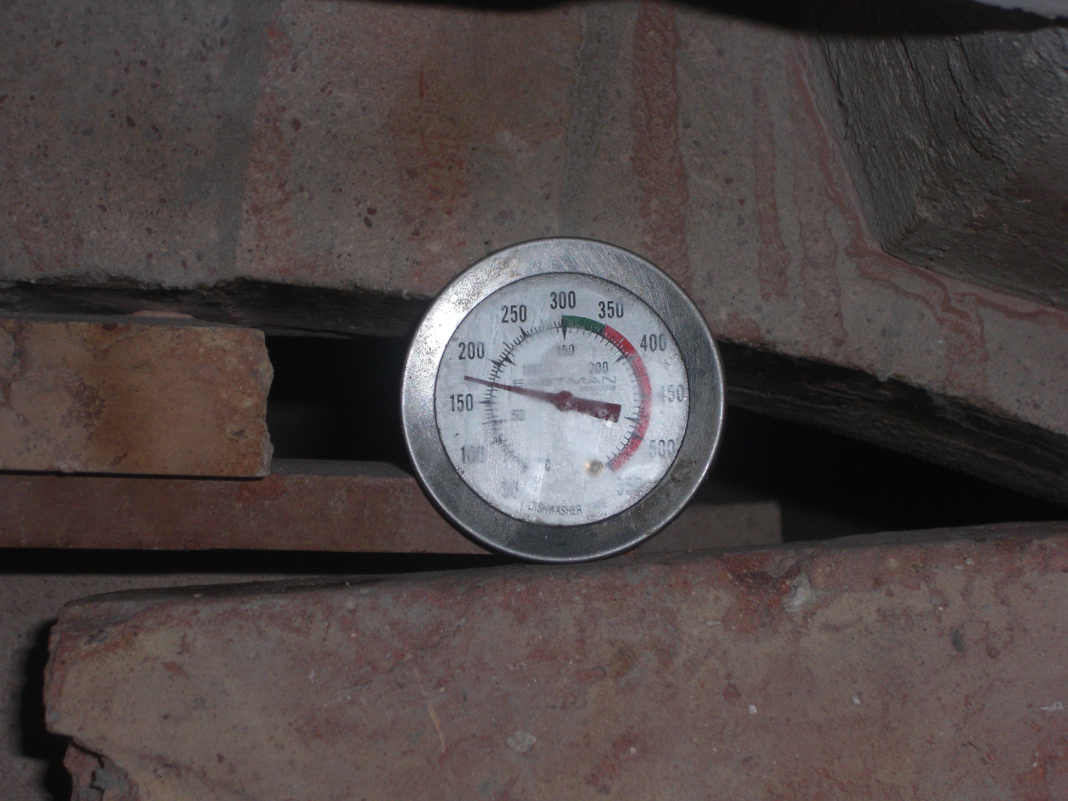

                        Bill - Are you sure your thermometer is still alive? could you have gotten it too hot and damaged it?

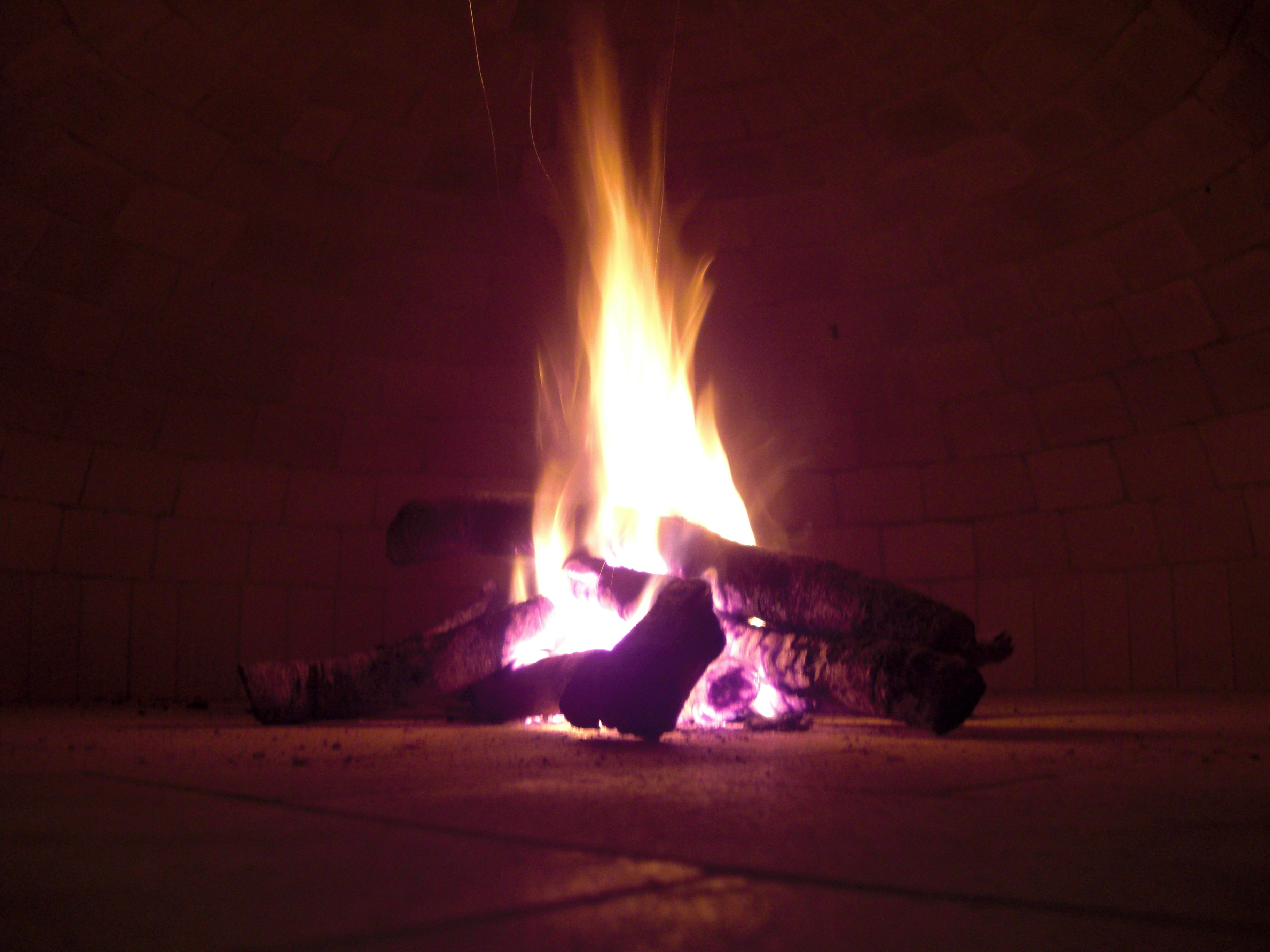

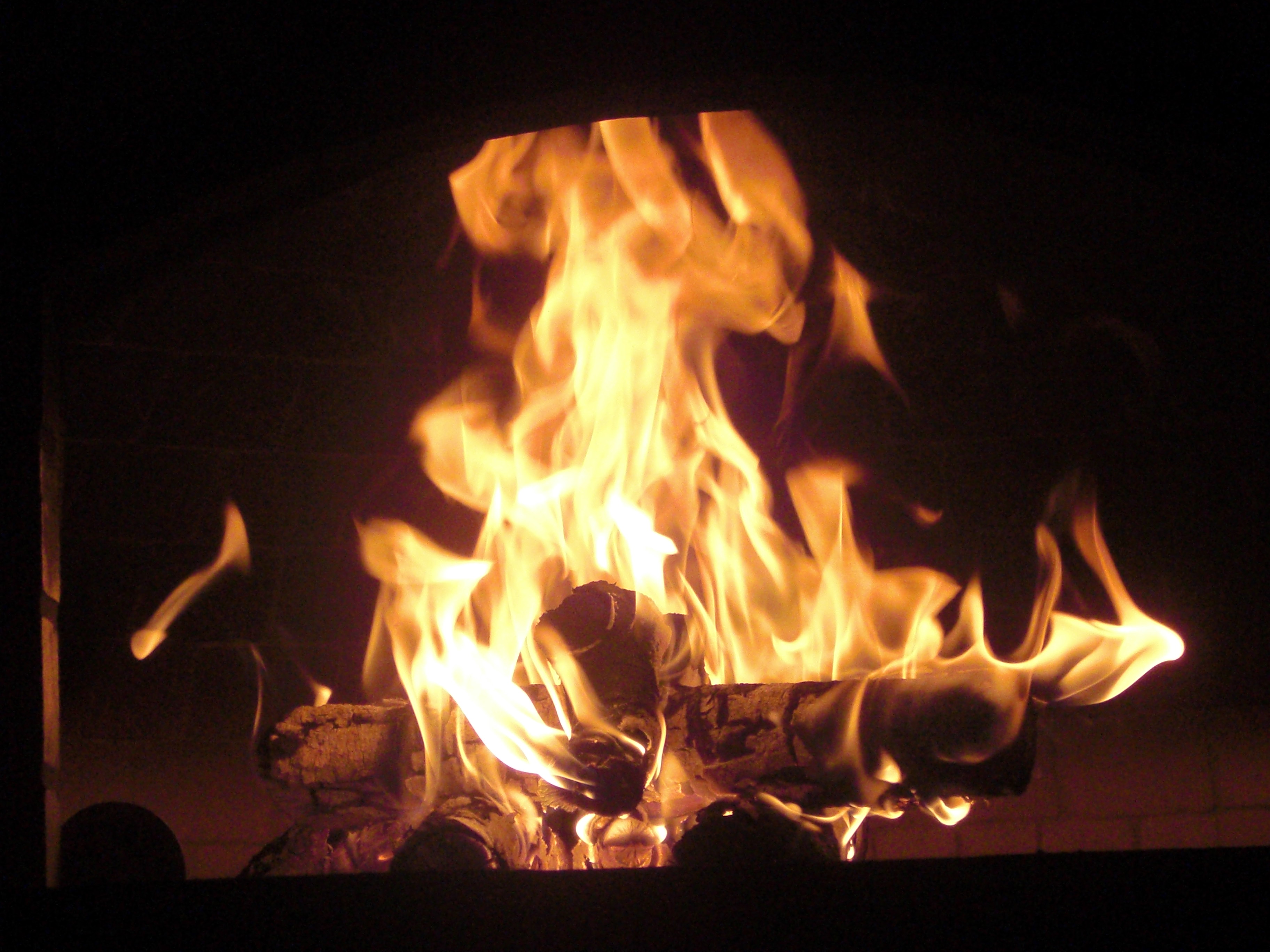

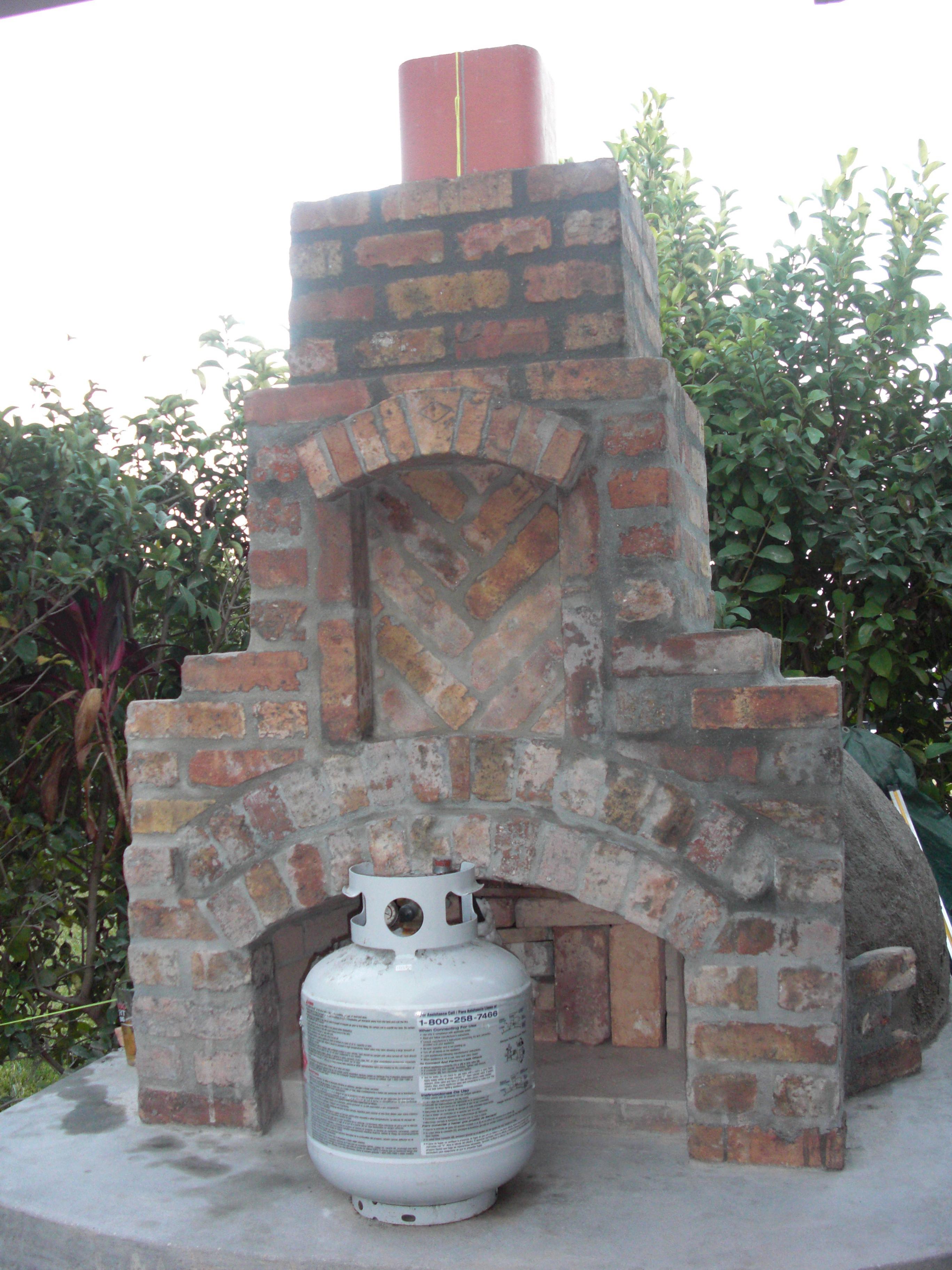

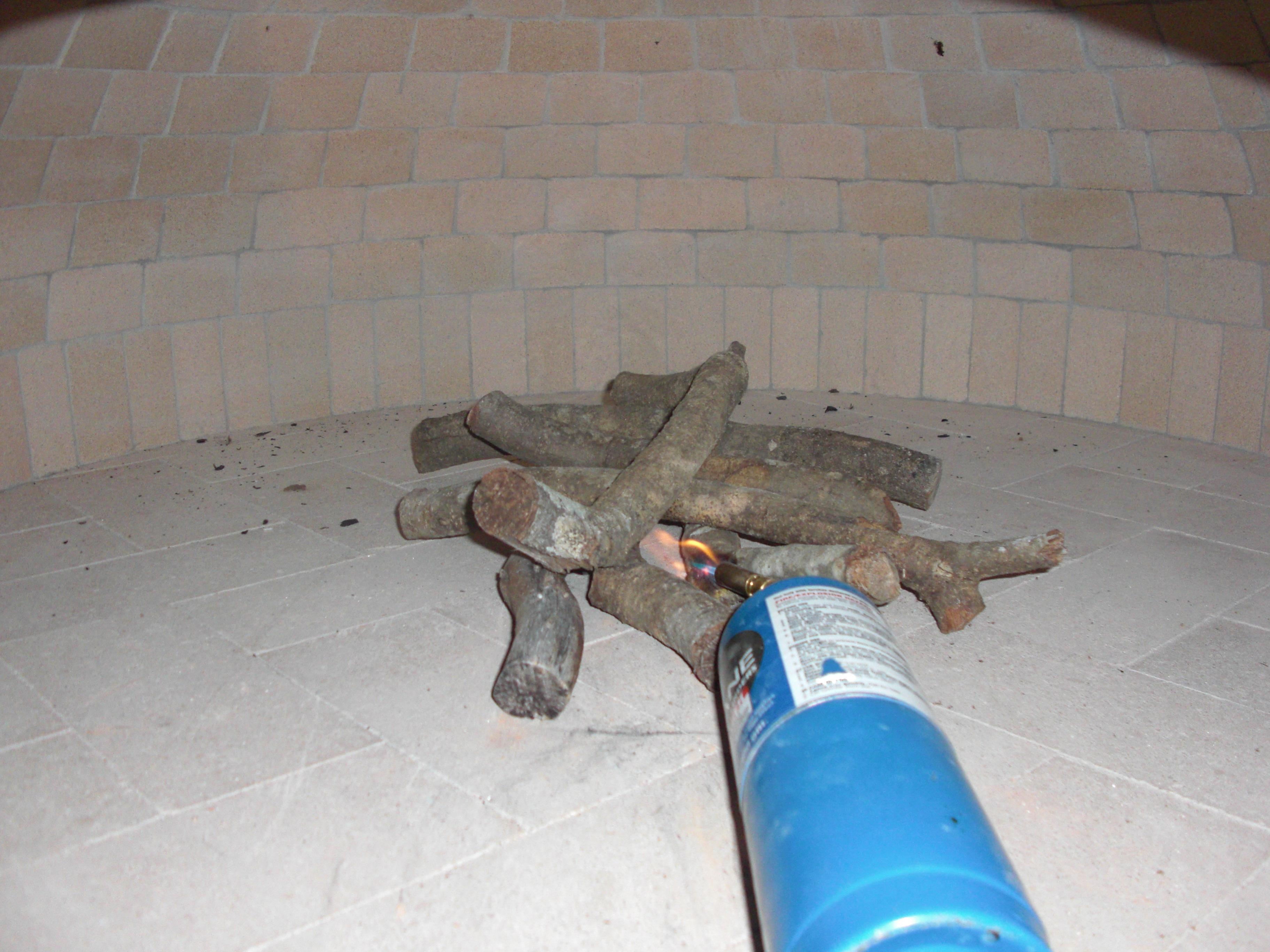

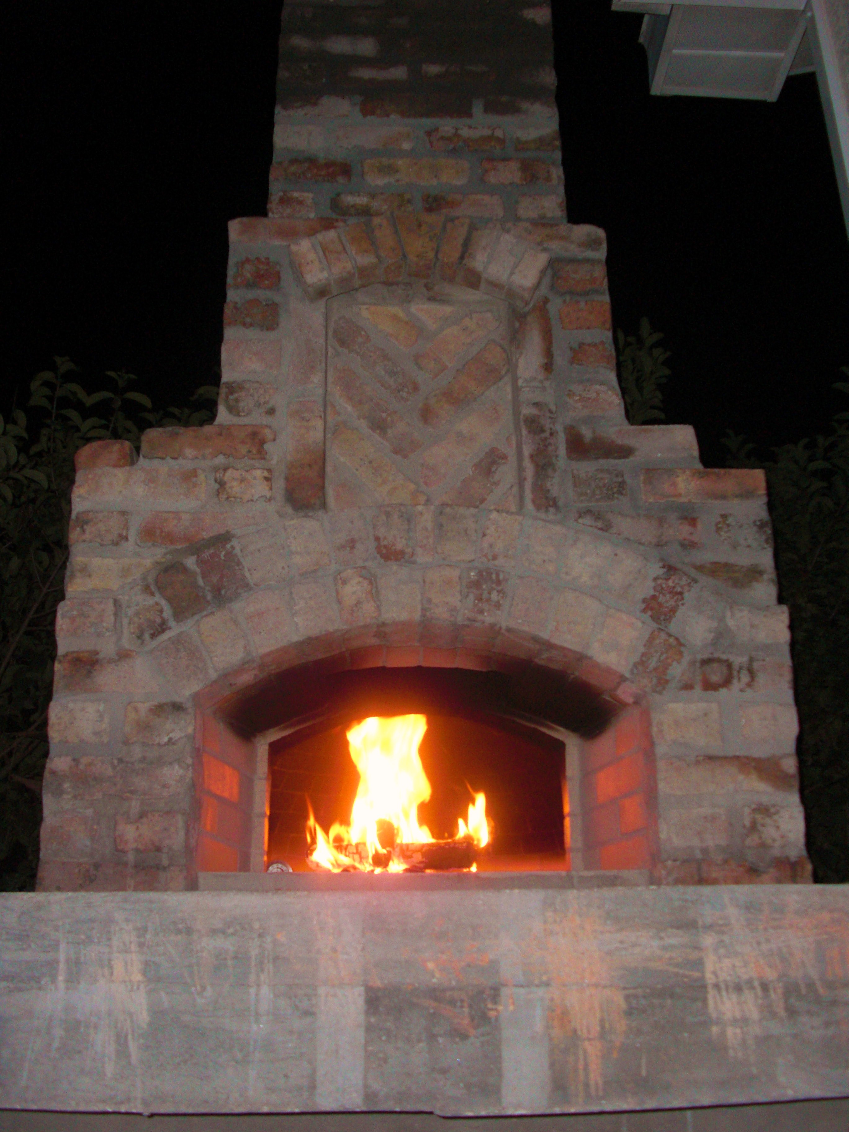

                            Yes I made sure the thermo works ok. I took it out to check along with inserting a digital thermo afterwords and it's right on. Is what I'm seeing out of the norm? Below I have pics of my fist wood fire: I just got in and it's 12:15am...NOT ME!
Name:	First Fire 12-09-08 001.jpg
ID:	273771 The first fire
Name:	First Fire 12-09-08 008.JPG
ID:	273772 Slowly starting to grow
Name:	First Fire 12-09-08 017.JPG
ID:	273773 Nice flame! Inside temps were about 600f, top third of dome was white after a short while
Name:	First Fire 12-09-08 015.JPG
ID:	273774 Finished all the chimney except the acid wash and the spark arrester.

                              Wonderful! I really like the brick facade! -
                              I honestly thought you'd be making pizzas for your friends in just a completed dome - not fully completed and washed oven!!!
                              It would also appear that you did a fine job with your insulation - very nice heat retention - I keep wanting to try to dry friut on the third day, but have not tried it yet. And as your oven continues to dry out, performance could become even better.

                                Very cool chimney. I love the brick.
