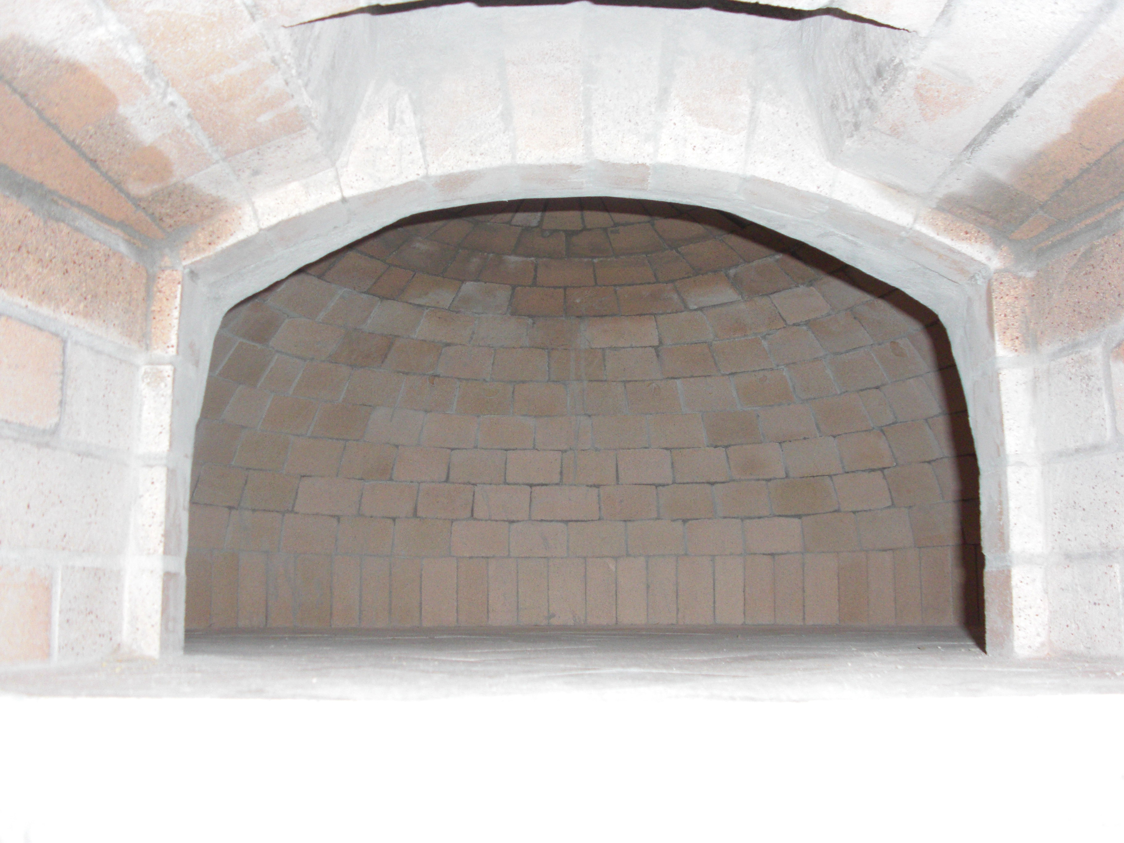

          #139
          11-26-08
          Dome progress.
Name:	Thanksgiving 08 023.jpg

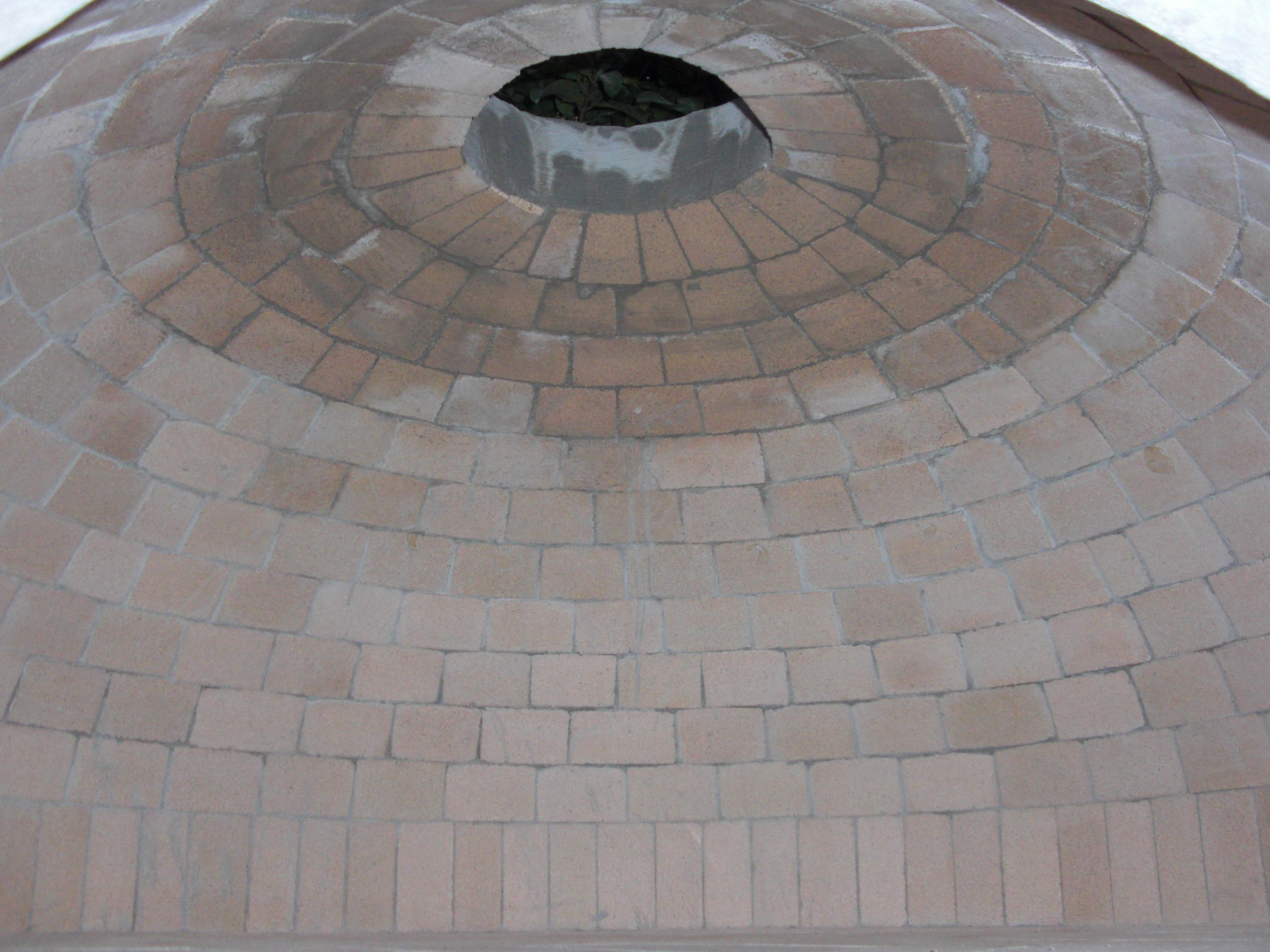

ID:	273168 With the exception of the keystone the dome is complete.
Name:	Thanksgiving 08 025.JPG
ID:	273169 Entry shot
Name:	Thanksgiving 08 029.jpg
ID:	273170 Looking up. I have some "I wish I wouldn't have set those" bricks up there... I have some cleaning to do but for the most part I think it came out ok. No supports, forms, or braces used; just HS-50, one yellow string, and a little patience.

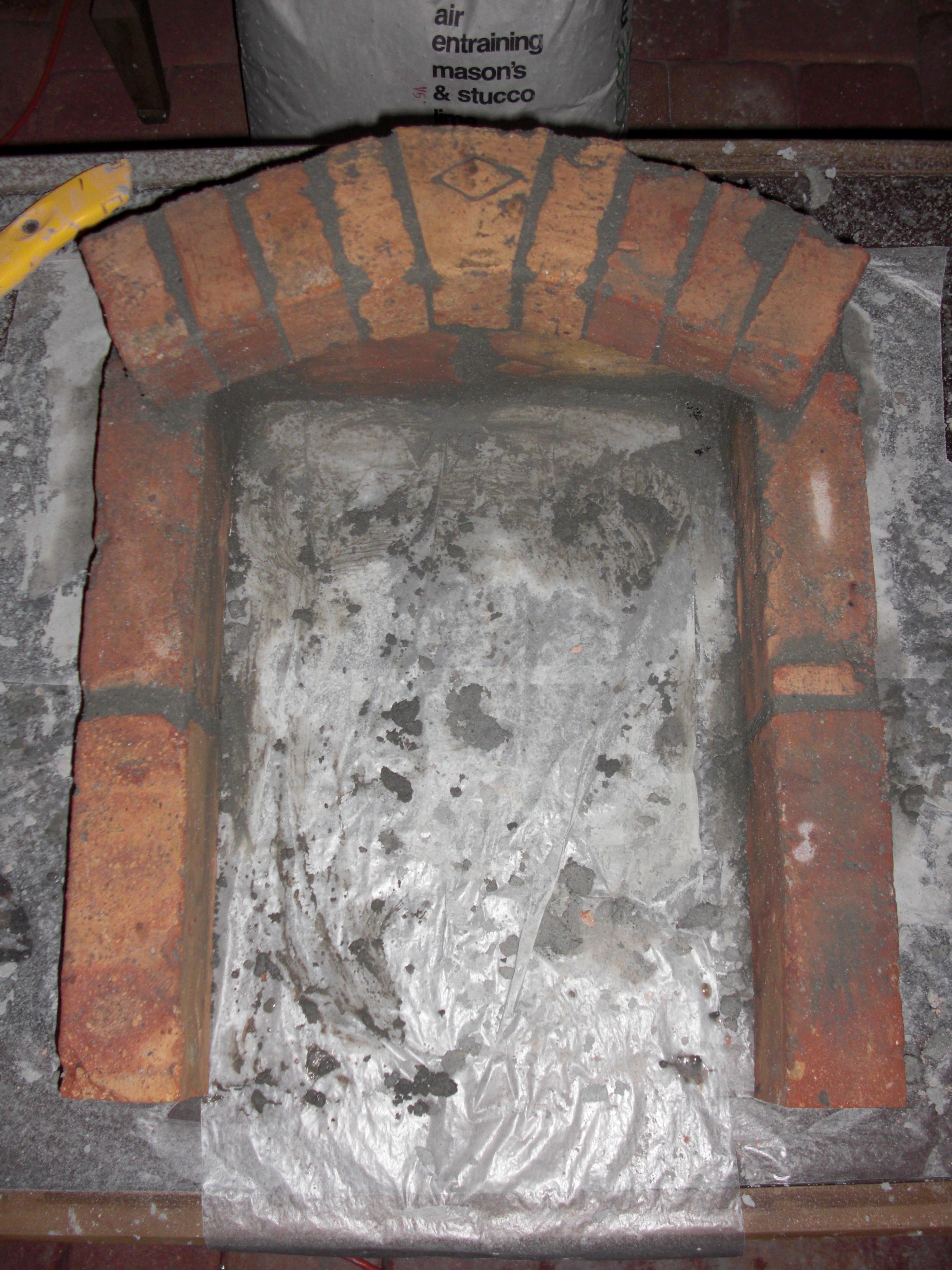

ID:	273173 Here is my cool feature... Hopefully it will work out as planned.

              Looking good BIll. The joins inside the dome look really neat, did you taper your bricks at all?
              Justin
              My 40" Oven progress http://www.fornobravo.com/forum/f8/j...peii-5495.html
              • Bandrasco
                • Oct 2008
                • 208
                #142
                Thanks Justin,
                I cut each brick to eliminate the gap as much as possible both front to back and top to bottom. I did not cut the bottom or top of the bricks that some do to adjust for the angle; I chose to use shims made out of fire brick when needed but mostly just HS-50 mortar.

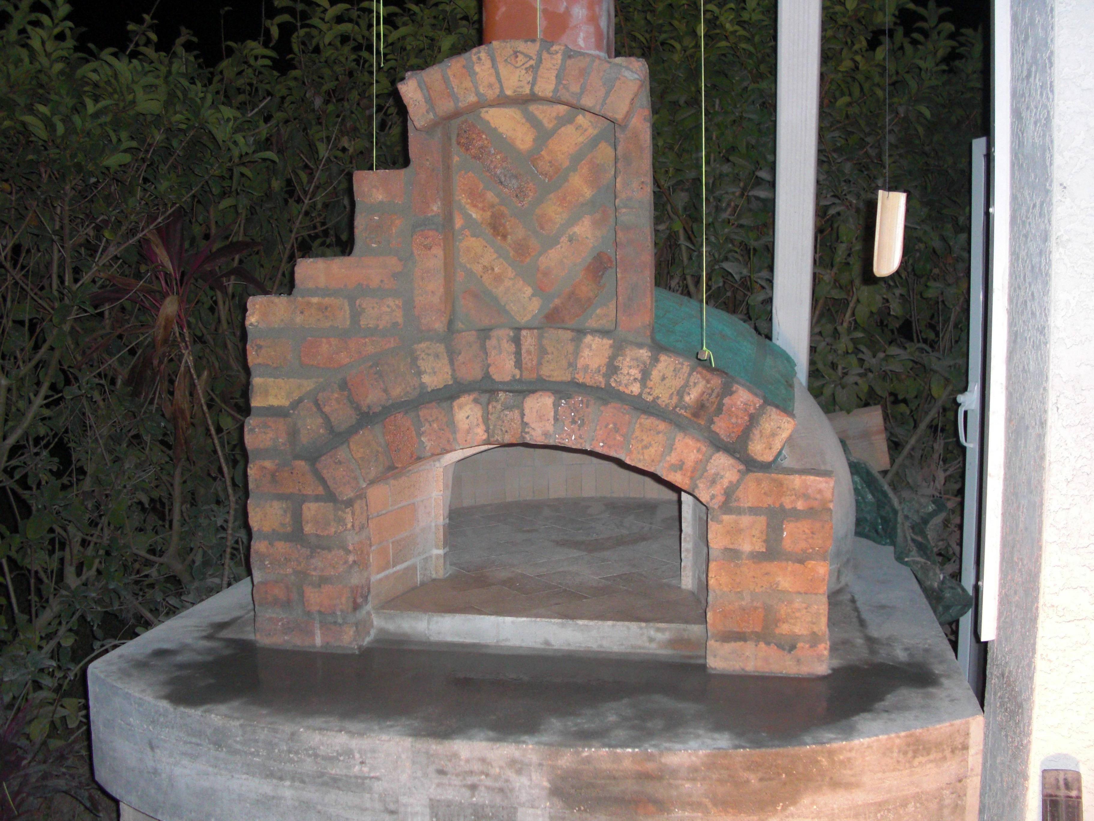

Name:	11-28-08 Pizza Oven 006.jpg
ID:	273623 Bricks looking good. I'm going for the old world look which isn't too difficult since they're all different sizes

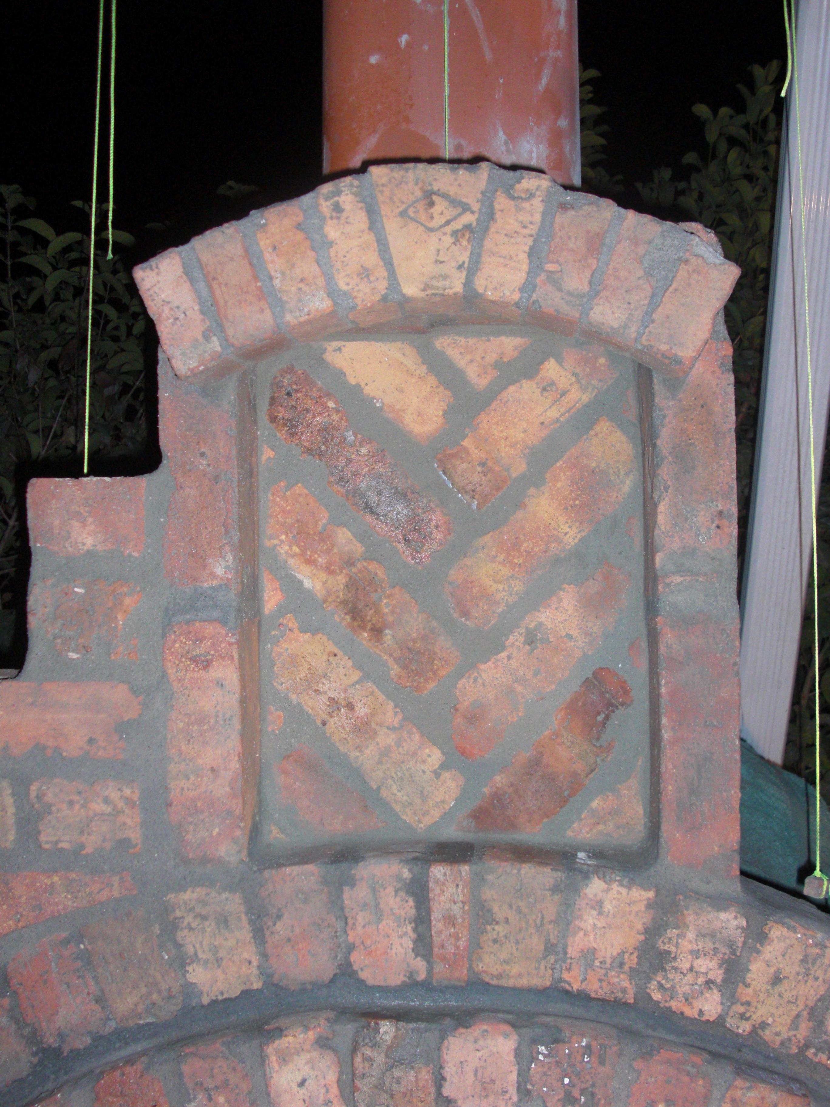

ID:	273625 This was the cool feature I posted yesterday. The keystone has the diamond stamp that's on all the bricks. I read that it's a 'union' stamp and was one way to tell if they were authentic Chicago bricks This is not a political statement; for the record-I'm not for or against unions, I just thought it looked cool.

                    The inscription on the keystone, the keystone itself, the brickwork, the cool feature and the fire god to go in it...COOL!! What a great build!
