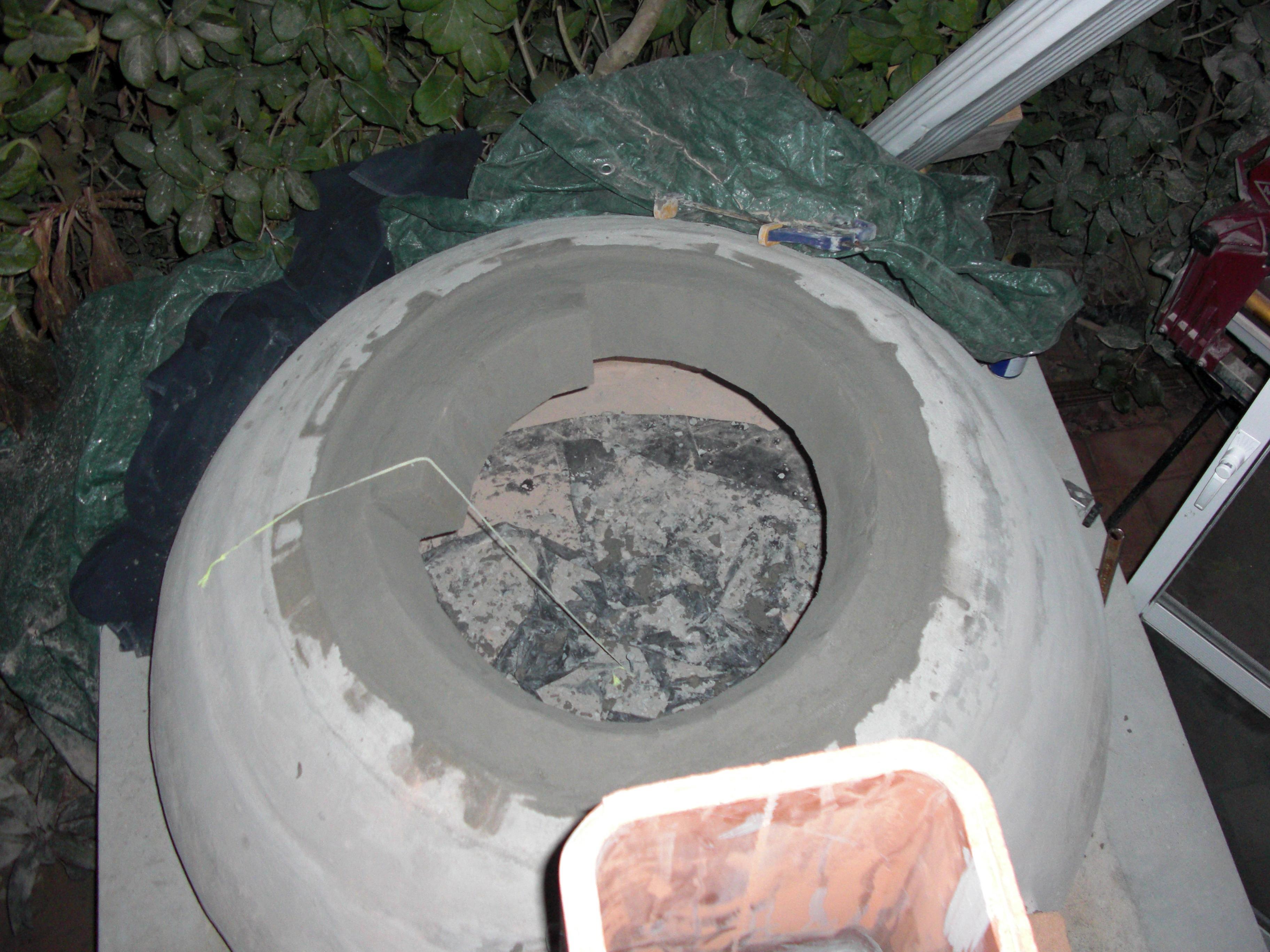

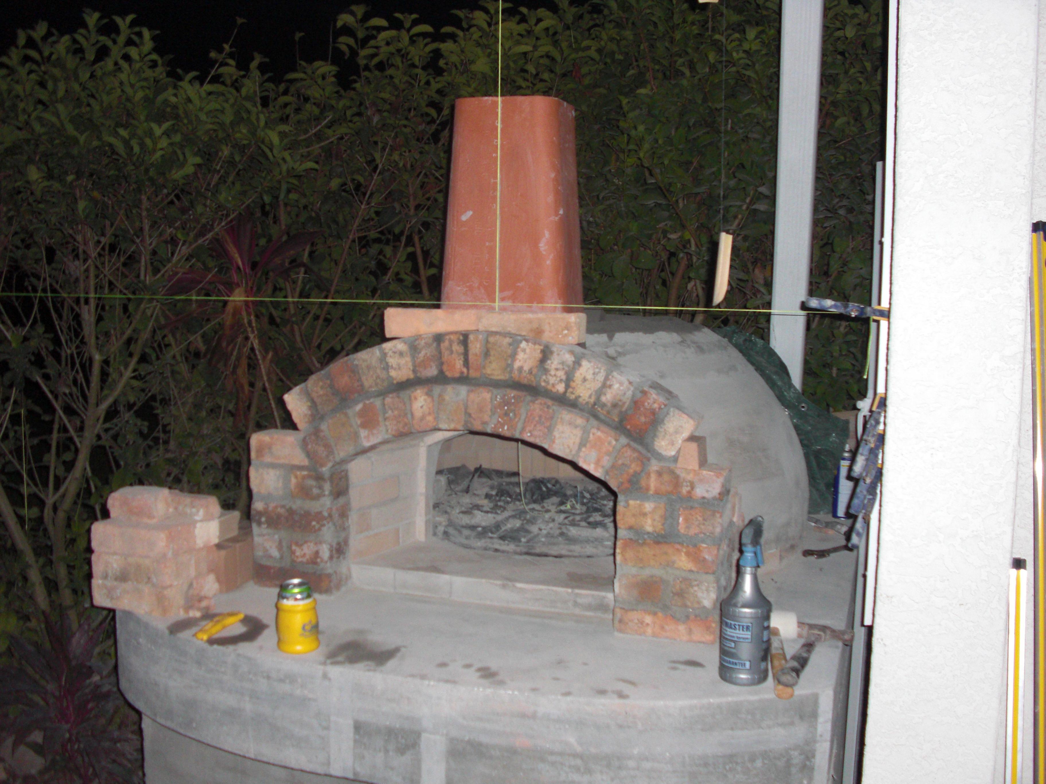

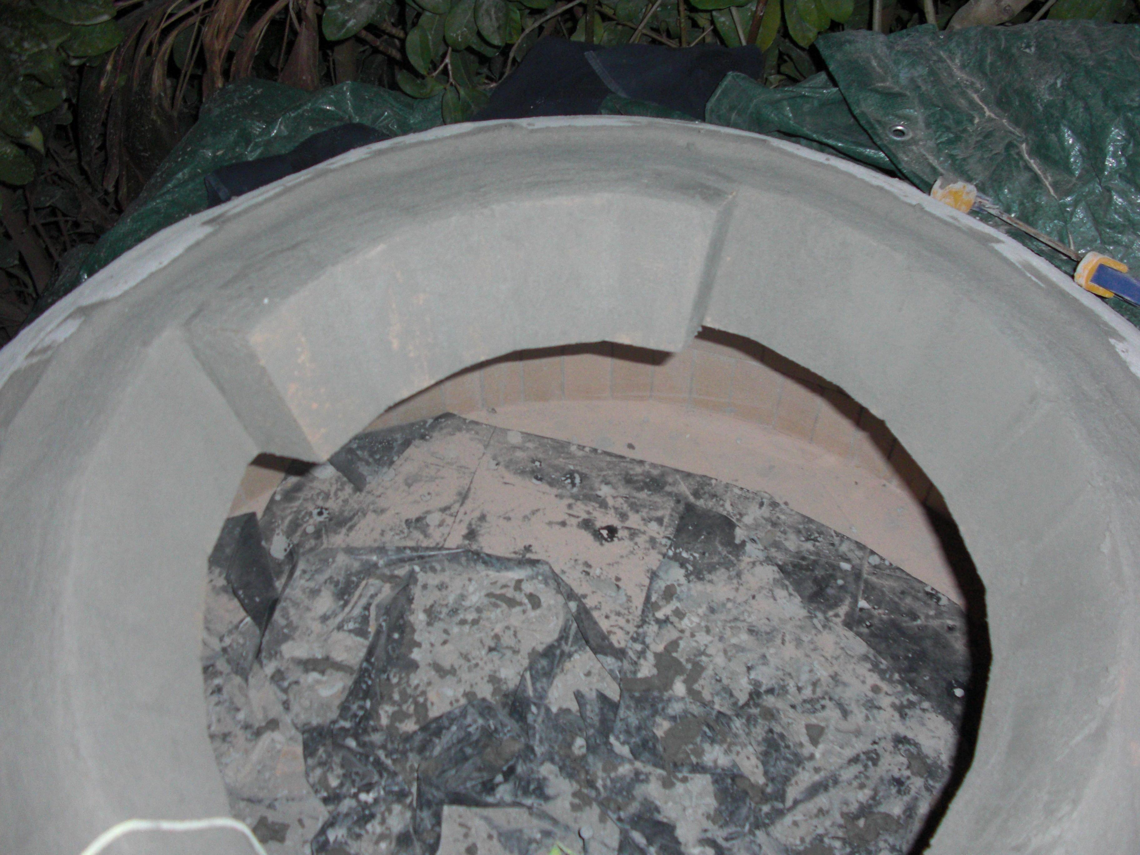

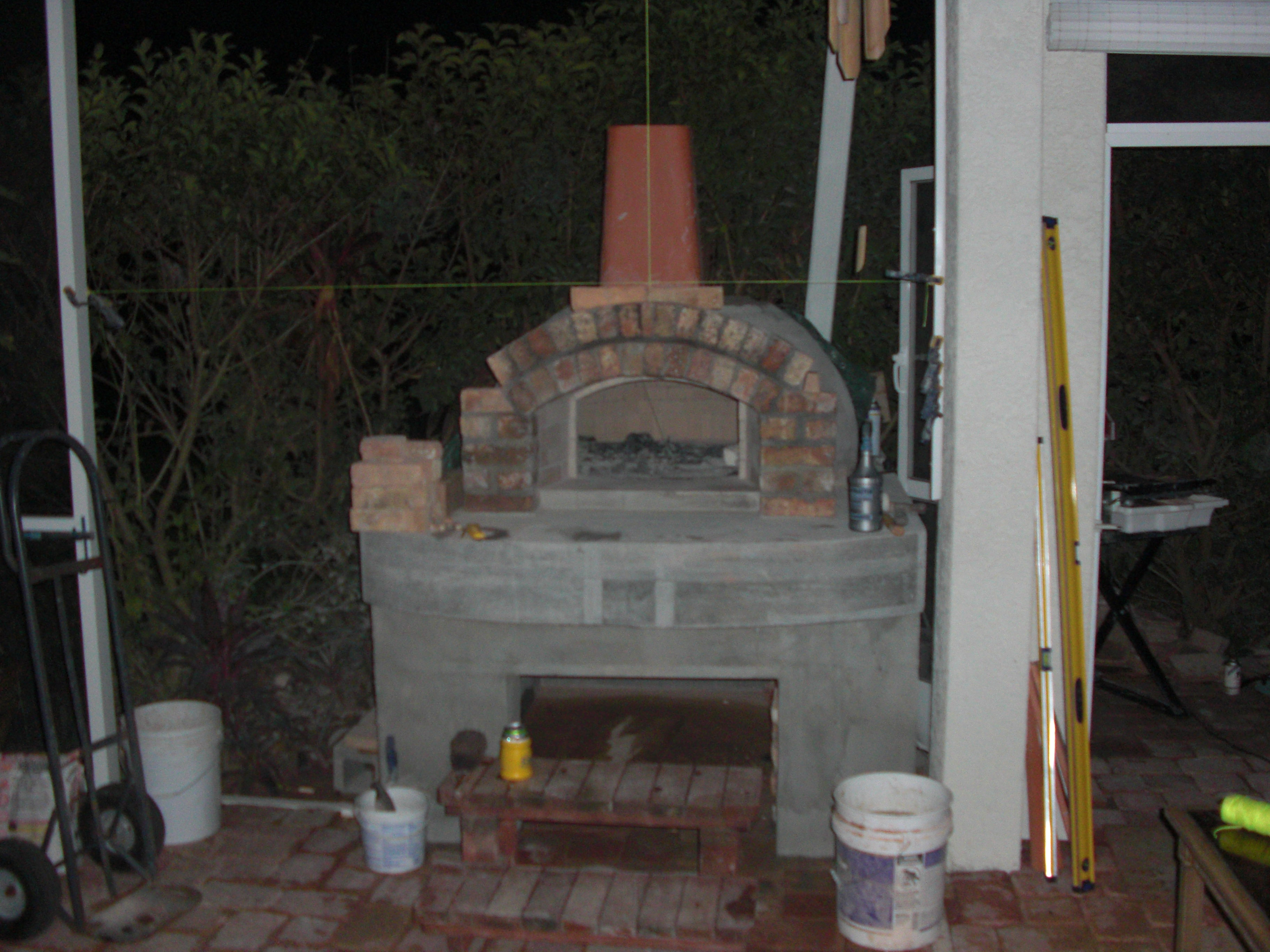

                              The clamps are to be used to stop the bricks from sliding off. If you clamp your first brick in place (after correct angle and edge placement have been achieved) you start adding more precut bricks and then if needed you can clamp the last one set... Hard for me to explain but I can tell you that I have not used them yet. Take a look at the pictures below. The Heatstop-50 has such an amazing holding power without any sliding yet. I mixed it a little on the thick side (thick peanut butter), key it in to your bricks (very important) on all three sides (bottom, left, right) and then place the amount of mortar you think it will need for the angle (determined by the string in my case). Push the oven side of the brick down until it is sitting on the bricks below it and then push the back of the brick down until the string is flush. It's way easier than you think.

ID:	273095 Defying Gravity. These were just installed without clamps, forms, etc. The mortar is holding them in place.

ID:	273096 Blimp shot, almost closed in.

ID:	273097 Sitting area shot...

ID:	273098 Plumb and level line in place ready for more Old Chicago bricks! The level line also shows me the screen location; It will land just behind the top row of bricks on the arch... I love it when plan starts to come together
