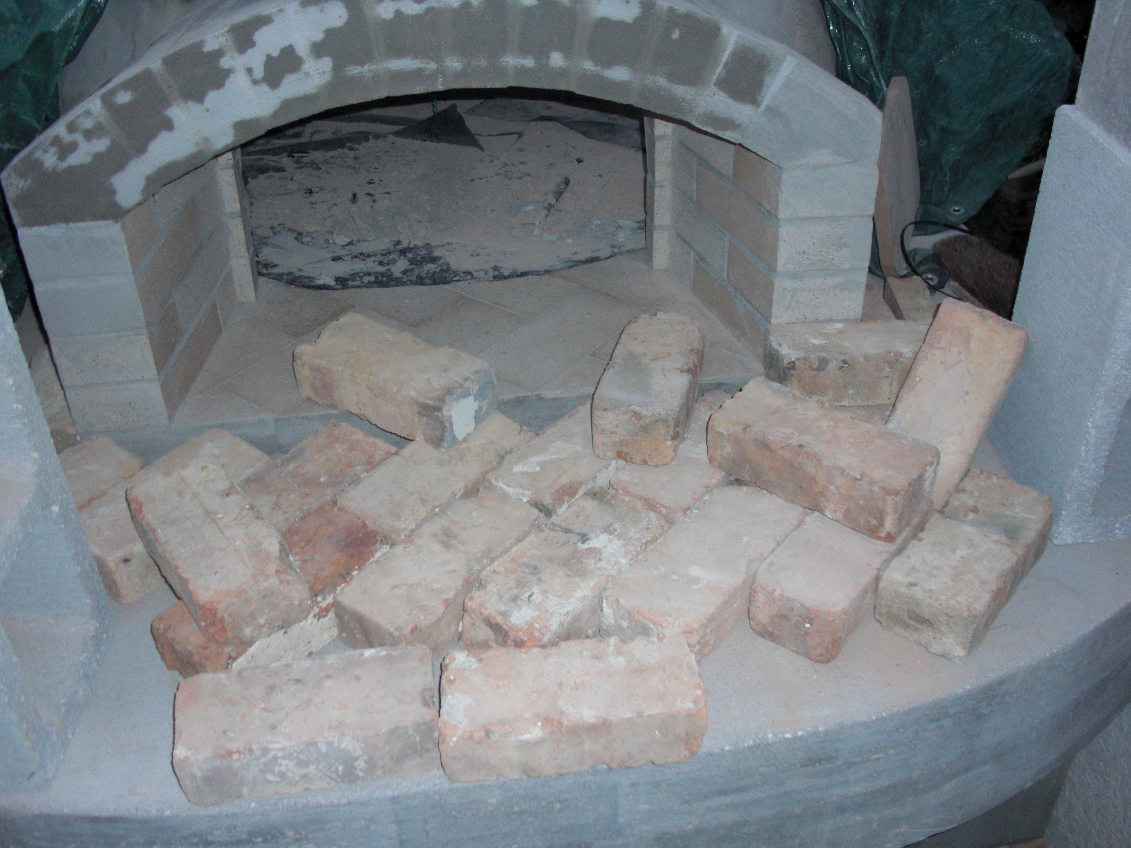

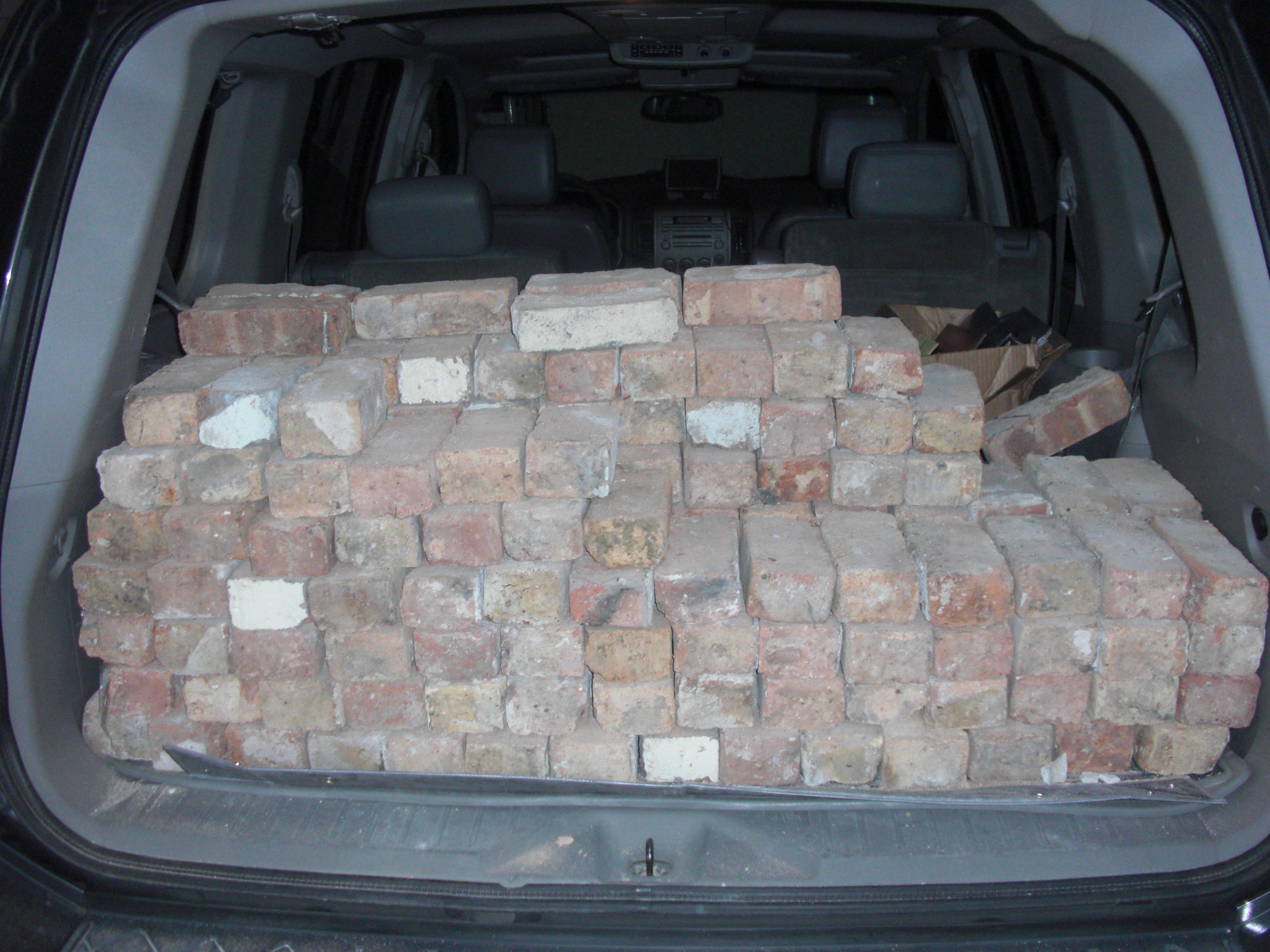

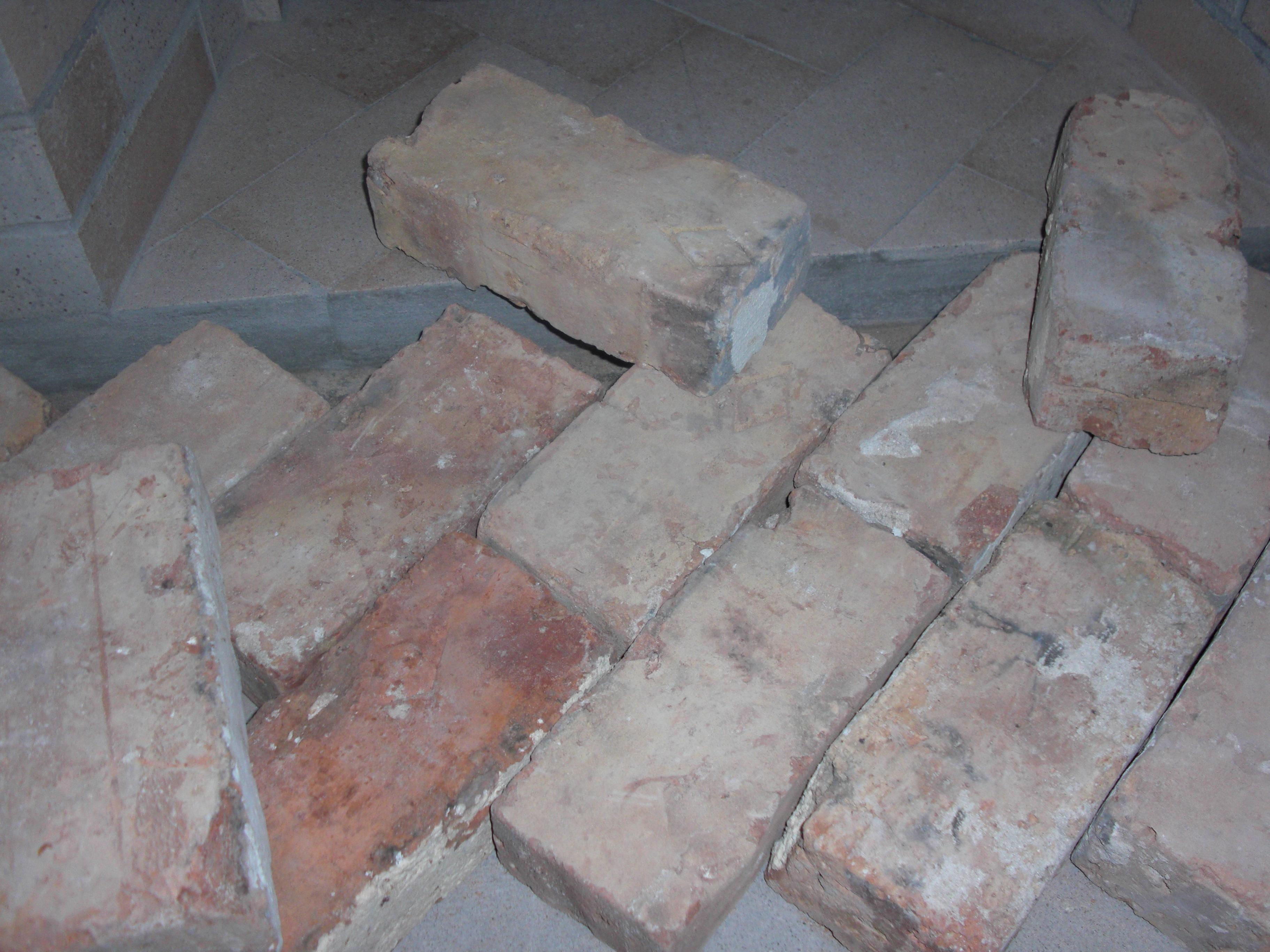

                      Here are my bricks that I'm going to use for the arch, chimney, and dome exterior. Heck, these are so cool, I may just cut some into 1/2" slices and use that for my stand exterior....
ID:	273001 Man, just looking at these makes me smell pizza...
ID:	273002 Close up of bricks... Trying to convince my 12 year old son why I had to pay for these was fun.
ID:	273003 The Armada is getting a good workout from the build! 200 Chicago bricks is nothing compared to what I did to it when I had to get the blocks and cement for the hearth stand.

                          Looks like you really had the Ramada loaded down....
                          I bet it was fun to drive home!
                          Christo

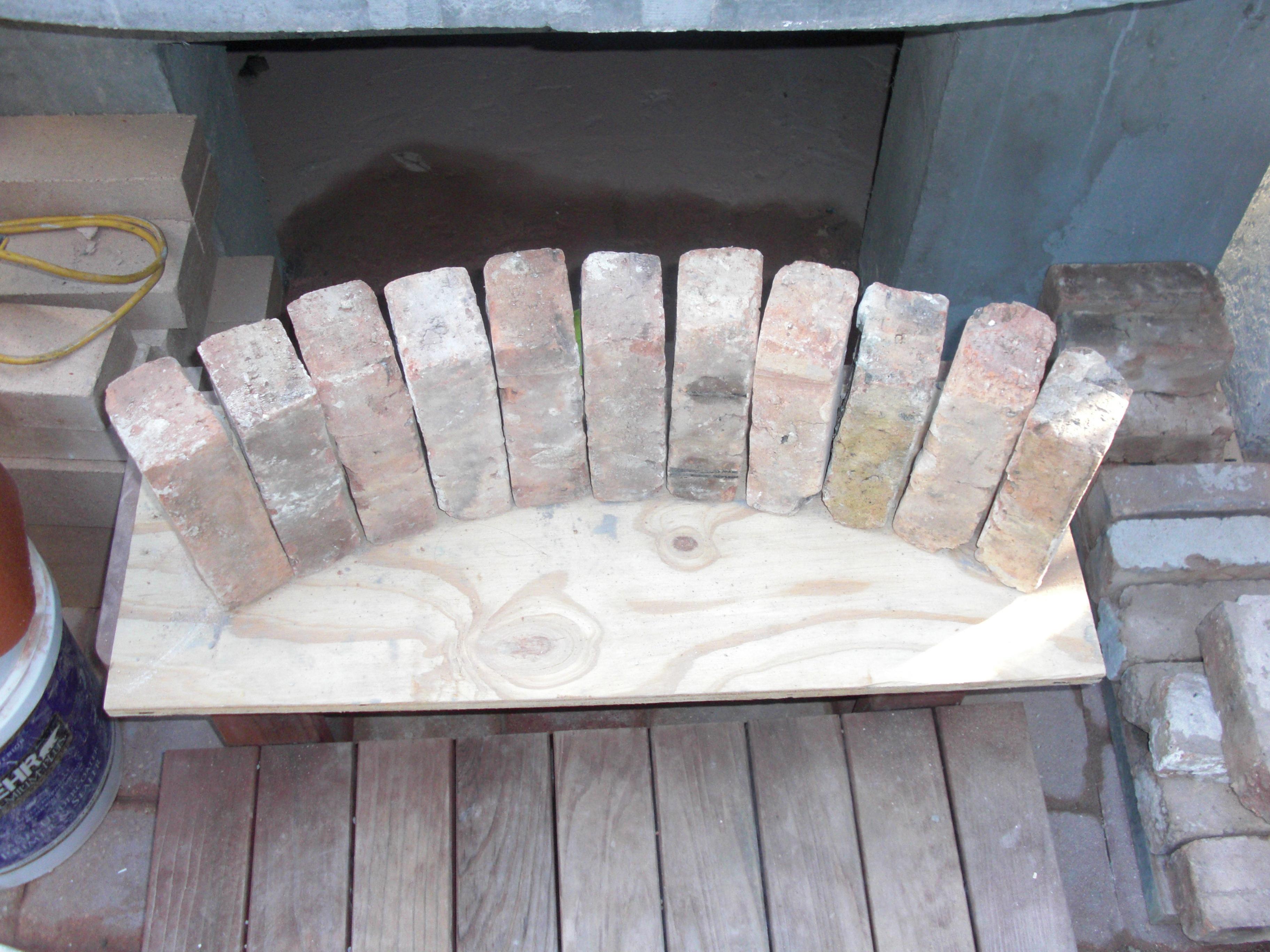

                                I'm trying to decide what to do with the brick. There are so many designs I could drive myself nuts (if I wasn't there already). I have two basic designs for the foundations. The arch will be the same but one would incorporate full brick, the other would be halves.
Name:	Chicago Brick Entry Ideas 016.jpg
ID:	273010 Full brick design. This would give it a more massive look making the front reveal larger along with allowing me to use full brick for the arch as shown below. The drawback would be that it would make it farther to get inside the oven which may or may not be an issue.
Name:	Chicago Brick Entry Ideas 017.jpg
ID:	273011 This design allows me to use half brick on the arch giving me a better view in the oven. The only drawback I can see would be that it gives me less brick to work with when tying my screen into the mix. That is not a big deal; having the best reveal is a bit more important to me.
Name:	Chicago Brick Entry Ideas 018.jpg
ID:	273012 Although hard to imagine, this is how the arch would look from the bottom. I kind of like it. It looks very heavy, almost structural. Well I guess it is in a way.

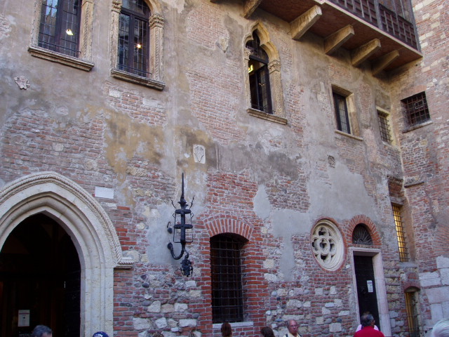

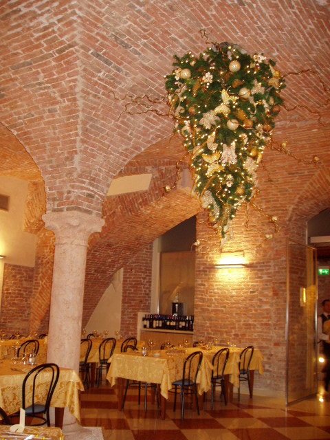

                                I was fortunate enough to travel on business to Verona Italy a few years back. While I was there I took a lot of pictures of their buildings, arches, and I'm still amazed at how many arch designs were incorporated in just one single building.
                                Take a look at this.
ID:	273013 This is the home where Juliet stood on the balcony... Although not real, this 13th century structure is. I went there 4 times just to look at the stone and brick work. I was also fortunate enough to be invited to a private event held by Antolini Luigi that was held at Castlevecchio, way cool. Apparently it was the first event ever to be allowed in the castle as half is a museum, the other is occupied by the military.

ID:	273014 This is the lower level of a restaurant I dined at, It was a Roman strategic planning room back in the day. It's about 35' below the surface. Absolutely breath taking. What a night!
